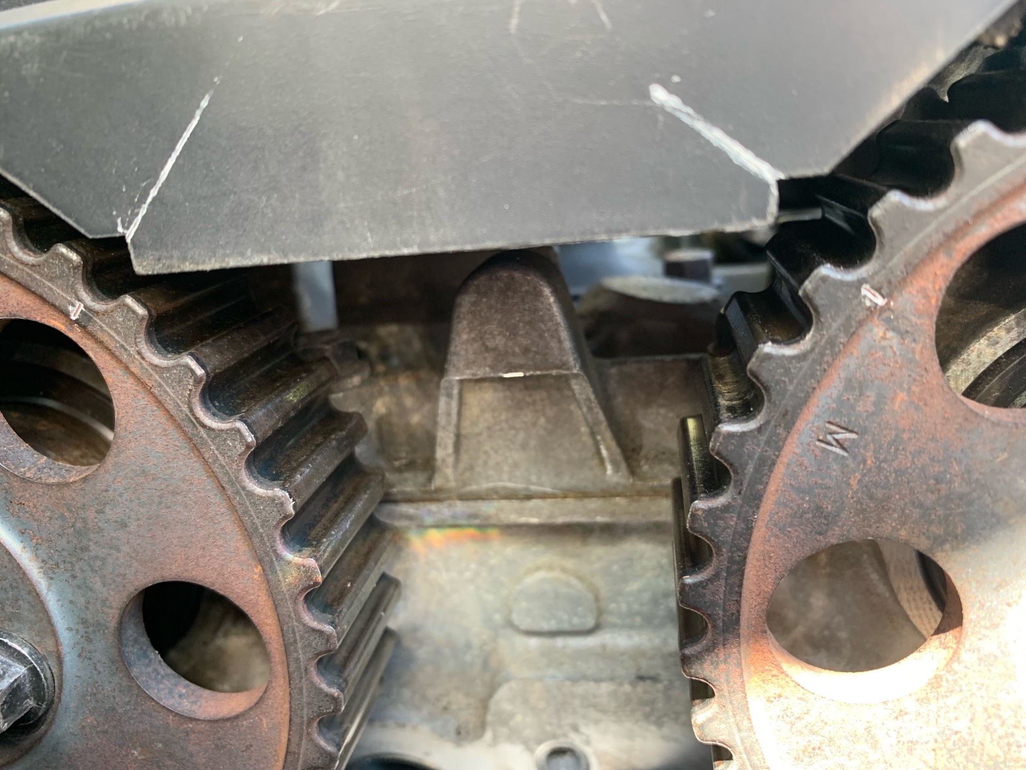

This is as close as I can get the marks to line up when the crank shaft and cams are where they are supposed to be!
Good enough?

Yes!

*ding*
Fries are done.
Fries are done.

That's more like it.
(*As long as the slots machined in the rear [drivers side] of the cams are aligned as depicted in Roberts' video.)
