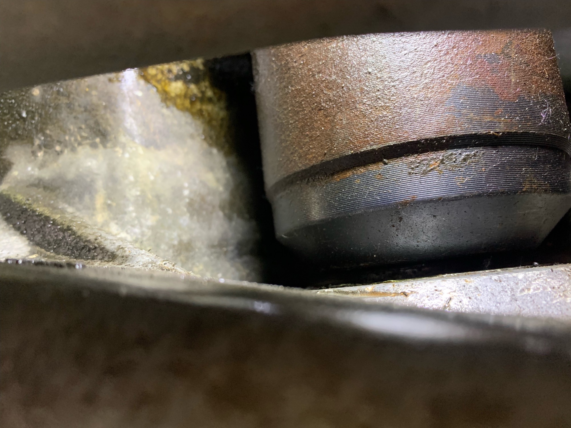

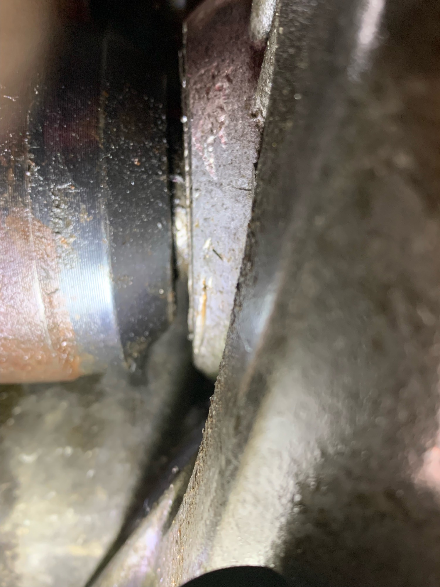

Here are a few pictures:
Do these help?

These are of the driver’s side axle and where it enters the housing.
There is lots of fluid leaking from this side. As you may recall, the seal is only a few years old and the discussion prior was that maybe the spring clip that sits at/near the end of the axle inside the housing may have lost its “spring”. I did finally receive a new clip.
Is now a good time to pull this axle off and replace the clip?
Am still trying to figure out why the transmission makes so much noise when I attempt to backup the car. The last time it did this, I shut the car off and then with the shift release button down was able to shift into park. I was not able to shift into park as trying to felt like and sounded like metal against metal.
