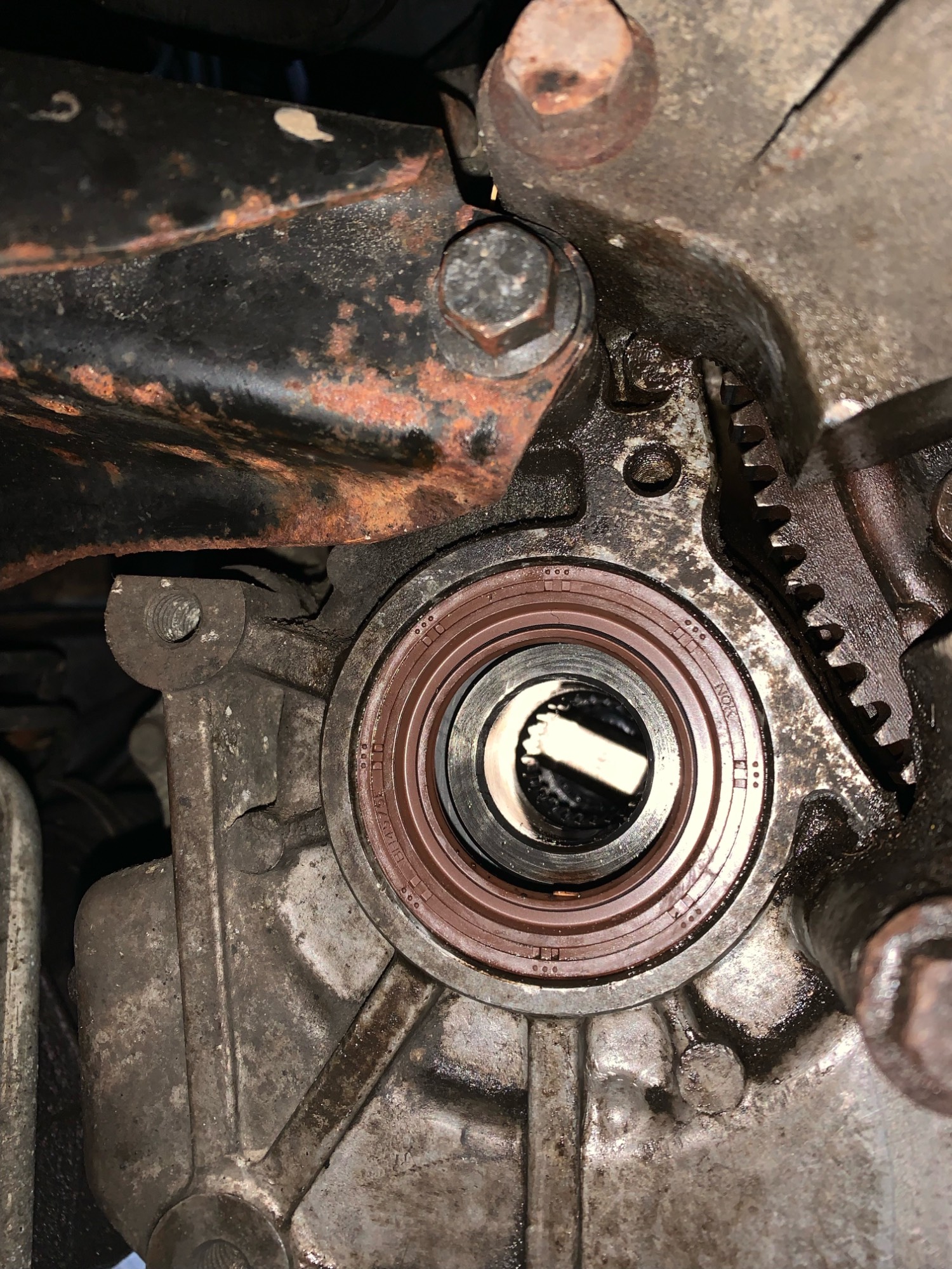

Some pictures:
Pic #1 is of the axle with old seal
Pic #2 is of the old seal
Pic #3 is of the new seal installed
Pic#4 is of the axle installed before trying to reverse the car

I have removed the bolts to the carrier bearing and have the axle out of the hub. Am trying to figure out how to remove the axle. It was not a problem when I pulled the axle out to remove the seal and remove the old cv boot, but it is now. What would have caused the grinding when I tried to back up the car? Appreciate your help!

Is the seal installed backwards? On seals I've replaced, the garter spring is usually oriented towards the inside. Don't know if this is what's causing the problem.

I put in the new seal the same way the old one was-rubber cover facing outward, metal facing inward.
