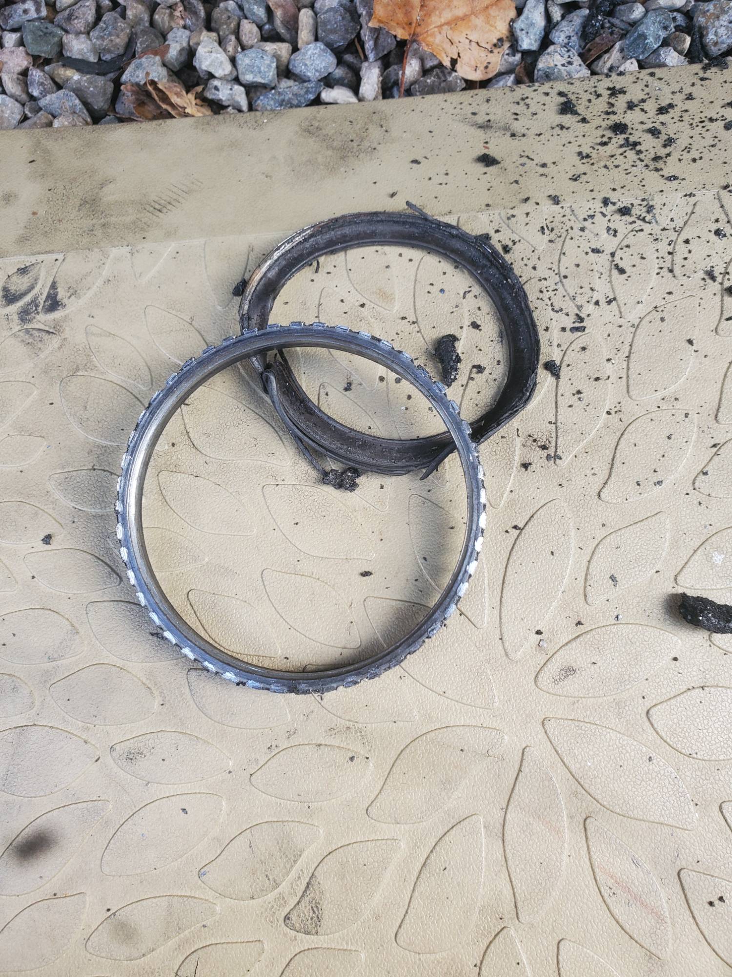

The smaller ring is the dust seal. The larger one is the reluctor ring.
