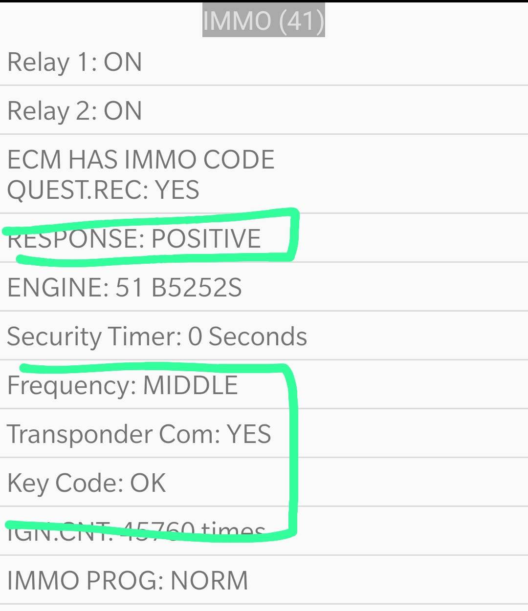

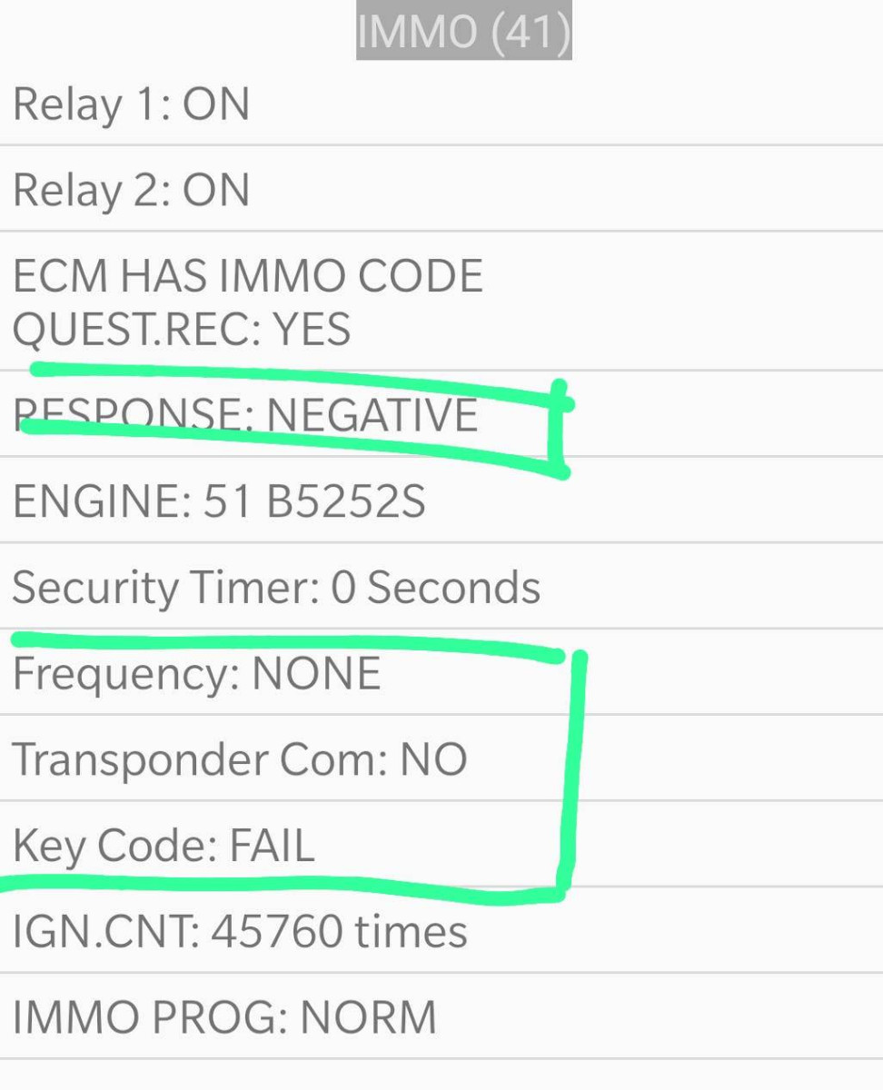

Update on topic:
I drove the car approx 100km with the donor IMMO / ECM now.
Donor key taped to relocated antenna ring, original key in lock.
First starts are unsuccessful most of the time. Vehicle shuts down very quickly. This is the IMMO live log of these cases:
Next attempt is successful then, vehicle stays on. This is the IMMO live log of successful starts Not sure what causes this. I am taking time upon starts, leaving some time for the key to be read etc.
Could both keys interfere with each other? They're 10cm apart approx.

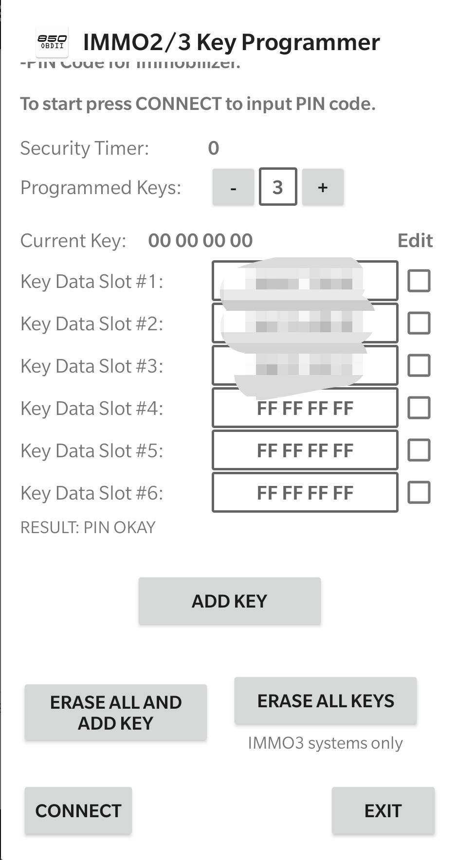

To eliminate this possibility (and for the sake of a clean installation) I'd like to make my original keys accepted by the donor IMMO. Got IMMO PIN and can successfully enter the section in 850OBDII where keys are managed in IMMO.
@Xanthefin
How can I know the key address to be entered there? Do I need to have my original keys read somewhere or can the app identify a keys address that is read at the antenna?

Yeah that bad response includes too if key wasnt readen as bad as thats then from immo side like saying "no good".MotorTheresa wrote: 24 Jul 2024, 03:30 Update on topic:
First starts are unsuccessful most of the time. Vehicle shuts down very quickly. This is the IMMO live log of these cases:Immo bad start.jpg
Next attempt is successful then, vehicle stays on. This is the IMMO live log of successful startsImmo good start.jpg
@Xanthefin

Reader is very sensitive when you take it off as if ever played can see how little they give from right placement and when i example take off from 40 series Volvo it just doesnt work that antenna anymore as alone as it uses metal ignition as part how they are tuned in frequency too.
For that IMMO key data exchange.. i need say not yet as what you see is not full story of the key shortly on IMMO3 systems key needs be ready programmable for the car from Volvo though i can rip the necessary data from IMMO3 via App but not yet program back with an App (i only know bypass to far read but not yet program back all data)... and i havent included read part in app as not yet need.
IMMO3 and IMMO2 Volvo keys are locked too so cant reporgram them as alone with key programmers.
IMMO2 systems are more simpler and its more direct via App by that popup as key is not so cryptic.

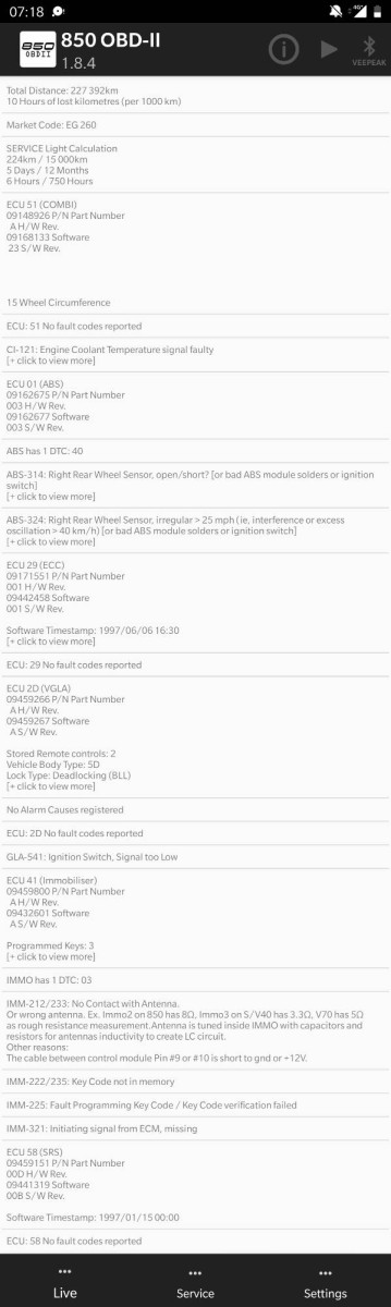

P.s. adding my current summary screen. We see that IMMO is struggling. Is there a way of purging the screen to scan anew from a clean sheet?

P.s. adding my current summary screen. We see that IMMO is struggling. Is there a way of purging the screen to scan anew from a clean sheet?Screenshot_20240725-071815.jpg
Yes Key ID's can be changed, modified, added or removed manually as you wish. But IMMO3 that ID is alone not enough. IMMO2 keys are dumper/simpler and this is what can be done and its enough what i mean sorry.
That Current Key in IMMO programmer view should show ID in Ignition at moment 00 shows there was error at reading or totally wrong kind of key chip. I might add Read button to try again read it.
In Settings Take off "Prevent Removing Scan Data" and do new Scan.
..but i must admit that DTC data not in my plan to keep even if its turned on and propably bug as recently i did notice it cleared all by accident at pressing Scan so i might have made bug there.. i will change that if its so.
But gives me idea just add button to remove it all just manually if want.
