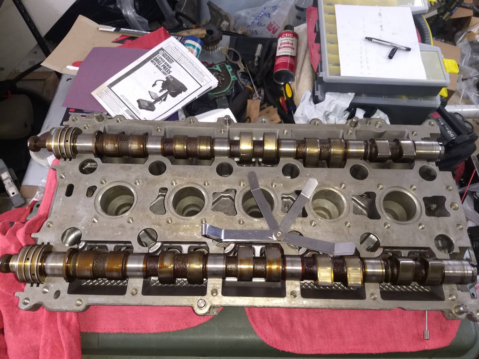

MoVolvos wrote: 29 Sep 2024, 20:06 Nice work, however why is this not done or is it like the transmission fluid :roll: suppose to be in spec the life of the car? Does VIDA give a mileage or time that this needs to be checked?
Solid tappets are good for the life of car. In Volvo's opinion, you should be buying a new Volvo shortly after CPO expires. I.e. should happen before 100k miles ;)
With 10k oil change intervals I see why Volvo switched away from hydraulic lifters. Solid tappets are not only cheaper, but they also don't mind working in that carbon-sludge mix you typically find under valve cover.

I will have to look into this further. It is like the parking brake shoe support on P2's that can break off in salty areas that few have heard of, P80 sub-frames cracking from corrosion and I'm sure there are others including trans oil changes and Haldex services.
I have never heard of tappet/lifter adjustments on white block engines. That is even with engines over 300,000 miles and more. I have never heard noticeable lifter tick on solid lifter motors either. Hydraulic lifters on older P80's have issues as they get older sludging up. The main issues again are caused by overly long service oil changes or lack of.
I will try to find more on the subject from Volvo as I like to hear more.
Thanks for the info.

scot850 wrote: 30 Sep 2024, 08:26 I will have to look into this further. It is like the parking brake shoe support on P2's that can break off in salty areas that few have heard of, P80 sub-frames cracking from corrosion and I'm sure there are others including trans oil changes and Haldex services.
As you can see, back of camshaft lobes have almost no deposits. Means, tappets started to scrape them off.

scot850 wrote: 30 Sep 2024, 09:04 Wow.
The result of thin 0w30 oil running at extended 10k intervals in high heat summers. I've got it at 79k in 2012, PCV was clogged, saw high carbon buildup evidence everywhere. Ran more with 0w30 and 5w30, but lately switched to heavier oil. When it died, it was running a mix of 10w40 and 15w40.
In Canada you have less of mechanical wear simply because even regular 5w30 is thicker due to ambient temps.
But this engine still commonly dies around 220-250k miles. I've counted more than a dozen of forum engines ended up with a burnt exhaust valve (not MVS forum). It also like to overheat and warp, which also brings third cylinder tappets closer to camshaft. A typical death sentence scenario is a summer road trip in mountains in south.

The exhaust valves is a more common issue. From what I have read over many years it is typically down to:
1) Lack of maintenance (oil changes) and leaking valve stem seals. This may be aided by failing oil pan O-rings causing oil pressure drop to the head.
2) Running low octane gas at high speeds and under load.
PCV issues are also an issue due to sludging and lack of oil changes. Our XC70 at around 125k miles is so far ok, but oil changes are 4.5-5k miles with 5W30 synthetic. I am tempted as the mileage goes up on the XC70 to consider running 5W-40 like the R runs on to see if it reduces oil consumption. I'm also going to try it on the 02 XC70 as it burns a little oil (maybe a liter between oil changes).
We do have the much larger issue of temperature range. Were I live we are at 3500ft, and our temps can range from -40C to +35C. Temperatures can go lower and higher. I still use the same oil, but then our cars are garages in a heated garage which should aid wear issues a bit. All out cars are run on 91 octane up here. No regular gas used on our cars, even the 4Runner (the handbook recommends Premium/91!!). All in theory could run lower but as the 2 Volvos are turbos, and we do a low mileage, the additional cost is not a concern.
