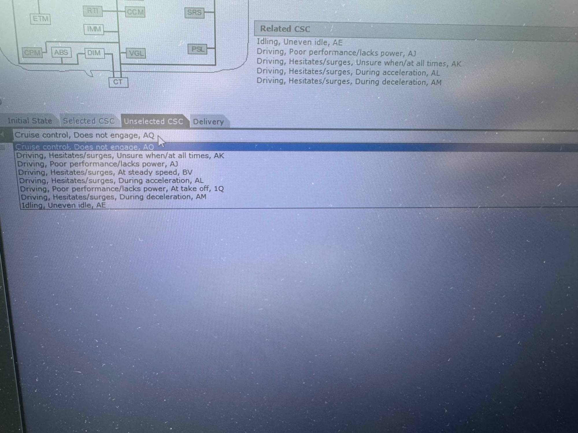

After confirming software compatibility and viewing VC7200 counters, I felt confident that that softwares are compatible and performed an ECM reset. (3minute interval procedure)
At the end of said procedure, I was asked if the ECM-4038 error was still noticeable. Since I was not sure, I closed the window (x)
After the reset, the system requested a 20s idle procedure for code reading.
I am no longer faced with error code ECM-913F, so I believed it was successful. Will have to see.
After restarting vida and requesting a fresh read, the error returned.
I'm probably going to consider cleaning and swapping back to the previous ETM if no other procedures work.

Hello,
I found the ETM test section, and it said the ETM software was up to date and compatible. I performed the ETM test and the result says the sensors max difference is 0.48 degrees. It states that the maximum varience permitted is 13 degrees.
Image 1: ETM Software part number (updated confirmation) Image 2: ETM live readings at no throttle (written below) Image 3: ETM live readings at full throttle (written below) Image 4: ECM-913F Unselected CSC drop down symptom options Image 5: ECM-913F CSC symptom specific info (idling, uneven idle, AE) Image 6: ECM-913F CSC symptom specific info (Driving, hesitates/surges, at steady speed, BV) Image 7: 720A code reference. (no issues) Image 8: ETM test results graph (maximum difference shown 0.48 degrees) Image 9: ECM-913F Potential sources I checked the ETM throttle position sensor, throttle absolute position, intake thrtottle / desired position, and accelerator pedal live data.
*Again I see that ETM-Absolute throttle position begins at 21.18% instead of 0%. *

I am able to view the dropdown options under unselected CSC which cover different symptoms and list of items it wants to check to verify symptom, but it does not update from the 'checking' message phase. I am able to manually click on them and confirm/deny the question, but I am not sure how to progress.
