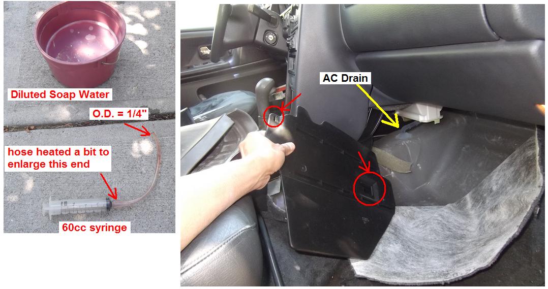

Thanks jblackburn,jblackburn wrote:See the instructions for heater core removal...
Actually for this job (AC Drain), there is no need for any tool at all. The only things you need are:
- Small bucket ($1 at hardware store) and diluted soapy water
- 60 cc syringe with small vinyl tubing (O.D. = 1/4").
I heated one end of the vinyl tubing a bit (on the stove) so it fits the syringe.
1. Simply peel the carpet downward.
2. The plastic side panel has 2 tabs (Red Arrows), just pay attention to them during install.
3. Once the rubber hose is disconnected, squirt some soapy water down the bottom drain.
You should see water under the car.
4. Squirt a bit soapy water into the Evap: have a catch pan ready for water to come out.
5. Don't forget to re-connect the rubber hose.
See pic:

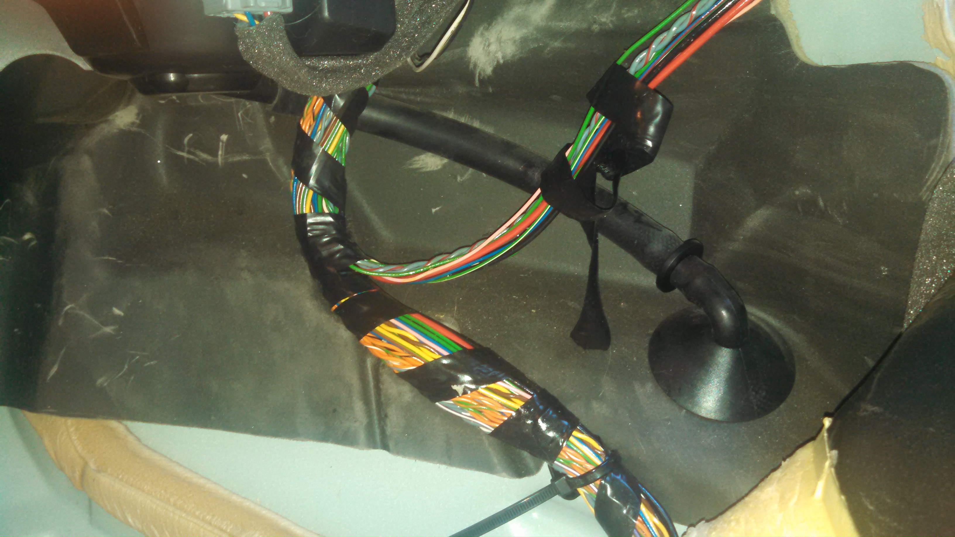

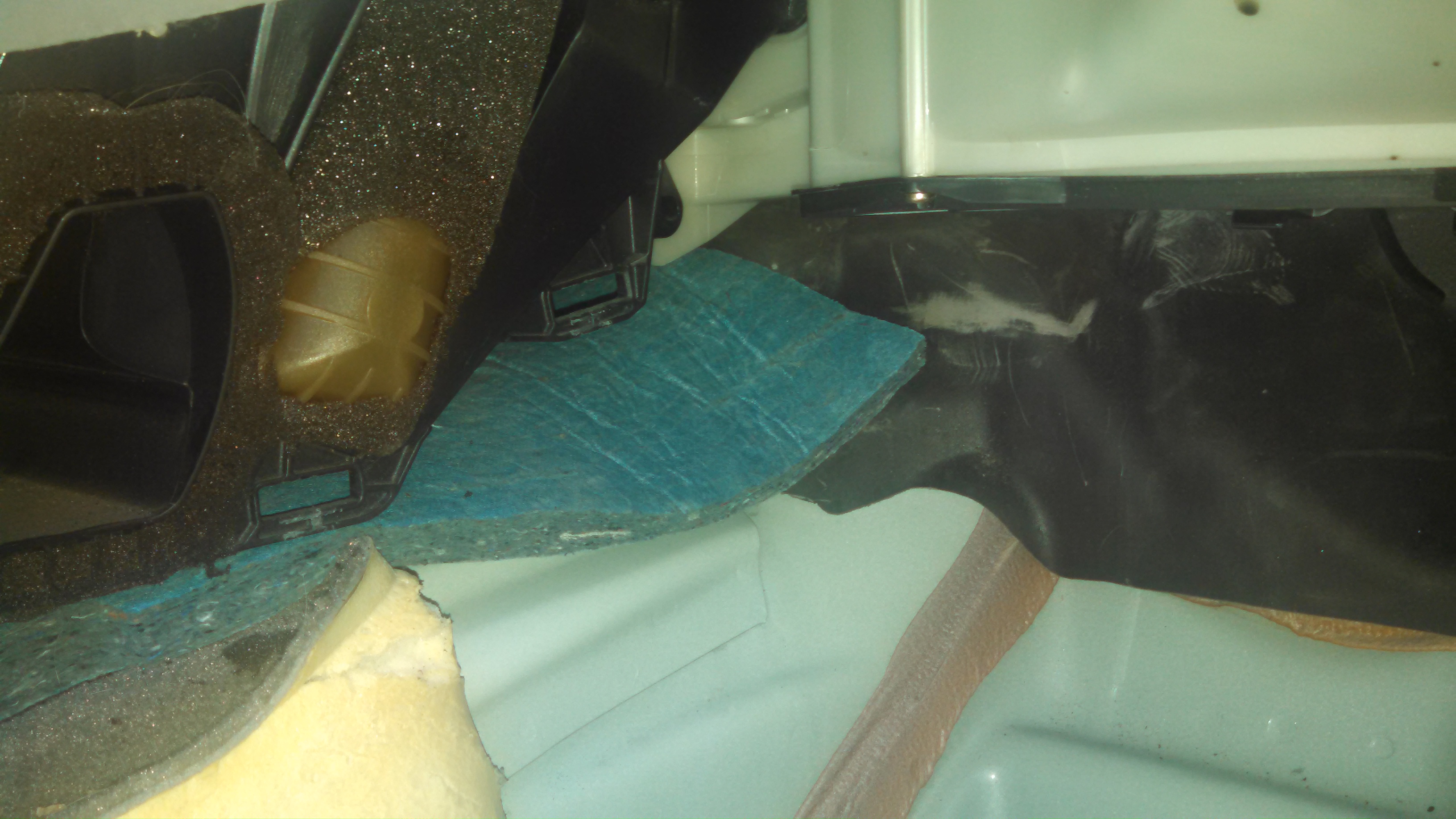

My car is a 2005 xc90. I am going to resurrect this thread b/c despite a lot of search I cannot understand how to find this drain clog. I have removed the trip and pulled back the carpet w/ foam backing. The only hose I see is what I believe to be the "cover draining hose". Am I too (somehow) remove/pull the hard black covering? I have attached some images of my car...any help would be appreicated. (I have already investigated the sun roof leak and rain cover seal below the cowl and I think this must be the cause of my leak). Also, the A/C is not blowing particularly cold...could this drain clog be the cause of poor A/C performance or is my evaporator just shot?)
The first pic is from the right side of the passenger footwell - and this has what I believe to be the cover draining hose"; the second picture is from the left where I thought the evaporator drain hose would be.

The 2nd pic shows the drain tube. Pull it and check it for blockage.
The AC not being as cold as it should probably just needs a refill, which you can easily do yourself with one of the cans from AutoZone.
