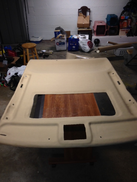

This looks suspiciously similar (minus the paint roller) to the videos which you posted.northernlights wrote: Using a small trim paint roller seems to be the best way to apply the headliner into the corners/curves. I put the clean board out on a piece of plywood on two sawhorses, laid out the material on top, and then folded it at the mid point so that I could apply the adhesive to one half of the clean board while rolling out the new material. After I finished the back half, I folded the fabric the other way and did the front half. All trimming was after the foam bonded, and I took some pictures of the old board to remind myself how much overlap the factory used in different places. The first photo below is the old board.
