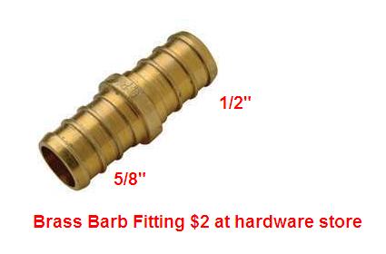

I am thinking another option: modifying the coupler with brass fittings!
Get 2 brass "barb fittings" ($2 at hardware store): 5/8" on one end and 1/2" other end (or could be 1/2" on both ends)
Remove the coupler and drill appropriate hole sizes for the "barb fittings".
Slide the brass "barb fitting" x2 through the coupler and seal it with caulking or silicone caulk or whatever.
- Re-install the mod coupler back on the firewall.
- Inside cabin: a short hose from this new coupler to the cut pipes (cut the pipe with tube cutter as mentioned)
- Engine compartment: use standard 5/8" (or 1/2") heater hoses.
This allows you to replace appropriate hoses later w/o messing with the coupler any more.
SEE Pic. What do you think?
PS: This Barb Fitting $7.00 for a 5-pack at Home Depot, talking about cheap!

The pipes are 5/8 OD (0.625") on both sides of the coupler.
I did not know about that writeup when I eliminated the coupler junction on my car, but it was pretty easy. I used Gates Green Stripe 5/8 heater hose (1 inch OD, 0.6 inch ID). Fits right through the coupler once you remove the interior bits (no drilling etc needed).
It is not a cakewalk to maneuver the thick heater hose in the cabin, I think using a brass coupler might be more of a pain than it is worth. Later on you can just disconnect the stubby pipes at the heater core when needed.
