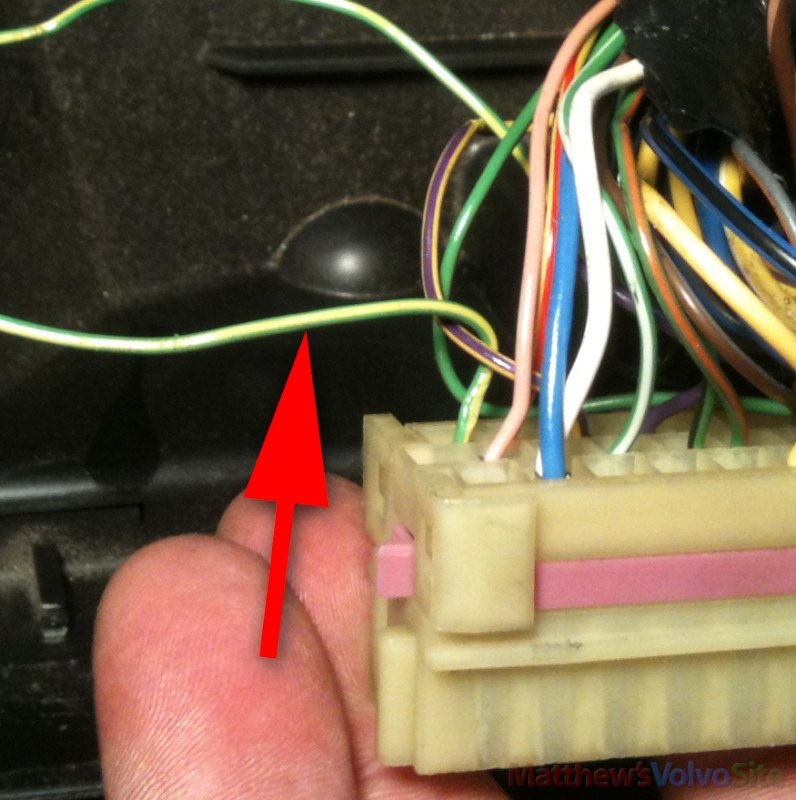

Fair enough, but that is the wire which he said he cut. What is you opinion on his observation of no change?jimmy57 wrote:I no longer have a car with this setup.
You are looking for the green with yellow stripe wire that is a jumper between rear of ECM base and TCM base.
IT requires removing TCM and ECM and then pulling the box apart so you can get some access. None of this is hard. You take the bolt out behind the washer reservoir filler and look for the tabs down on box base and the box lifts straight up.
There a 4 or amybe 5 wires that go between the bases for the two control modules. All the other wiring leaves the box to the front engine and trans harnesses or to the rear for car body harness wires.

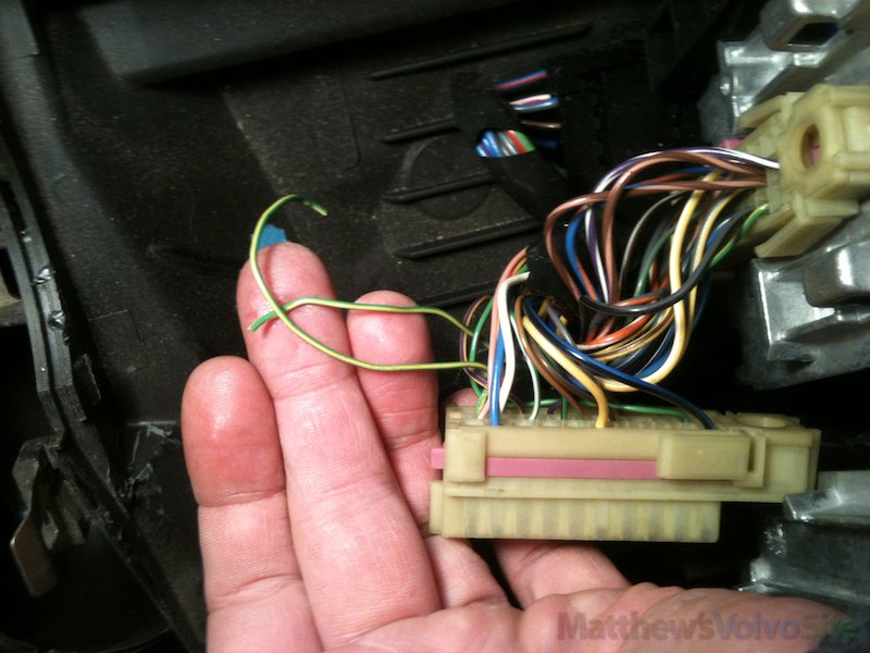

I'm going to try this tomorrow, meaning I'll cut the "green with yellow stripe wire that is a jumper between rear of ECM base and TCM base". I'll know one way or another, and report back within minutes.

I'm knee deep in this now. Printing out the TCU PDF so I can take it into my garage for reference.
- Posts: 14809
- Joined: 14 Sep 2002, 11:03
- Has thanked: 2857 times
- Been thanked: 1332 times
No change
. Oddly, I can't feel any change, but there should be something to be felt. I disabled something.

For what it's worth, the harness looks like it matches the wiring diagrams, at least what I can see in the pics. #1 is green and yellow, #12 looks somewhat pink, and #22 has two wires, a violet and a white, just like the diagrams claim.matthew1 wrote:No change. Oddly, I can't feel any change, but there should be something to be felt. I disabled something.
