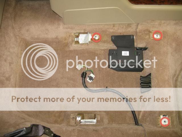

Reading some other threads, I think I get it: the amp I have DOES go under the seat, hence the length of the cable. This was the image that came up, and Jim (JRL) chimes in about the same upgrade. In there it's said that Dolby doesn't do much without the center speaker running. That leaves two plugs unused.
Is the one marked "CD" where the ipod adapter goes? Now that I have this stuff on the kitchen table it's starting to make sense.

The cable shown in the middle of the picture is for the passenger seat. The one coming from the radio is wired in the amplifier !!cardiegoV70 wrote:Well my pieces are all here, but I can't visualize the under dash arrangement. I know where the Dolby goes after being in there for a heating core and seeing pics. Is there a thread with pics someone can post?
It must be well away from the HU judging by the length of the harness.

I would say that answered my question about taking the seat out and placement. Thank you! I don't think it will be too practical to properly install in such a tight space with my meat hooks.

Will do, thanks. You think I will find holes for the mounting flange and wiring on an example that didn't come with the amp? I'm hoping so.

Yes, the '98 is pre-configure for this upgrade. You have to remove a small, "pre-cut" piece of carpet to reveal the screws nuts. They are embedded there so you need suitable bolts (sorry, can't remember the size!)

Wow. The amp went in just as described. HU was a breeze to pop in. CD player worked straight away.
I'm astounded by the quality of the sound from a CD source. Played 1 hr of reference tunes. Ears bled.
Decided against Dolby processor. Next up is the blitzsafe Ipod adapter. The cheapo headphone jack mod was tempting, but I think I prefer all in one charging and signal connection.
Thanks to all who helped, especially JRL for sending me a prefect harness and working amp.
