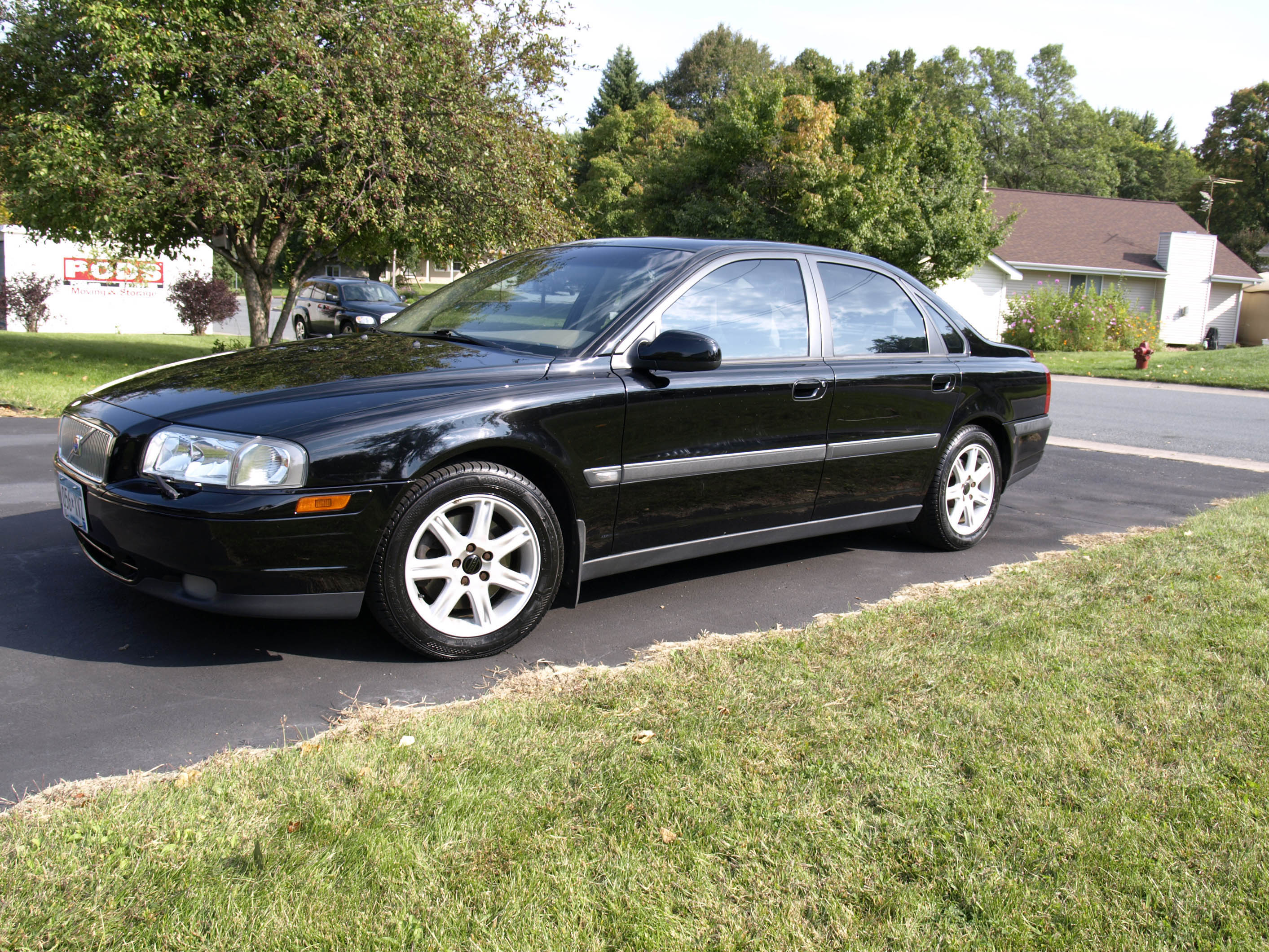

Wow that is a good looking car! I forget how great black looks. I sure miss the 8 series radio my 2002 S80 had it sounded so way better than the 6 series radio my 2004 has. I have the 10 disc in the trunk as my car had it. I asked back when the 2004 was new if my dealership could upgrade the stereo to the premium surround sound 8 series and they said no it couldn't be done.rb61 wrote: 13 Sep 2017, 22:01 Dr Dan,
