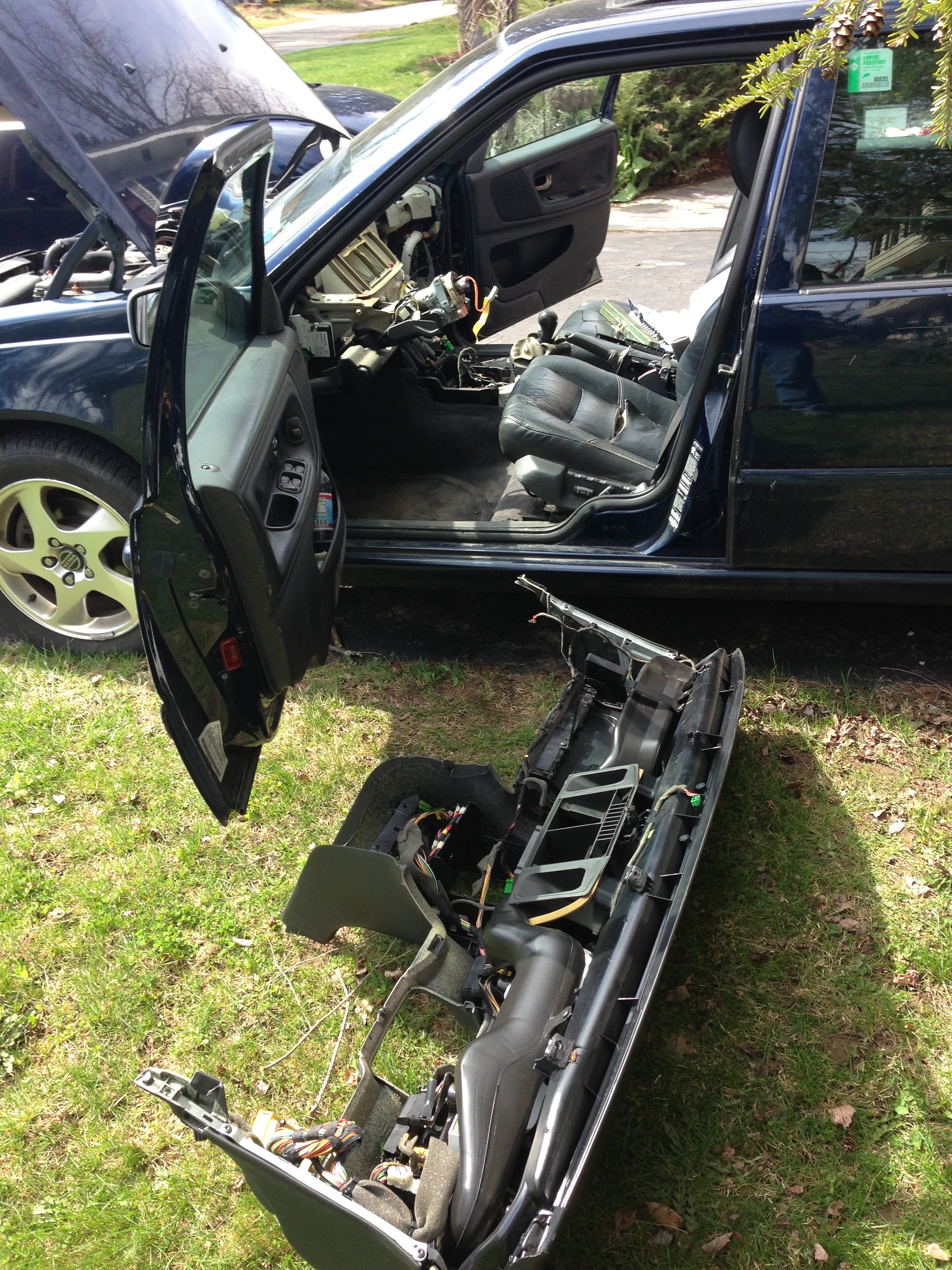

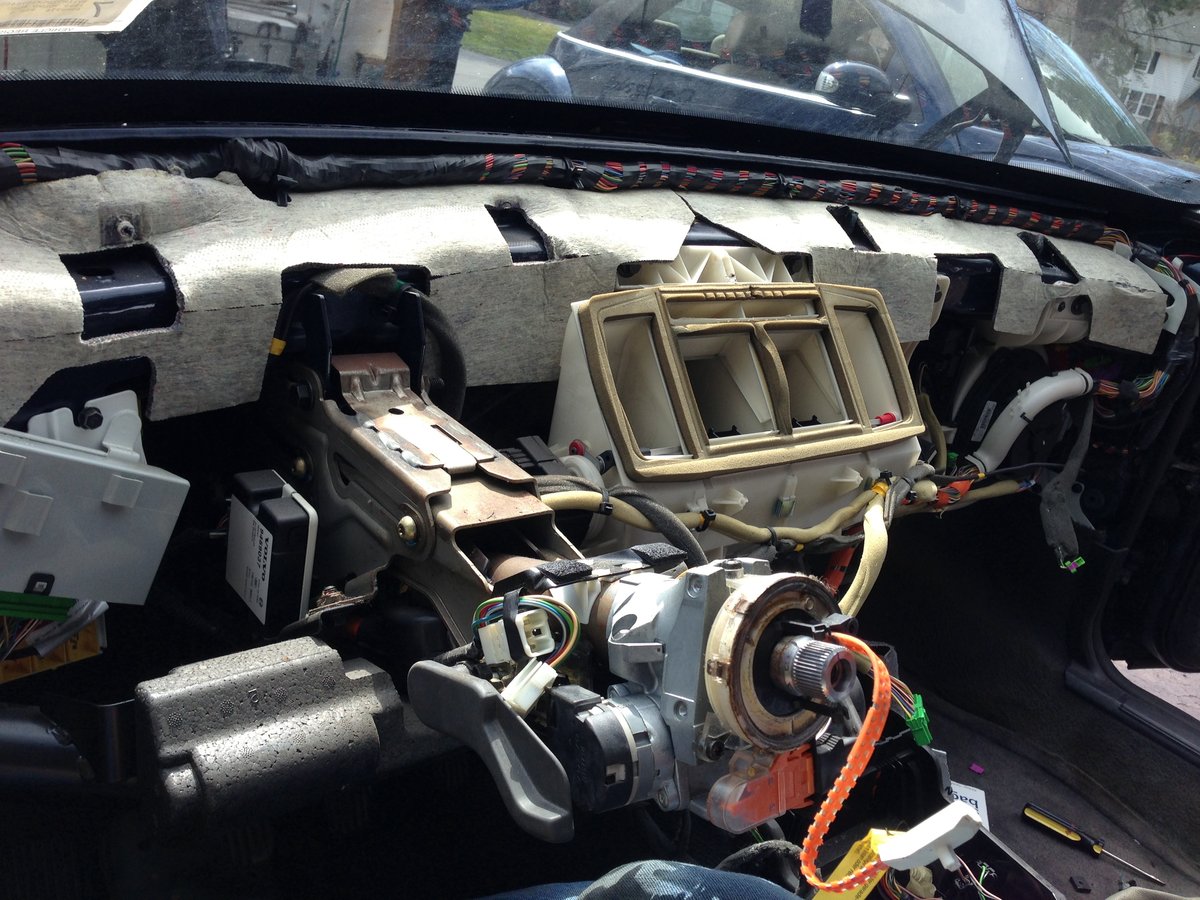

Question:

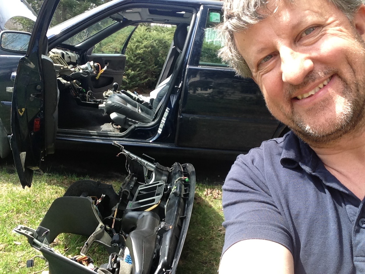

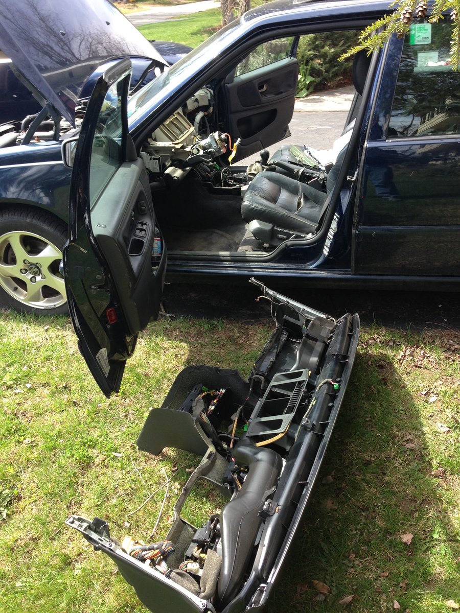

YOu were able to take the dash out one of the doors...I'm wondering if one could also take it out the back tailgate also then? turn it the long way? maybe? no? yes?

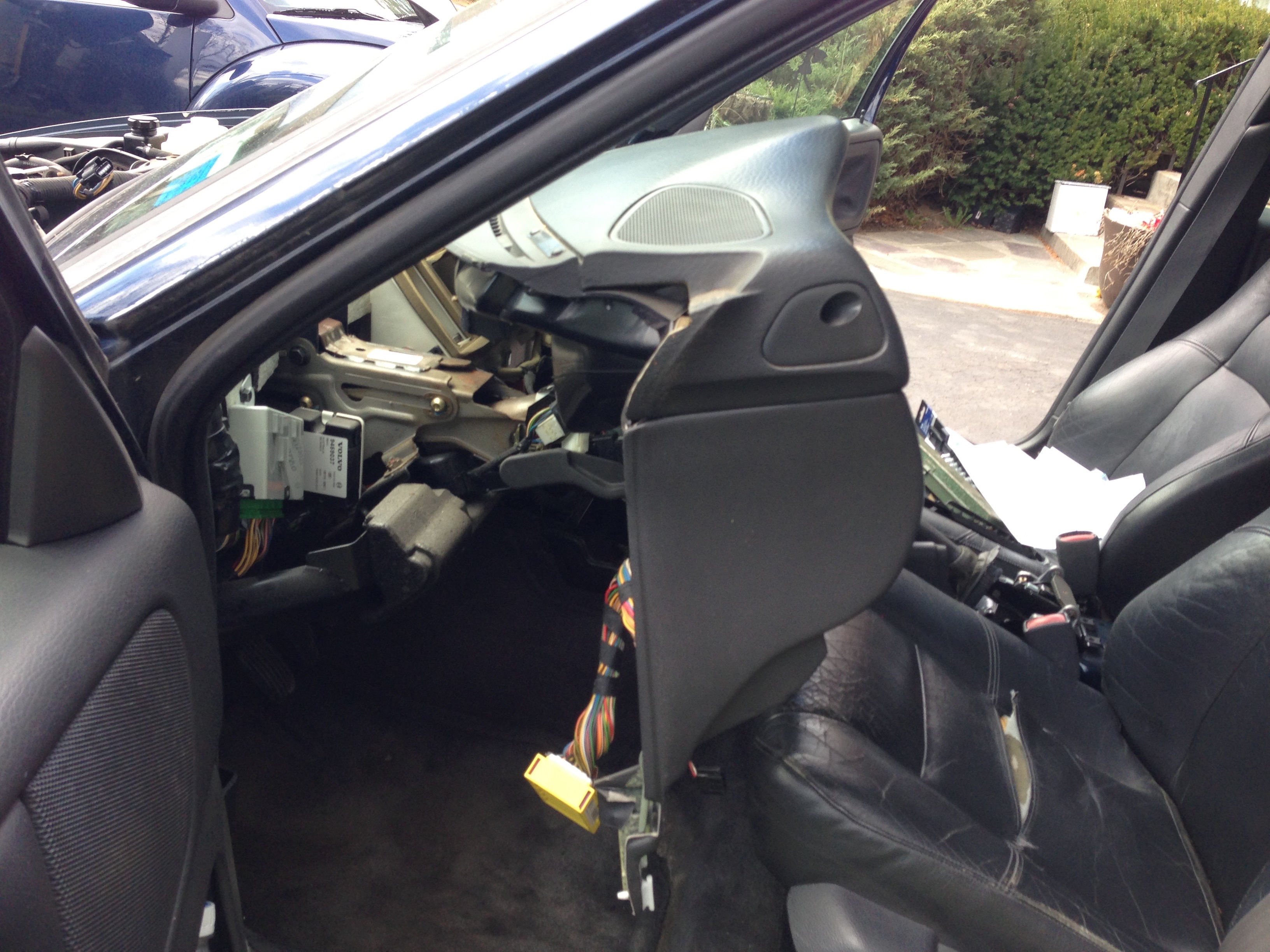

98T5 wrote:Question:
You won't get it past the back seat if you do it that way. I took mine out of the passenger door with good clearance and with the help of the other (more delicate) hands in the household.

Would definitely recommend one helper on passenger end of dash, and removal out the driver door.

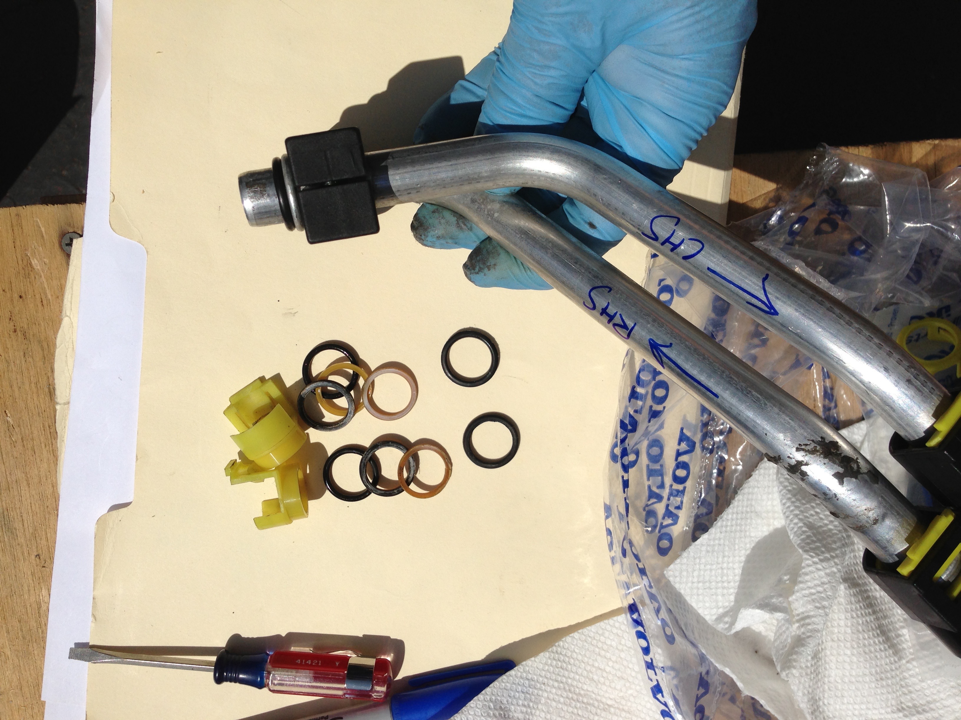

Abscate rule - buy two of and replace every Oring that you touch on HVAC

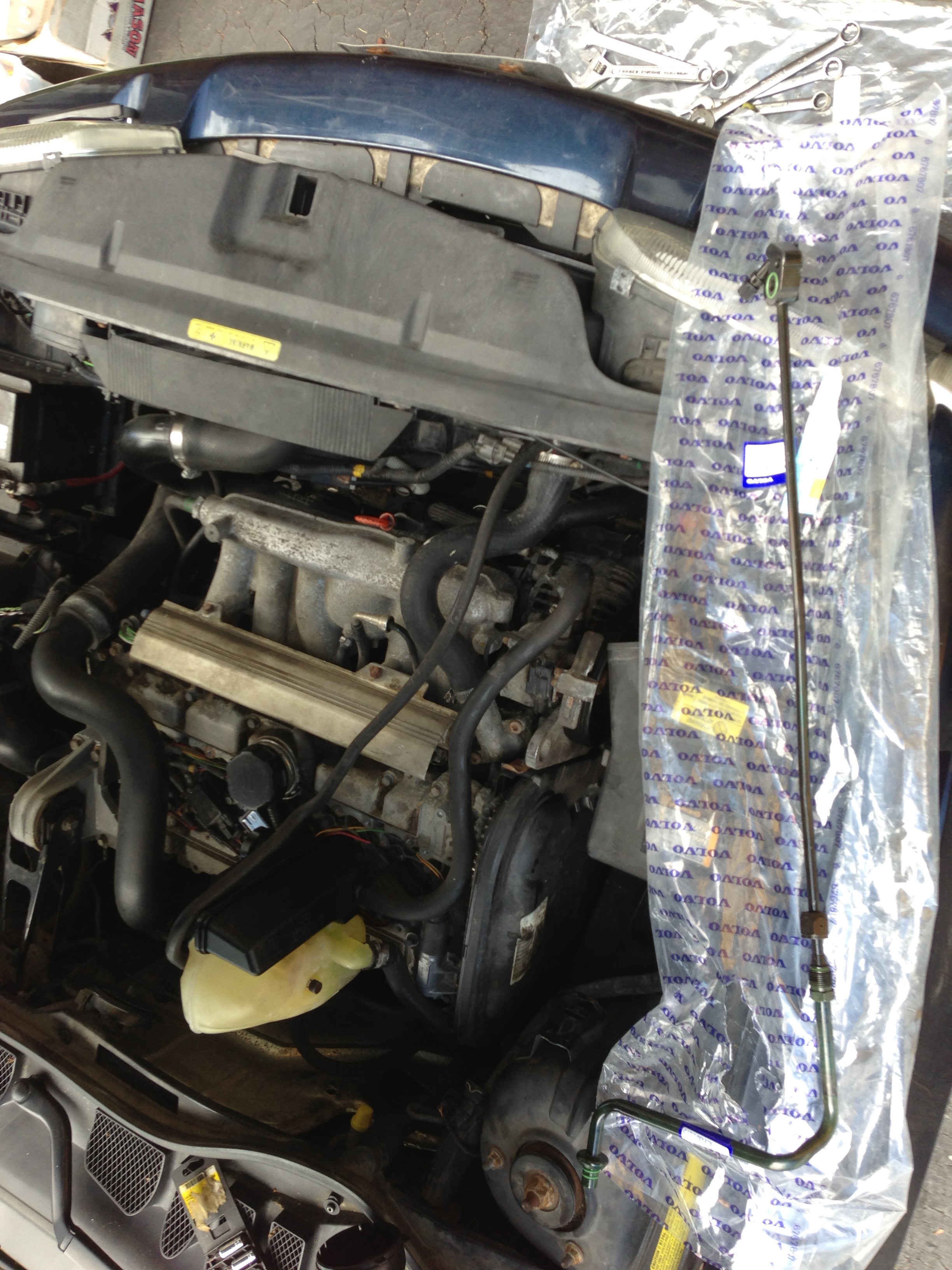

I had to replace this hard line, but install was a breeze.

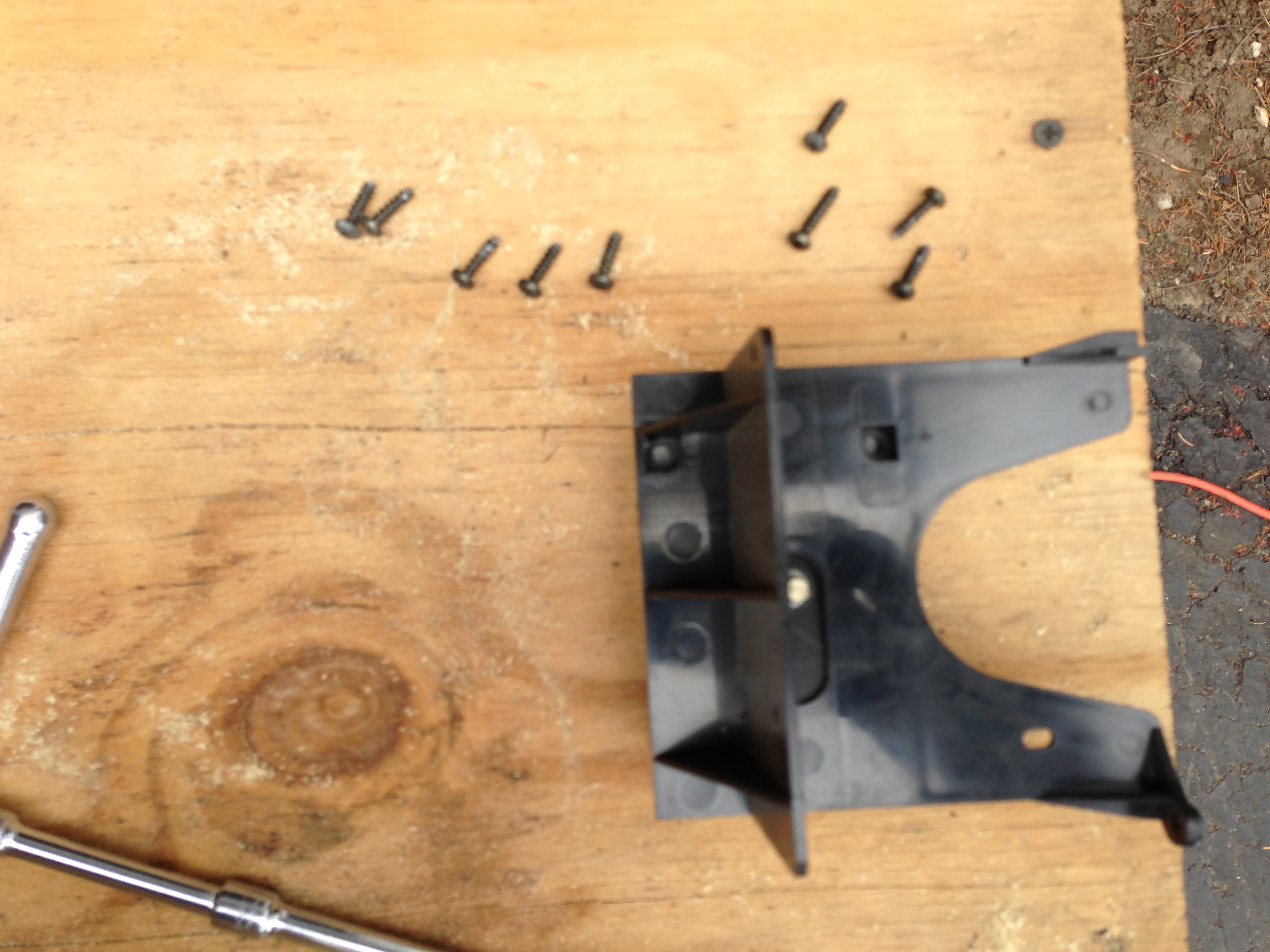

ha!! Recognized as the mount plate for the record /fresh air damper motor up near the glove box. One T15 release motor for this mount

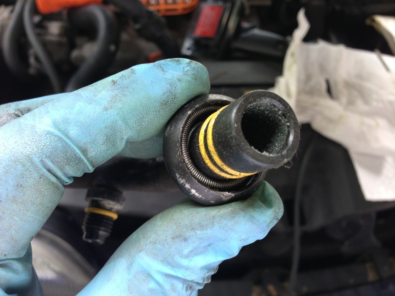

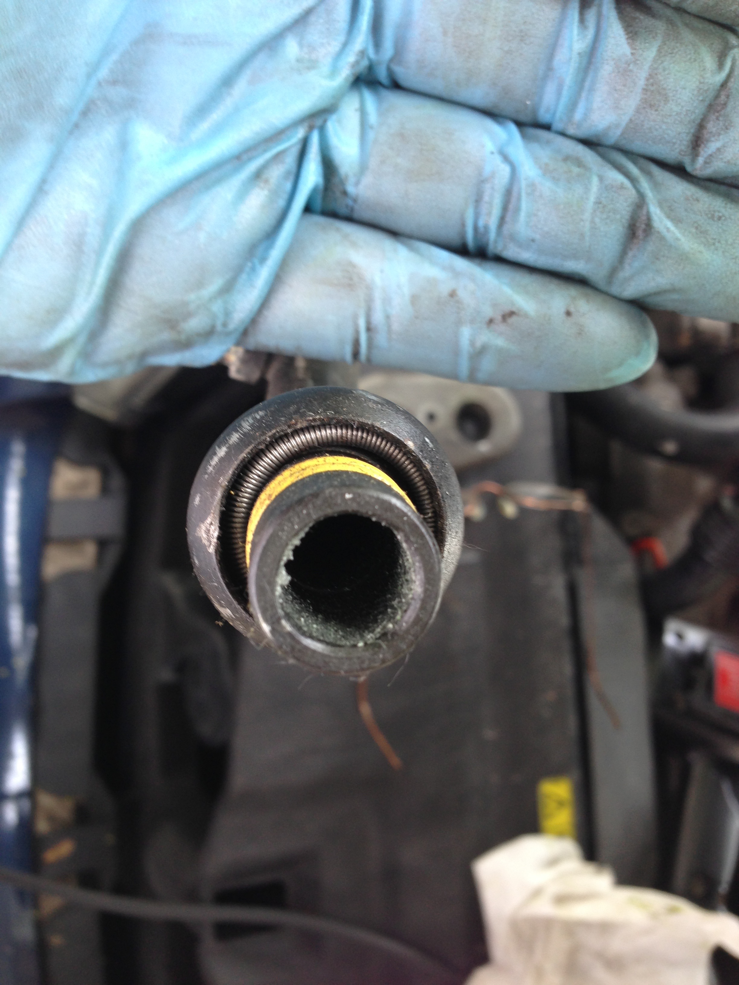

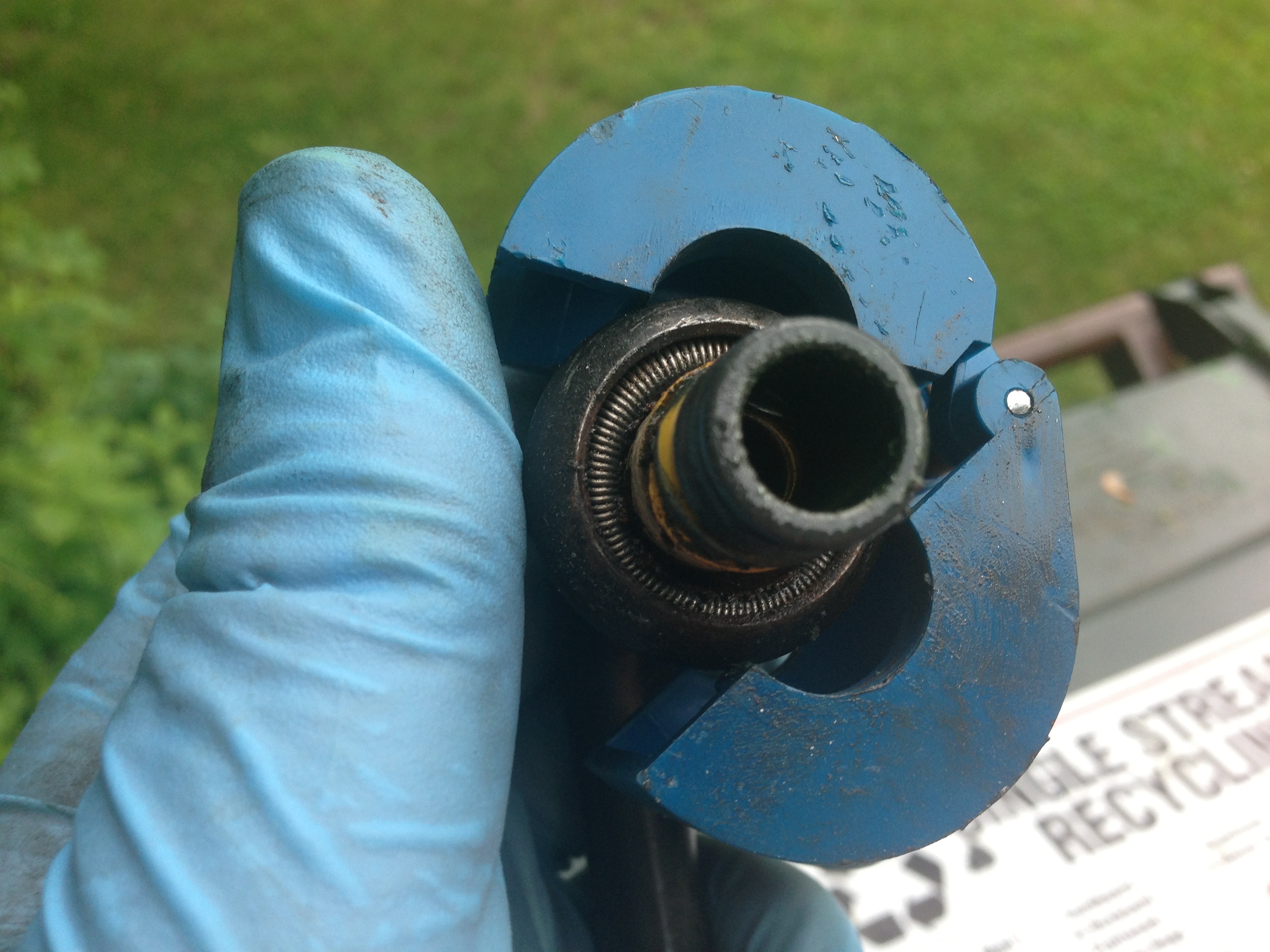

The tool expands that spring, which lets the trombone end slip out . Good luck  The aluminum corrodes the steel making it tough to twist and break free. Cut the evap and save an hour of swearing.
Double O rings
Double O rings

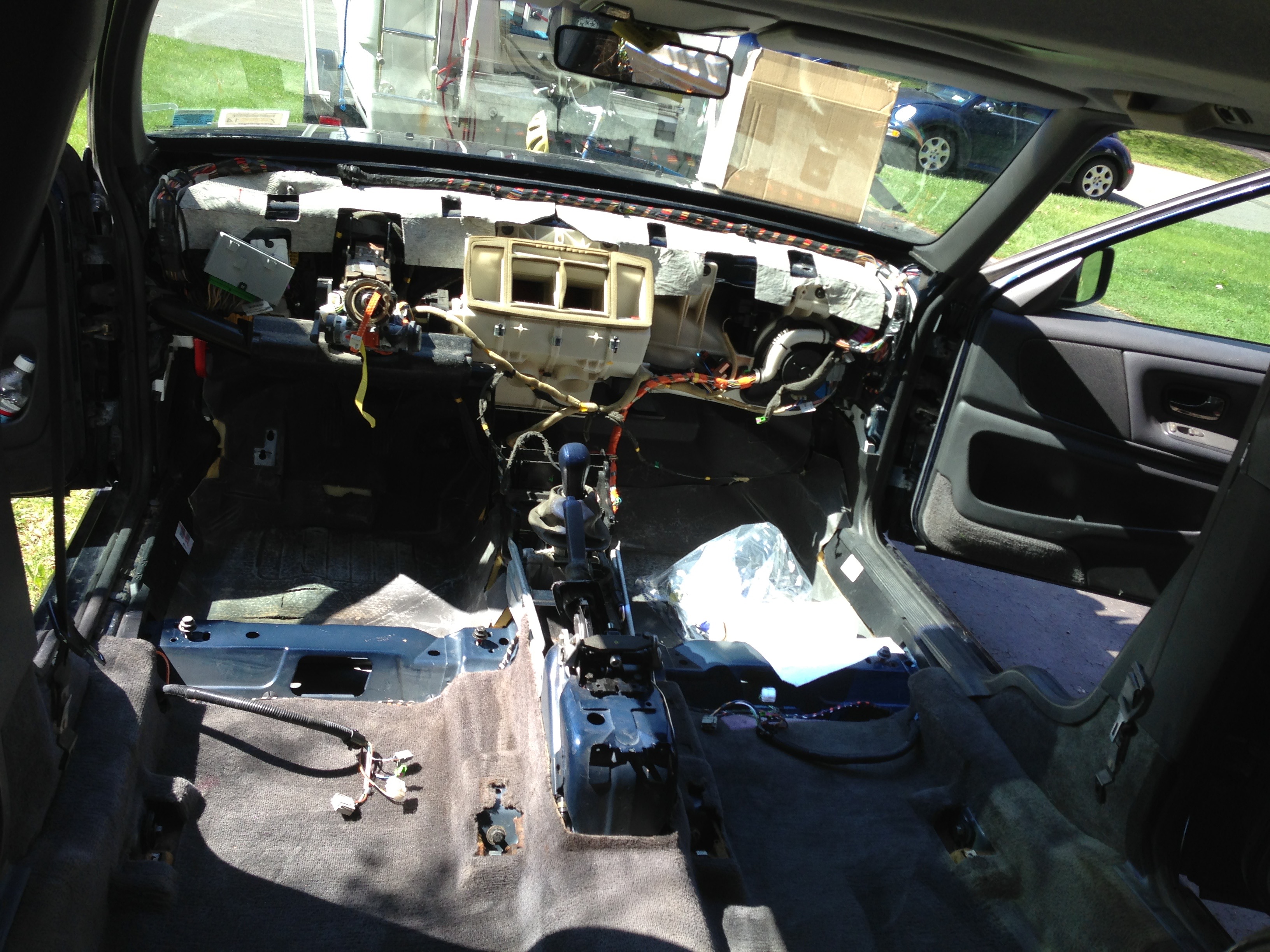

Dash back in
Dash back in

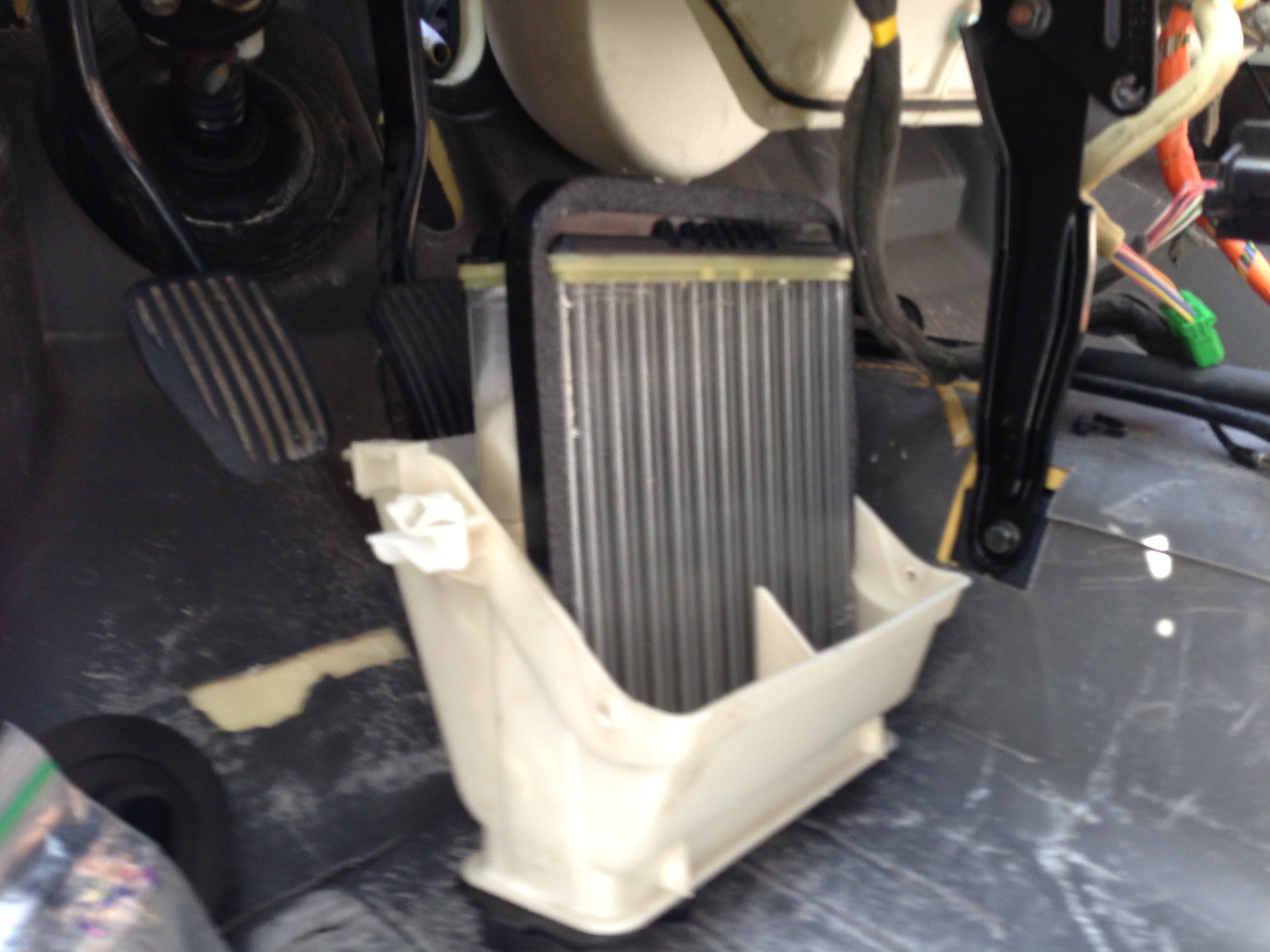

Ready to load heater core
a

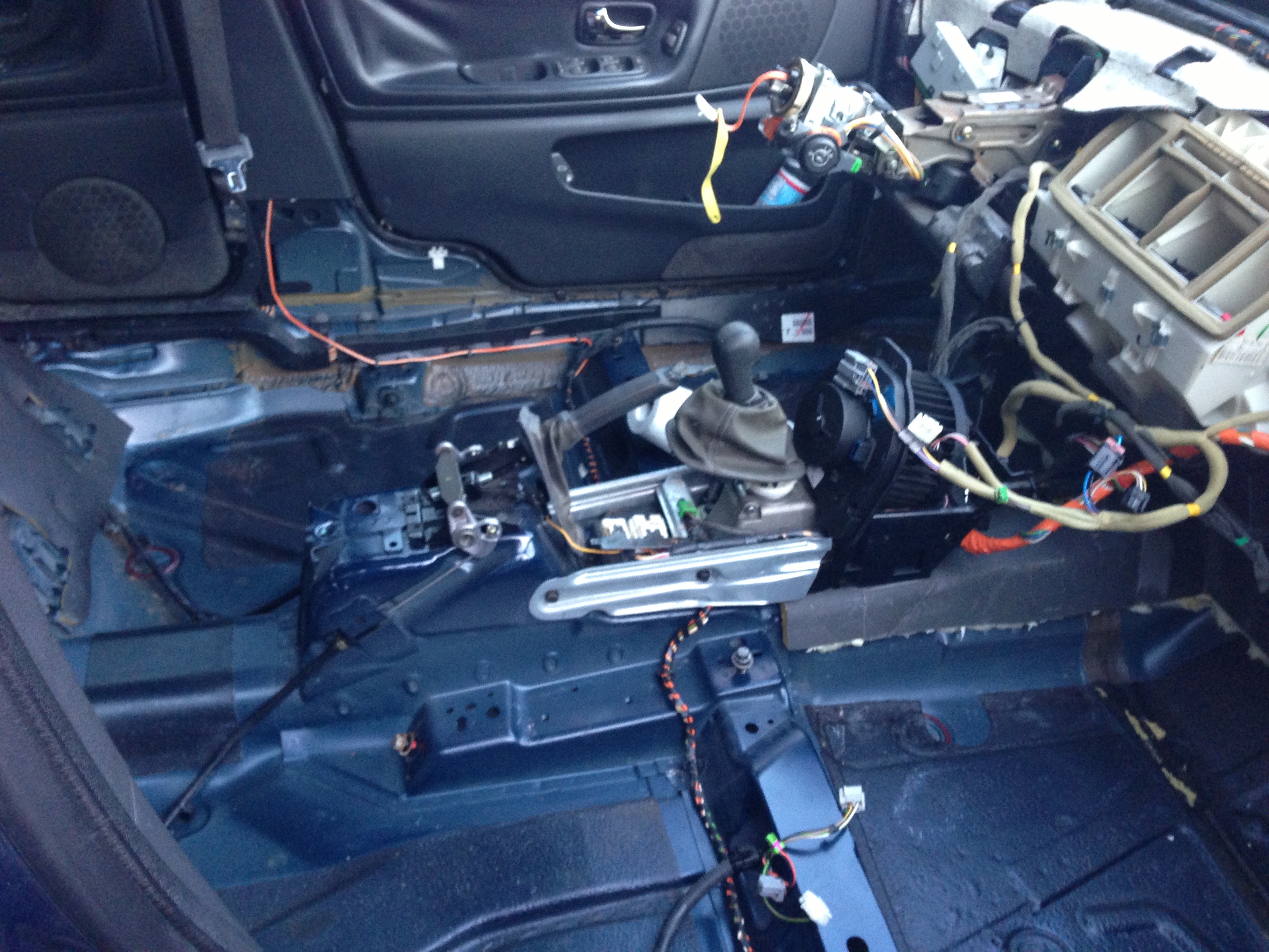

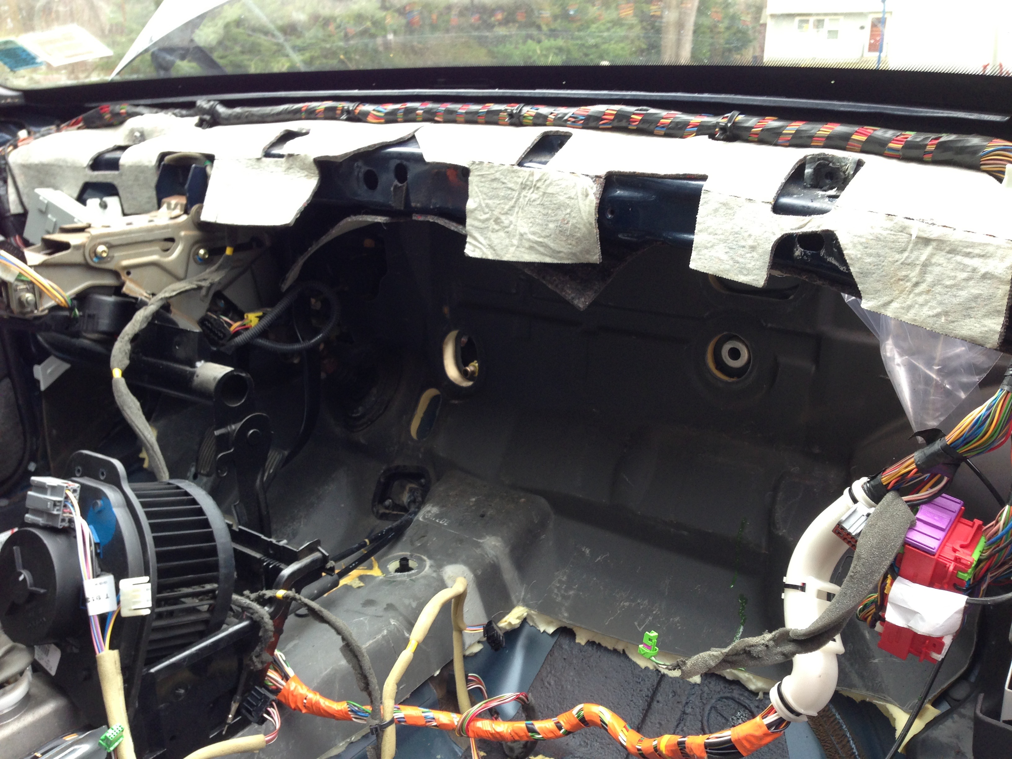

Dash coming out....
Dash coming out....

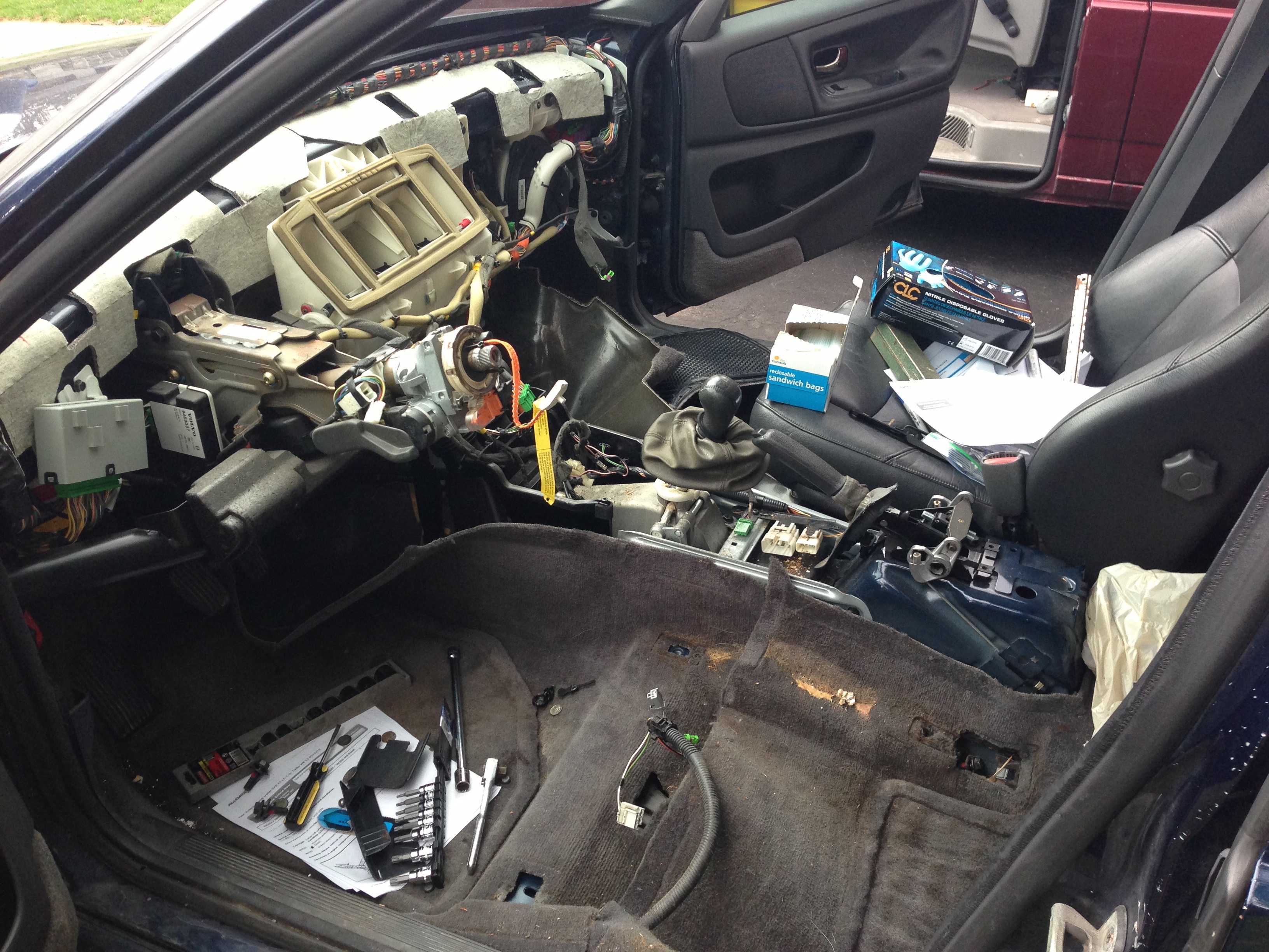

Seats out, console out

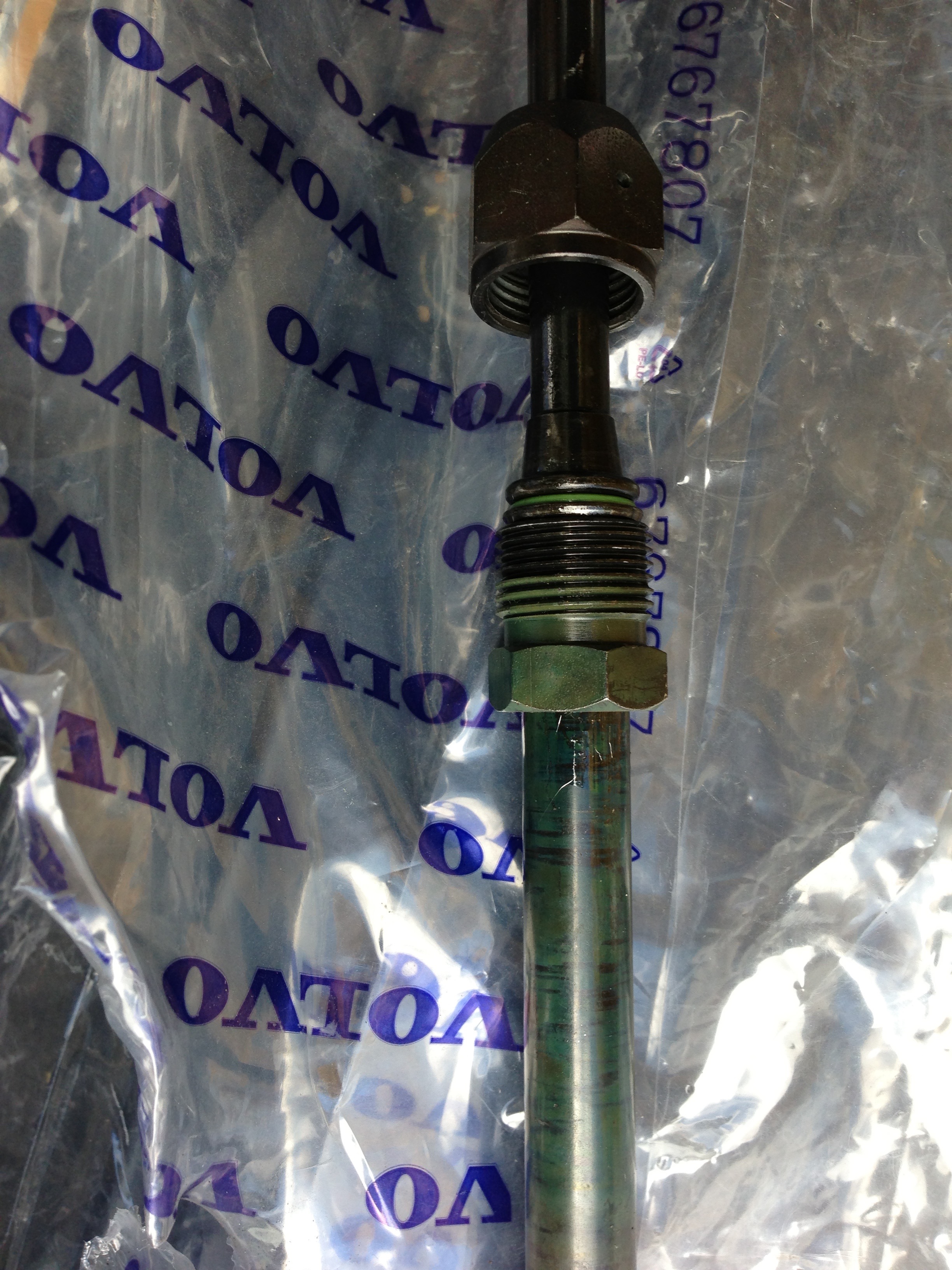

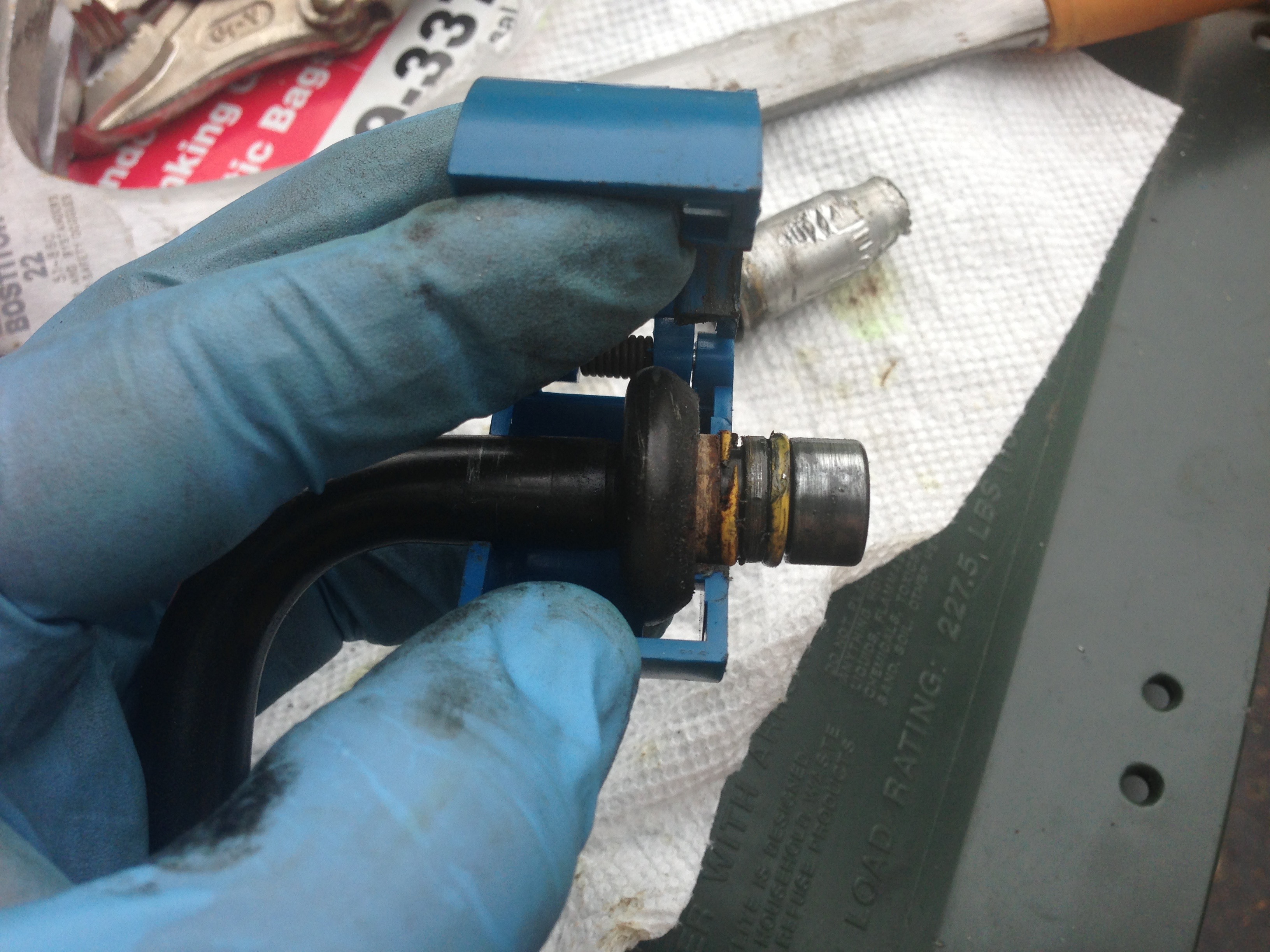

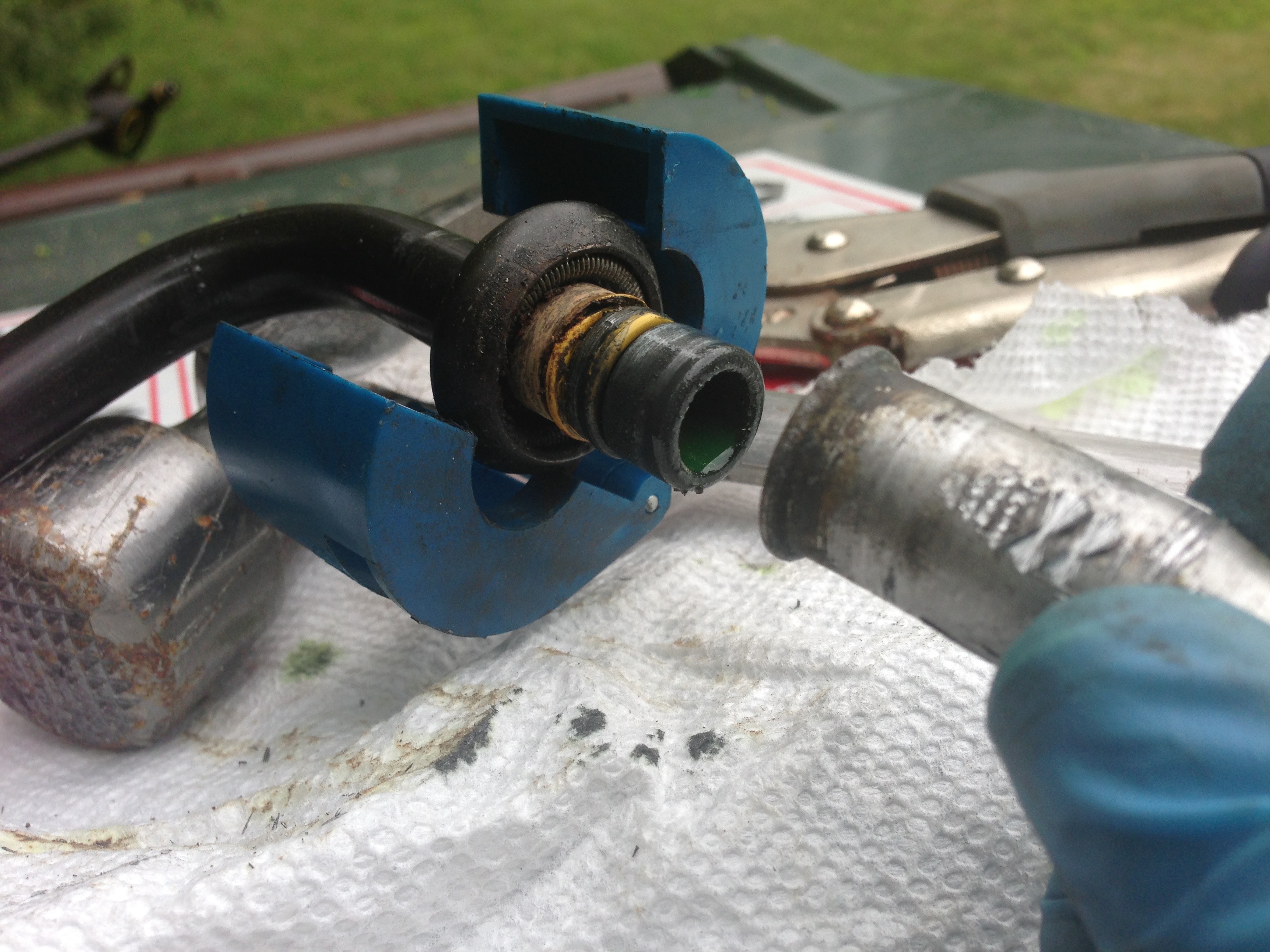

Close up of how the spring/bayonet connections function

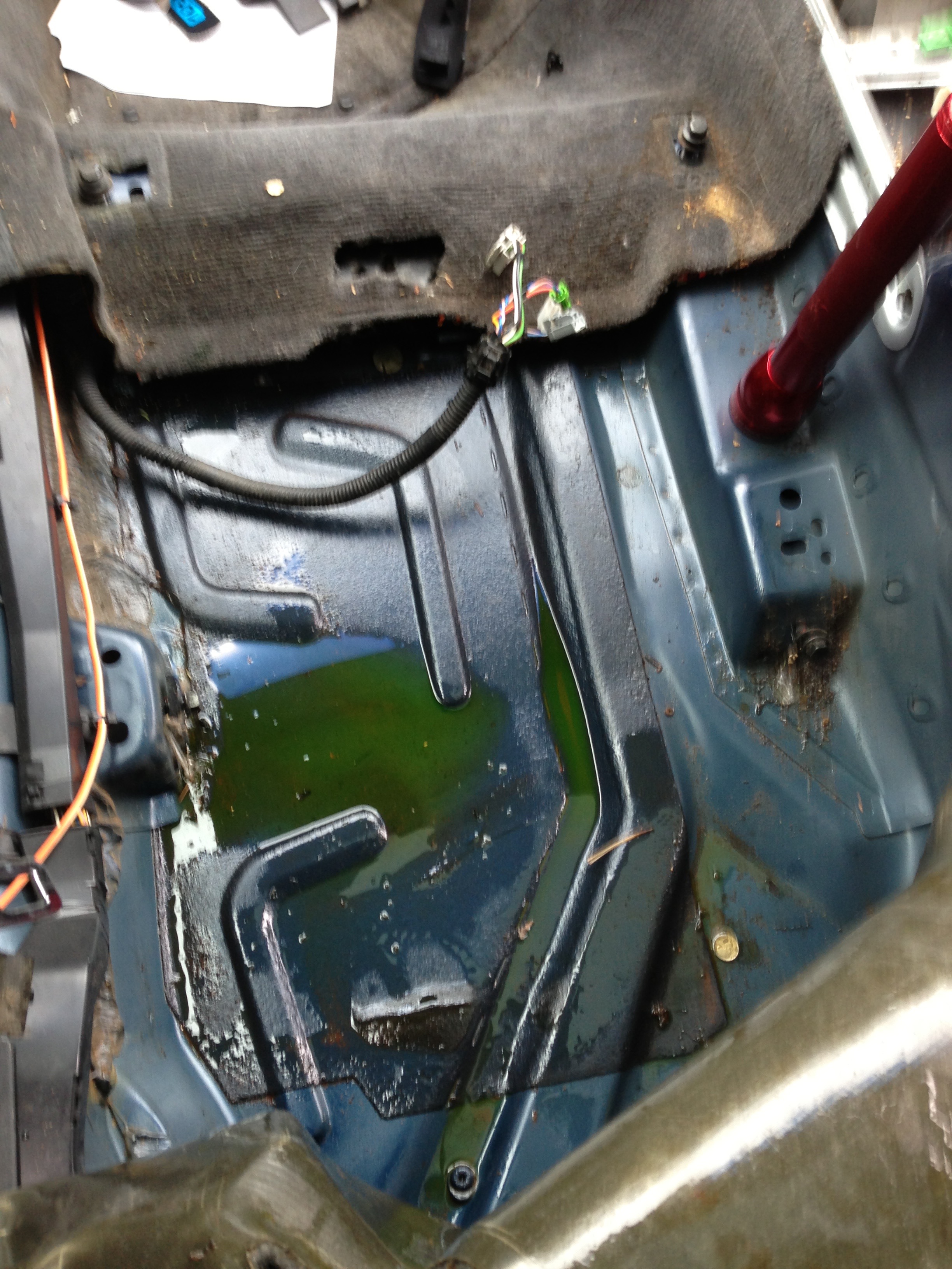

What happened to my car??
About one gallon of coolant removed from rear pass side

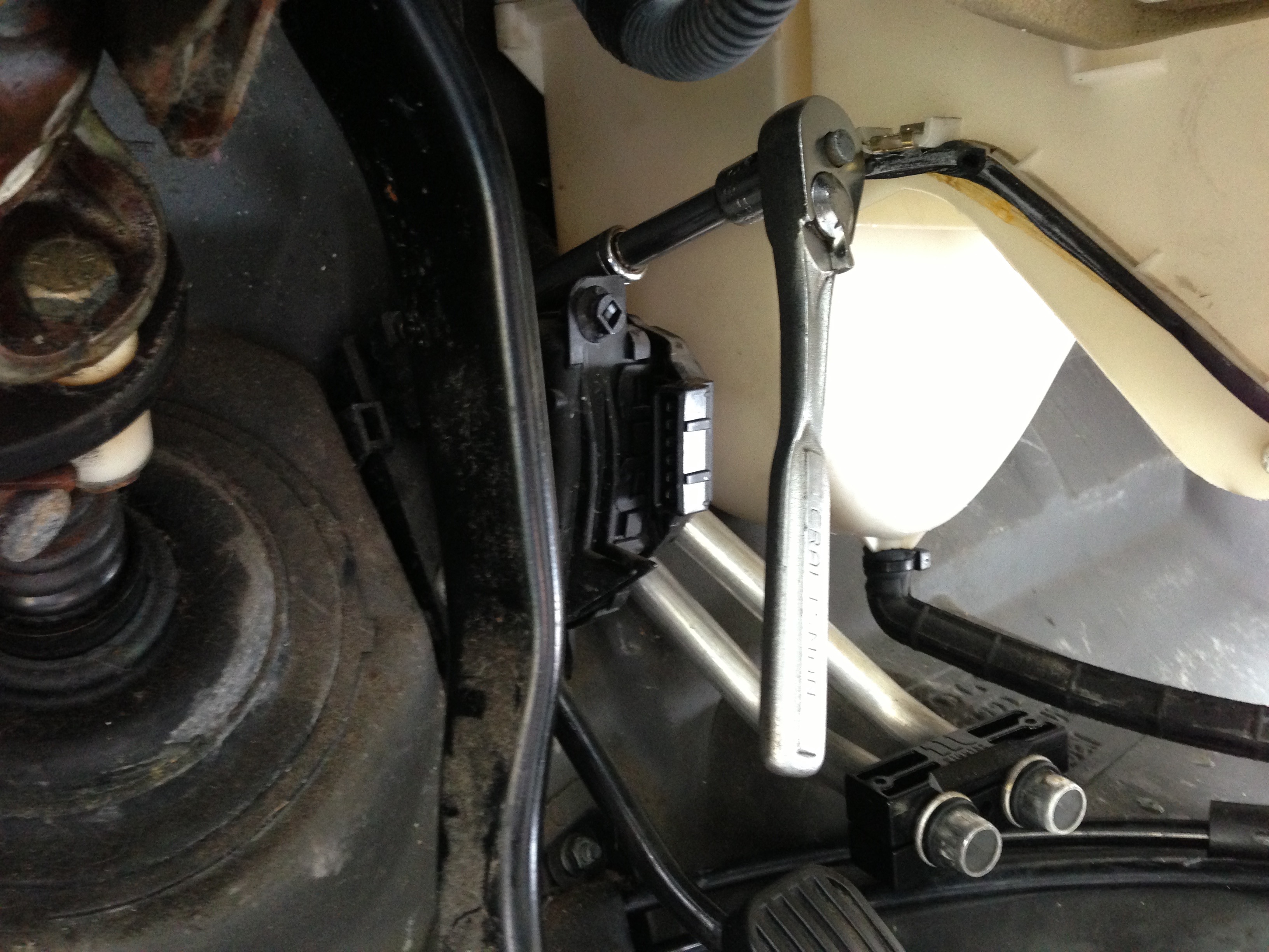

Tight Torx clearance on heater core bulkhead bracket

Removal tool for AC lines - brute force method - NOTE - I am cutting evap, not the expensive AC lines!

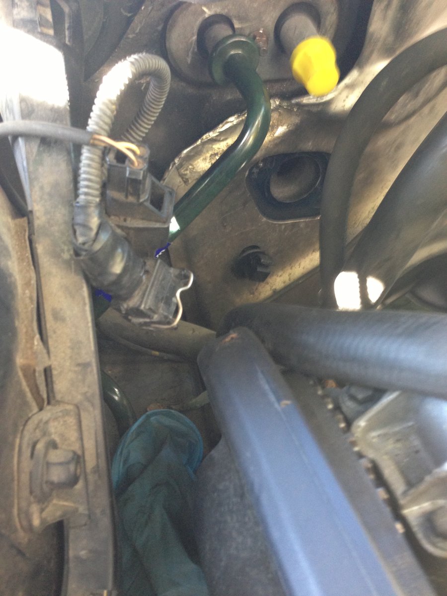

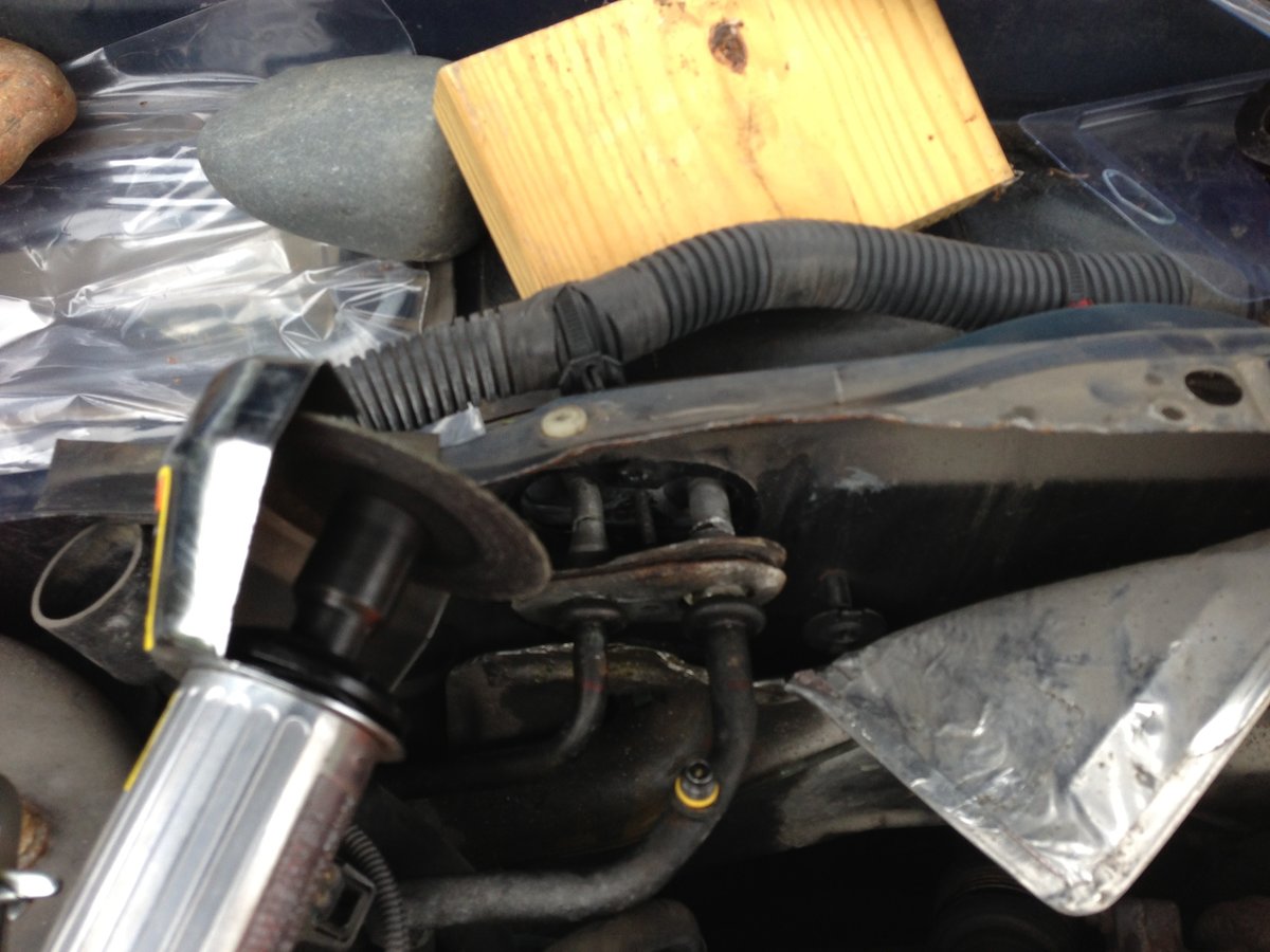

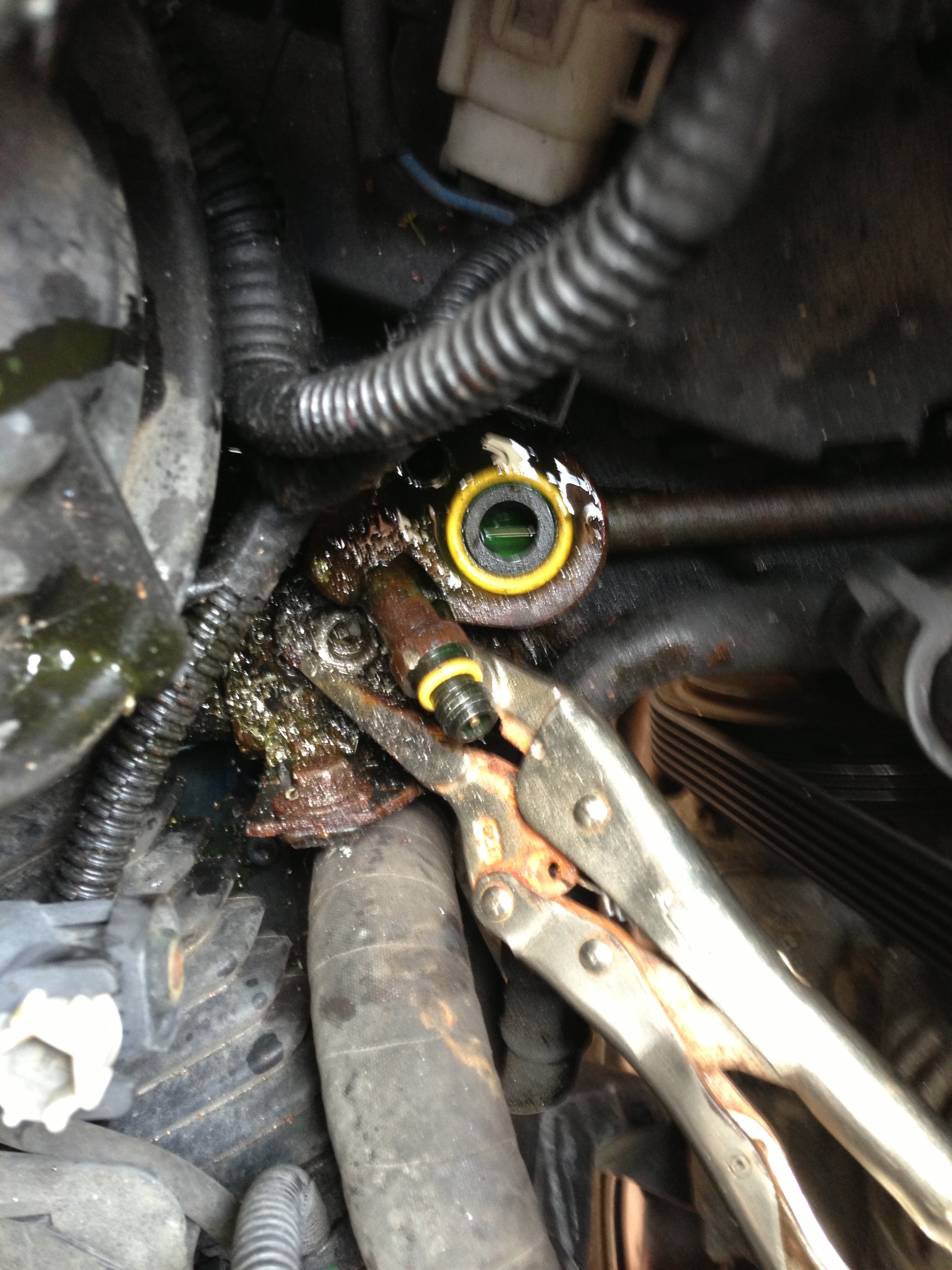

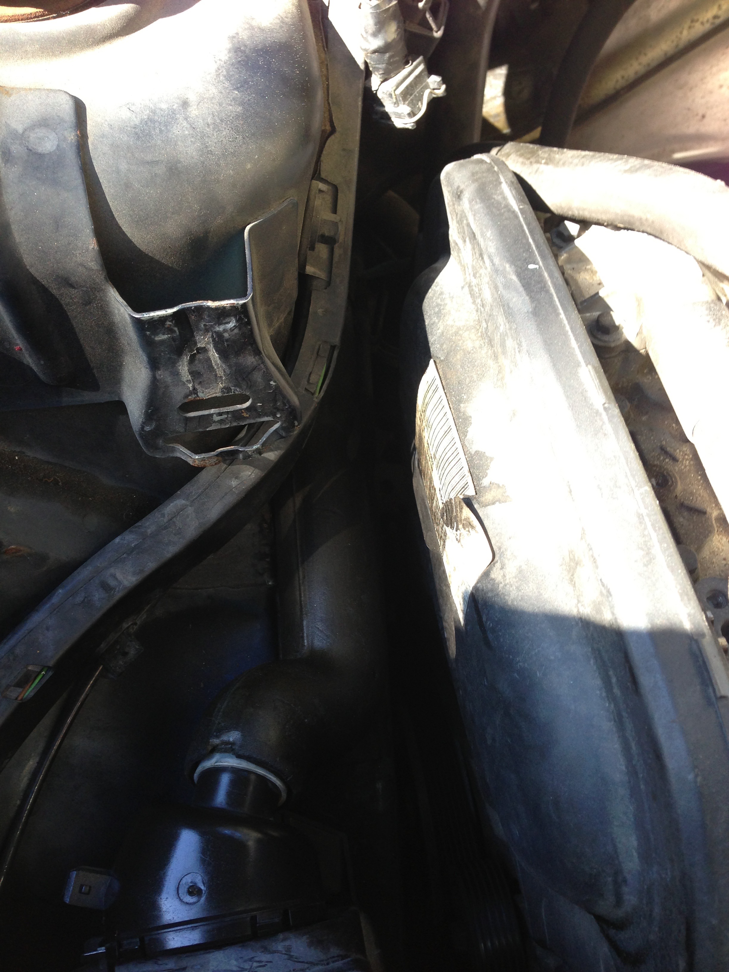

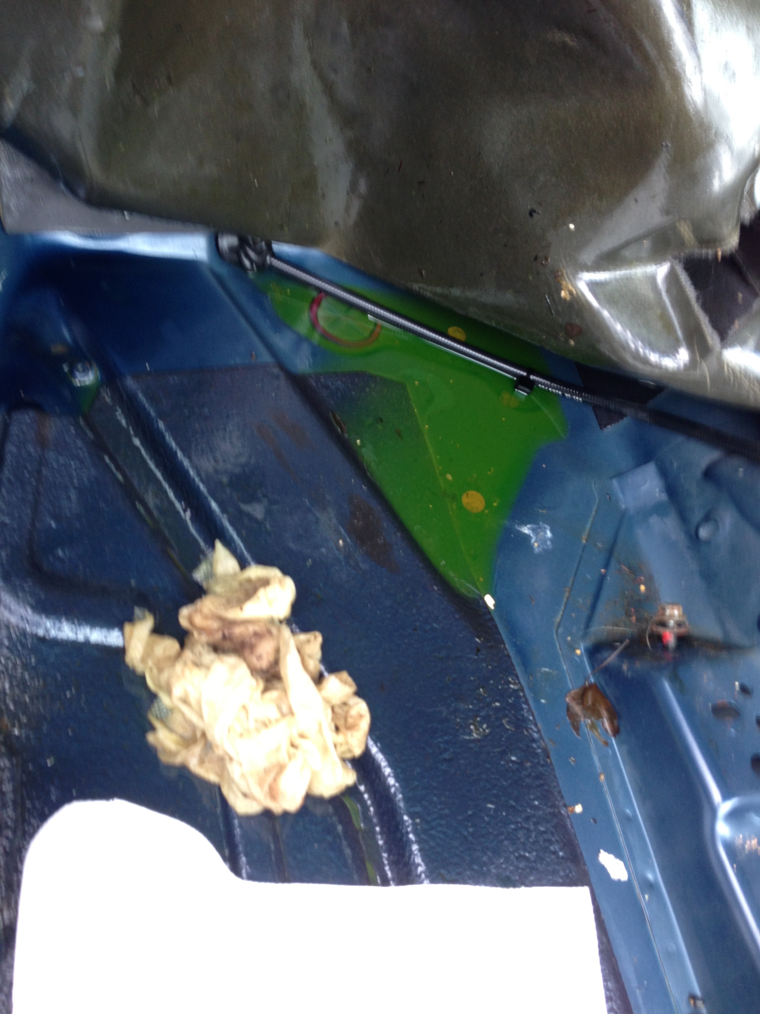

Ugly mess. The captive M6 in the frame member broke free, so I had to drill out the M6 to release the receiver. Chances of getting an old receiver out of car in place - near 0.

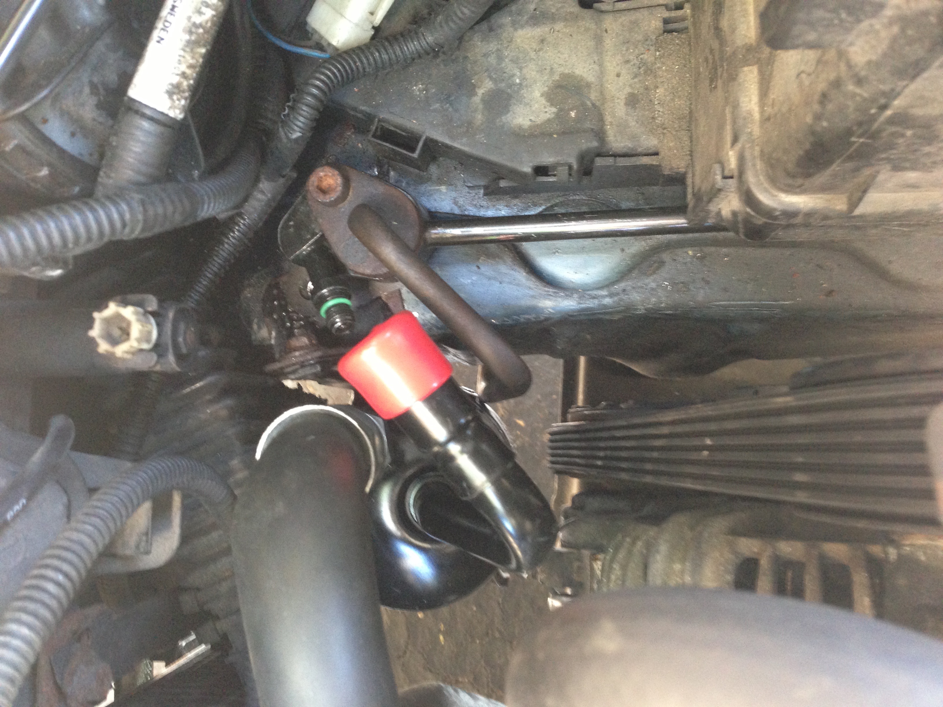

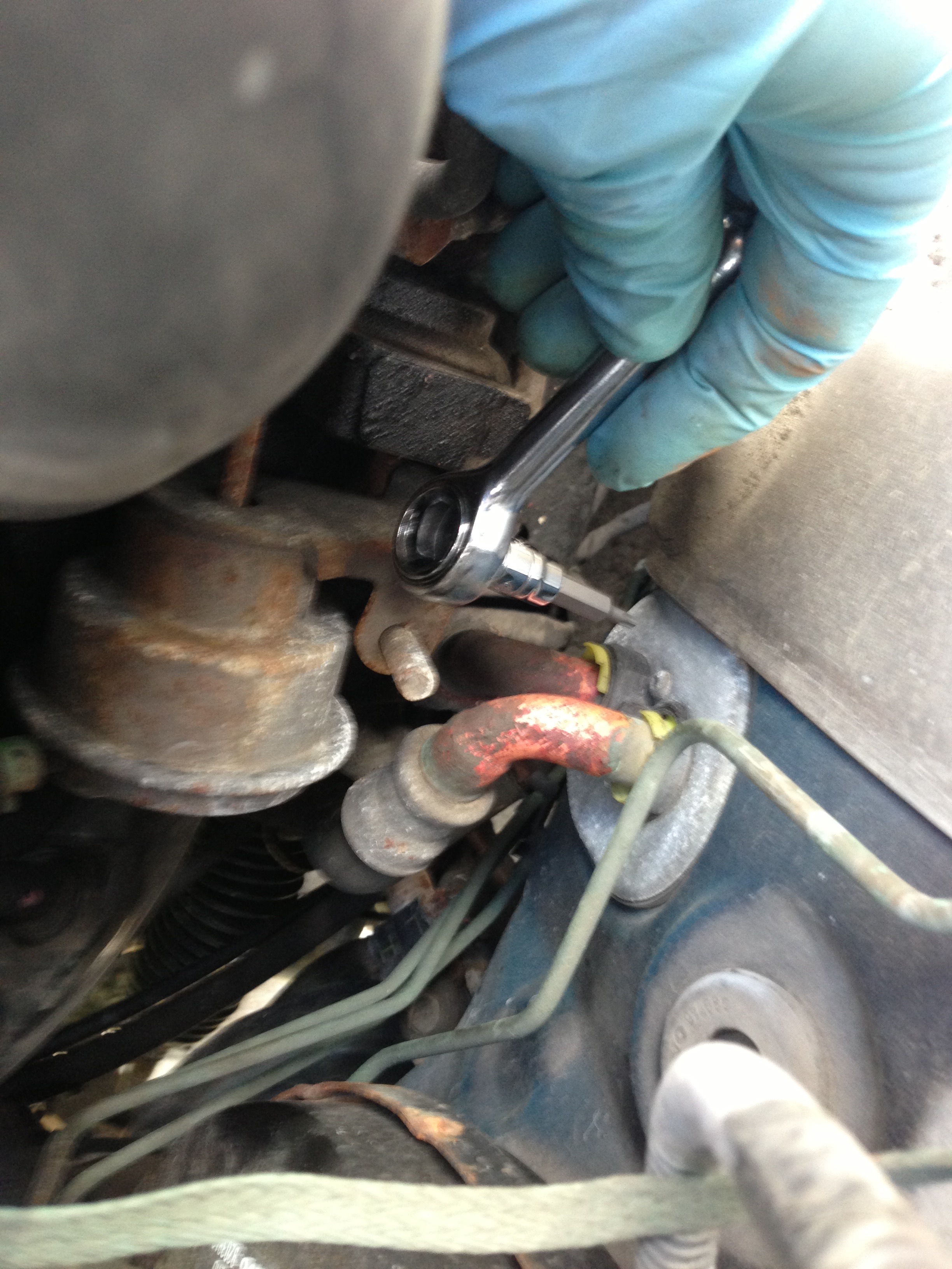

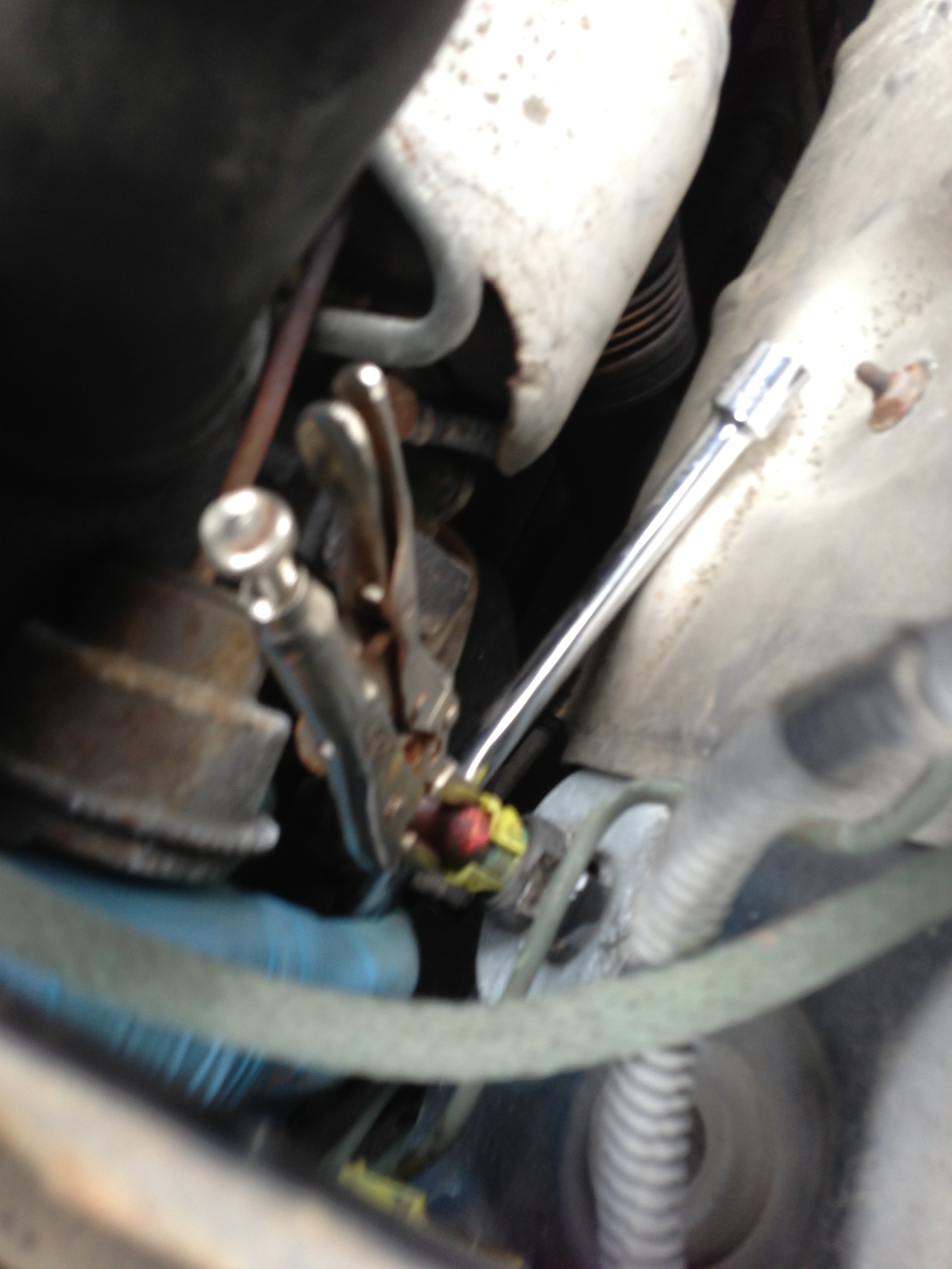

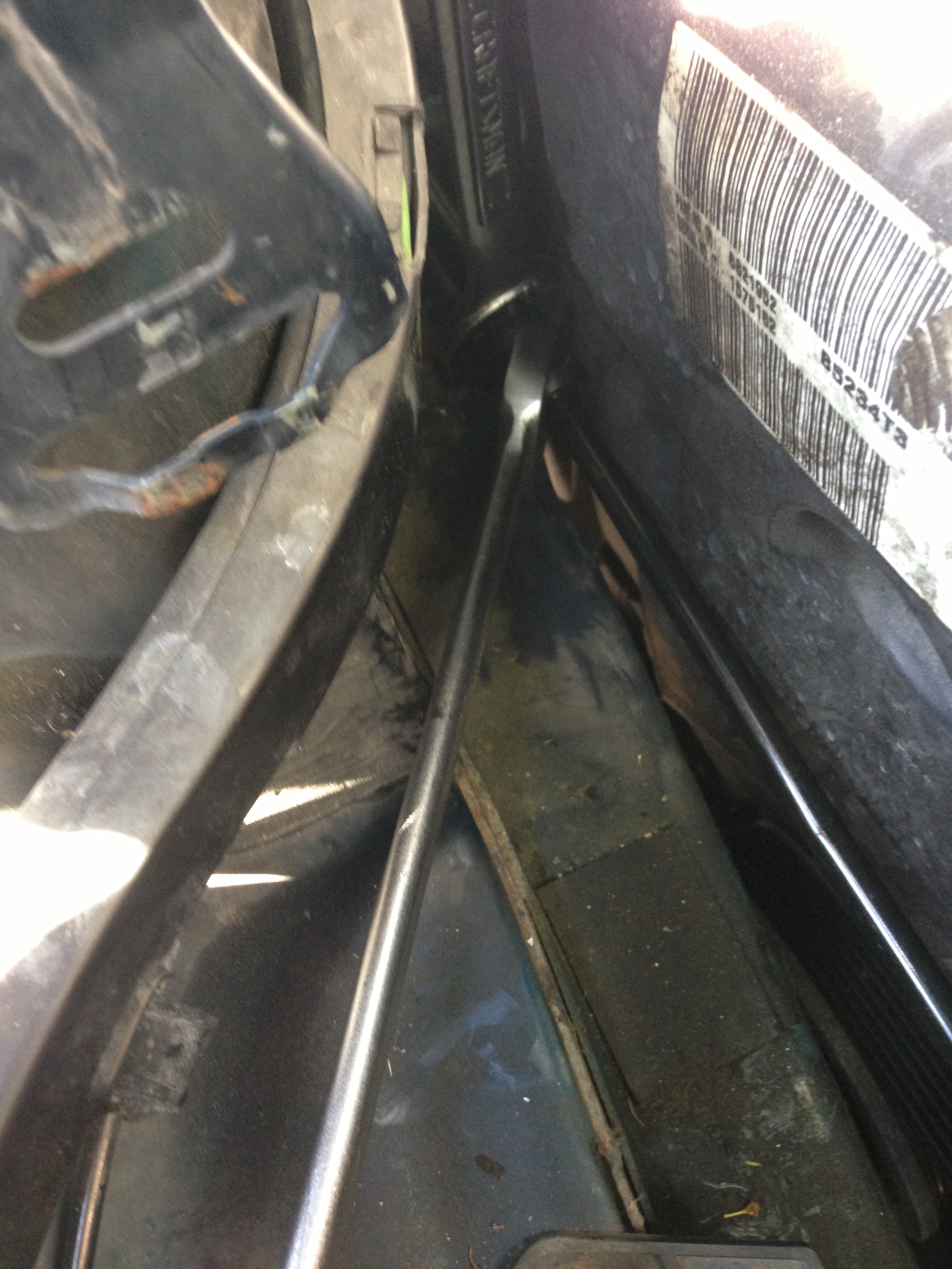

You can crack compressor lines with it in place with long extensions working from Driver Side, as pictured. The hand points to the fastener being removed

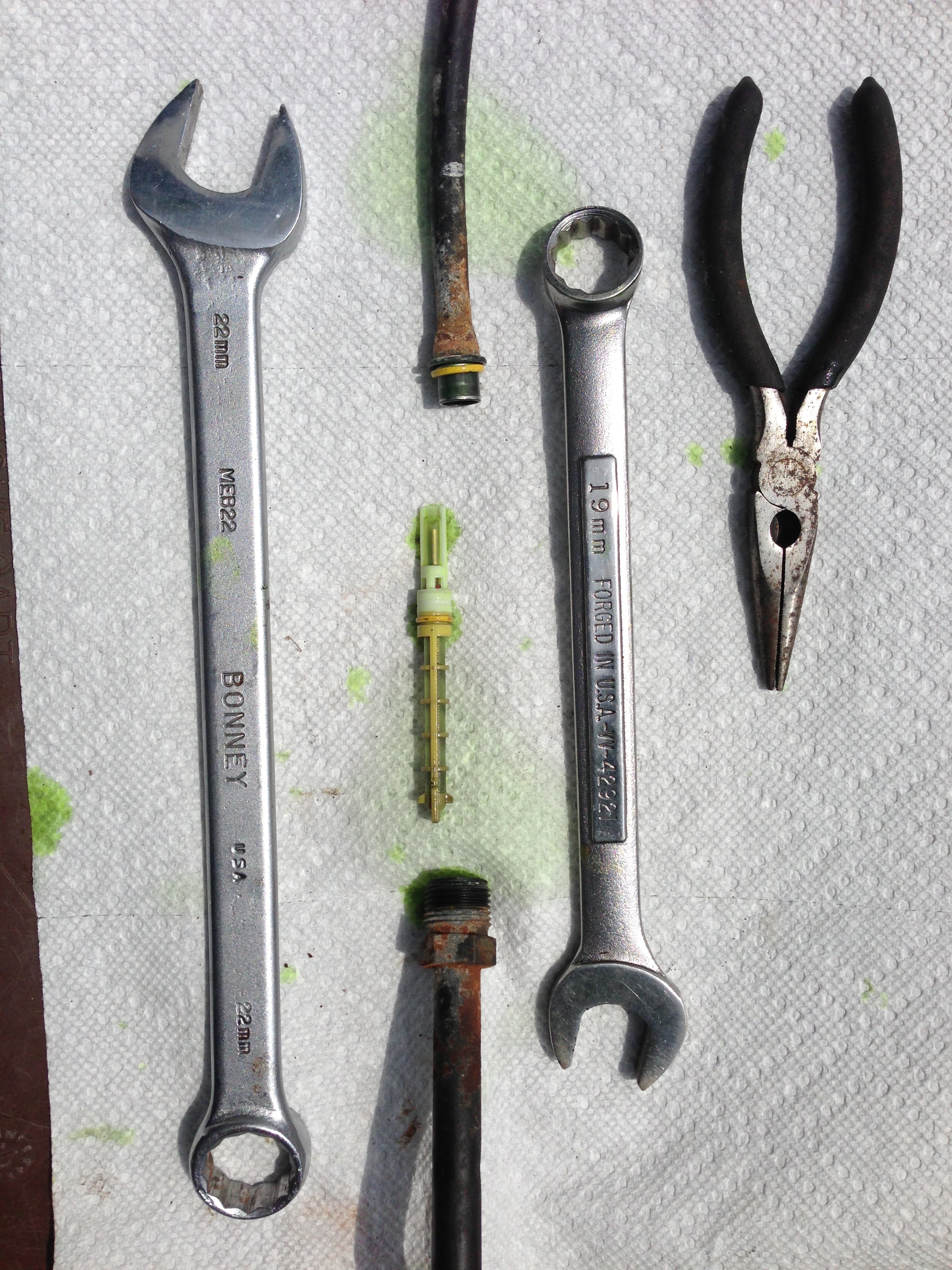

Tools to split office line and office part itself

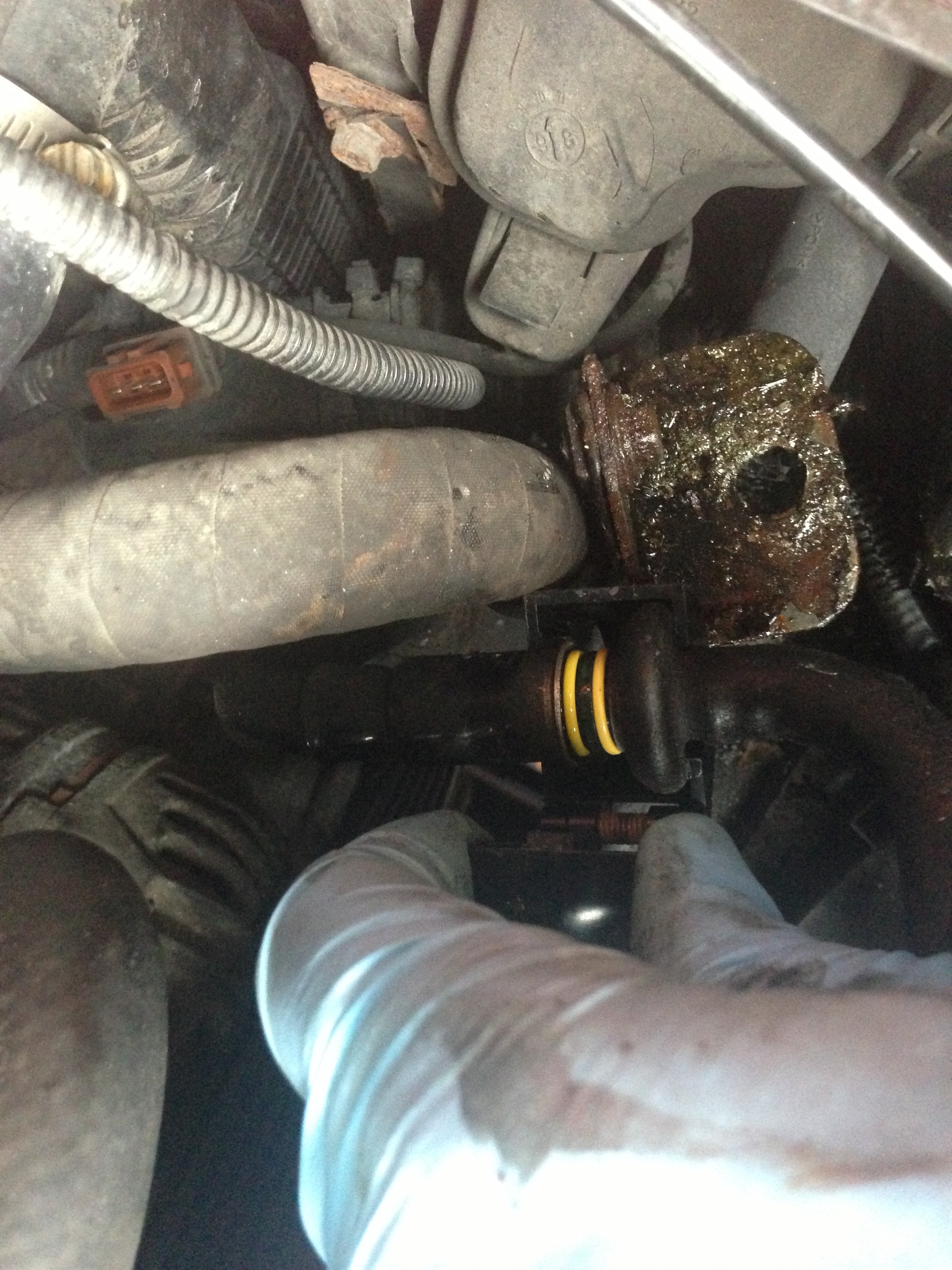

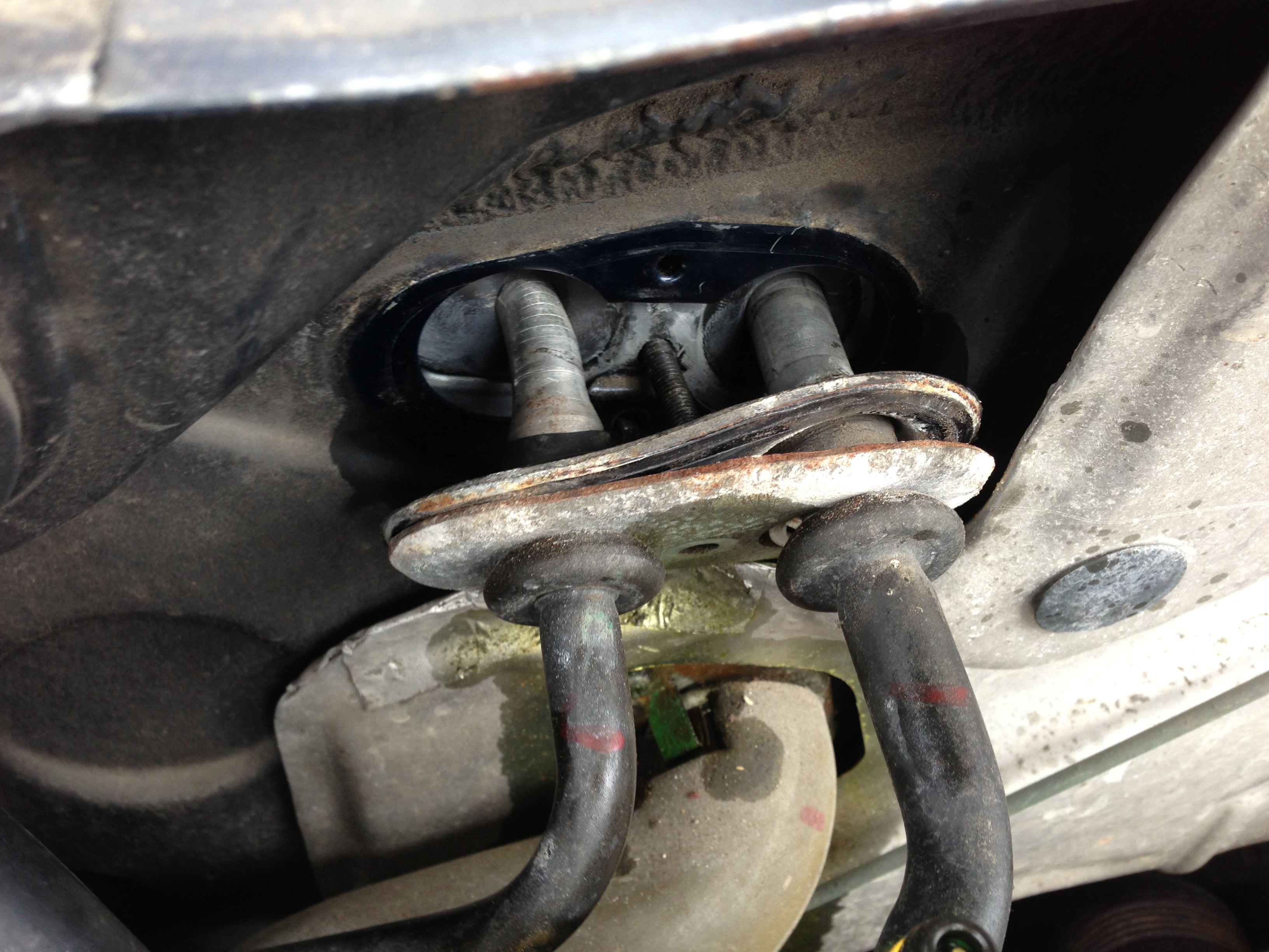

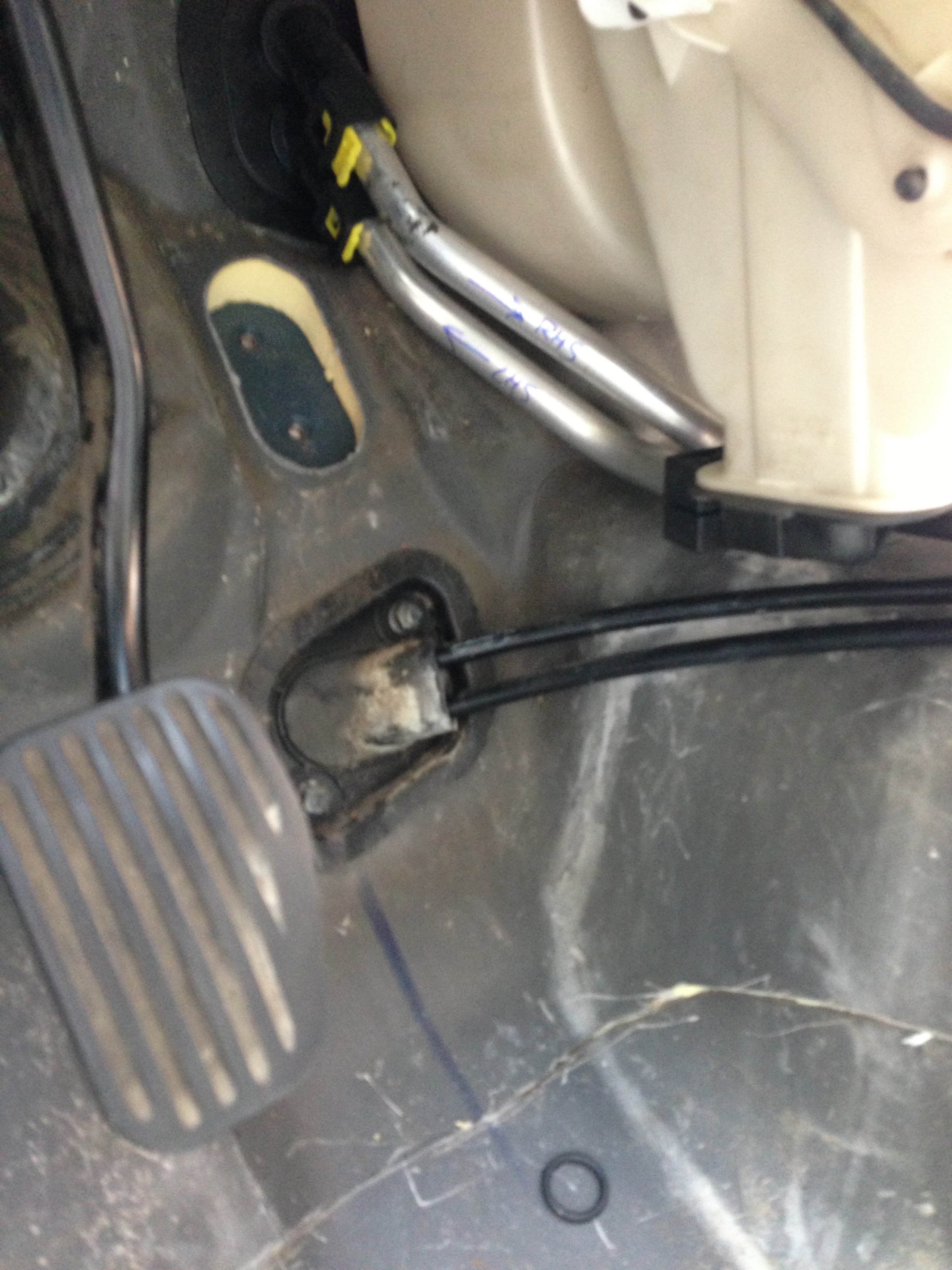

Tension method to remove old heater hoses
You will have to gently bend the hoses to duplicate position - note retainer plastic which holds position

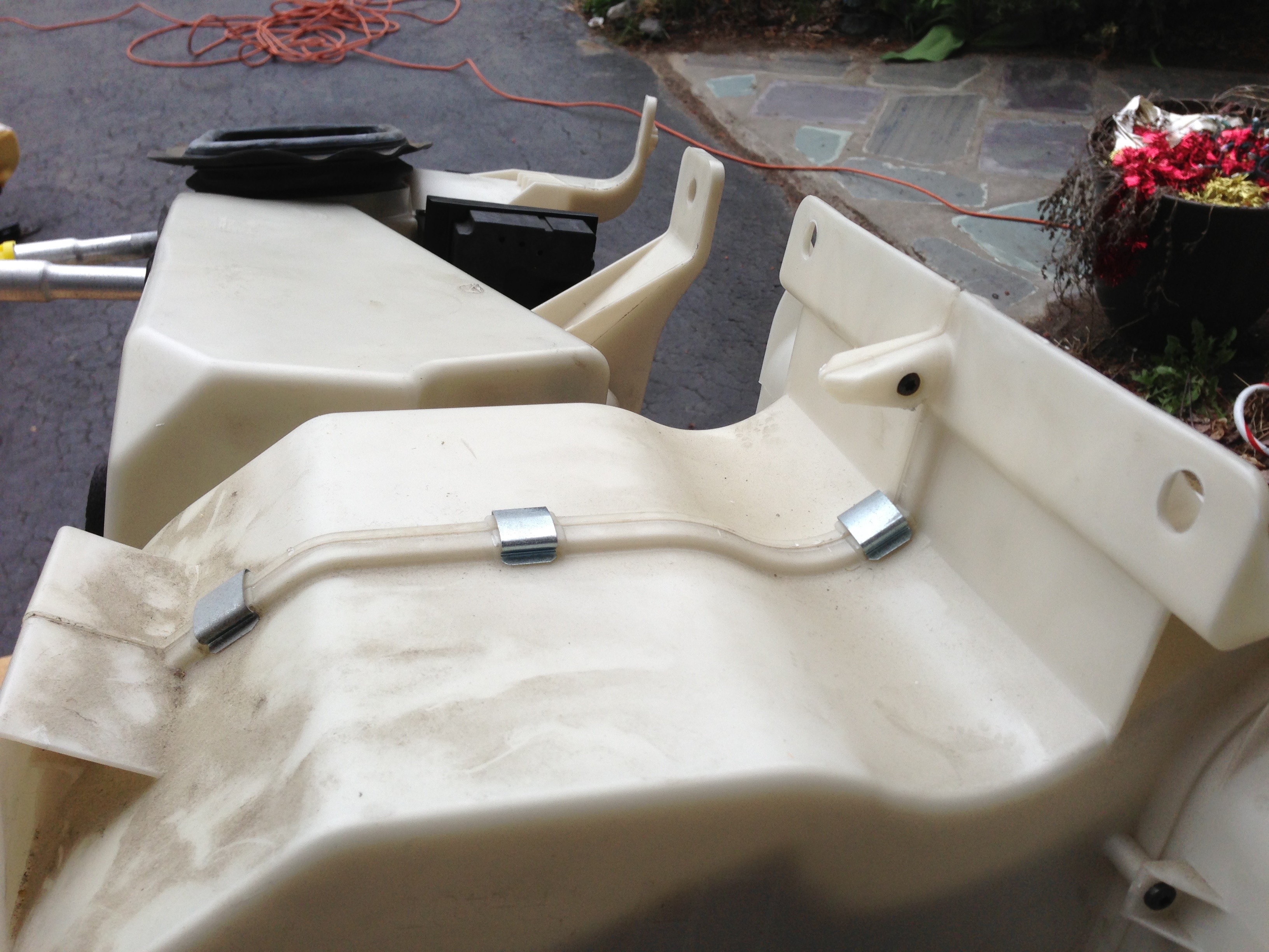

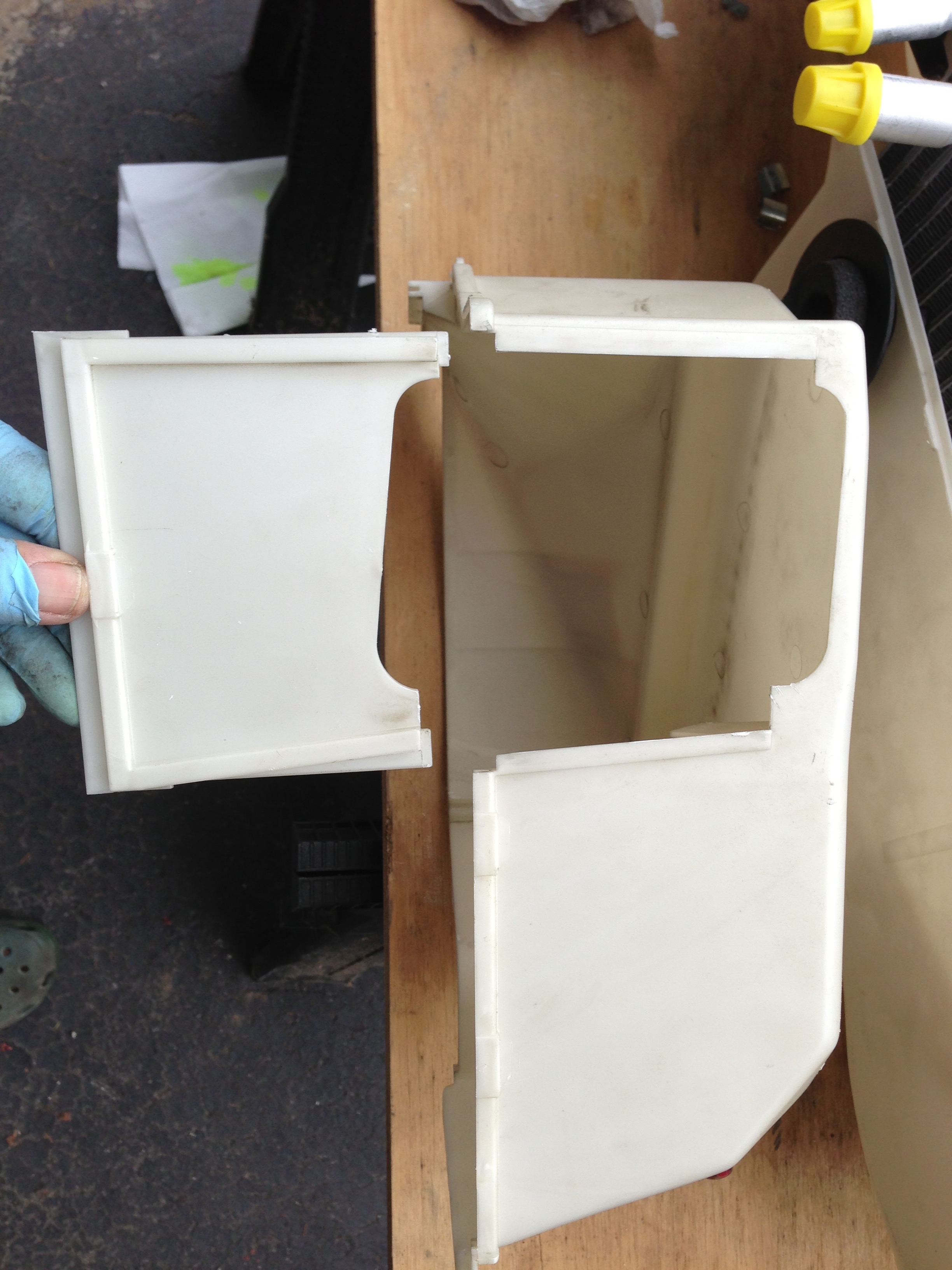

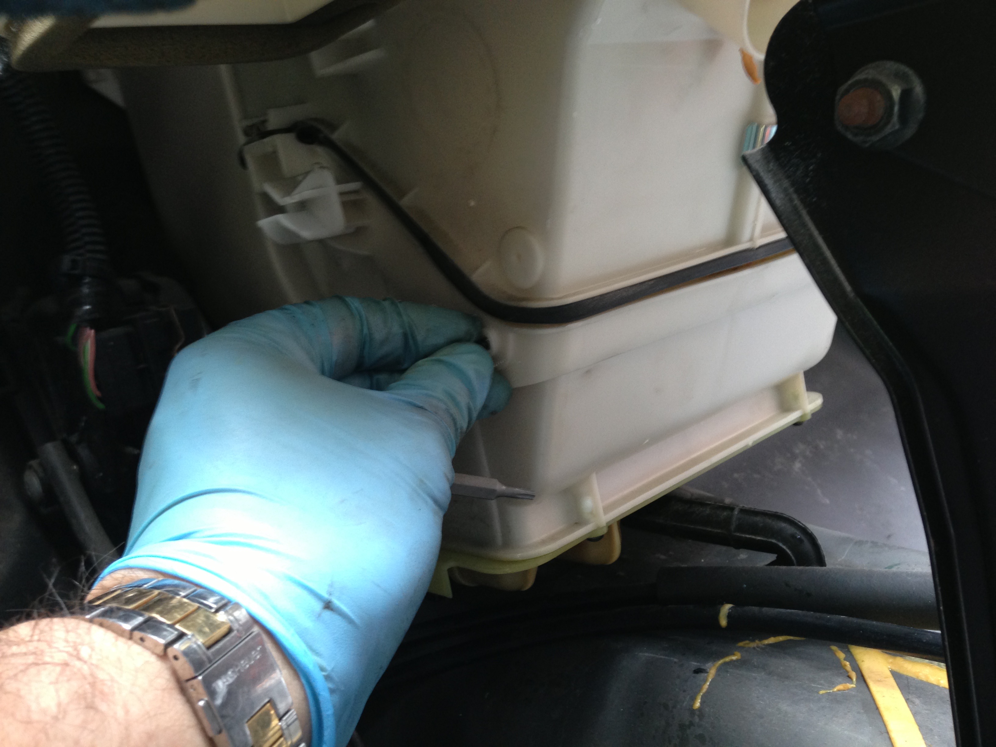

Cut out door on HVAC

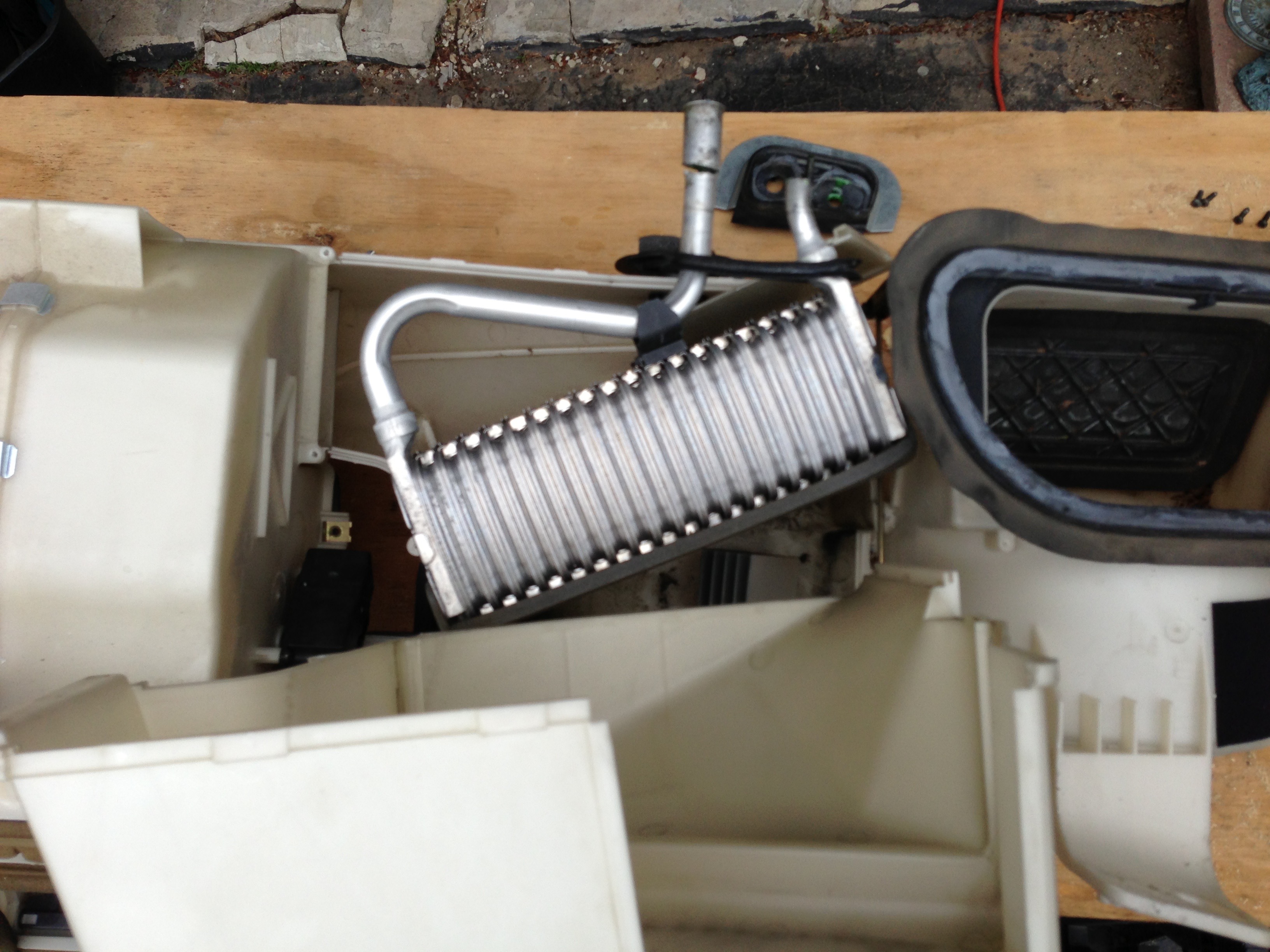

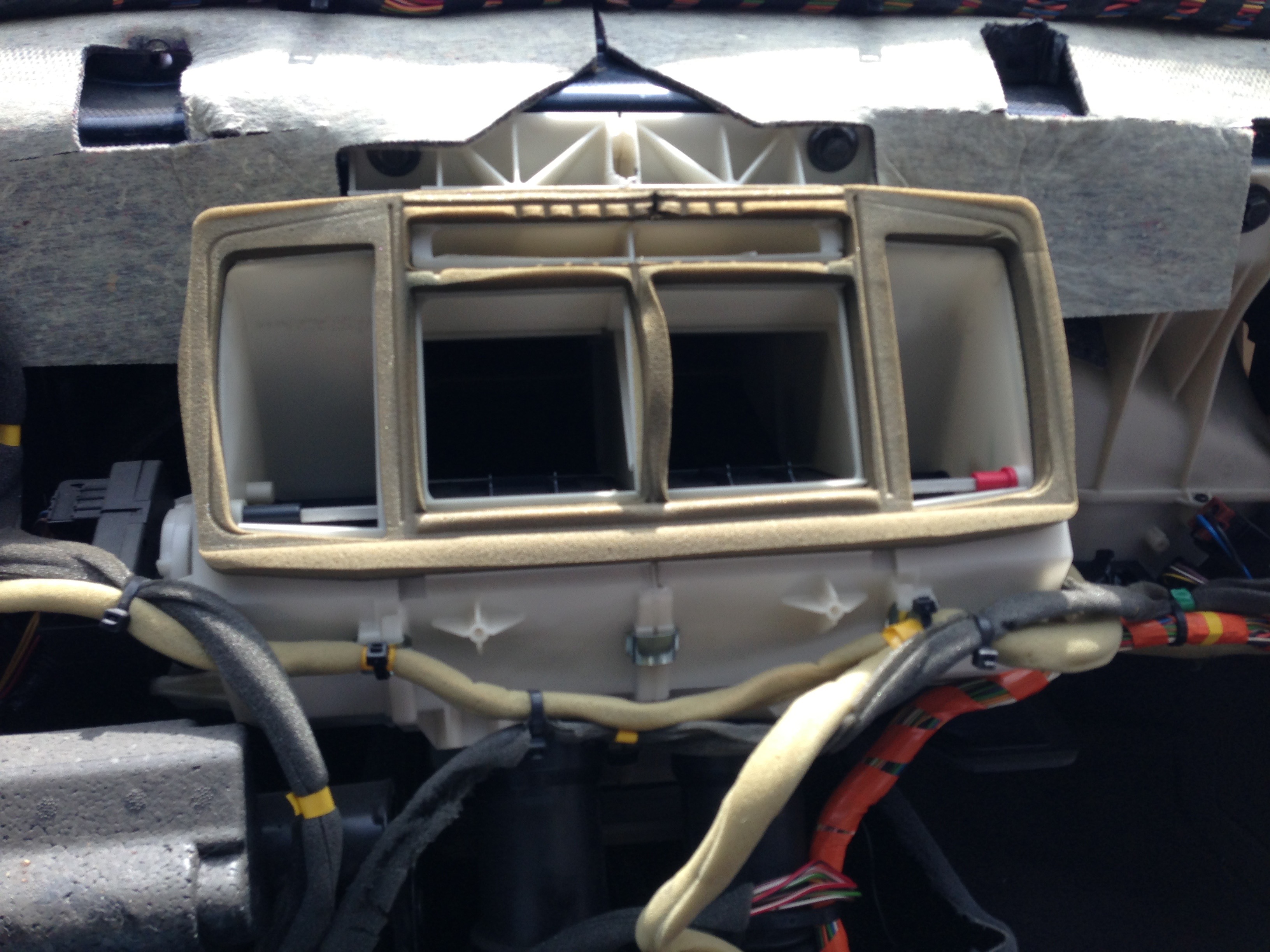

EVAP HVAC
EVAP HVAC

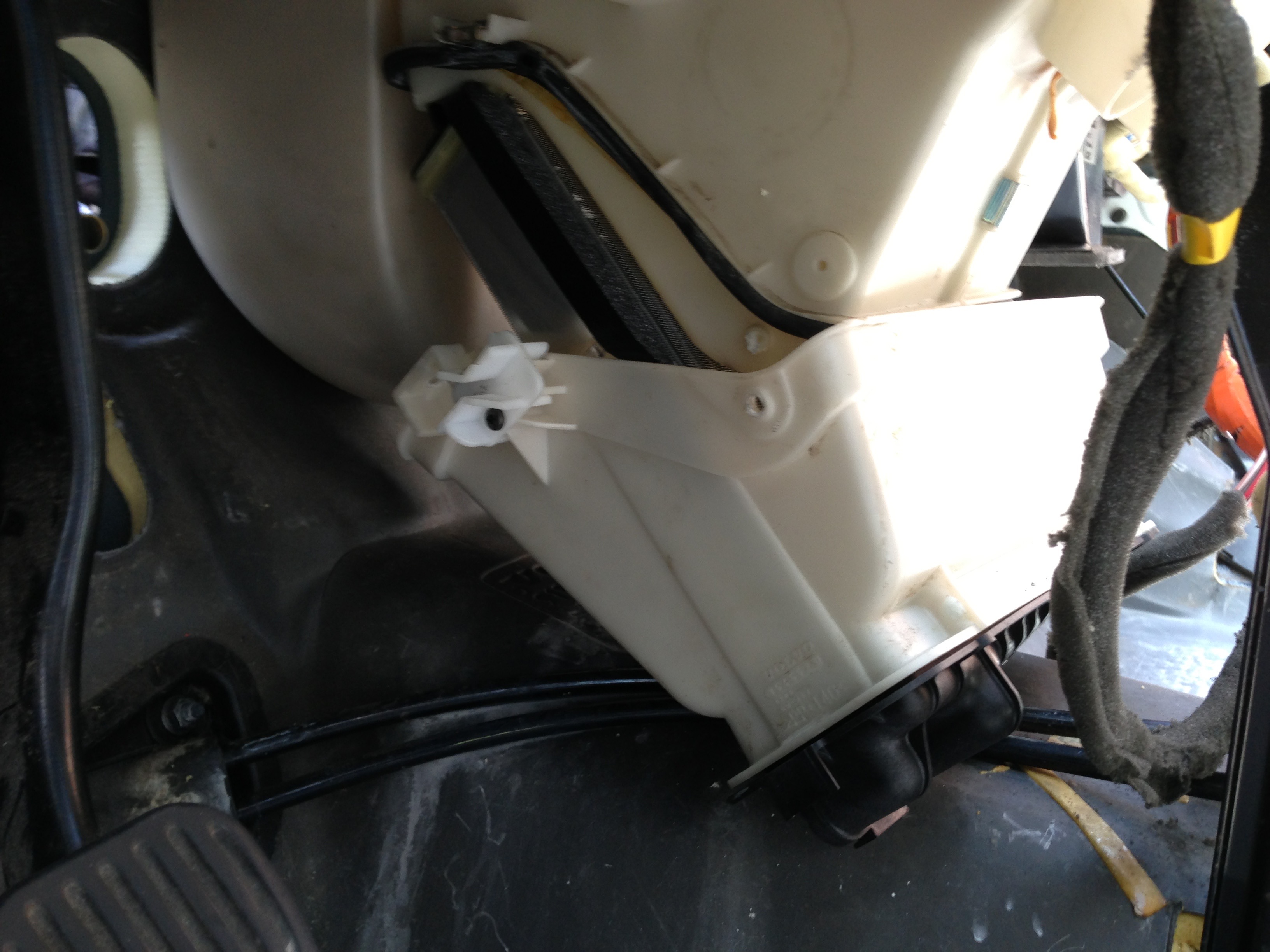

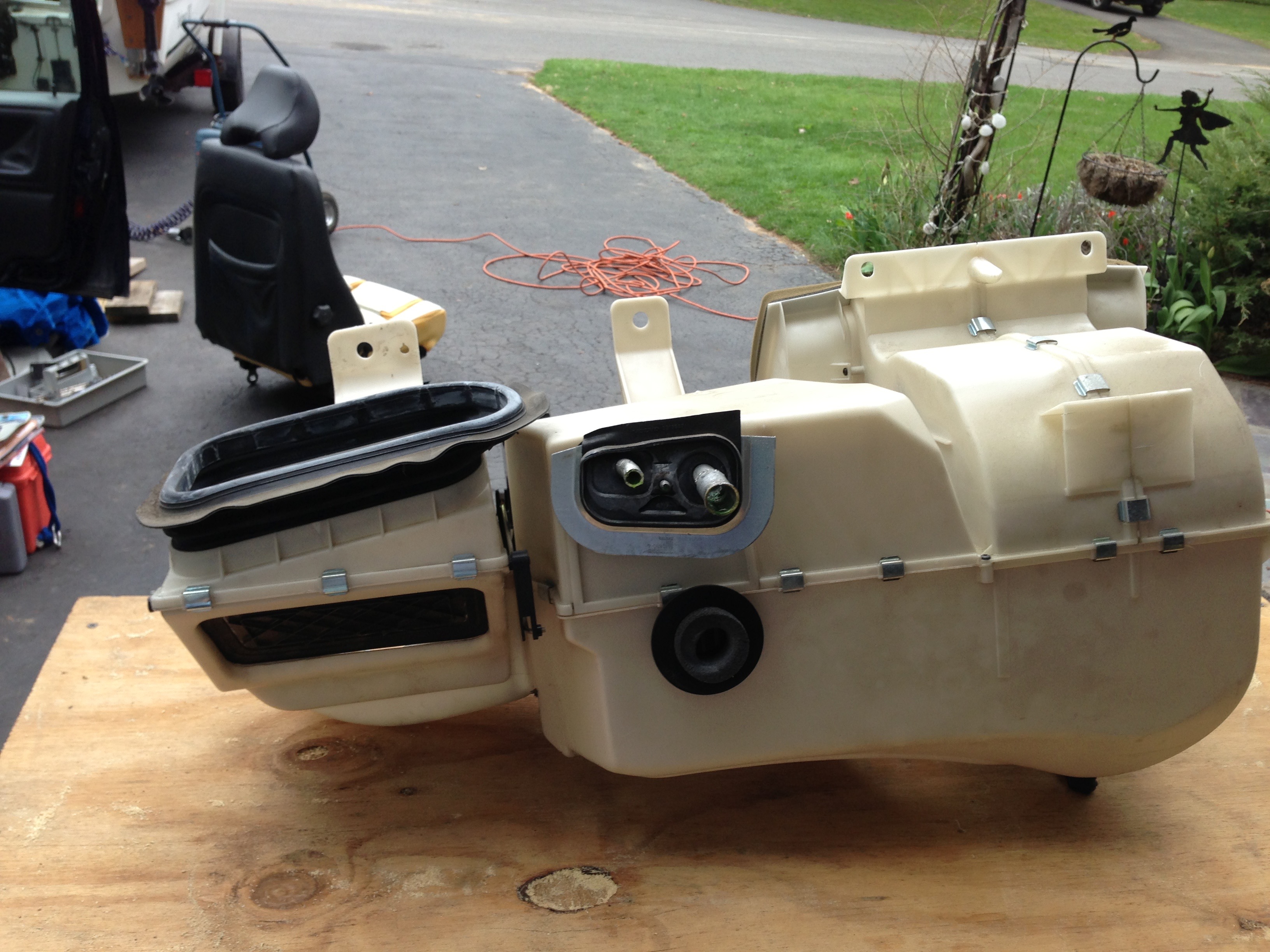

HVAC unit, removed
HVAC unit, removed

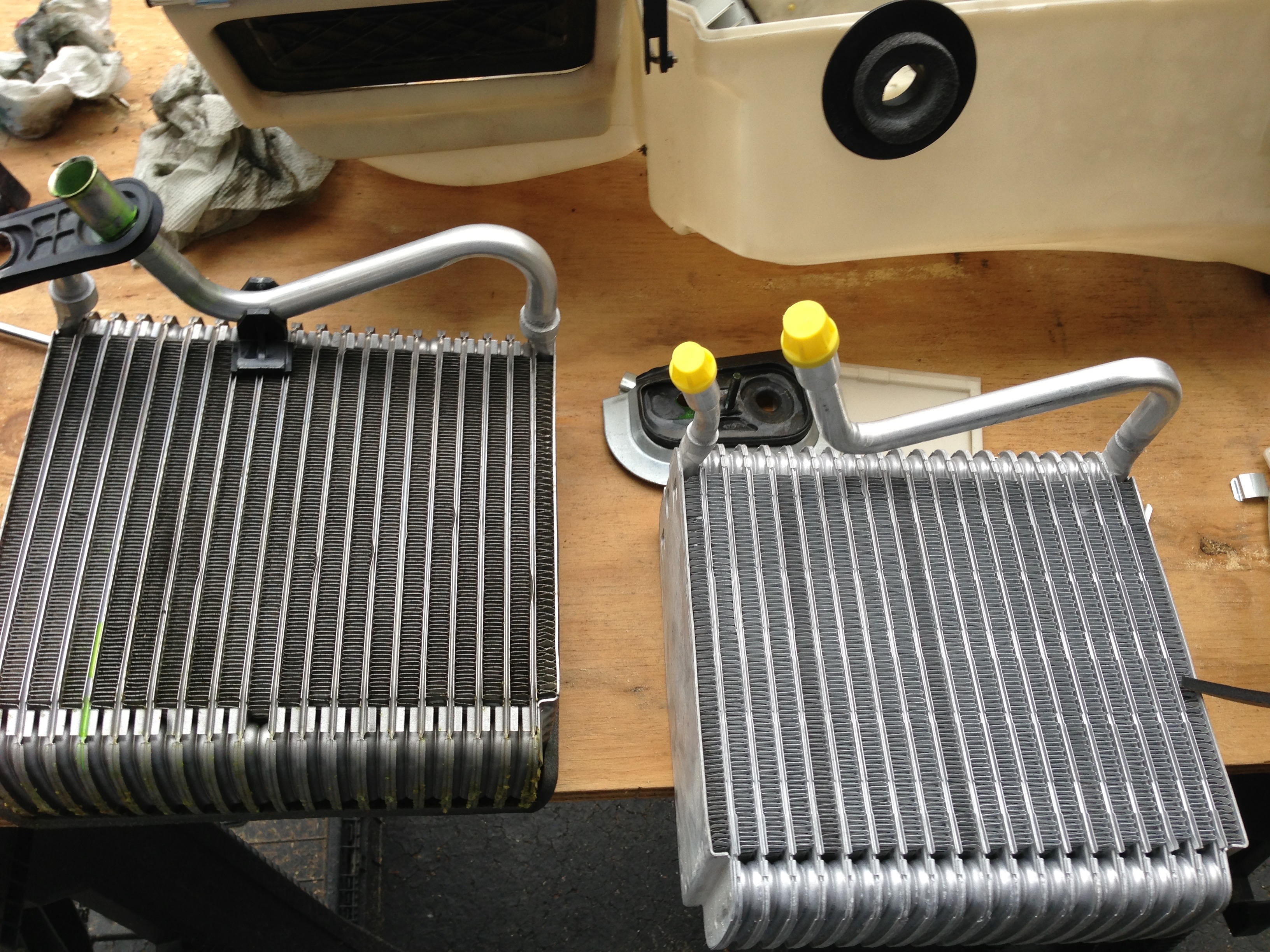

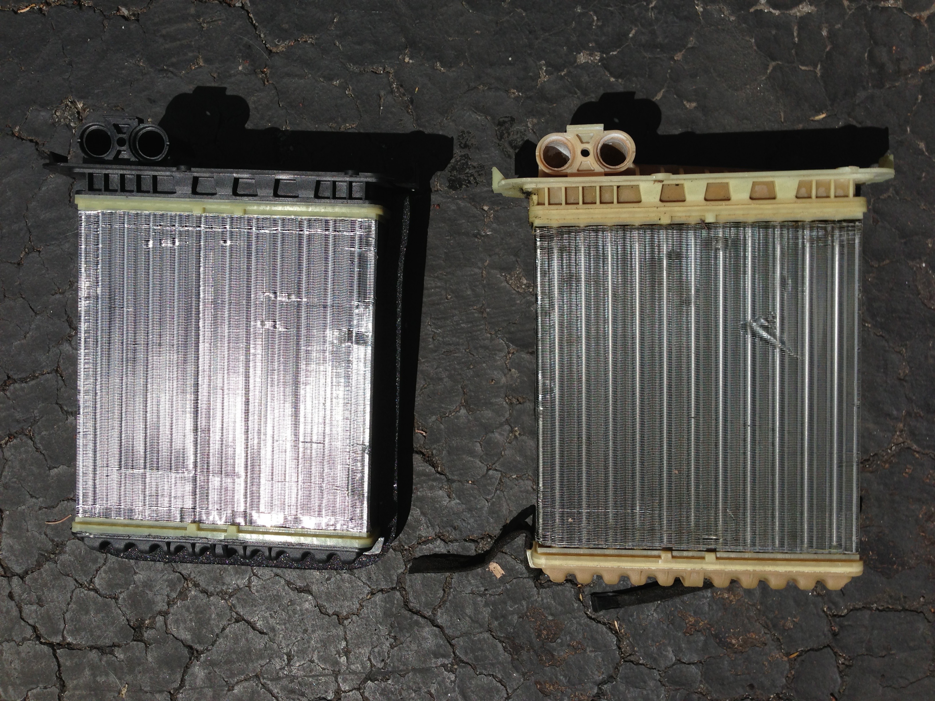

new and old Heater core

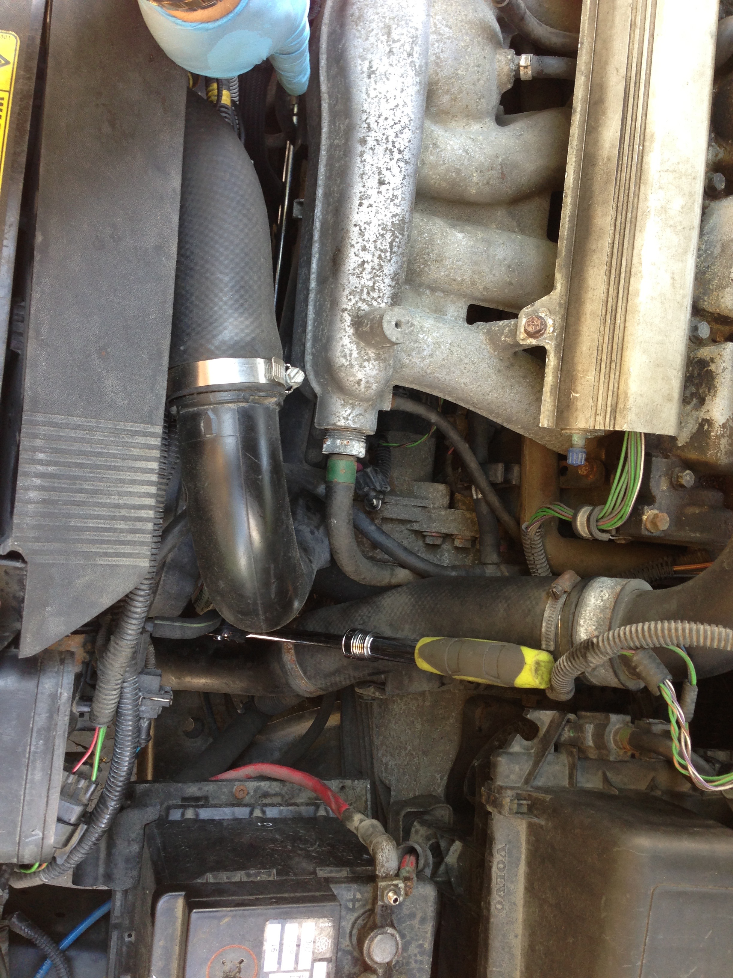

You can just snark this off in place (right in front of timing cover with two large open end wrenches
Close up on old EVAP installed in HVAC, before closing
Heater core goiing in

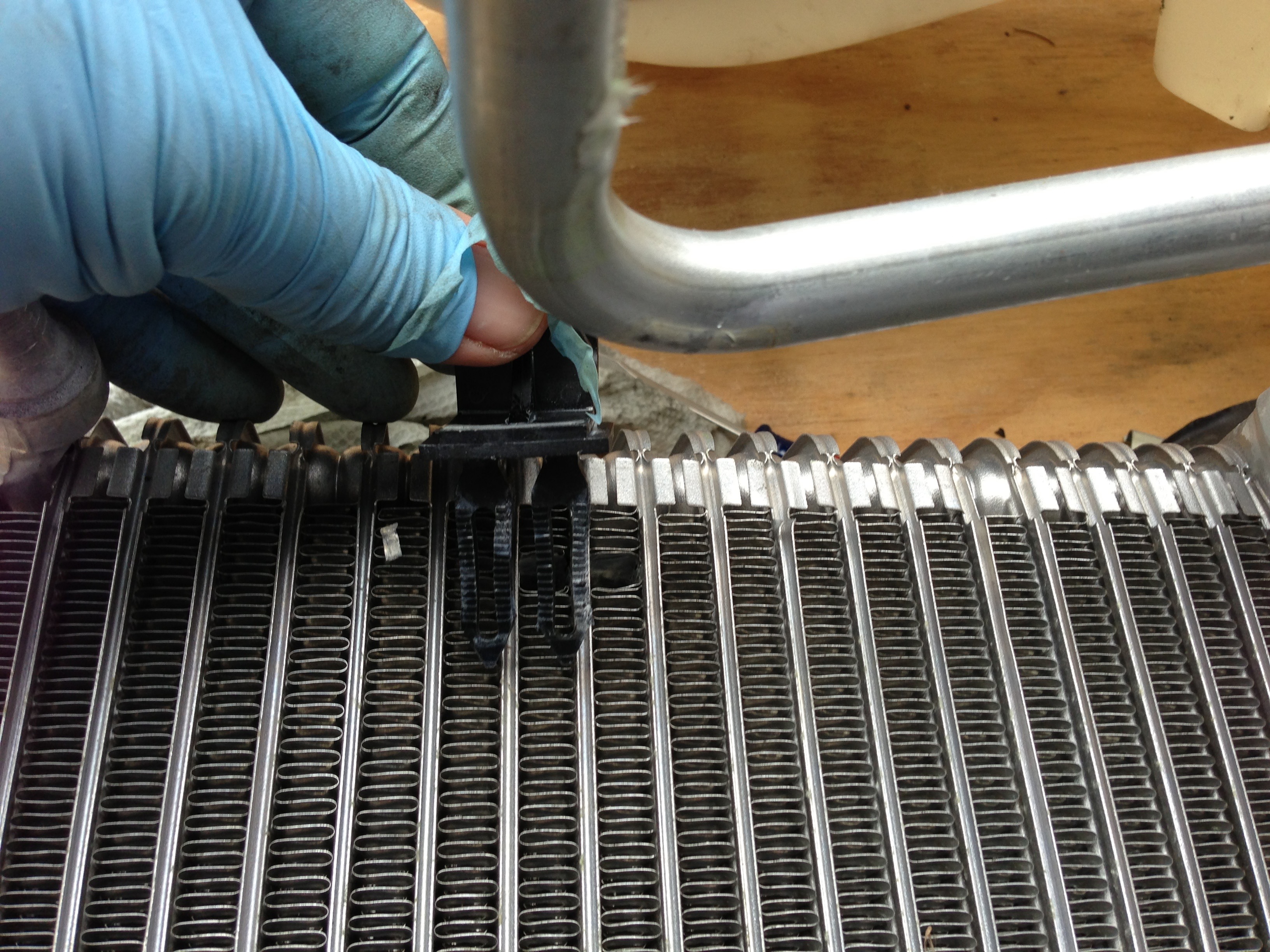

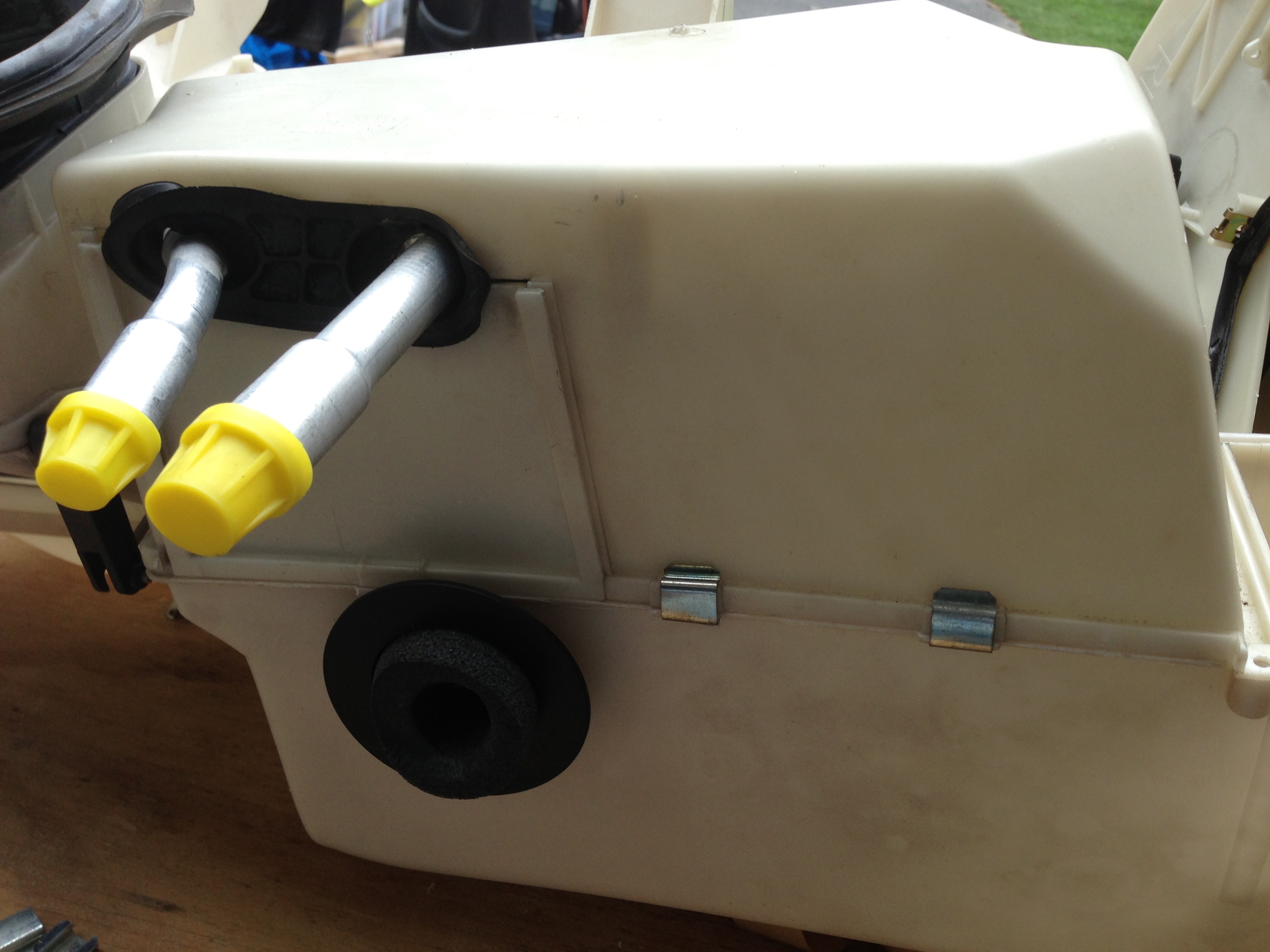

EVAP core line retainer detail

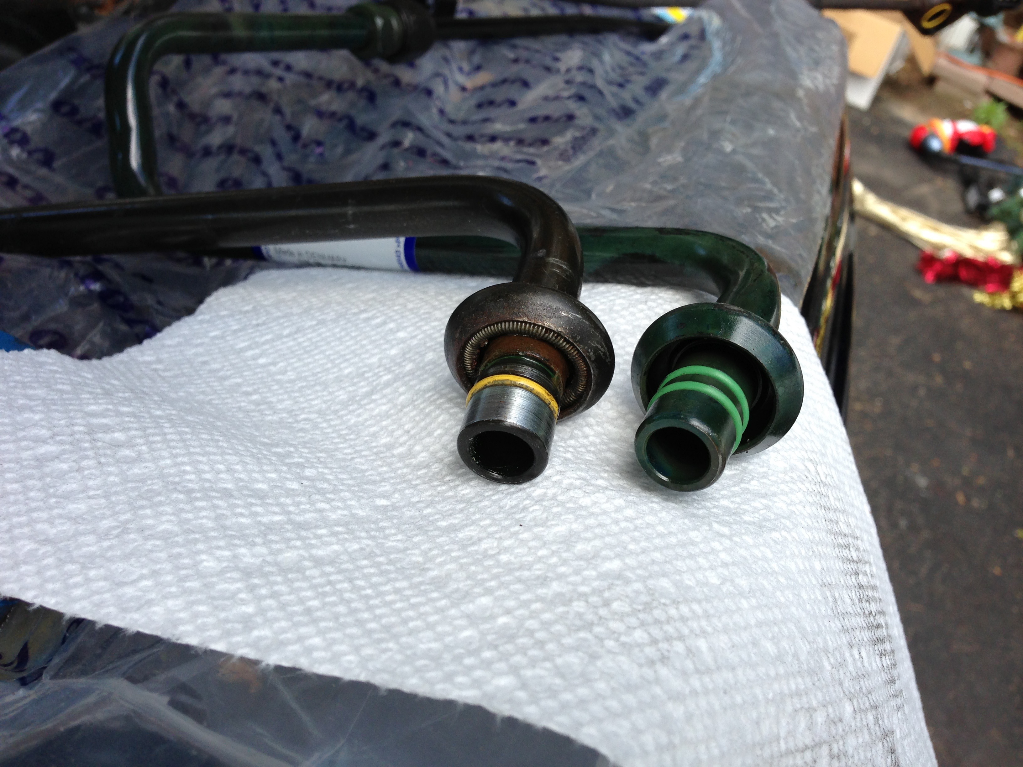

Nasty Orings and tool

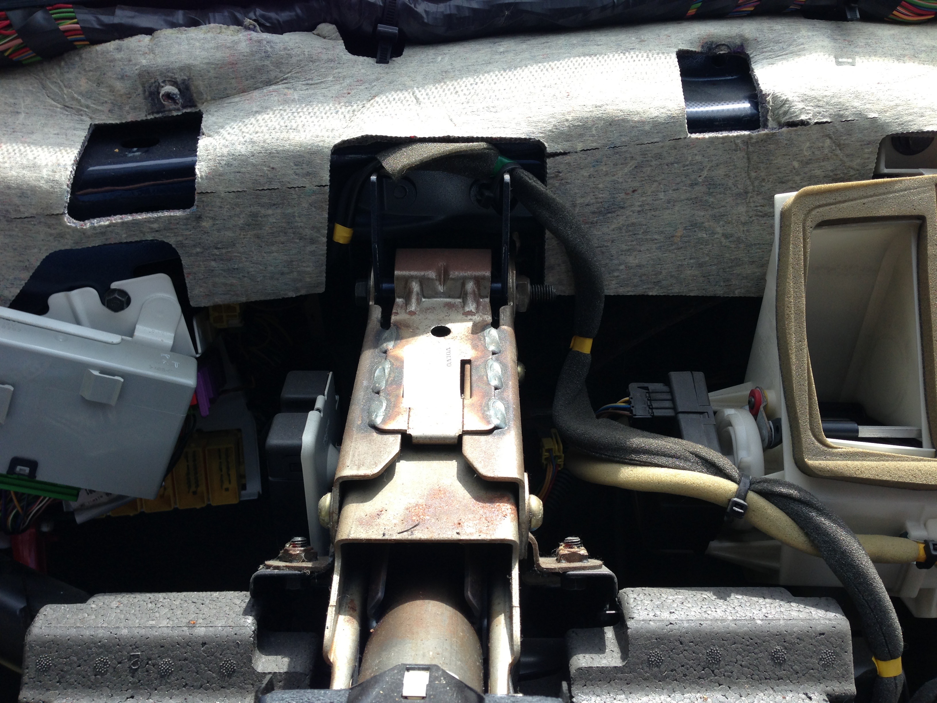

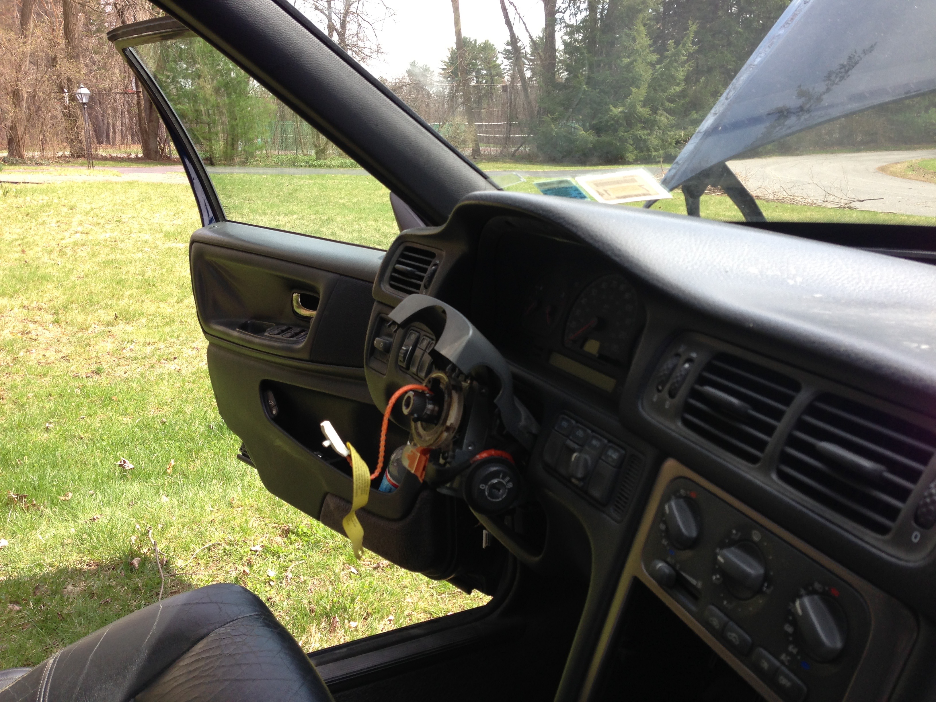

Steering shaft closeup
Clearing TPS (pedal sensor on ETS cars) - I remember this was a pain to do - needed deep M6 socket

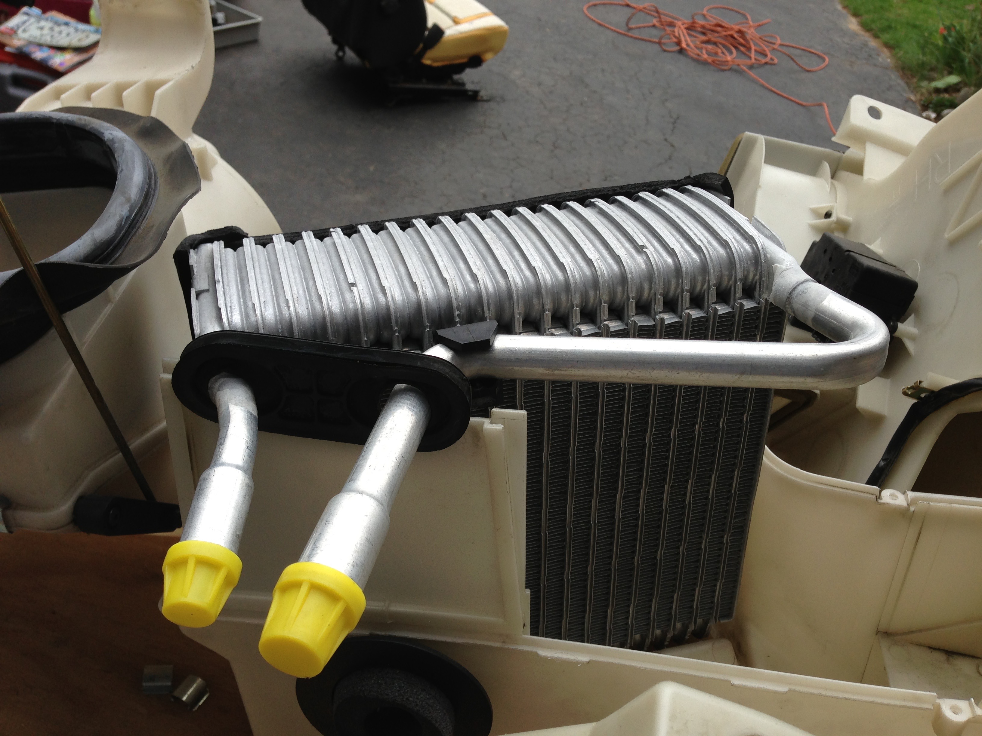

New Evap detail
New Evap detail

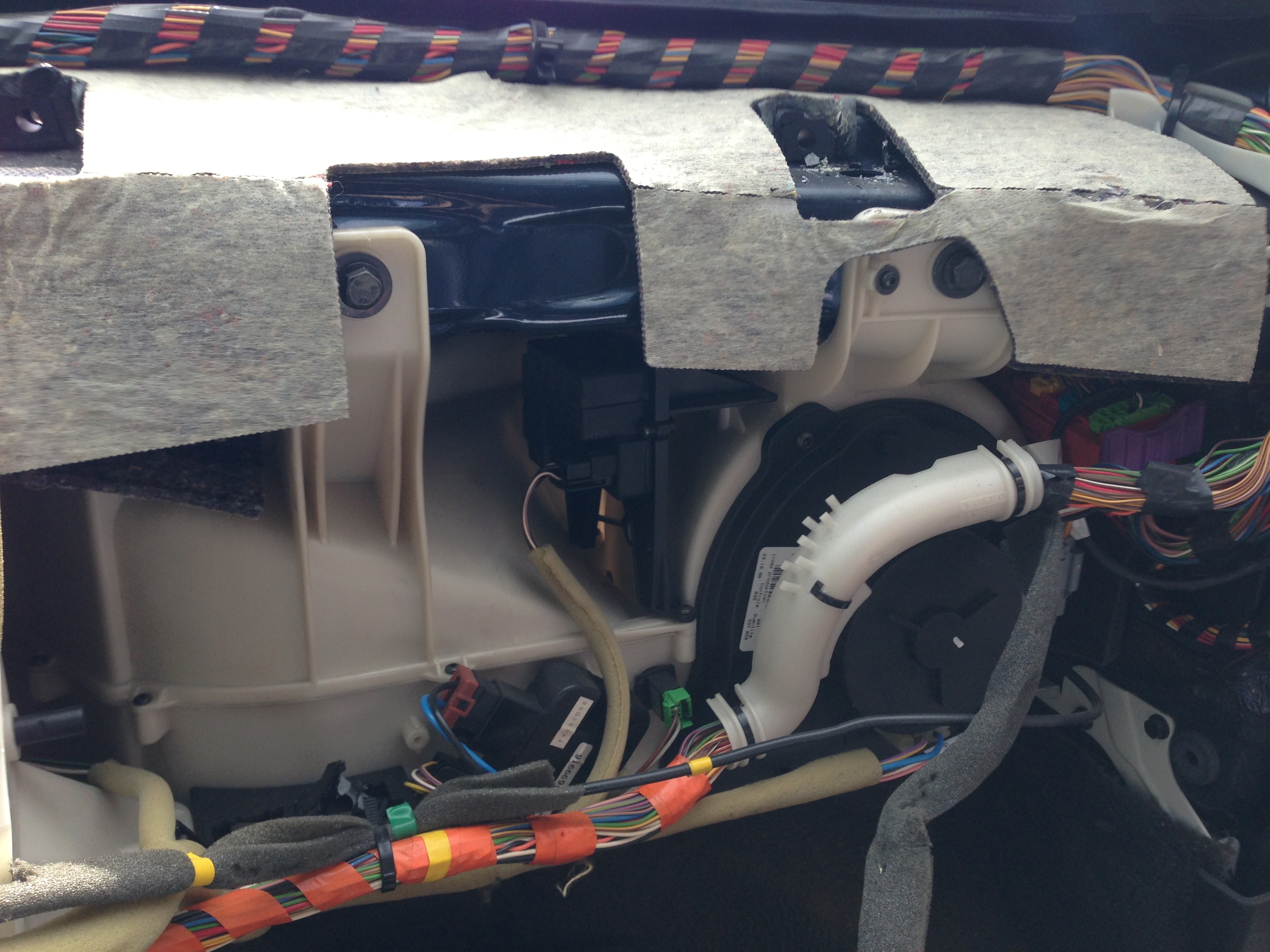

HVAC view installed
HVAC view installed

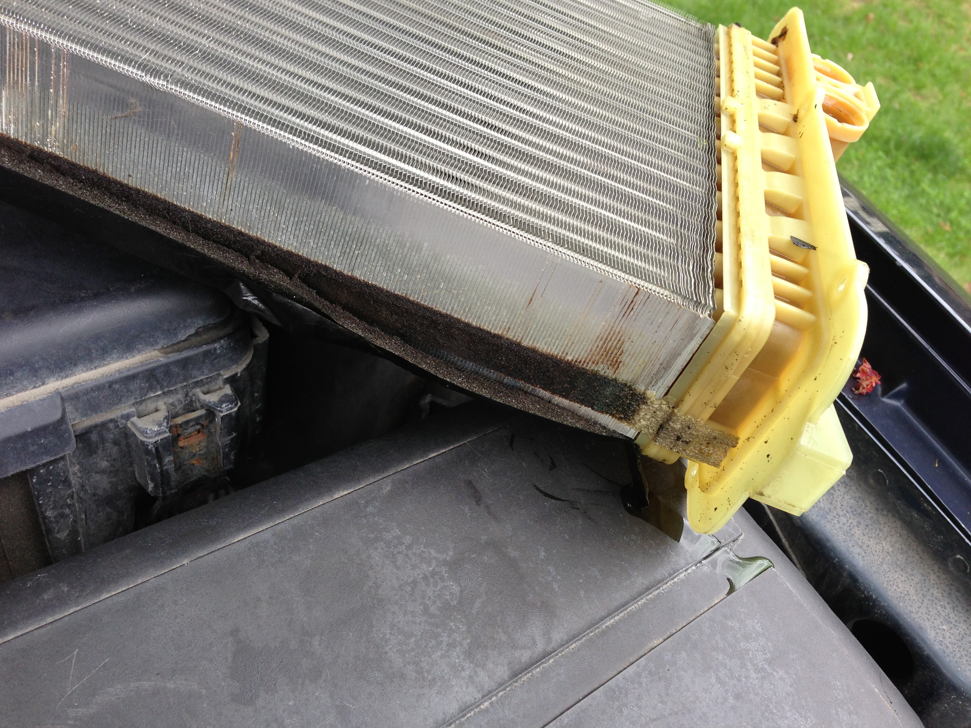

OEM heater core failure

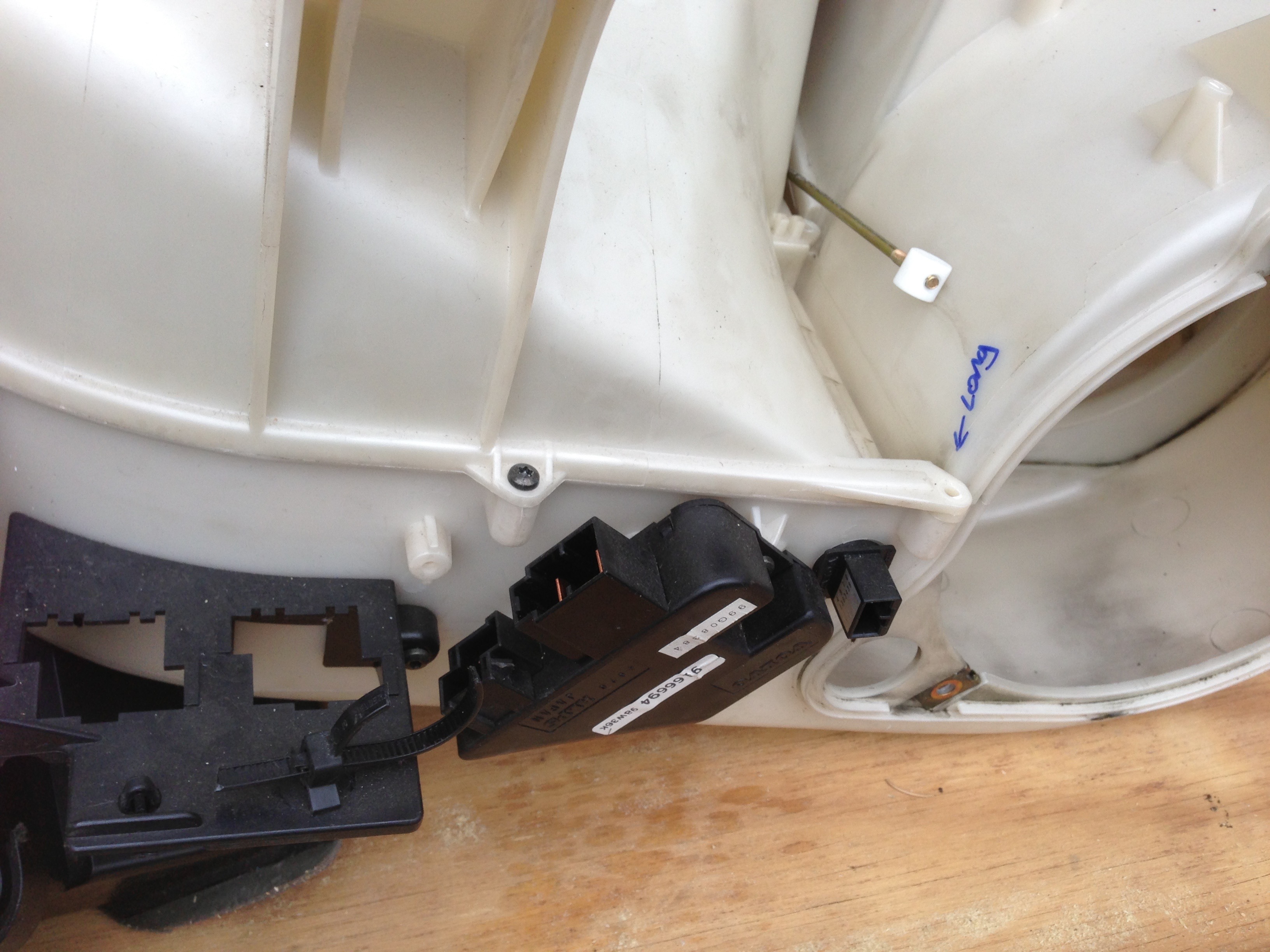

HVAC wiring detail
HVAC wiring detail

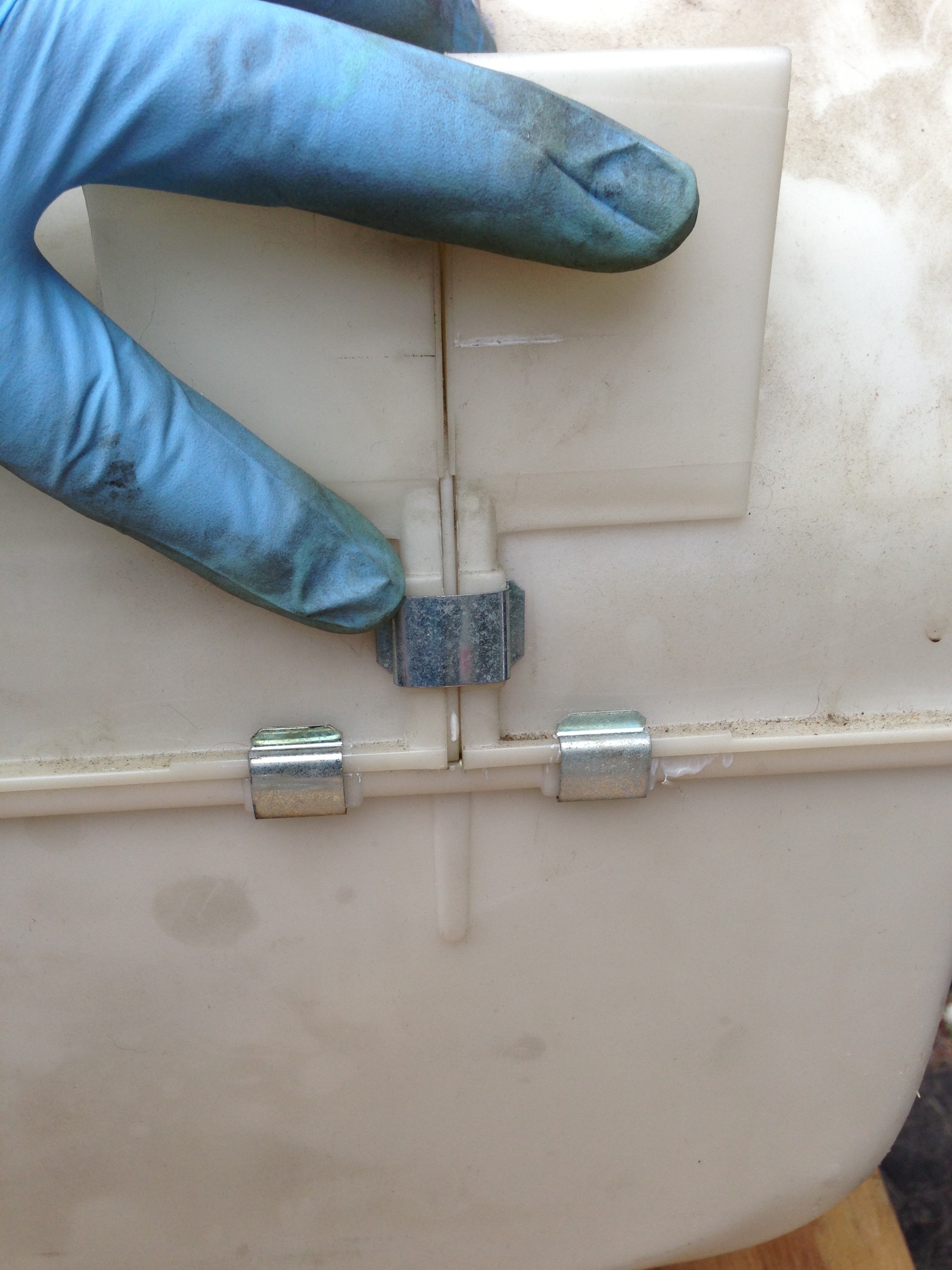

two sizes of fasteners on HVAC  - mark them with sharpie

Two sizes of clips but easily sorted
HVAC detail
HVAC detail

I replaced that one and also the drier to condenser return line due to corrosion
There are three fasteners that separate you from Nirvana on this job.
The two 6 mm hex screws that hold the hardline behind the right head light..you can see the mess I made when one of the captive fasteners broke
The hex holding the suction line into the compressor. This is the one I got to with the long extension
Once those three are out, all of the hard connections can be dealt with on the bench and not on the car. The drier connections are big , 27mm (1 1/16”)+ nuts which will be locked tight and there is no clearance on car to snarf these off.
Up top, you can heat and apply pure torque , all is good.

Replacing the orfice tube in place looks doable with another high pain factor. Look at the clearance for the 19 and 22 mm open end, and you don’t get pure torque with these. Crows feet probably required, and careful wrenching, or get it on the bench and 15 seconds. Not sure how you are going to keep things clean there either
