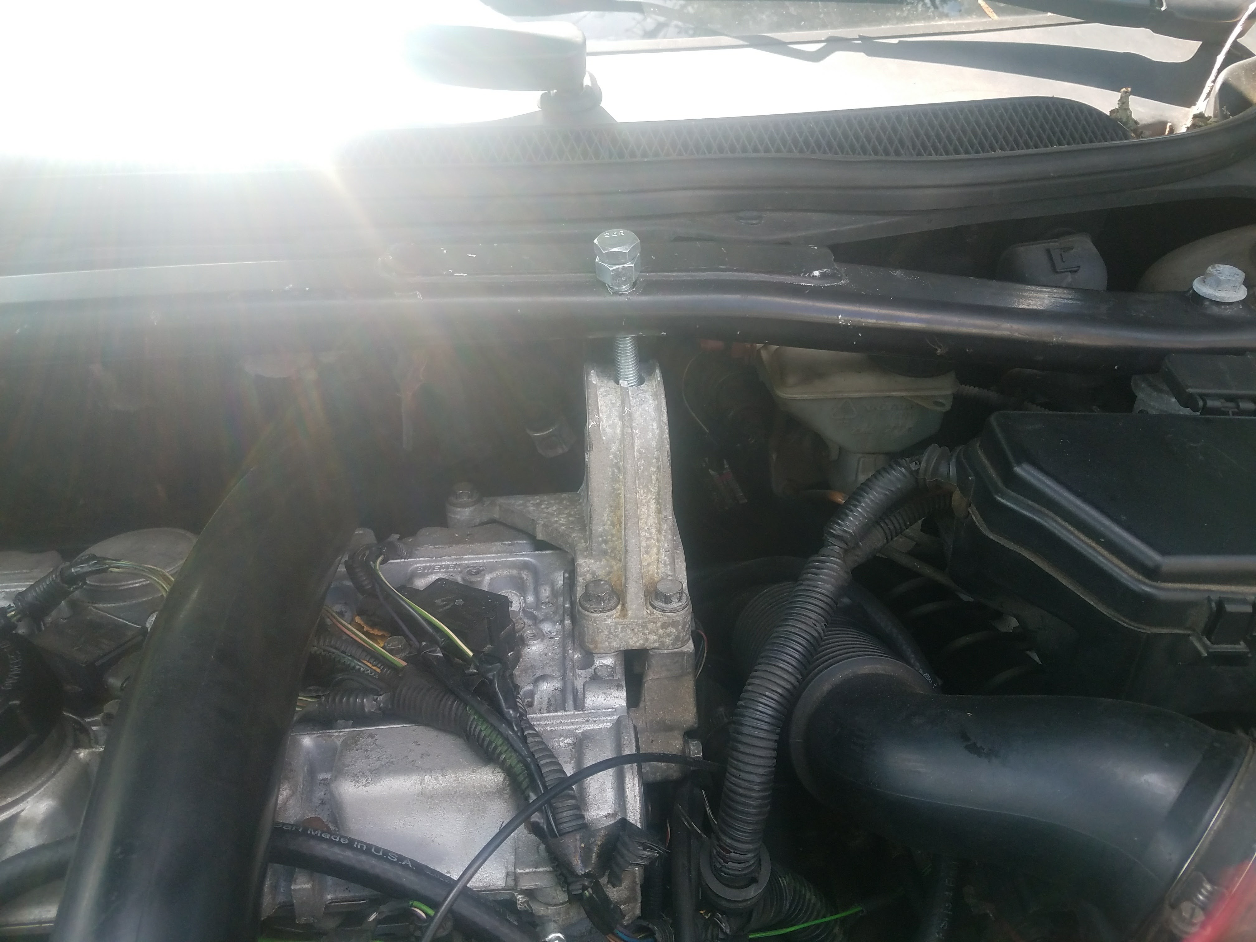

Just started my Solenoid replace job, took about 2 hrs to drop subframe.
Started on pan bolts, aleady see some hard to turn, not looking forward to it.
Made a cool way to hold up motor, see picture.
I had a spare s60 cross bar and upper moter mount. Drilled hole in both.
