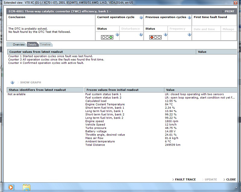

ECM 4801 has returned on our 2001 V70XC, three weeks after replacing both HO2.
VIDA DTC shows...
Yellow Dot - ECM 4801 - Two Way Catalytic Converter (TWC), incomplete performance check.
The fault tracing points to four possible Intake and exhaust vacuum leaks, and 5th is TWC permanent fault.
I am suspecting TWC too.
Unless there is more to check on VIDA.
VIDA DTC shows...

what are your fuel trims?xHeart wrote:Informative thread!

I will check and post.quietcoolone wrote:what are your fuel trims?xHeart wrote:Informative thread!
VIDA DTC shows...
Where are you with TWC replacement?

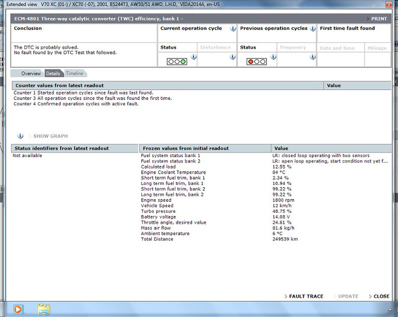

From 2/14/2015...
A month after new H2O, and MAF sensors.
I do not know what these number tell us.
