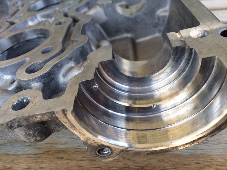

After a few days of soaking, scrubbing, and brushing with 'mean green,' the inside of the camshaft cover is sparkling:
I do wonder, though, if I should be concerned about these marks near/on the section of the camshaft cover where the seals (I think) would normally sit:
Appreciate your thoughts!!

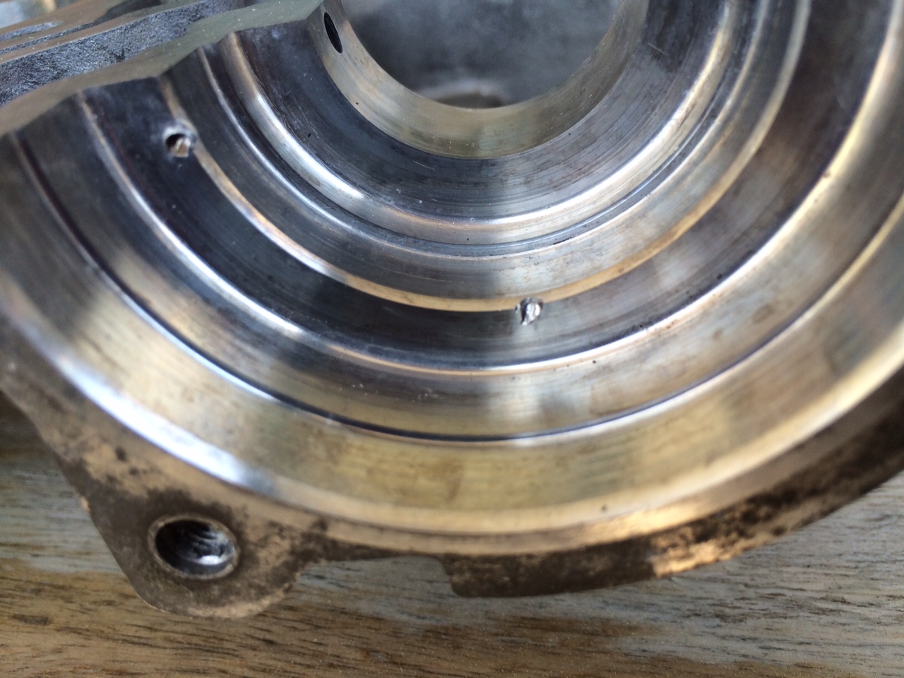

Here is another look at the knicks....

I would smooth the two nicks out carefully like a very narrow file and a few strokes by hand (remove ALL metal flakes!), but they are not going to be any problem at all for the cam seals.
