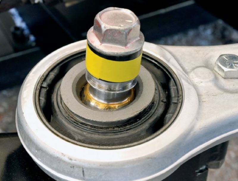

Pic is of a MY 2011 Subaru Sti OE LCA bush with the dust boot removed to see inside. I repeat: that's Subaru OE equipment, not an aftermarket pillow ball.
Obviously this one would not directly fit a P2 Volvo (the ball would need to be modified with cylindrical extensions to mount to our subframe with a thru-hole bolt).
But the concept is applicable and more in line with what we really need on that rear LCA bush. On the newer Volvos this bush was moved to the front position and I would suspect something like this design Subaru came up with might be desirable on the front position of newer MY Volvos as well.
The inner ball controls LCA movement while the outer rubber bush provides NVR isolation desirable for a daily driver. It would be imperative with this that the front bush be free from resistance to movement (like the powerflex bush where the bushing material, be it poly or rubber isn't bonded to the center bar). Resistance to movement up front results in more upward/downward 'float' force on that rear bush which would stress out the rubber part on this.
