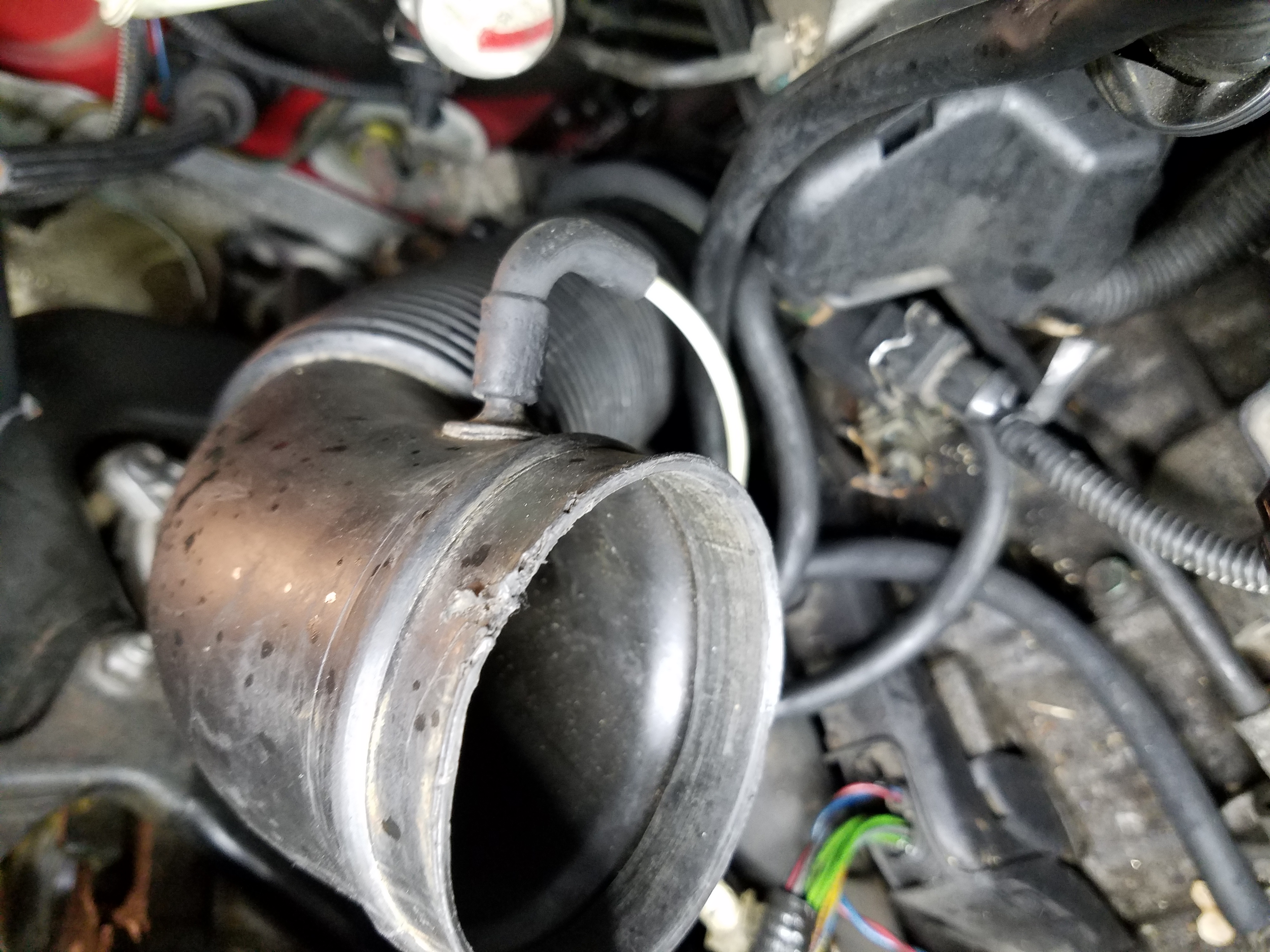

Looks like you are missing the Turbo Control Valve?
Look for a valve with three pipe nipples on it.

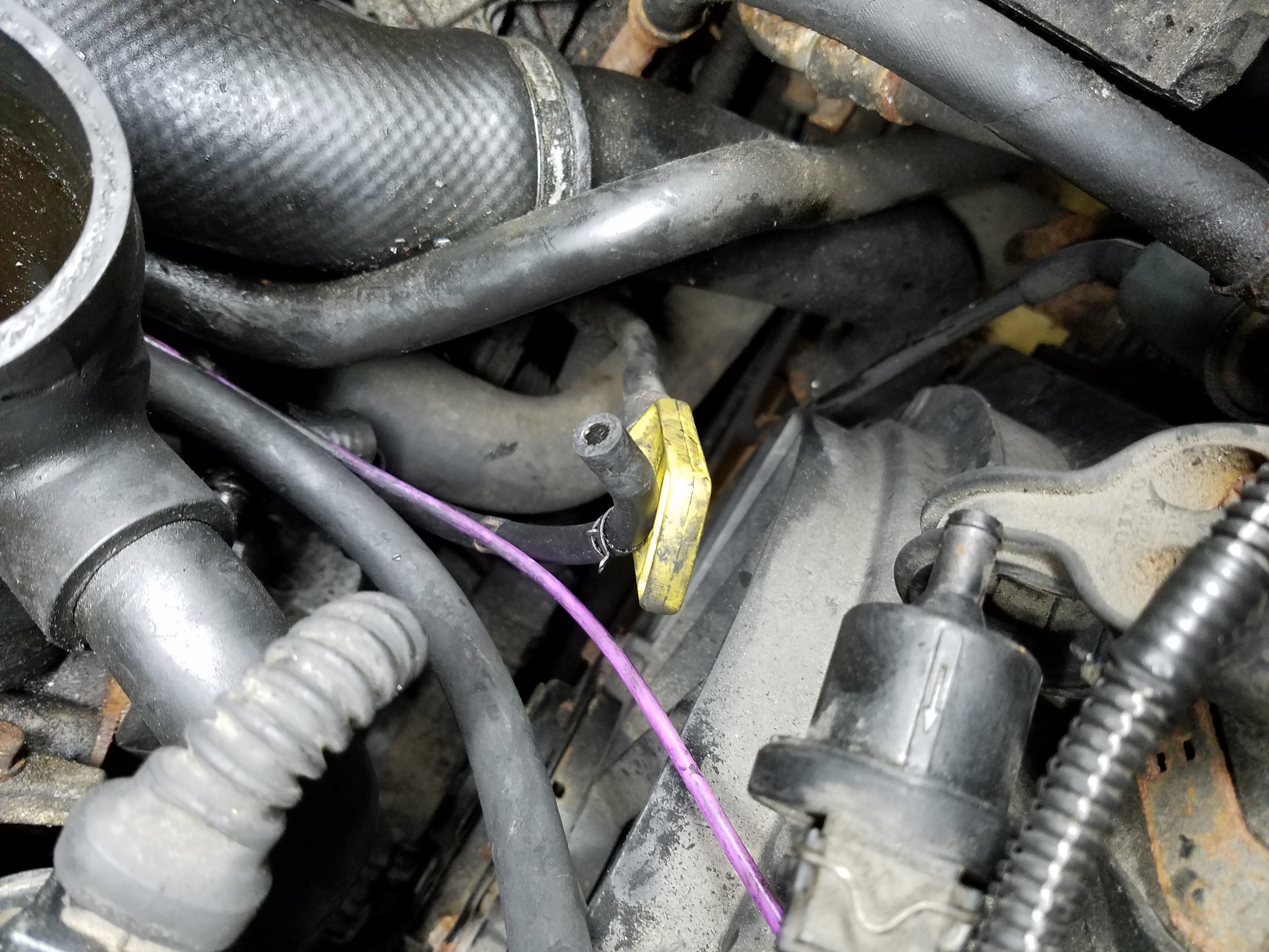

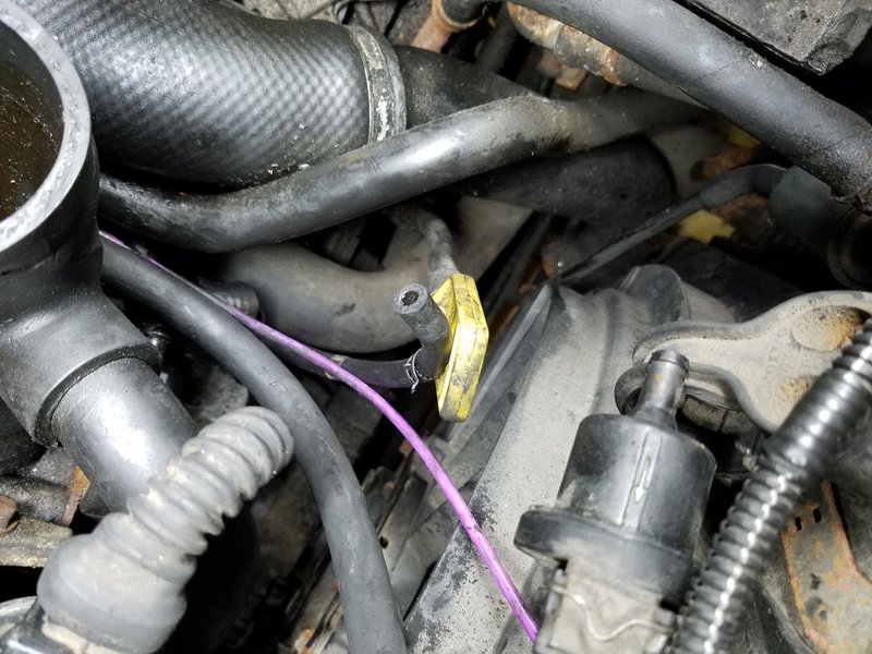

#1 looks like it comes from the intake manifold or goes to a plug near the radiator??? What is that plug on the right side of the picture without any line?
#2&3 Wrong. The boost controller has 3 vacuum lines, one of which is pictured center left with the yellow tape. The Boost controller has a short vacuum line that plugs into the intake where you currently have the white line.
Depending on the other end of the white line, it might hook onto the vacuum tree on the throttle.

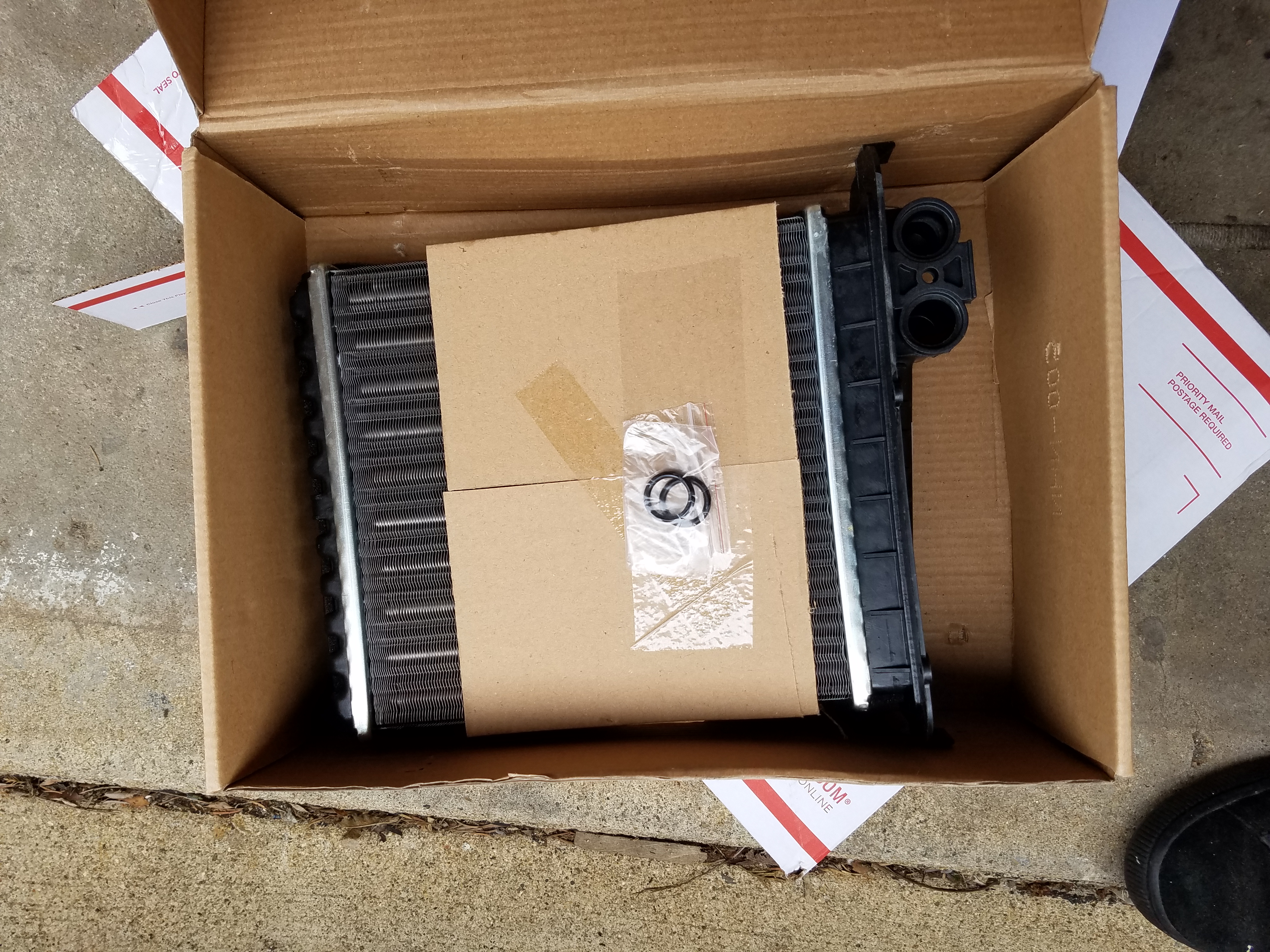

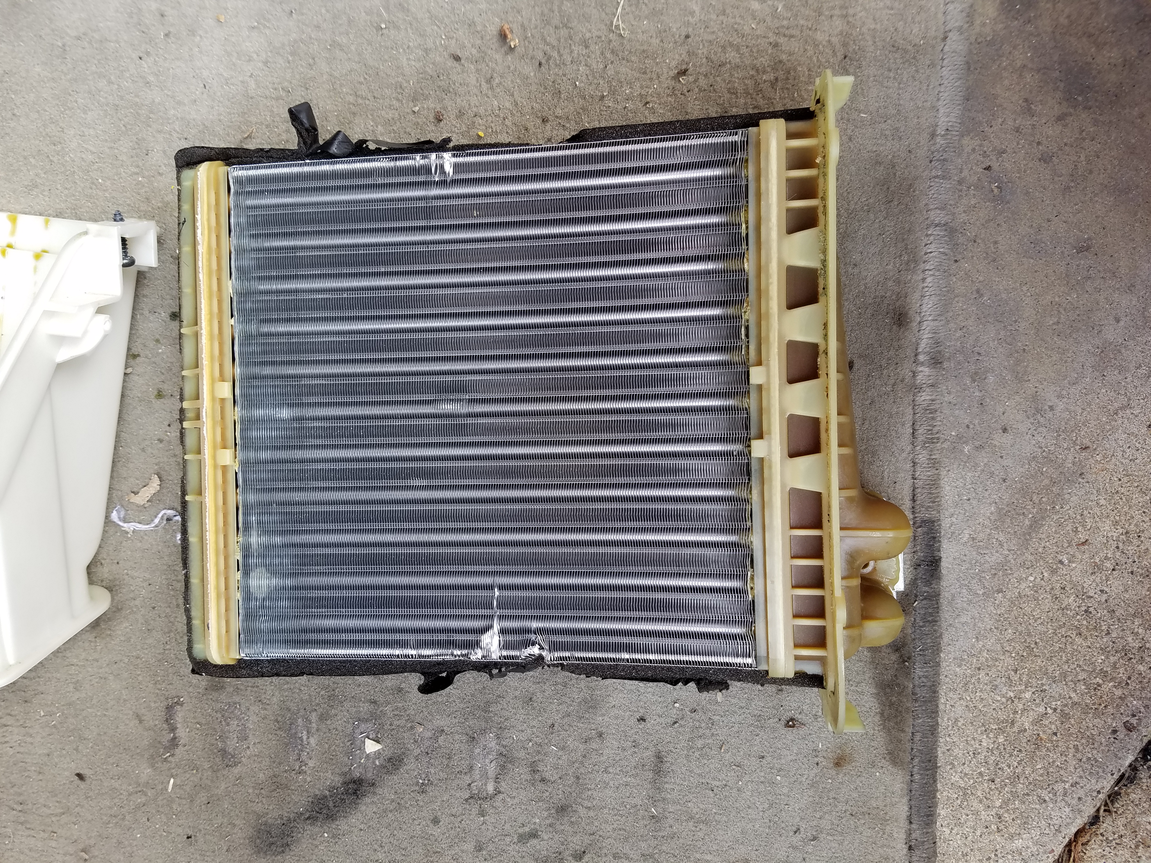

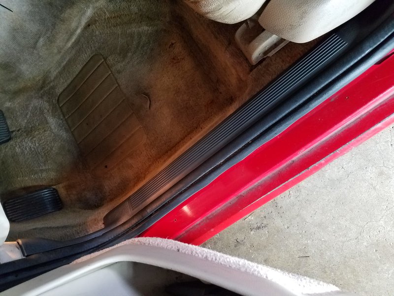

Noticed some trim missing by the driver kick panel and found lots of corroison near the driver seat, heater core was going. Found some new trim at the junkyard, not the same color but looks good, got matching pair.

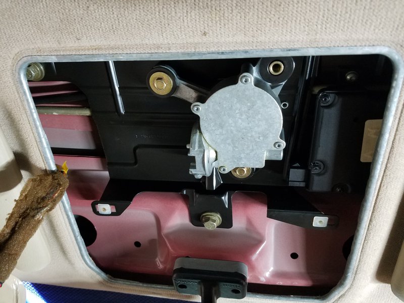

My sunroof wasnt working so i popped the cover off and noticed someone removed half the motor? Got a used one from the salvage but the mechanism is some how binding. gotta pull the headliner off.

No tilt. It just clicks and torques a bit and then stops. The sunroof wouldnt even move with the motor out.

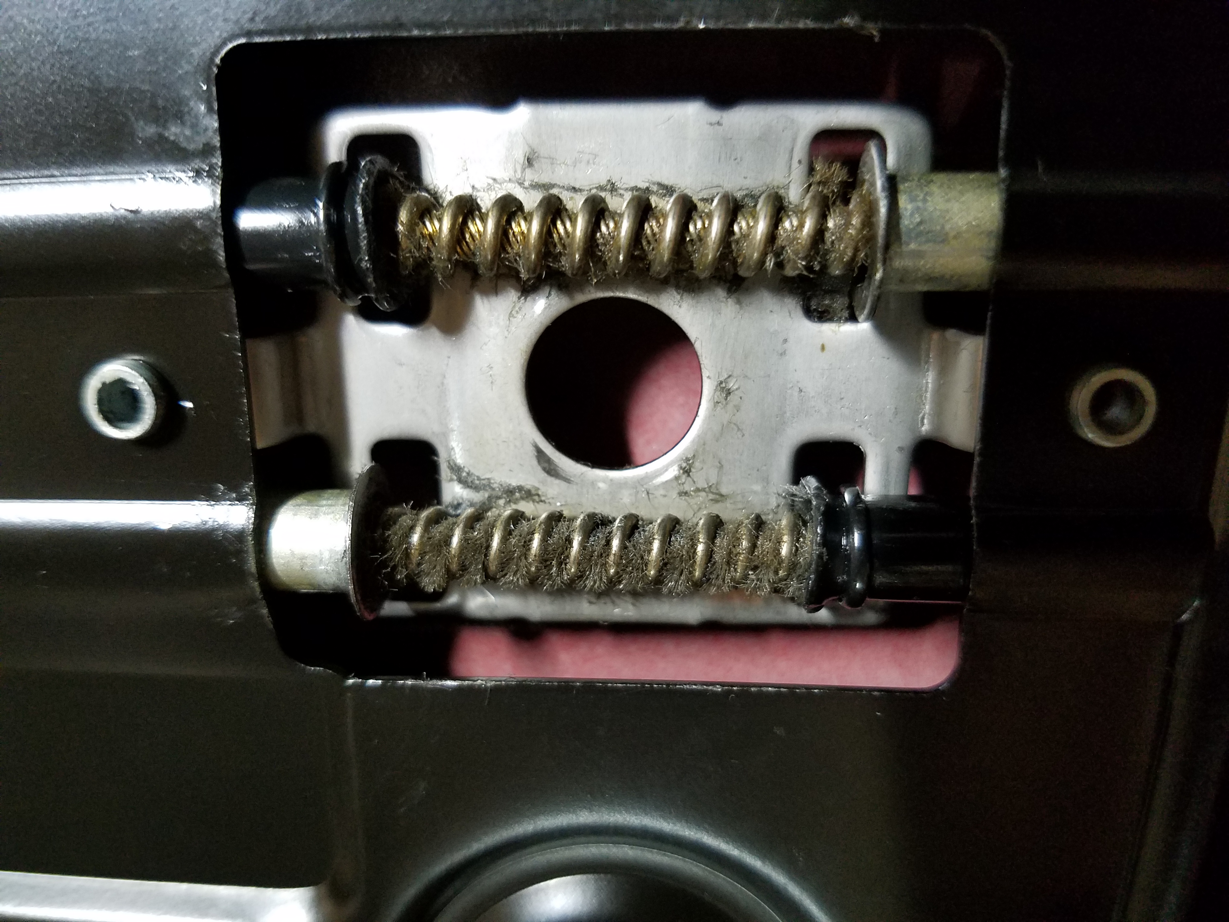

So I noticed the little cables that im assuming move the sunroof were full of lint like materiel. Cleaned them and nothing. So i started to pull the headliner but now i cant get the B pillars off...

You should have been able to push the SR glass up at the rear while the motor was out. Do you see any glue or RTV around the outside? A couple of light bangs with the side of a closed fist should loosen it enough to get it started on its way up.
As I said before, removing the headliner will not get you access to any part of the sunroof.
