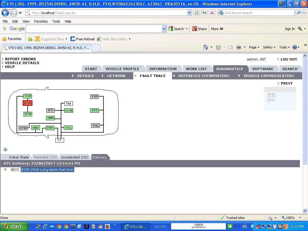

Screenshots from the 1999 V70 I recently repaired:
Similar to your own codes?? (apart from throttle and long term fuel of course)
The bottom one is before ABS repair and some codes were due to a flat battery.
As I mentioned he also had no speedo prior to repair
- faults 21.6.17.JPG (143.22 KiB) Viewed 2431 times
- Scan 23.6.17.JPG (102.89 KiB) Viewed 2431 times

Thanks for the comprehensive notes Mike. Really appreciate the work. Problem up until now is that when I have switched the engine off, the warning lights have gone off. When they have come on, the only thing to hand has been my regular code checker and it does not show the ABS codes, only the P0600 comms. code. Resetting that removes the other codes. I will try to see if I can get the P0600 to stay on while I connect the Vida to is and see if it then shows the ABS codes too.
I have a Matty module on it's way here so hope that will fix it. I was also at PnP yesterday, and following up from info from you and Matty I had a look at a 00 S80 non-turbo. Could not see the part number on the module so pulled it. Major pain compared to the P80's as the 4 hard pipes run directly under the module. Had to pull the air-box and main fuse box to get access. You can imagine my surprise when the part number was exactly the same as on the project V70! At $20 CDN it is worth trying to see if it makes any difference or at least throws other codes to show we are going in the right direction!

Well I tried Vida again today and managed to get it to show the layout map as in precopster (Mike) shows above with all the various modules. The computer/Vida went through the process of communication with all the modules and did not show it had issues with any, but when completed the modules were either green, light blue or white (TIM?). The only exception was the ABS which was orange/red in color. However, when I clicked on it nothing showed up. With the other modules that are green it shows the module number and other info, but nothing for the ABS. In theory from the color it means there is an issue but that is it. I am not confident using Vida, but am I doing something wrong or not activating whatever shows failure codes? Is the car just not communicating with the ABS module?
