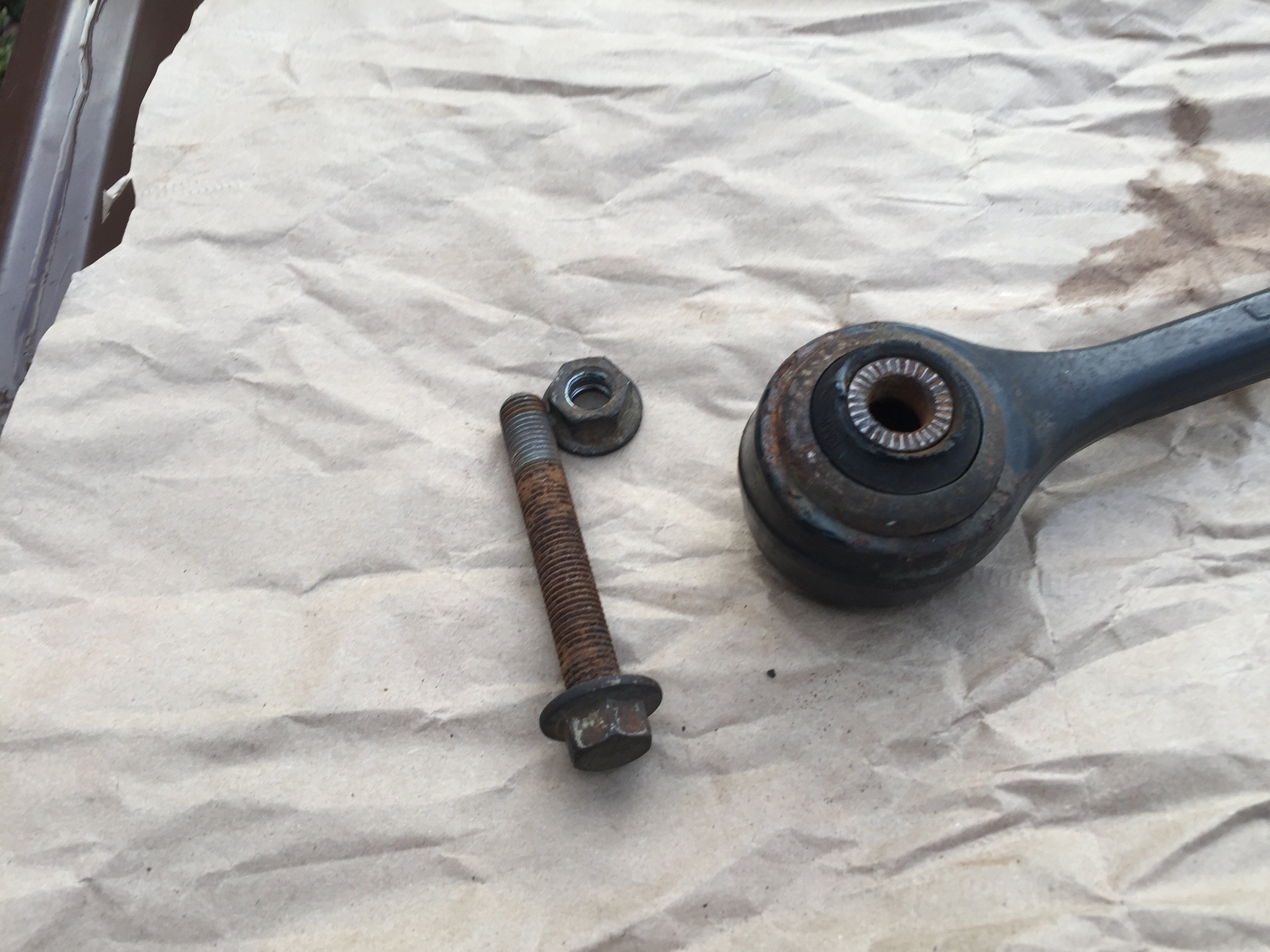

You will need the torch, too.
Just knocked off E83 front end work, and the wind almost blew over my press!
[/quote]

If they're really stuck, you can drill out the rubber bushing in several places around the ring, then it has little resistance left.abscate wrote: 01 Nov 2019, 12:10Just knocked off E83 front end work, and the wind almost blew over my press!
Is there not an outer bushing ring/sleeve inside the arm? If so, once the middle is shoved out, you can then use a loose hacksaw blade to cut through 90% of that sleeve and it's a fairly easy chisel job to pop it out. I've never tried the torch-the-bushing idea - doesn't seem like it's good for the arm (especially if alum!) or your lungs.

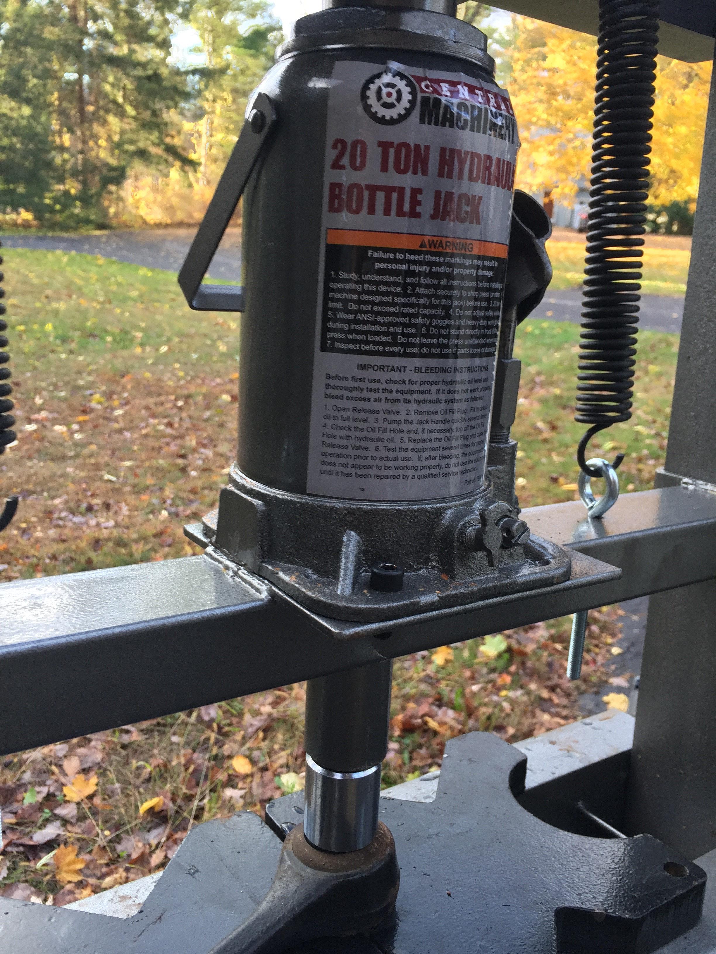

20 tons of press makes short work of stuck stuff
