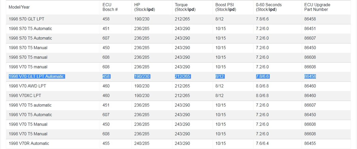

You're on top of it yes -tardcart wrote: 14 Apr 2019, 19:10 erik, good advice, but would that have to be a 4.4 ECU from a 97 98 t5? could he use a 4.3 from a 96 850? would he even notice a difference if he didn't increase to 15g?
- needs to be a 4.4 ECU from a 98 T5. NOT good to use a 4.3 in this case, it will fry the AC compressor.
- yep, the ECU alone is fine to drop in, but there wouldn't be any difference until/unless the bigger turbo were bolted on.
- Gmstewart22
- Posts: 63
- Joined: 29 Sep 2018, 11:56
- Year and Model: 2000 v70 GLT, 850-T5
- Location: ALASKA
- Has thanked: 11 times
I'm pretty sure I have the Bosch motronic 4.4 engine management system already in that car. I looked up the info off the cars vin number.

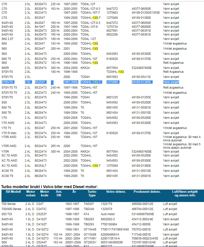

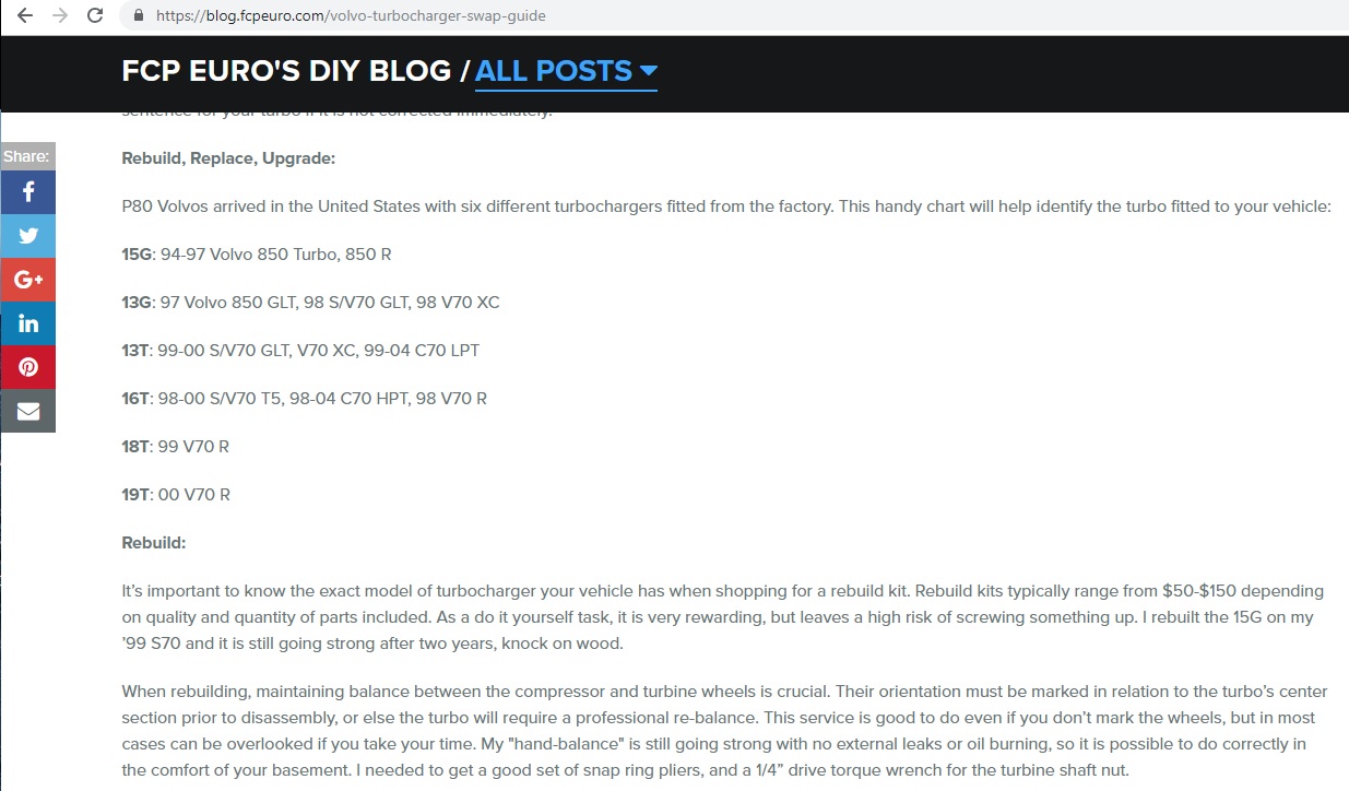

FCP: Volvoforum:erikv11 wrote: 14 Apr 2019, 18:55 You can just read the plate on the turbo to be sure, but it cam from the factory with a 13t. All AWD in 98 had the LPT engine.
You can also put on a 15g or 16t, an HPT ECU and the injectors to match from the engine, and get more boost that way.
MadeInJapan:
viewtopic.php?t=18342
"1998: s/v70, 2.4L normally aspirated engine (168 hp, 162 lb-ft)
----- s/v70 glt, v70 xc, v70 awd, 2.4L inline-5, mitsubishi turbocharger TD04HL-13G (190 hp, 199 lb-ft)
----- s/v70 t-5, 2.3L inline-5, mitsubishi turbocharger TD04HL-16T (236 hp, 243 lb-ft, bigger turbo)
----- v70 R awd, 2.3L inline-5, mitsubishi turbocharger TD04HL-16T (236 hp, 228 lb-ft, s70r not in u.s.; euro-spec R manuals had a mitsubishi turbocharger TD04HL-18T)
----- *factory introduced option ohlins 8-way adjustable shocks with remote resevior, $1600
----- c70 coupe, 2.3L inline-5, mitsubishi turbocharger TD04HL-16T (236 hp, 243 lb-ft)
----- c70 convertible, 2.4L inline-5, mitsubishi turbocharger TD04HL-13G (190 hp, 199 lb-ft)"
iPD: Also note the lack of a "15T" anywhere.

Thanks for fixing that - 13g, not 13t !!Sommerfeldt wrote: 15 Apr 2019, 00:59FCP:erikv11 wrote: 14 Apr 2019, 18:55 You can just read the plate on the turbo to be sure, but it cam from the factory with a 13t. All AWD in 98 had the LPT engine.
Volvoforum:
MadeInJapan:
iPD:
- S

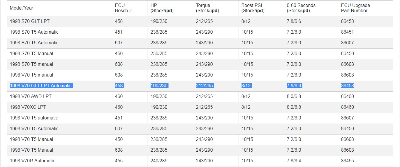

Also you highlighted the wrong line in the bottom graphic (
Why are you bringing up the characters "15t" here ? Not following.
