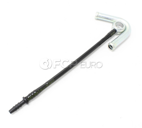

Abscate,
Thank you, I have already removed it, it is also clogged, so will it work to soak it in hot water and degreser?
Also, although the PCV Nipple P/N 30731007 is for the S60, I believe I should be able to use it for my XC70, but I am looking for a confirmation here.

- Posts: 8360
- Joined: 31 Mar 2010, 09:54
- Location: Omaha NE
- Been thanked: 504 times
The PN 30731007 is $40.
All you need is:
- Clean the old banjo connection hole. No need to d/c the coolant side.
- Get silicone hoses with appropriate diameter (maybe 3-4 mm in size) and change the plastic pipe portion.
- The barb fitting can be re-used.
All you need is:
- RickHaleParker
- Posts: 7203
- Joined: 25 May 2015, 14:30
- Location: Kansas
- Been thanked: 979 times
Volvo P/N 30731007 is for the 2.9L used in S80 1999-05 | XC90 2003-05.Metallo wrote: 19 May 2019, 04:51 Also, although the PCV Nipple P/N 30731007 is for the S60, I believe I should be able to use it for my XC70, but I am looking for a confirmation here.
