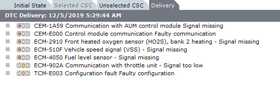

With the abs unplugged I ran a vida scan, this is what wouldn't clear:
The ECM-902A Throttle error is making me wonder about the ETM.
