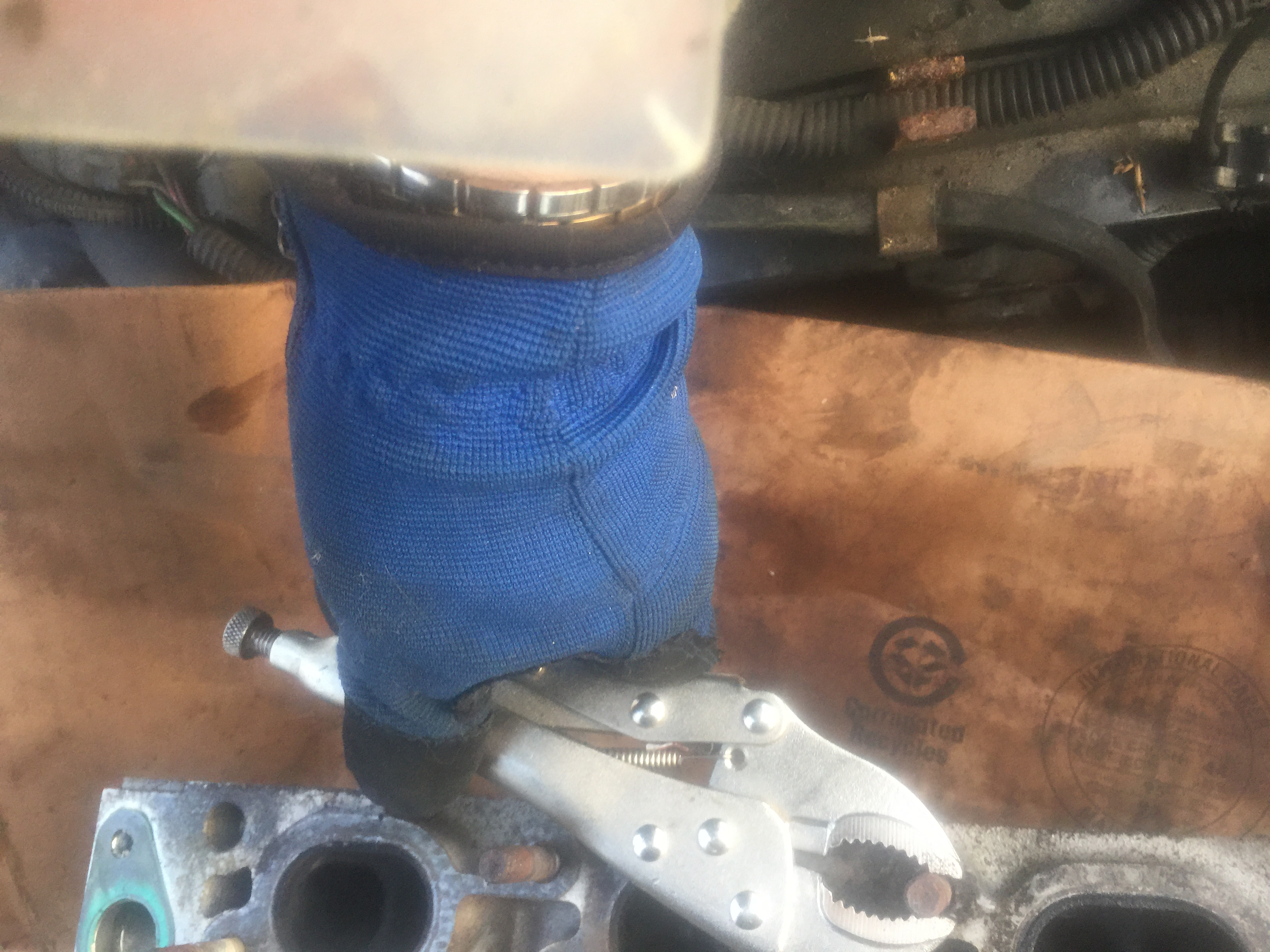

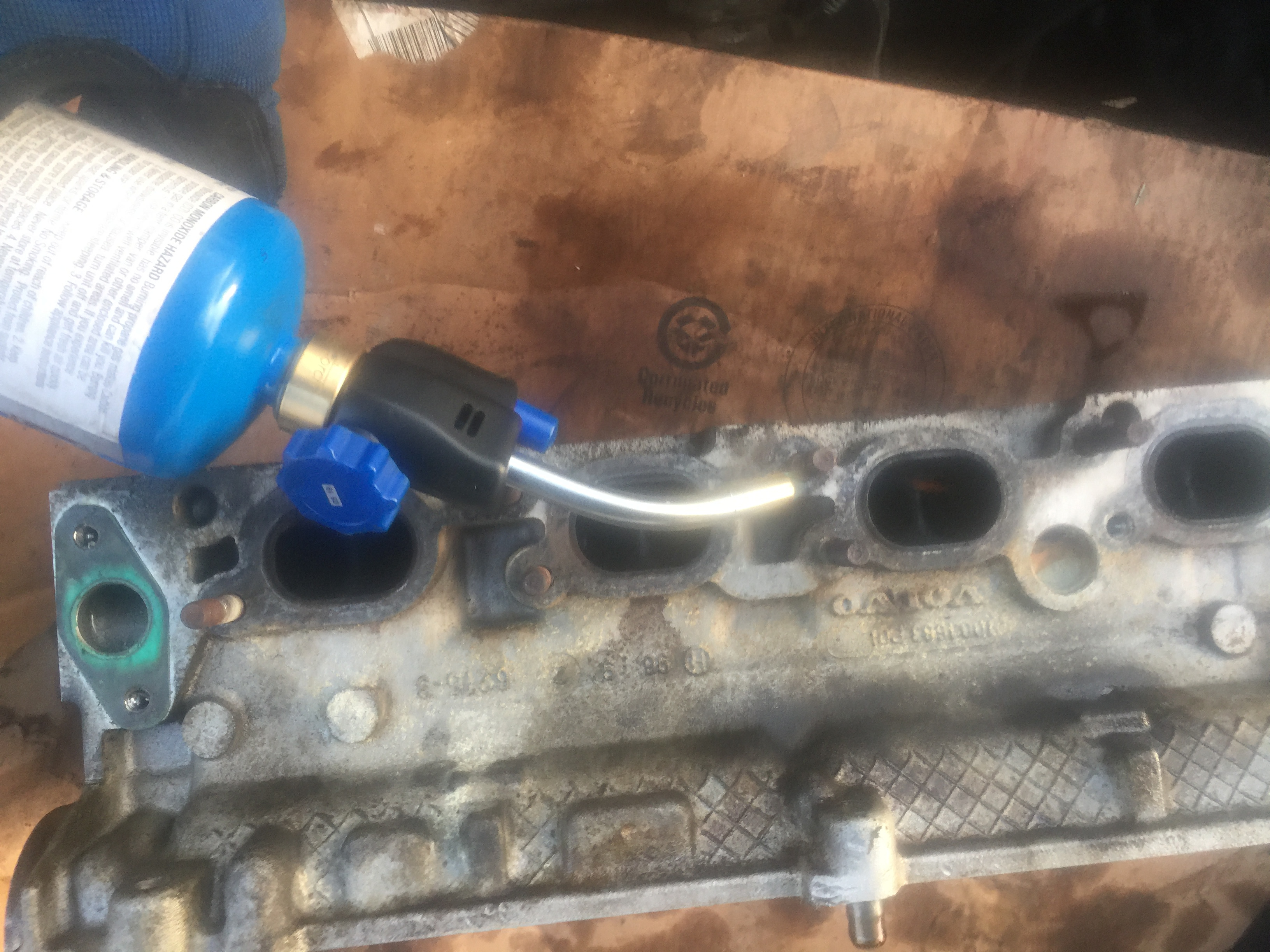

Ok , $16 per exhaust stud to replace, just Labour
That seems like a lot for heat and twist?
Hey! I’ve got a practice engine !!

Oh how I love working on southern cars.... the studs usually drive right out with the nuts. If not, vise grips usually do the trick with a little PB blaster.abscate wrote: 13 Feb 2020, 18:42 Ok , $16 per exhaust stud to replace, just Labour
That seems like a lot, especially if there's more than one or two studs.

Omen minute low flame. $160 less a few bad boys saved. I think most will come out easily. Kudos to Volvo for high quality steel studs.

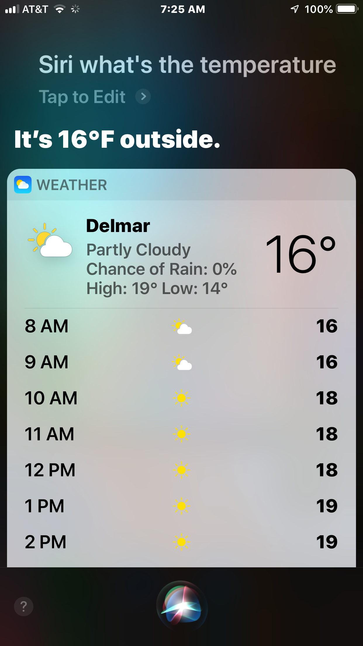

Worst problem was getting propane to light at 16F..can I get hazard pay, Mark?
Sorry about pic quality
