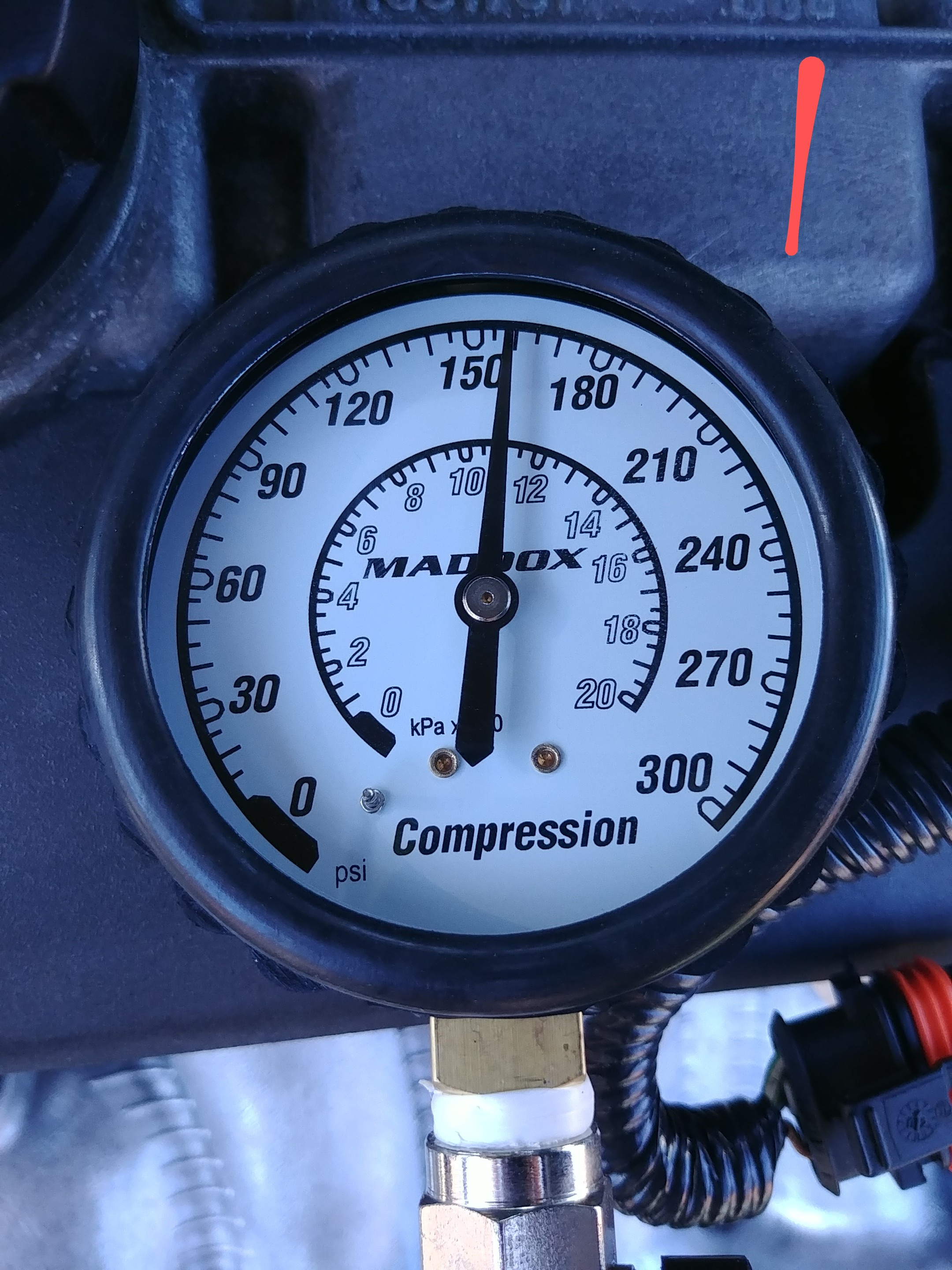

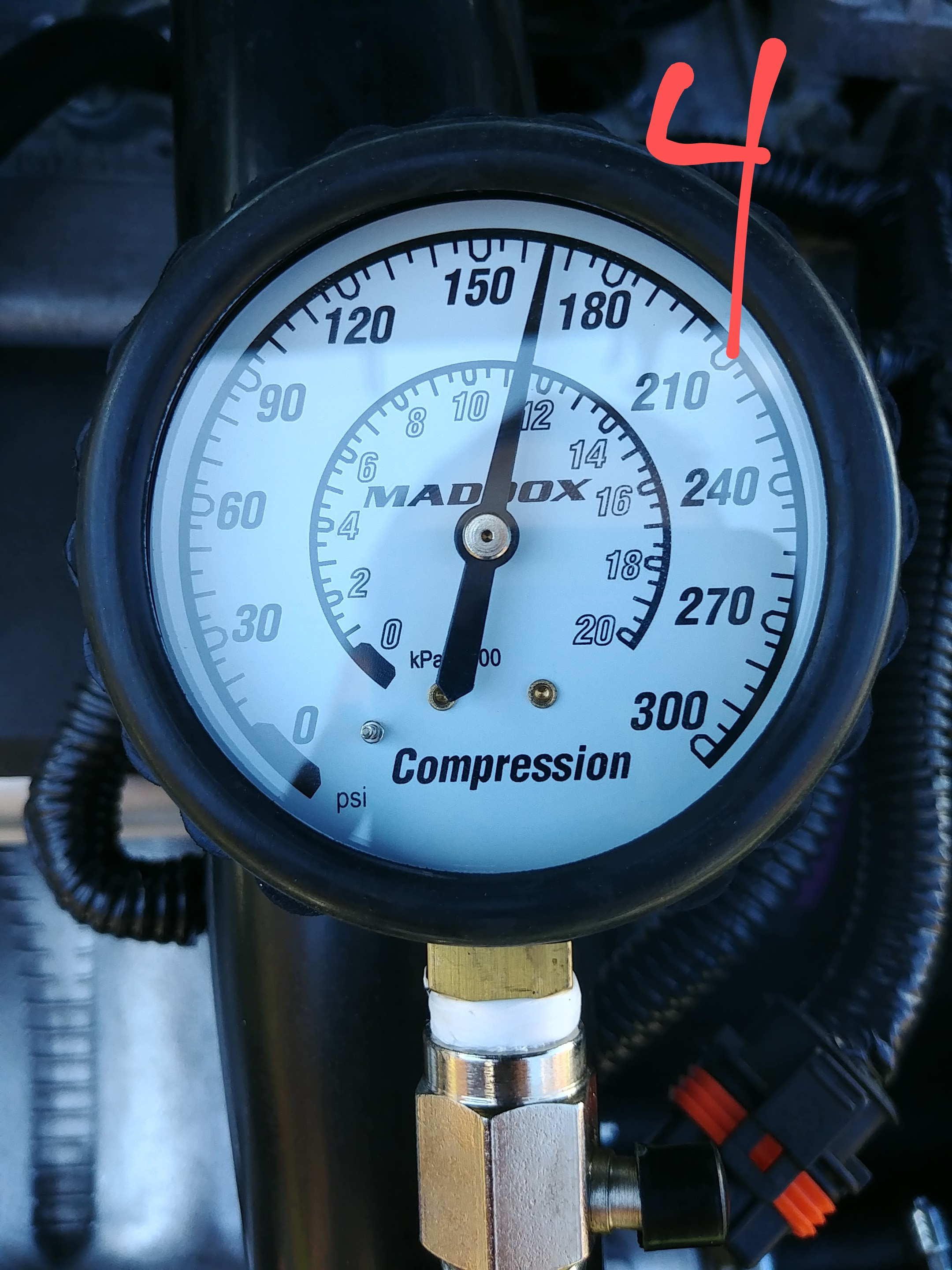

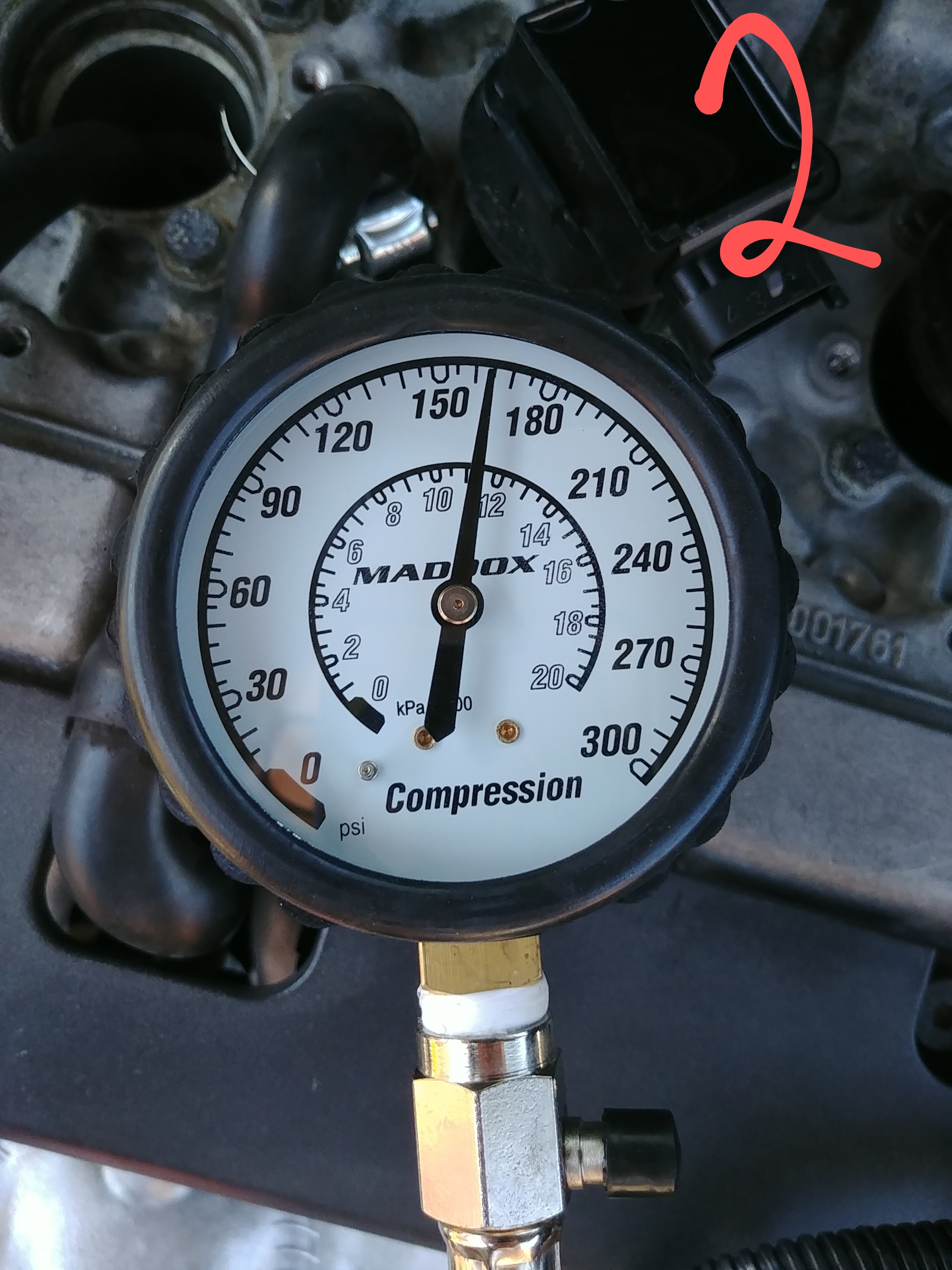

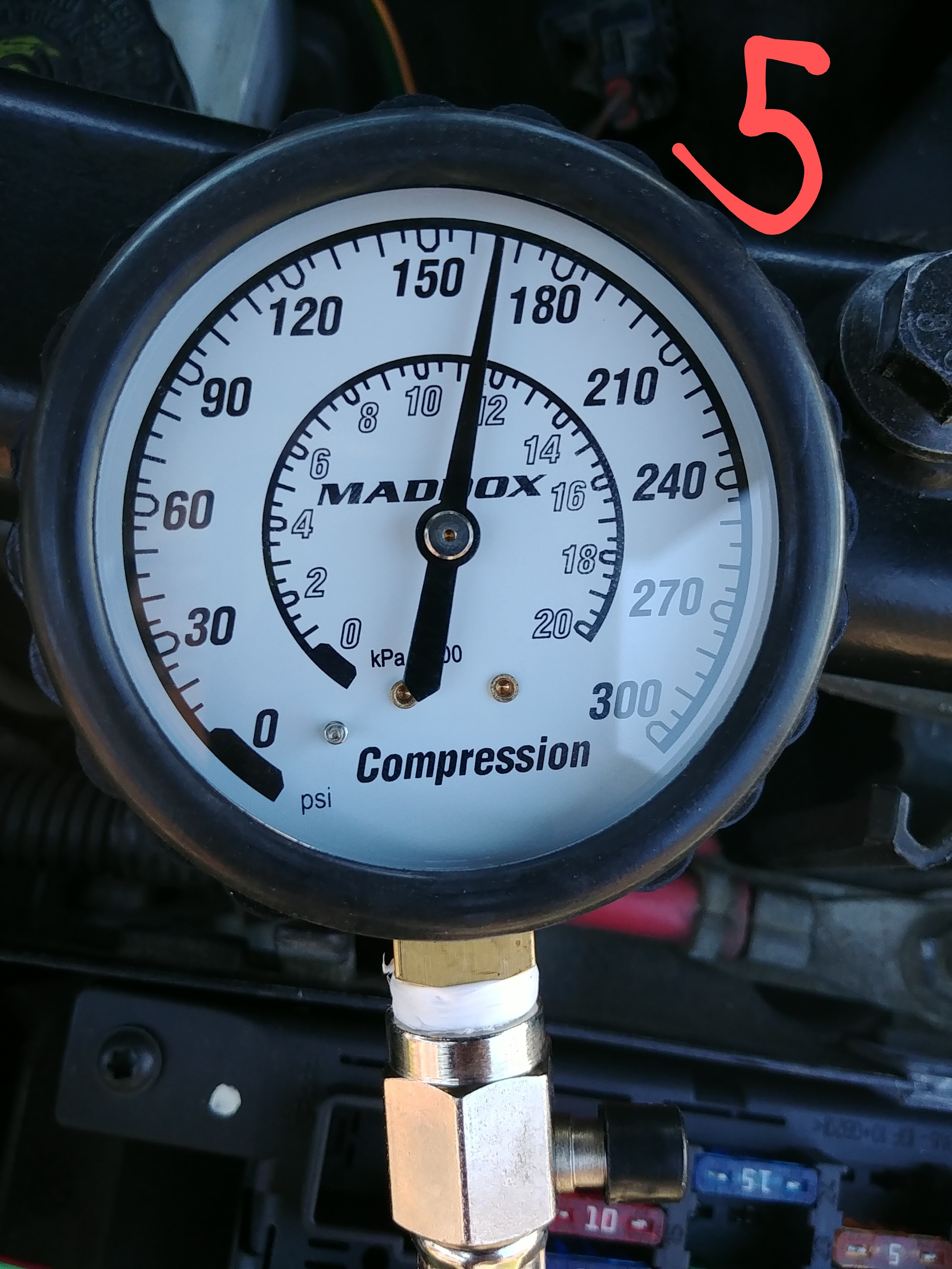

Finally got time to do a compression. Here's the results. Everything looks spot on. Still thinking head gasket. Going to do a cylinder leakdown test later.

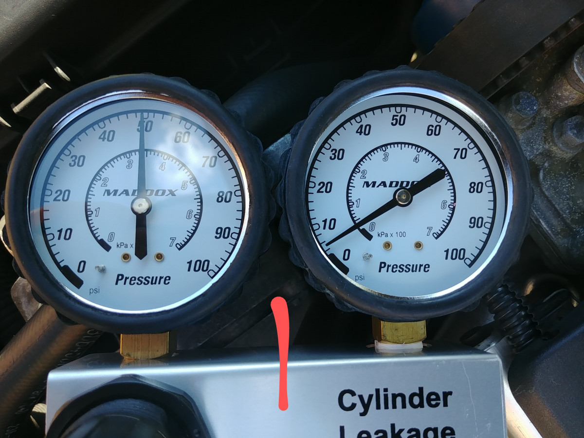

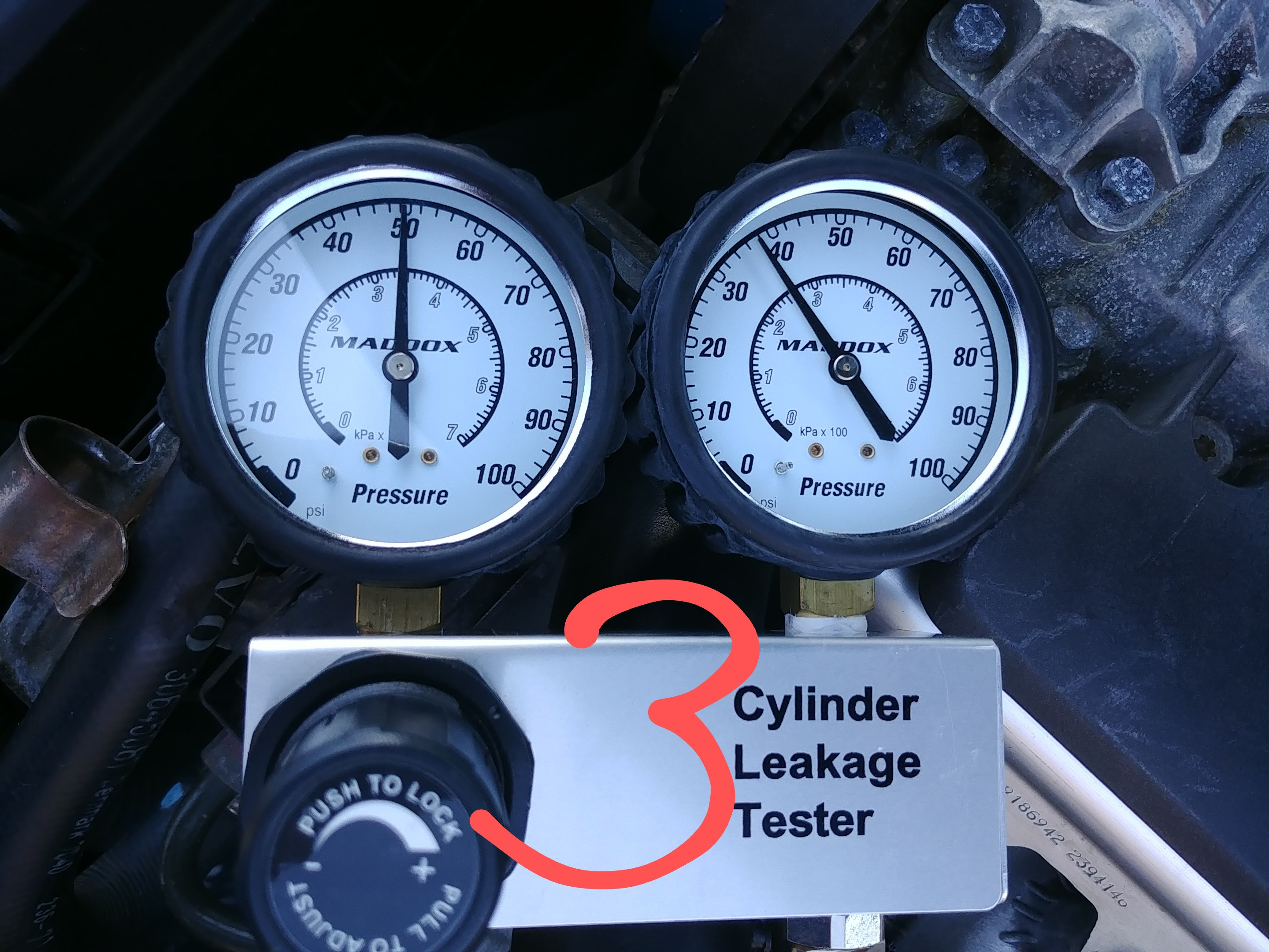

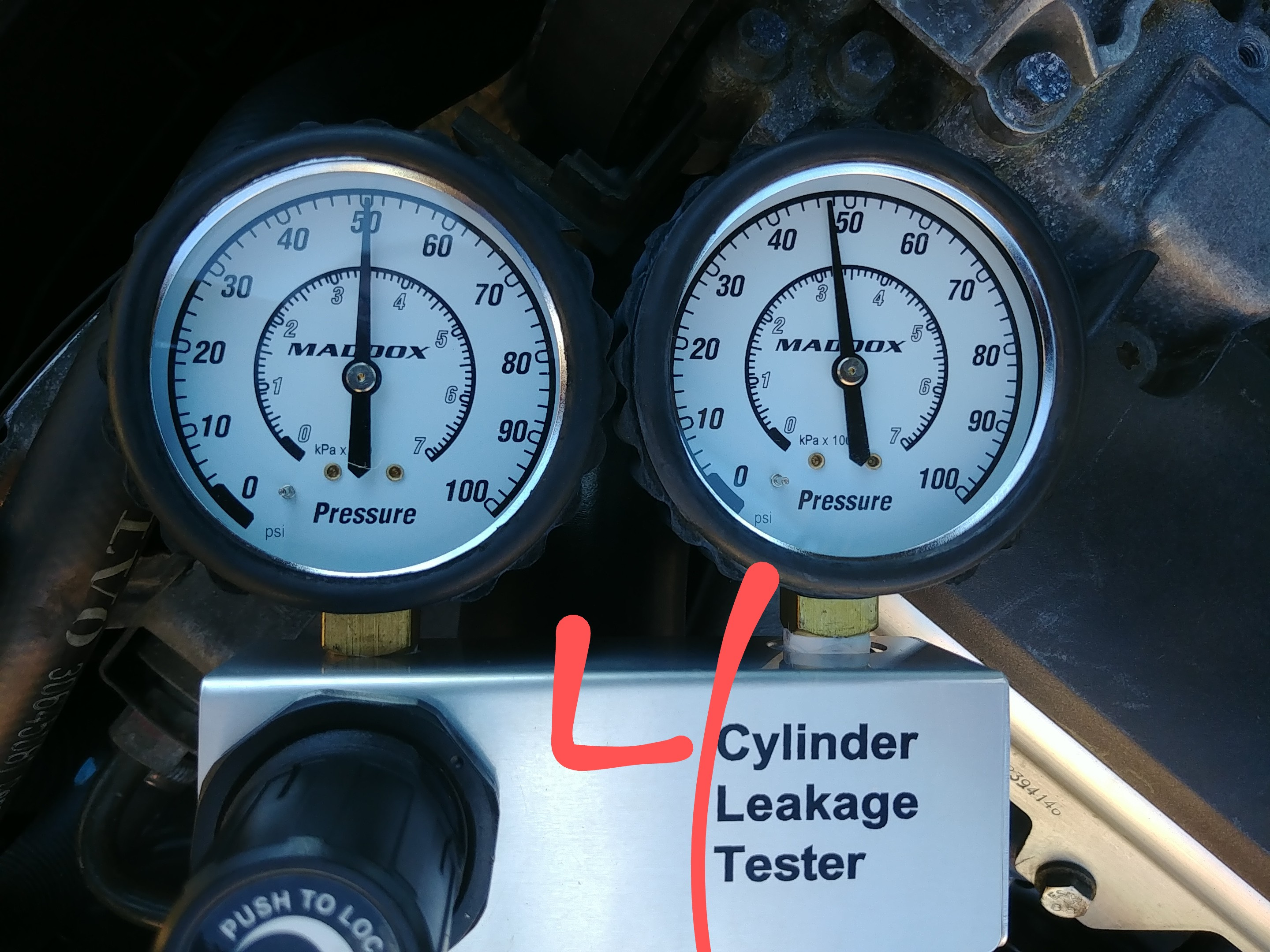

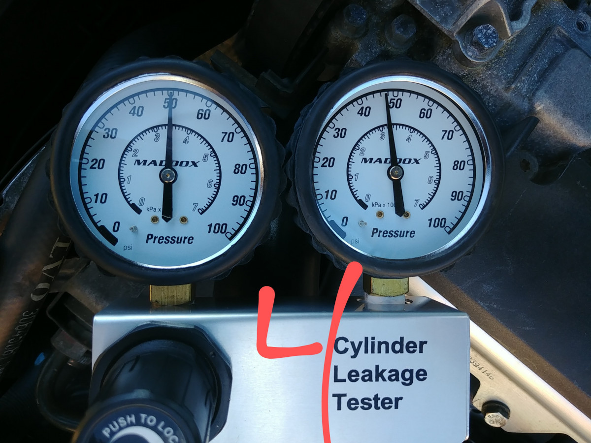

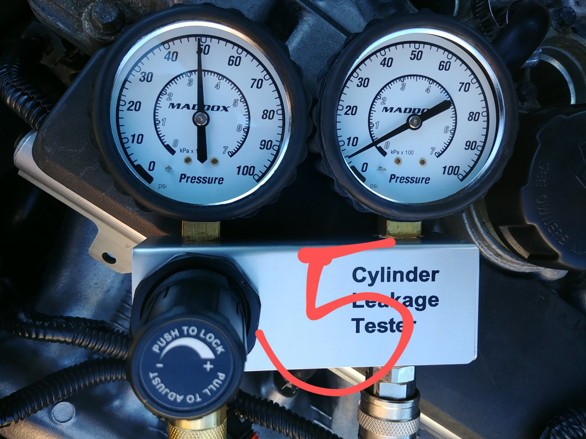

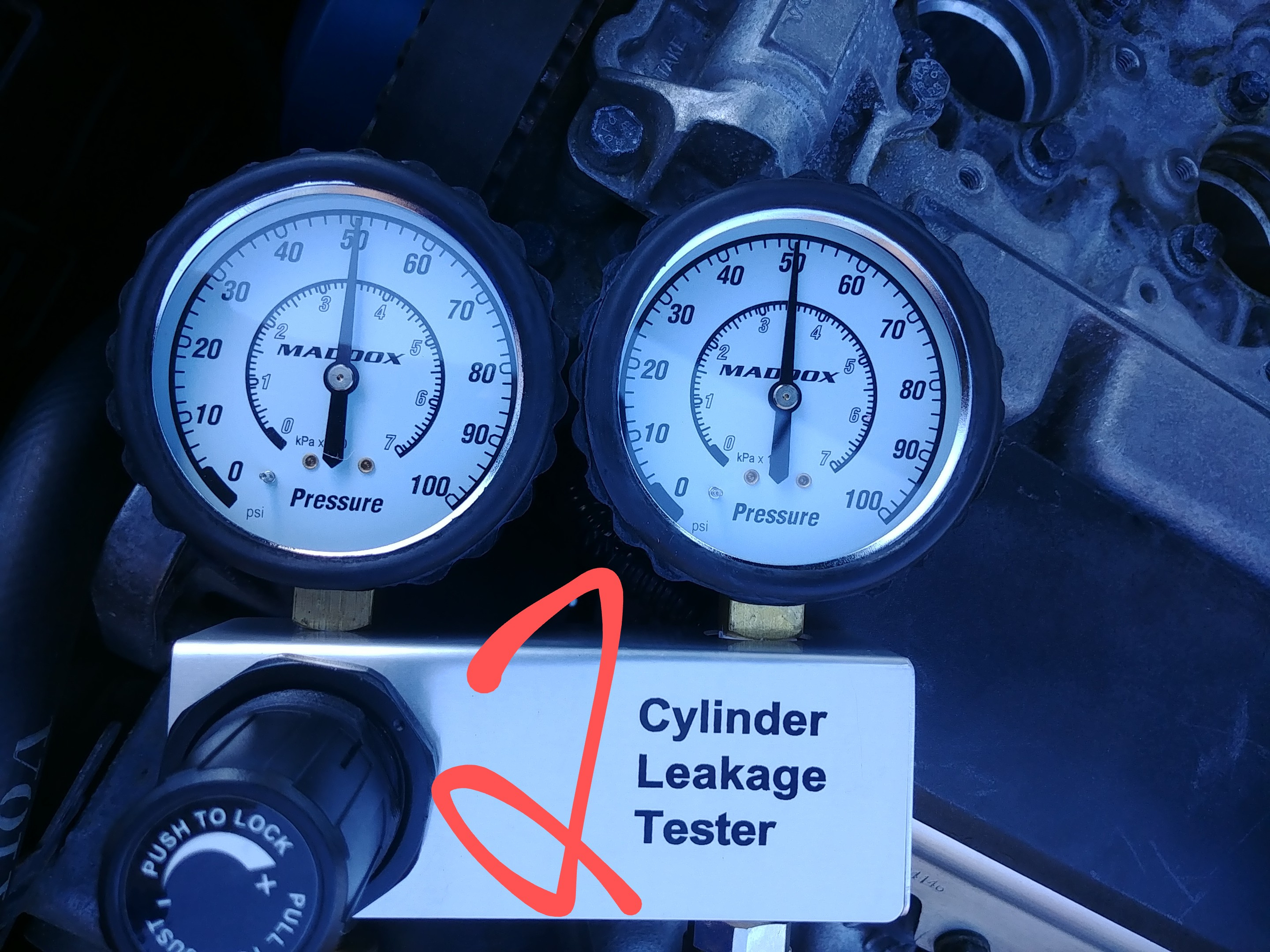

I didn't have time to do the cylinder leak down test the other day but just had some time to so here's the results. I put 50psi on each cylinder with each piston at tdc. How do I read this?

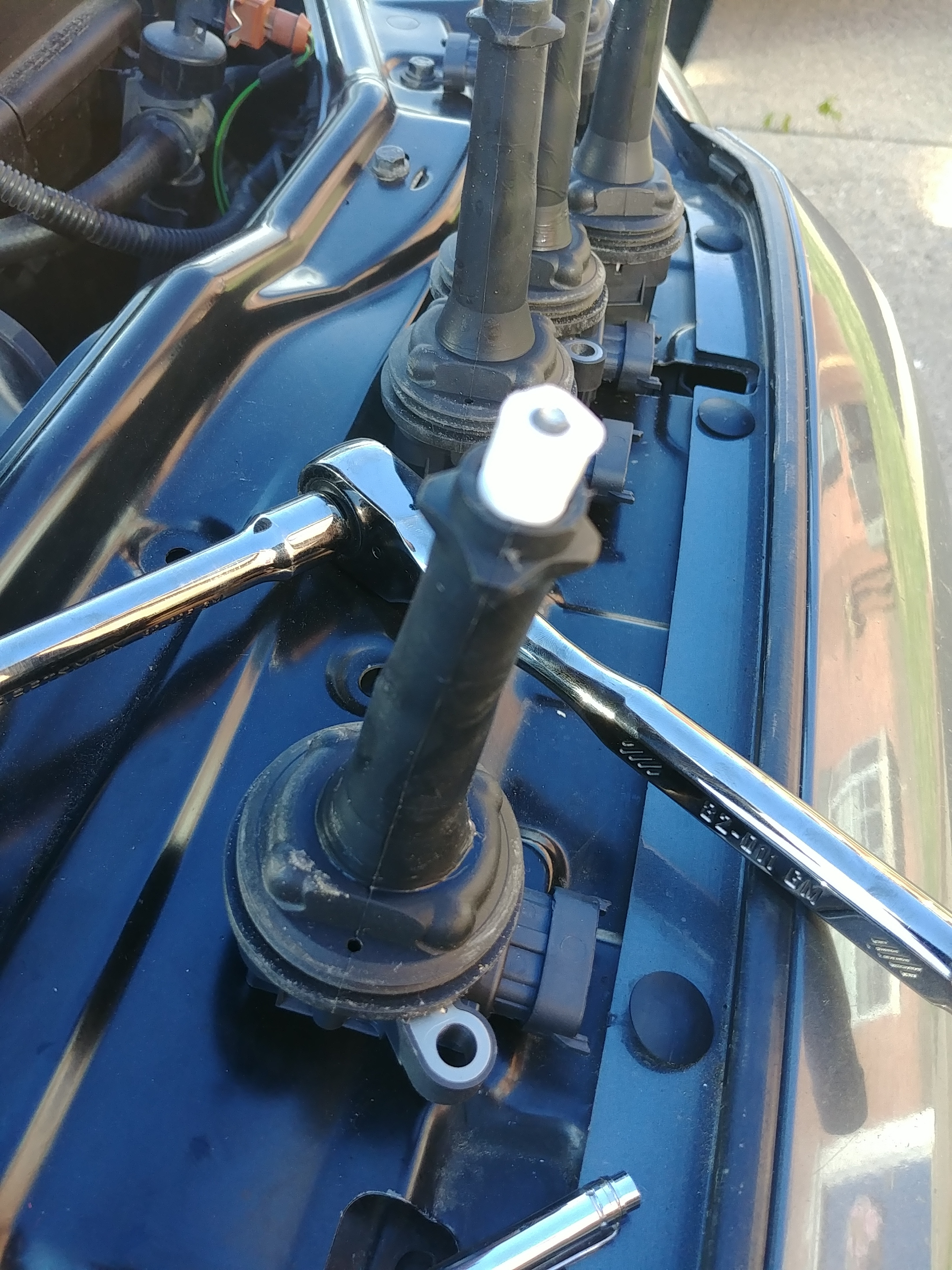

I also had a spark plug break inside a coil pack. Is this something that happens? I have no clue how it happened. But I know for a fact it just happened doing the cylinder leak down test.
