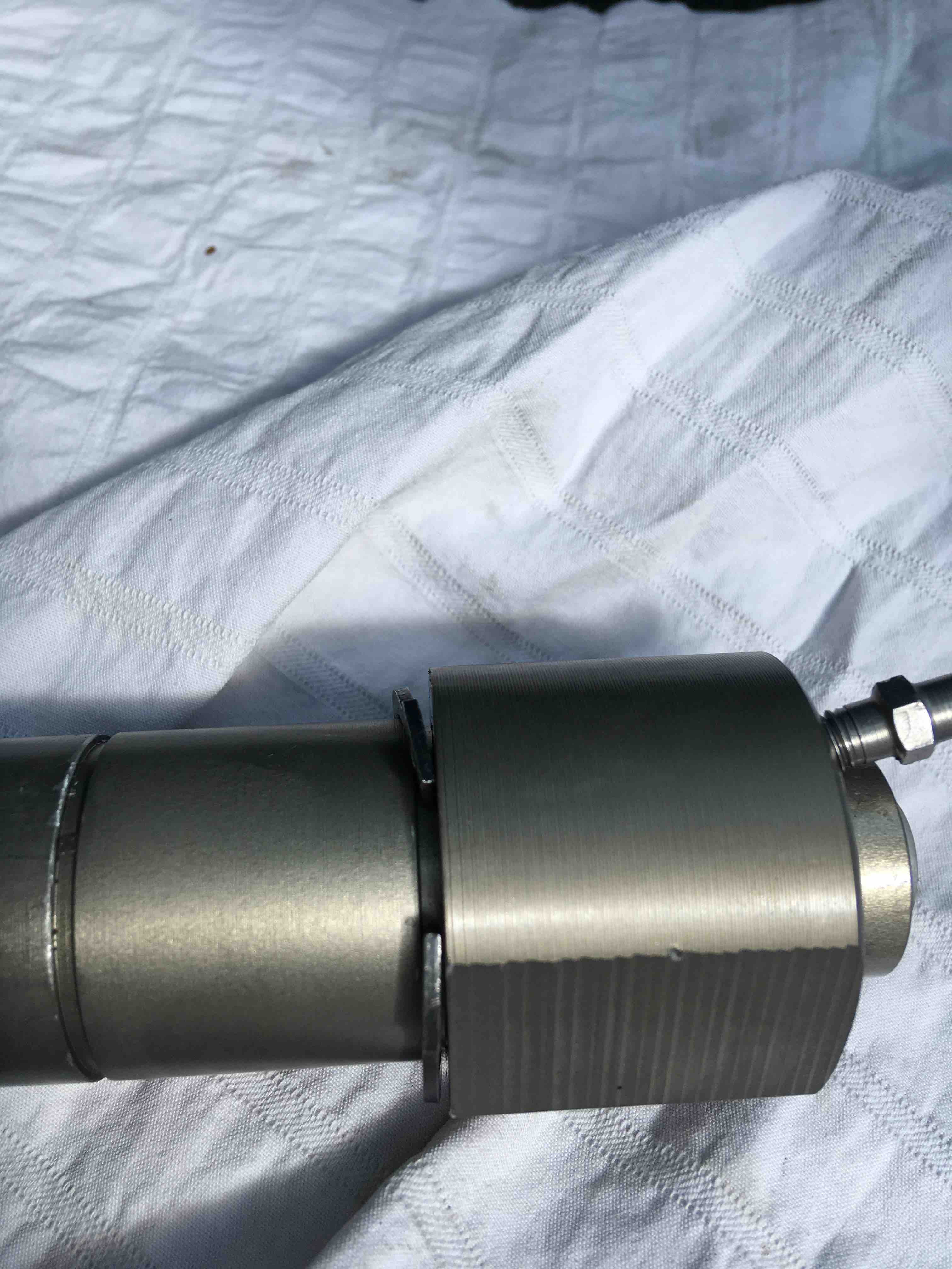

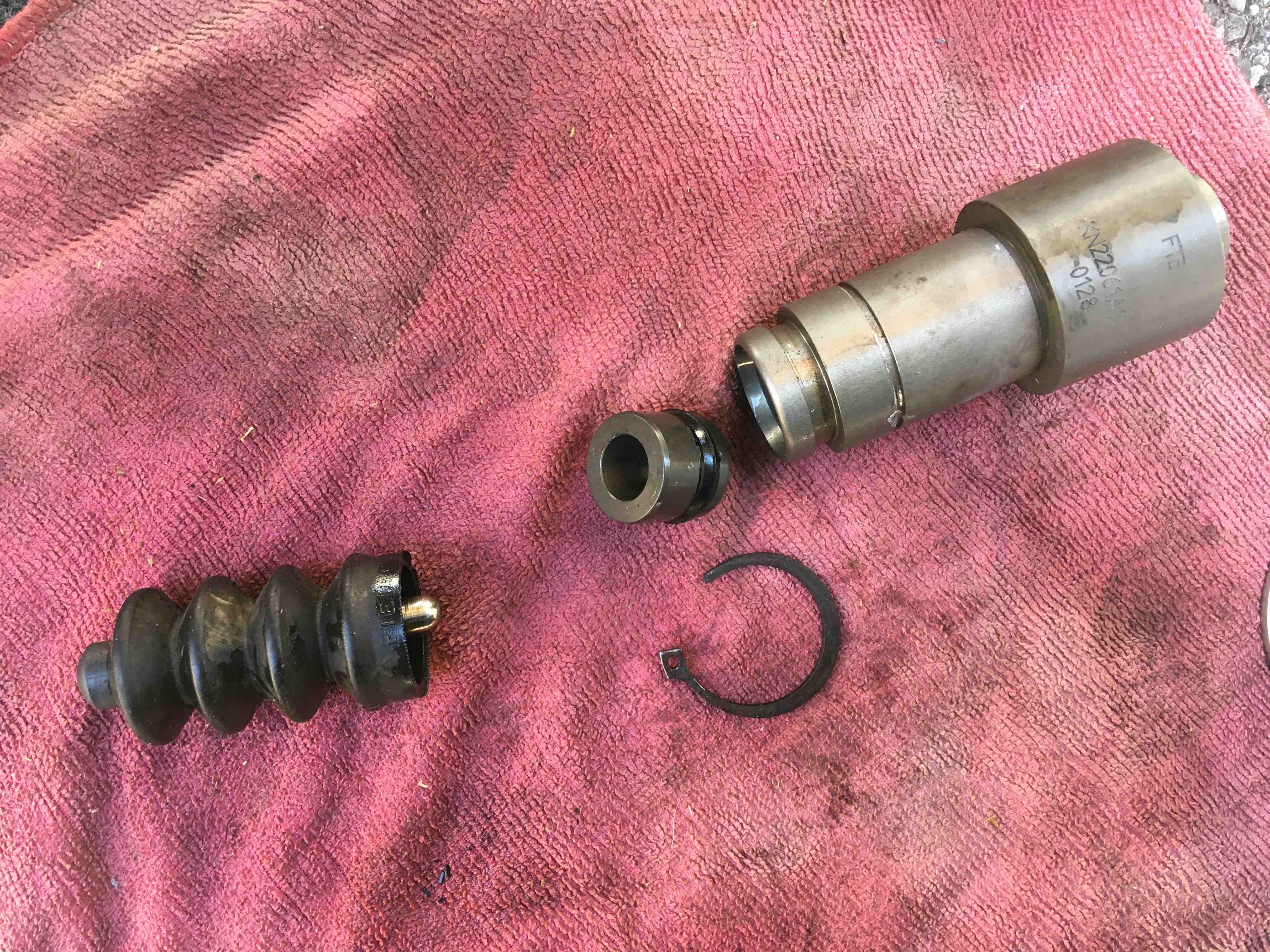

The seal just happened to get forced out by the pressure without the piston there to retain it. You can pull the piston and check the seal(s) for any damage. They may be usable, as long as they're not cut/deformed in anyway.
That c-clip groove looks fine to me. It doesn't take much of a lip for the clip to hold in place, if it's fully seated. You can now also check to see how it fits, seeing as you have the slave cylinder on the bench.

Chuck W wrote: 06 Sep 2020, 07:42manovlov wrote: 06 Sep 2020, 00:43

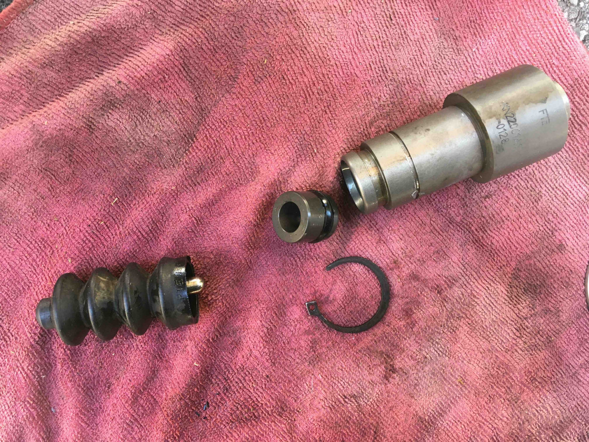

Post a picture of the c-clip not installed, just to see if it's bent or deformed at all, because in the picture above, it looks bent and pretty useless.
Pics :
The c-clips in no more straight, and I'm surprised to see how much he has been opened... The brand new c-clip I have had the idea to order "in case"... Well played Manov. And this is the original part ... which correspond to this part

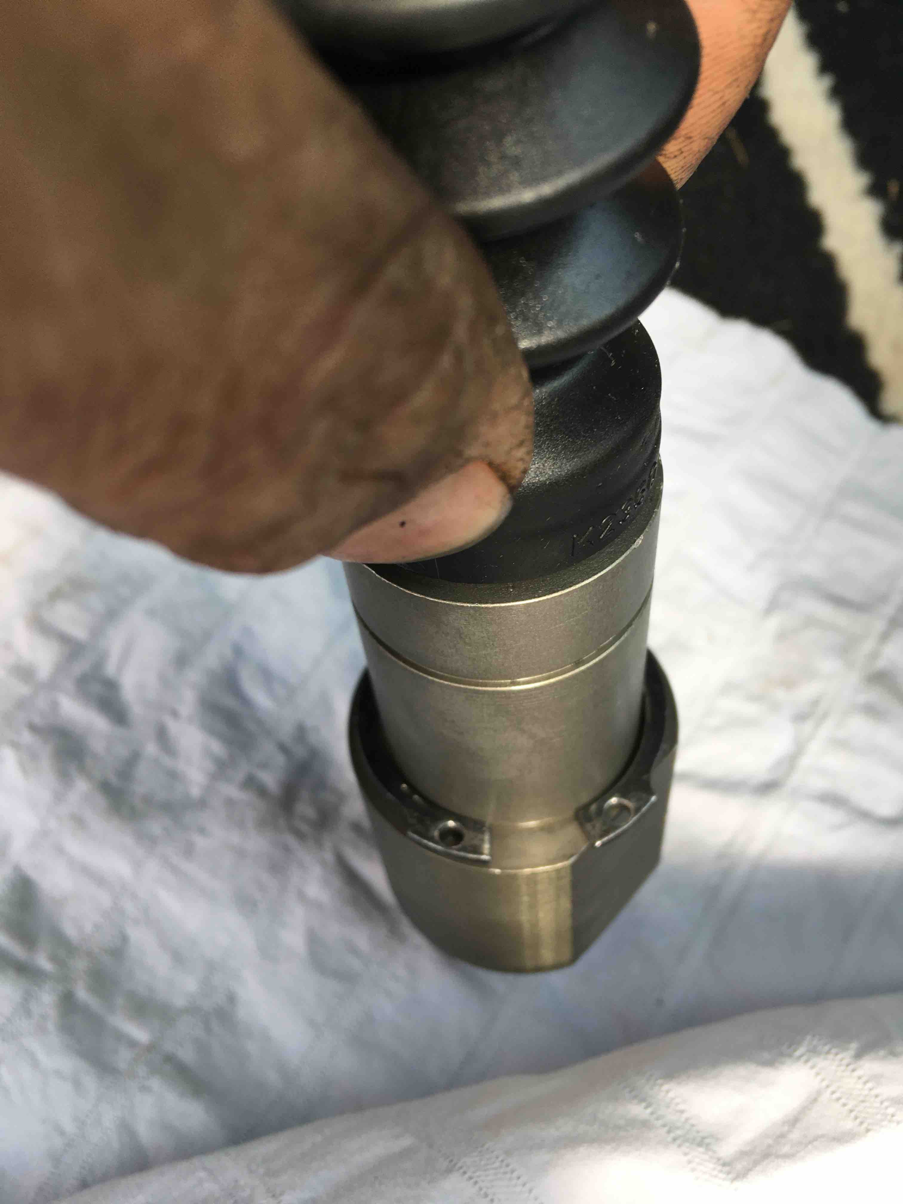

I've just had a look to the slave cylinder, the seal seems to be okay. But I don't think to have enough fluid to fill up the all circuit.

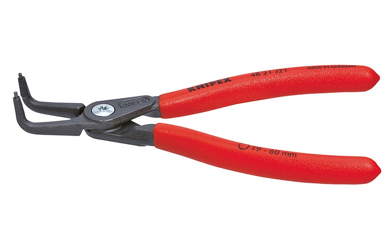

You should invest in a set of the c-clip pliers. It looks like you probably damaged the c-clip trying to lever it on there without the proper tools.

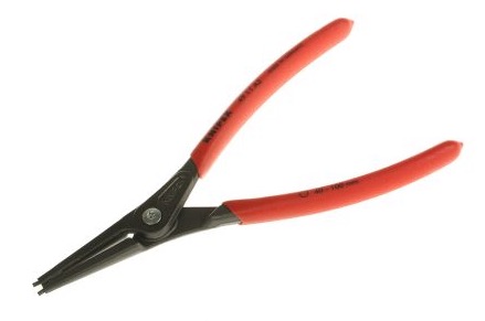

You're right. This c-clip has been installed with a bad plier and I bought 2 new ones from Knippex :
At the end, the slave cylinder is in place and the clutch works fine. I've tested on a little distance because it's late, I will make a full test tomorrow.
I've also bleed the brake fluid and the brakes lines, putted out all air bubbles and now they are strong.
I do thank you all, you Guys, who have given a little bit of your time and all yours good advices to help me to solve this issue.

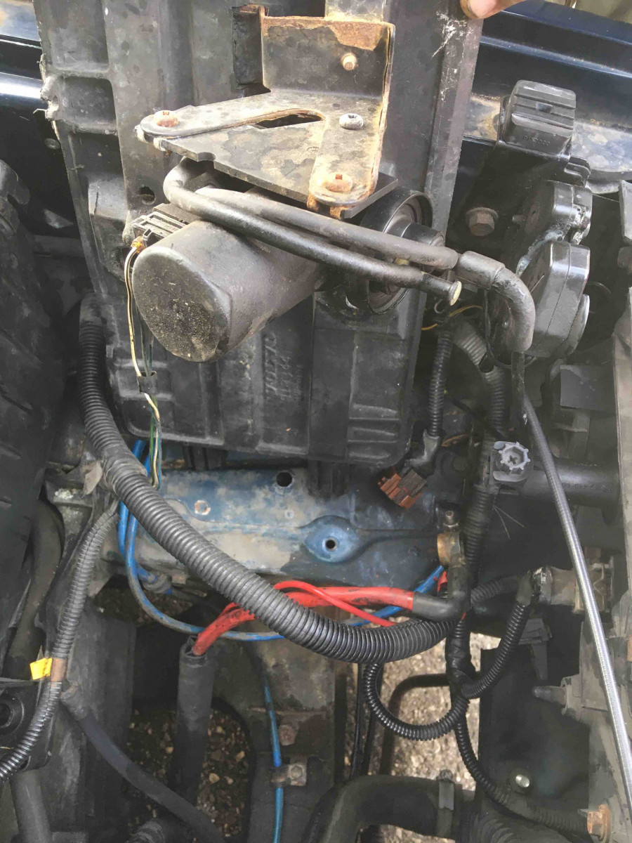

A last question: to work properly I have moved the battery plate, and I found this underneath. Can someone tell me what it is ?

- Posts: 15506
- Has thanked: 2210 times
That is the cruise control pump in the picture.
