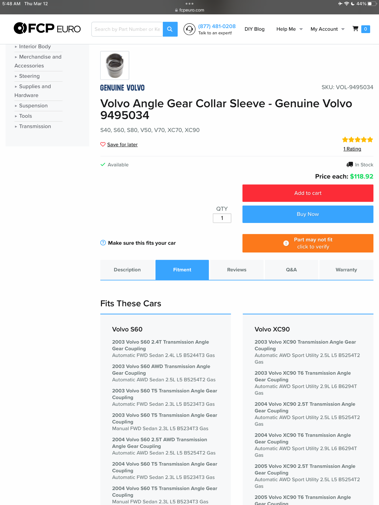

New P2 sleeve $118 from FCP currently
P3 sleeves are $300
