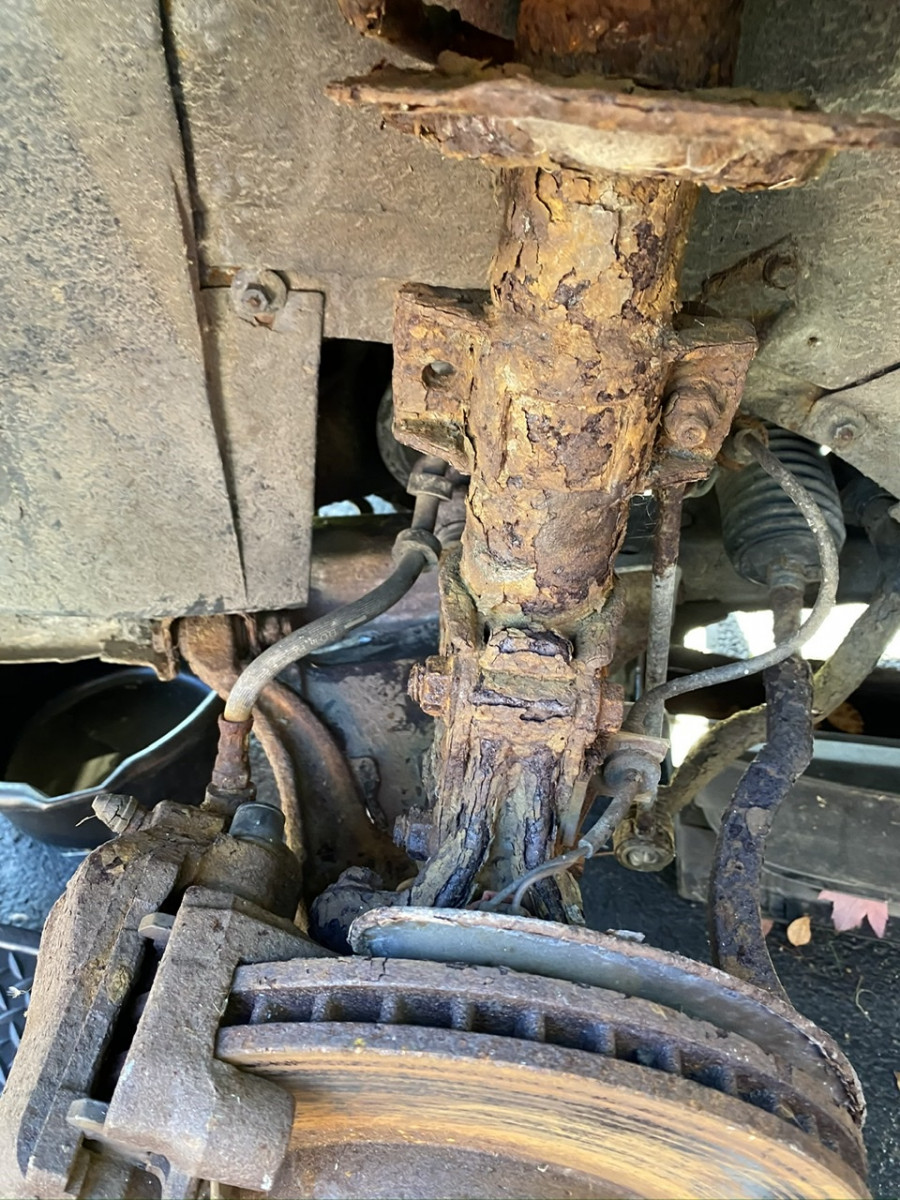

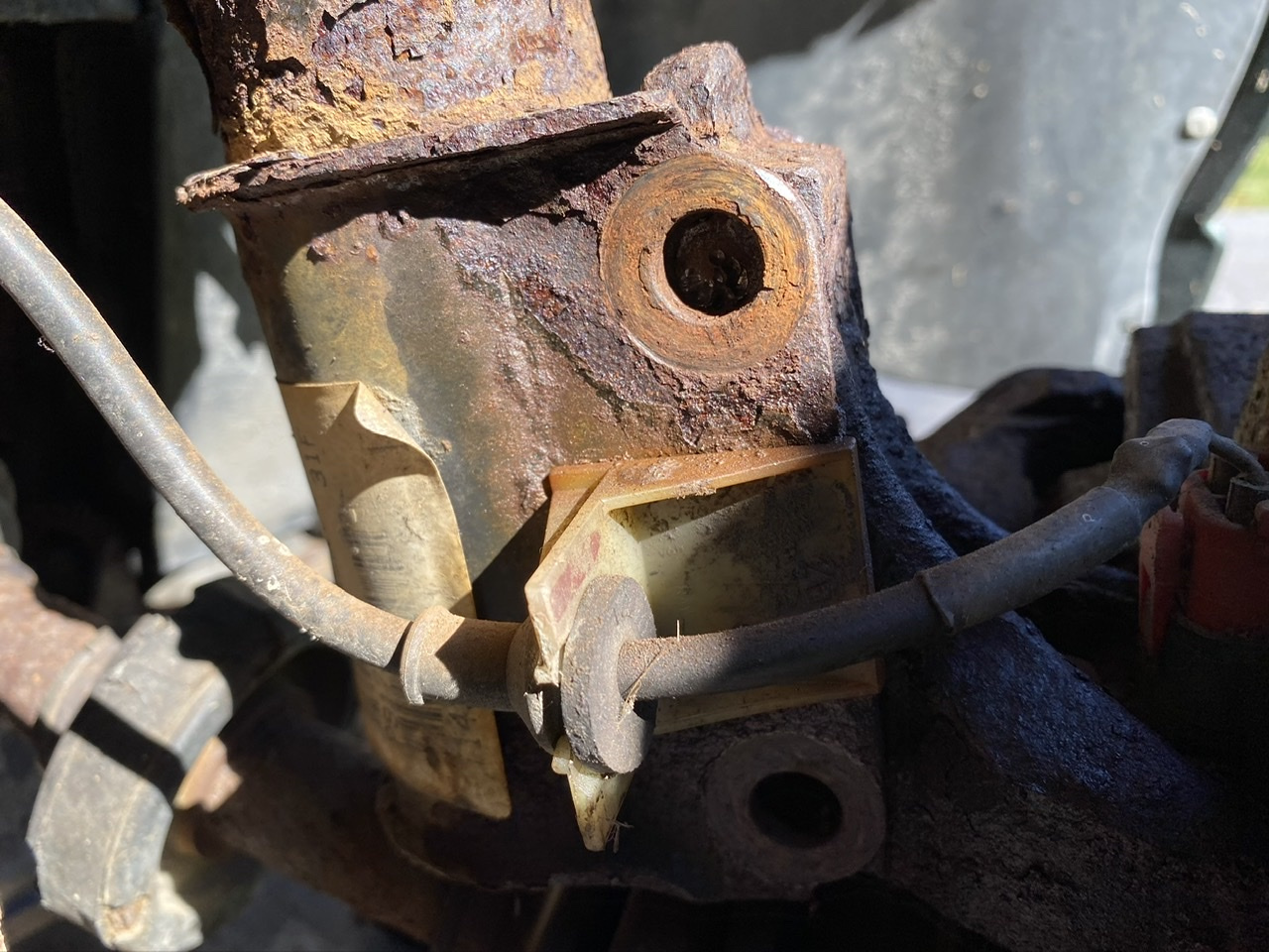

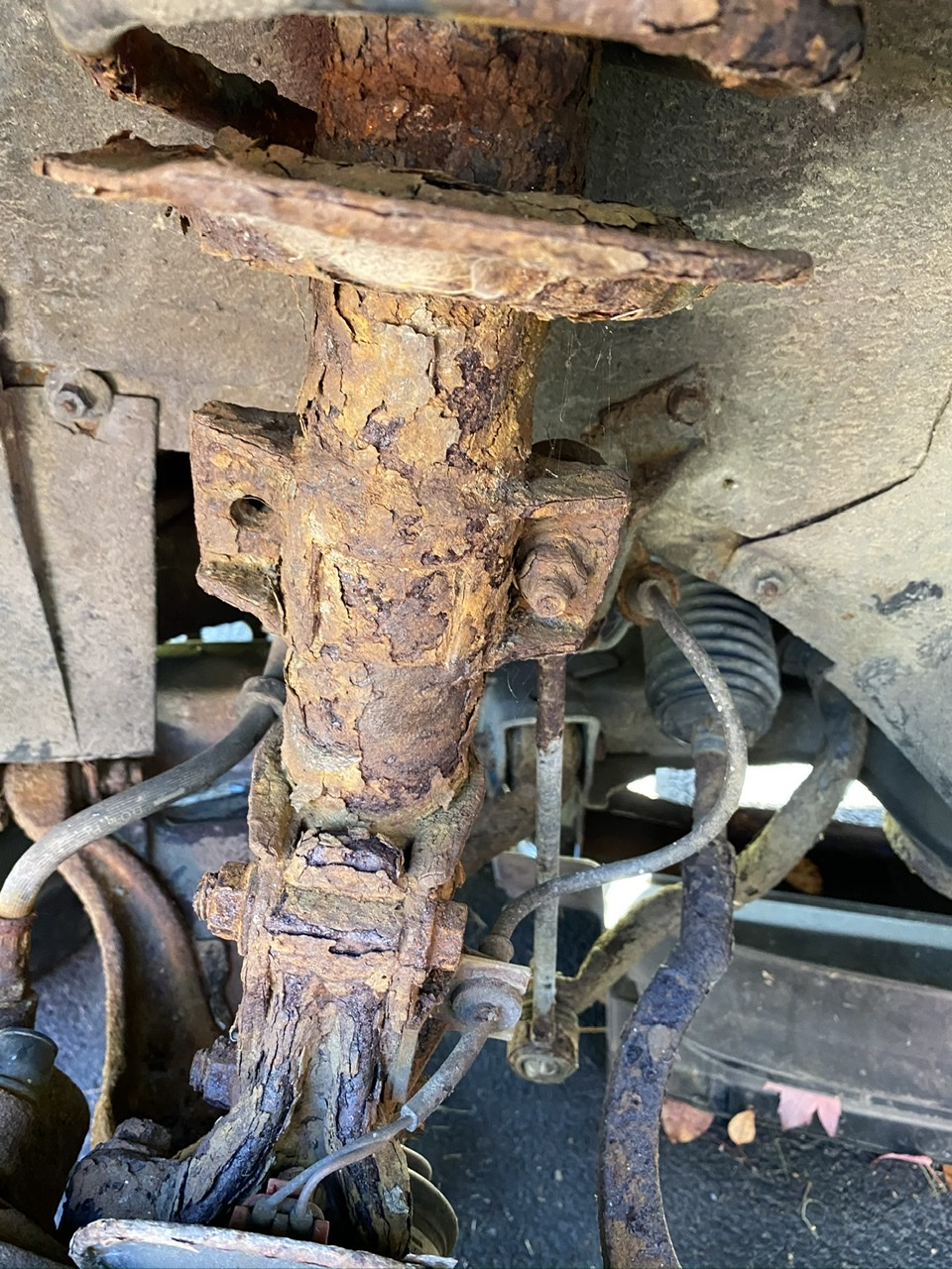

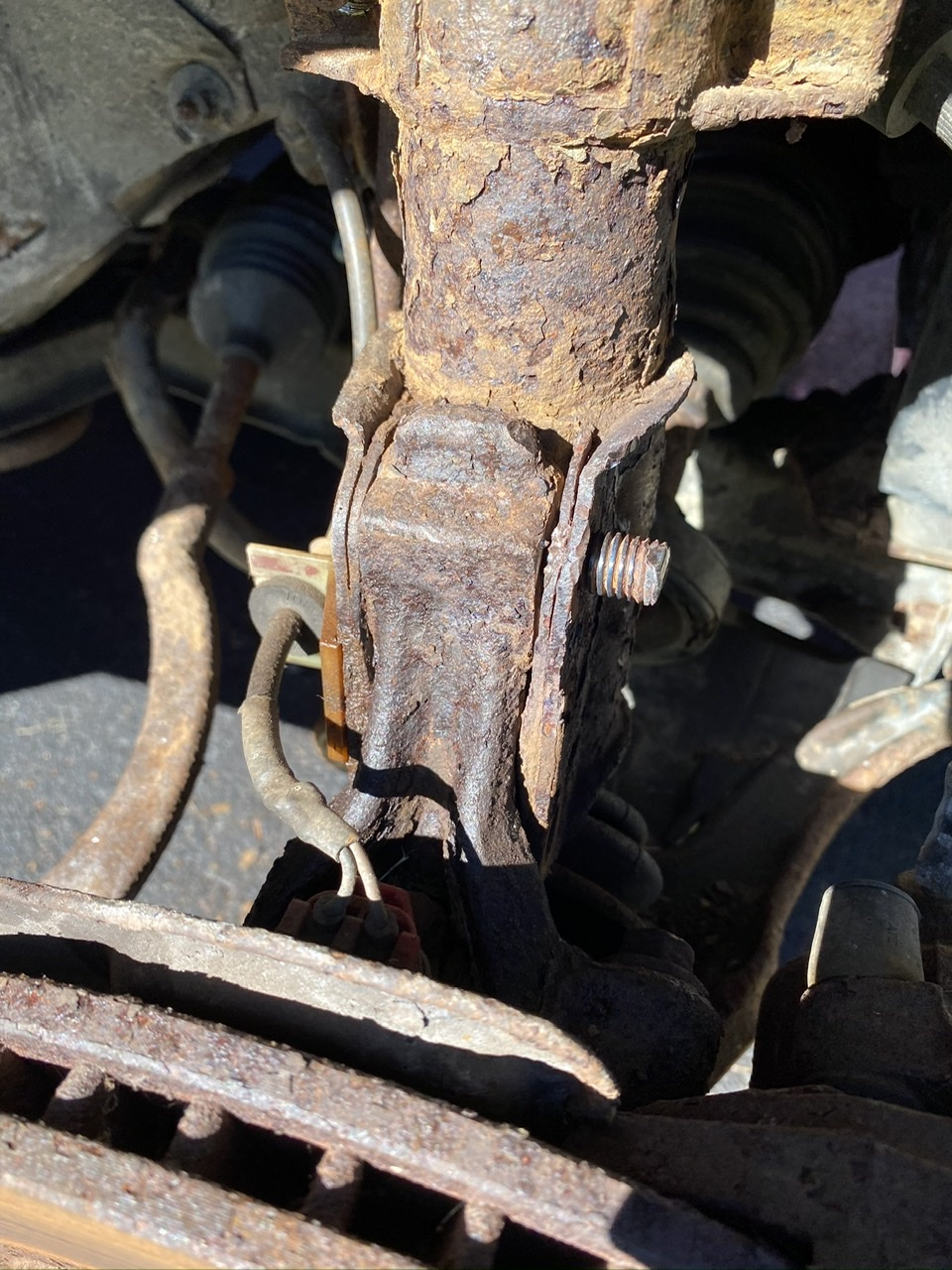

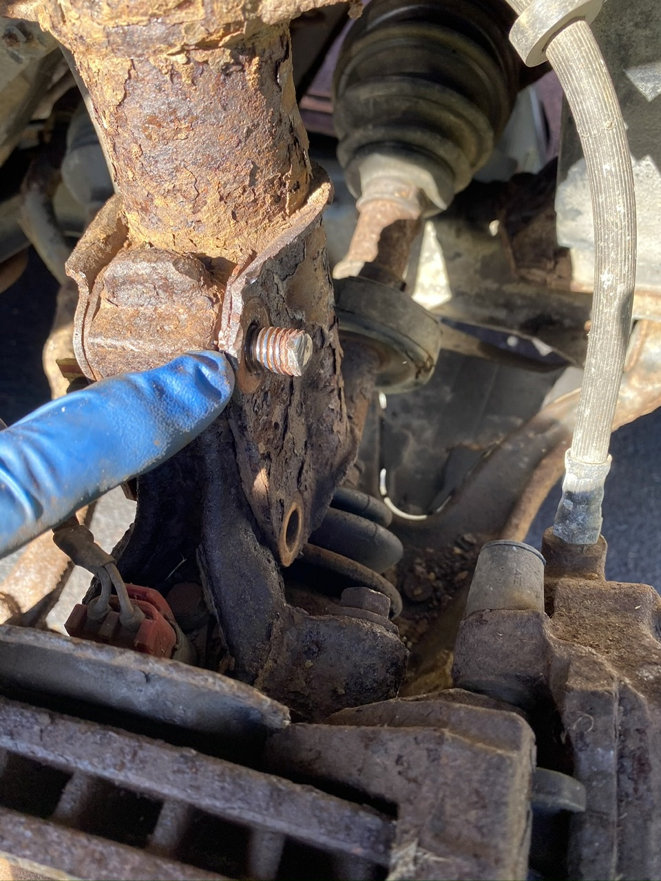

Removed front struts.
Right side upper Strut bolt snapped off inside strut. Ugly.

That’s some of the rustiest rust I’ve ever seen.
- Posts: 36153
- Been thanked: 4069 times
I’ve been contacted by the Museum of Modern Art
Even the rust has rust. Amazing.
I got lucky with those sway bar links. Wire brushed them, sprayed with PBB, the put three pumps pressure up on the link with the floor jack. They then zipped off with the Bosch hand impact and 15mm hex?
The pressure up acts as a counter hold so you don’t have to fuss with the Torx. Wisechatmgr and Indeveloped this technique , the Jack Counter Hold MVS (tm) last year

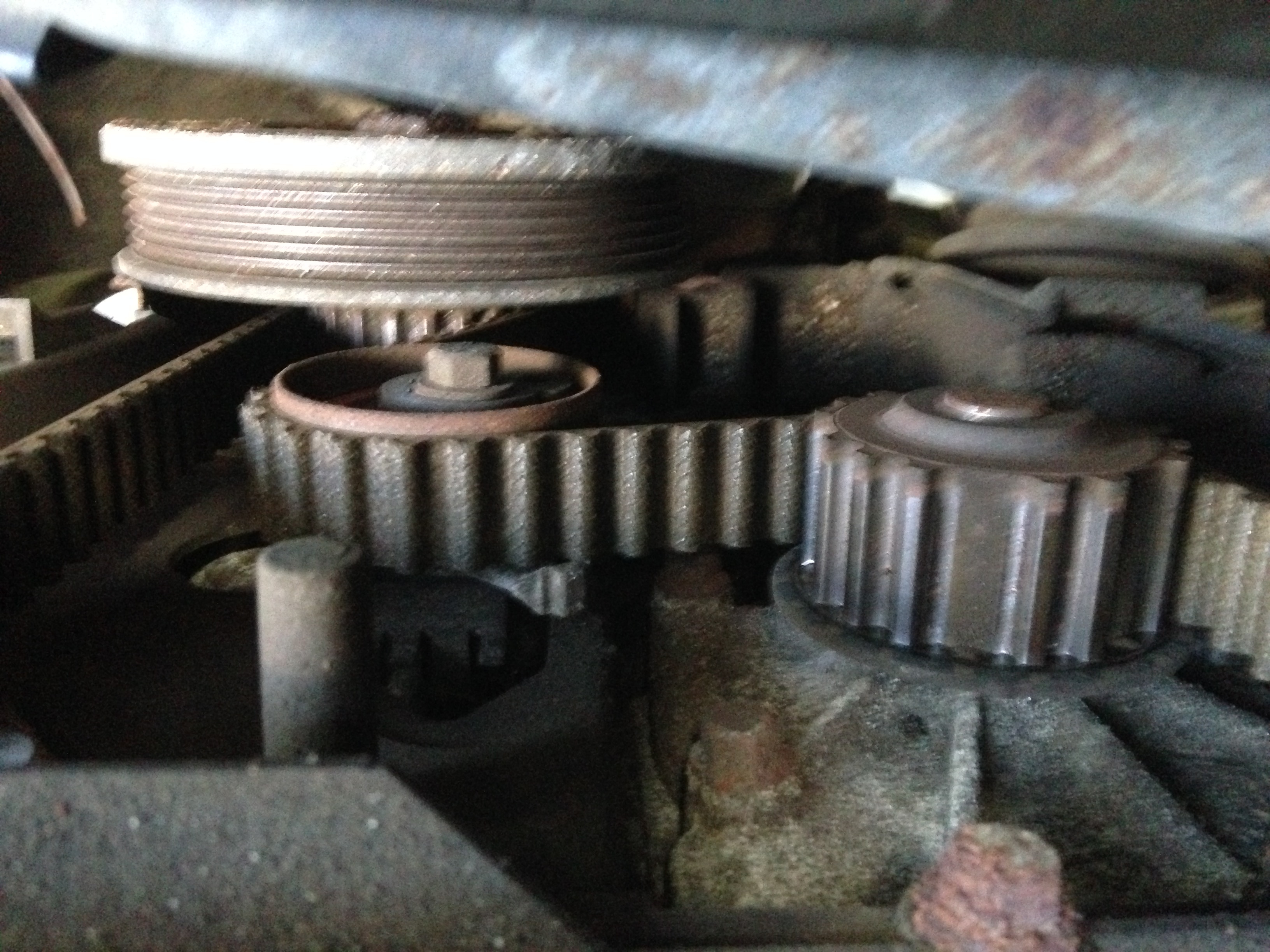

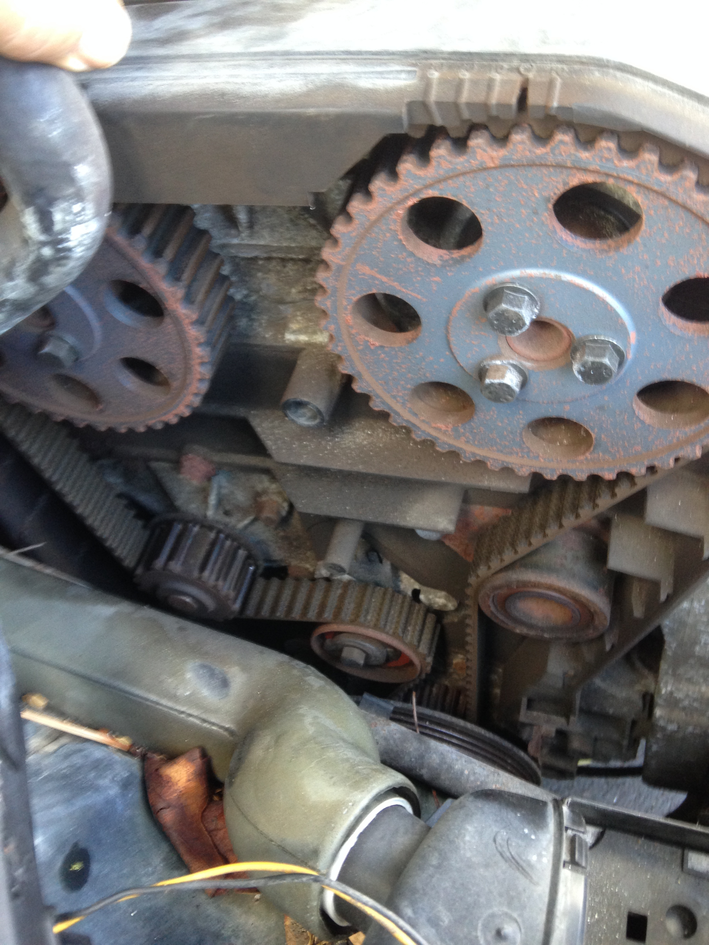

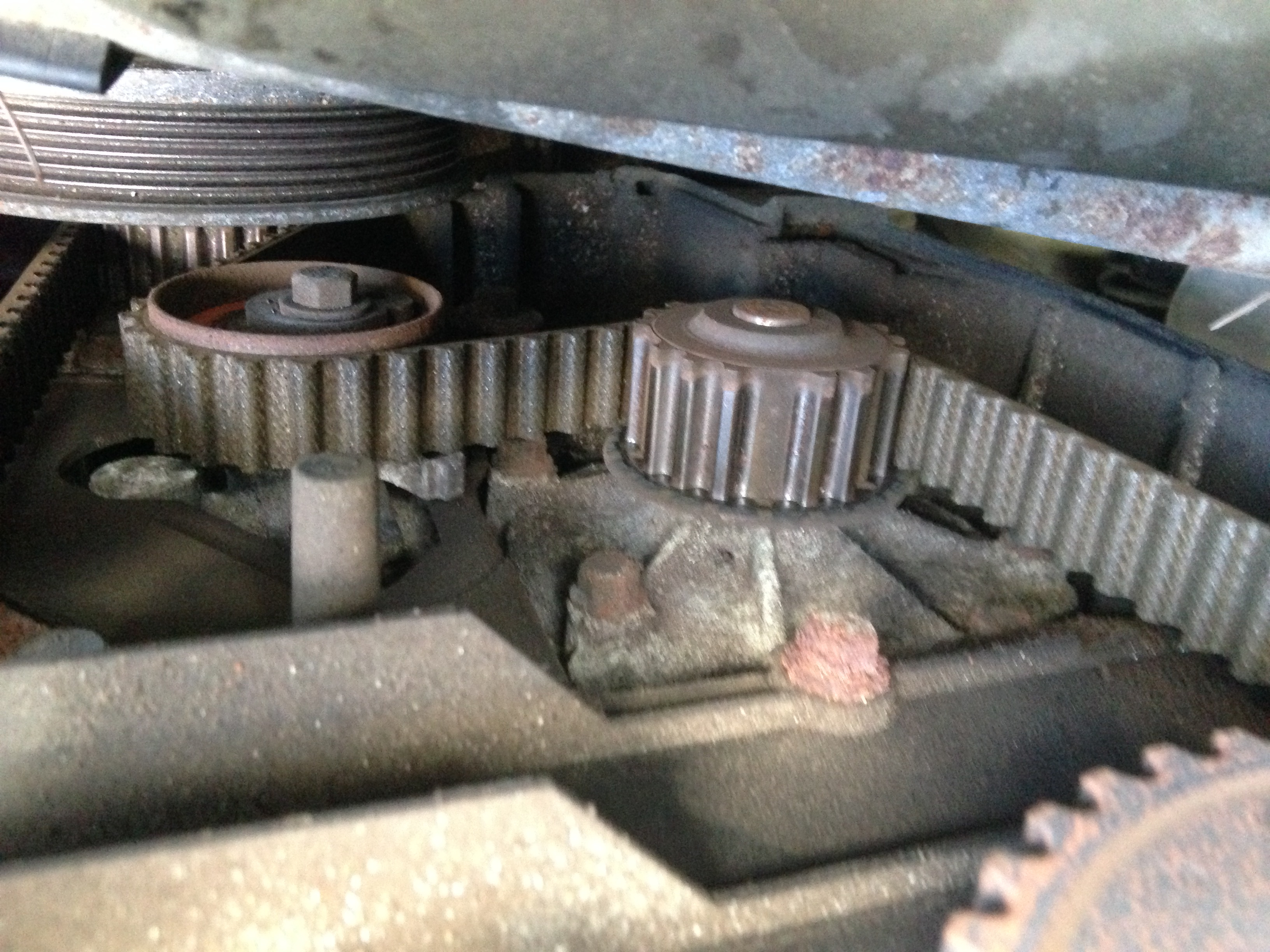

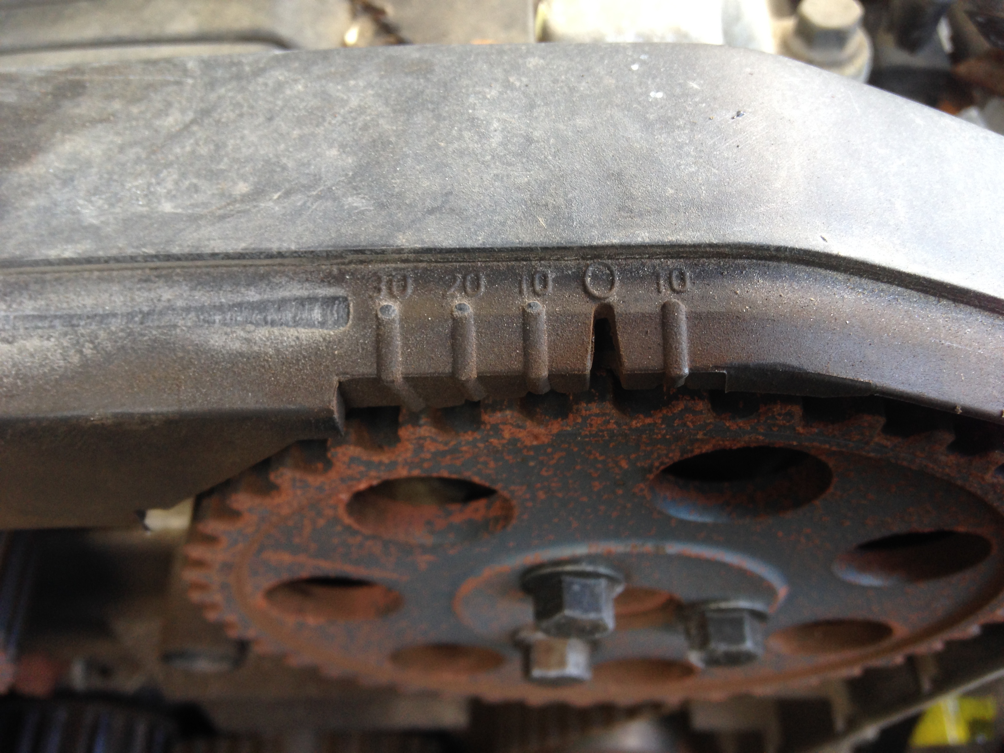

Very late 1998 build so sure to have Mechanical timing belt
Maybe its in good shape??
#Optimist
#Optimist

Woo hoo! Mechanical tensioner but it is ugly and very loose. Changed st 77k maybe, now 180kabscate wrote: 02 Oct 2020, 10:55 Very late 1998 build so sure to have Mechanical timing belt
#Optimist

Wow, that poor car did sit for a long time. Amazing how much rust there is on even the pulleys and mech. tensioner.
