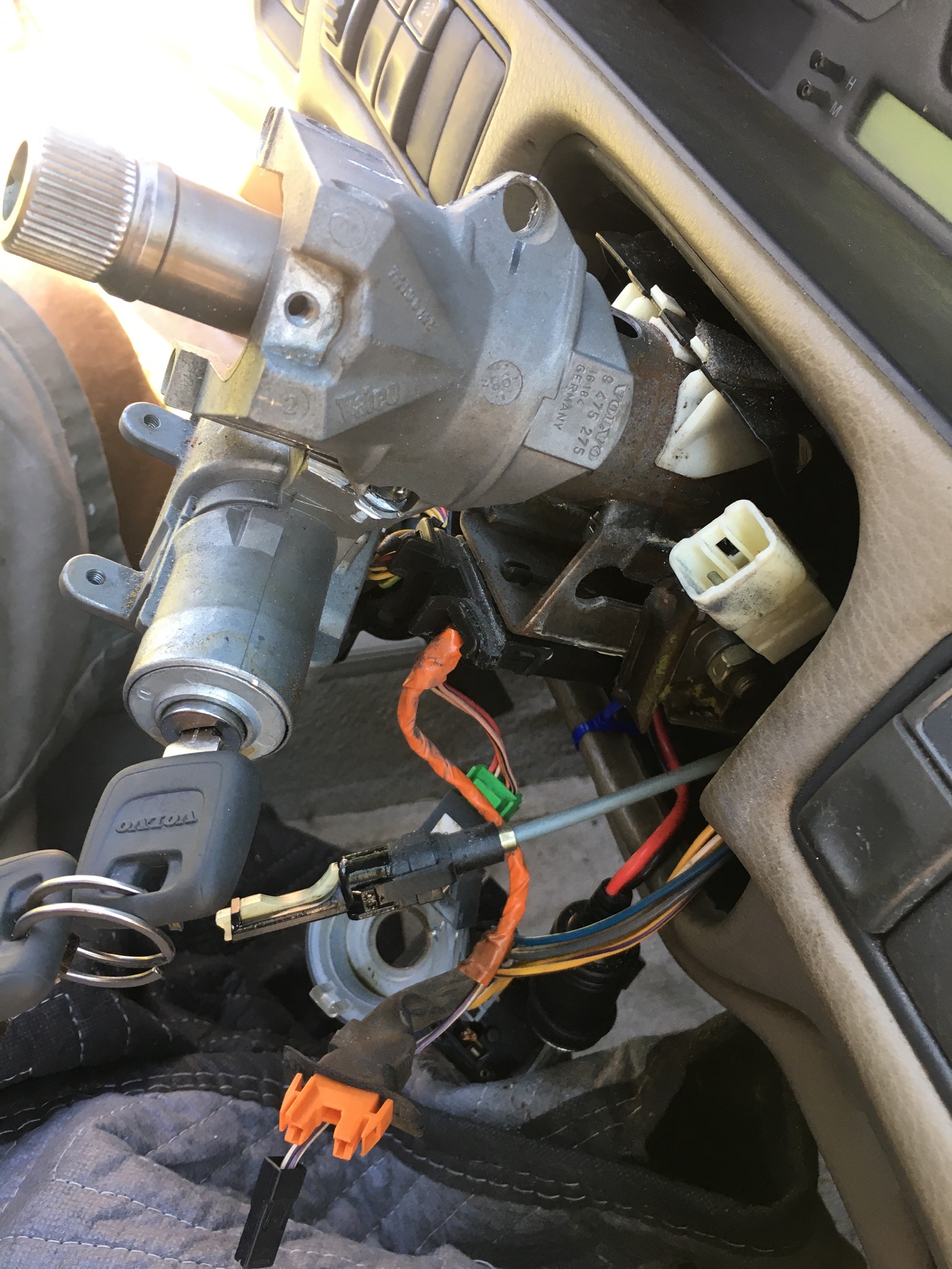

It’s the big day today. Parts came in from Volvo, it’s drill off the old, install the new.
Keys work perfectly in the new unit.

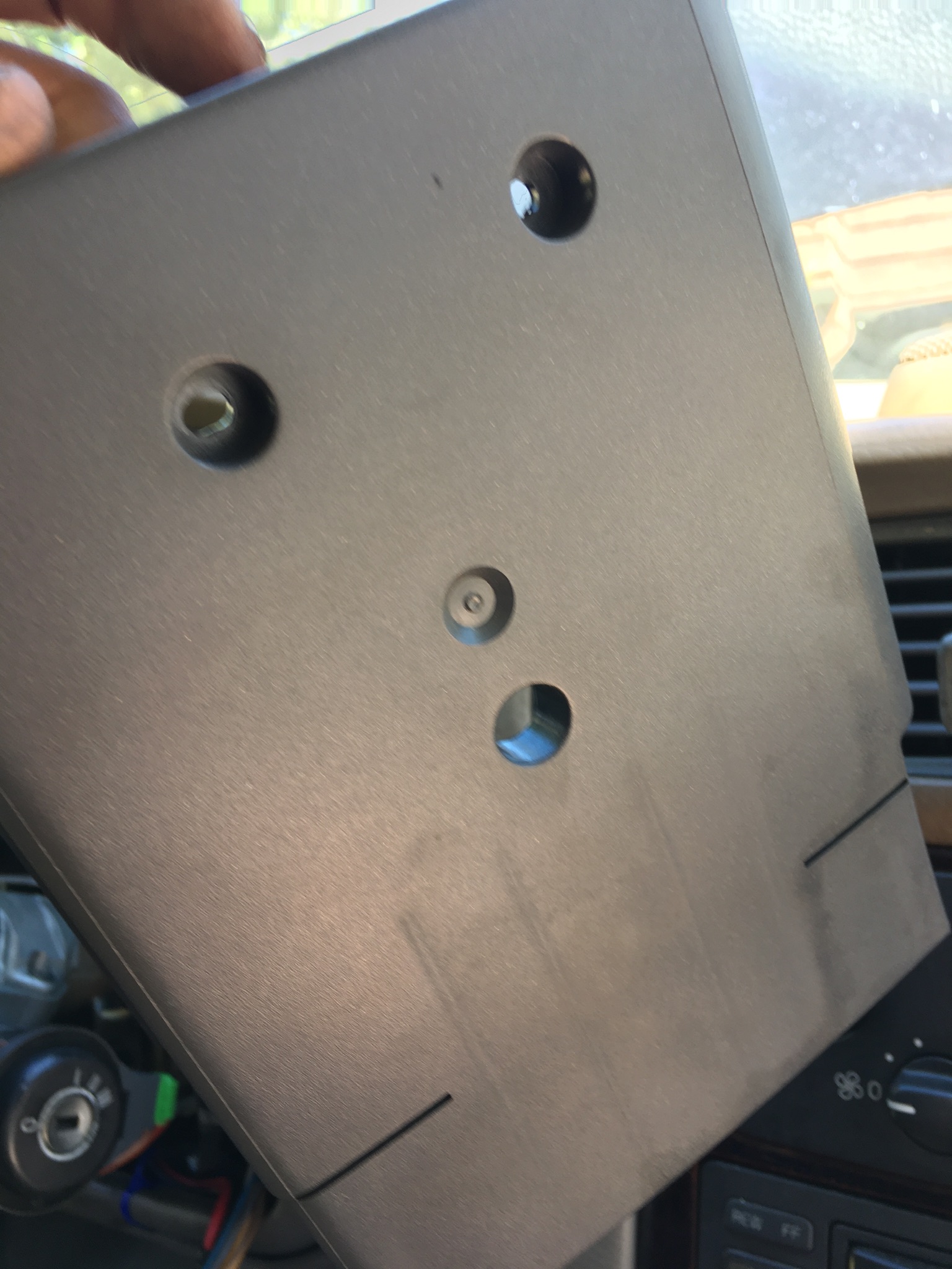

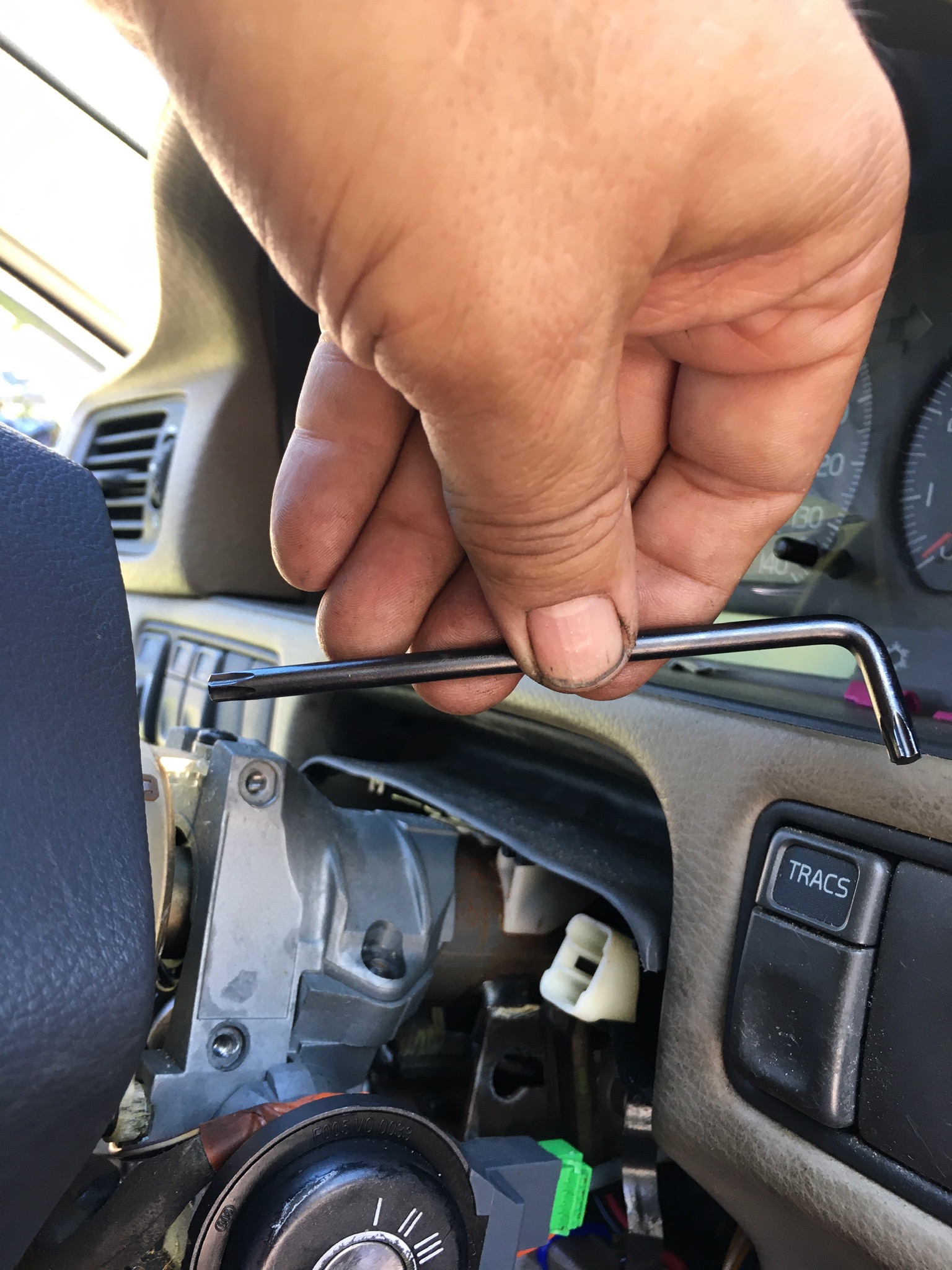

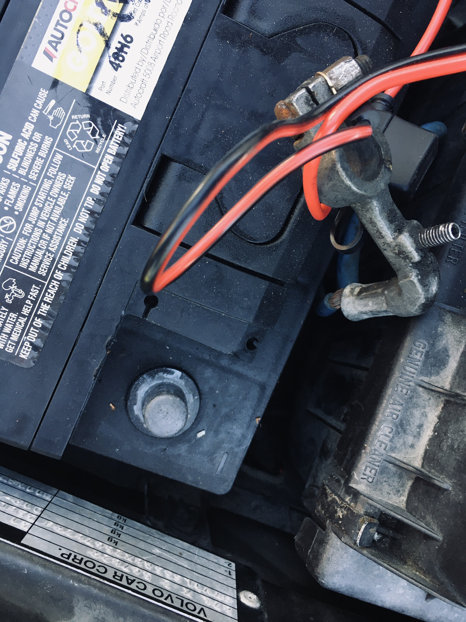

Well, first step of course.

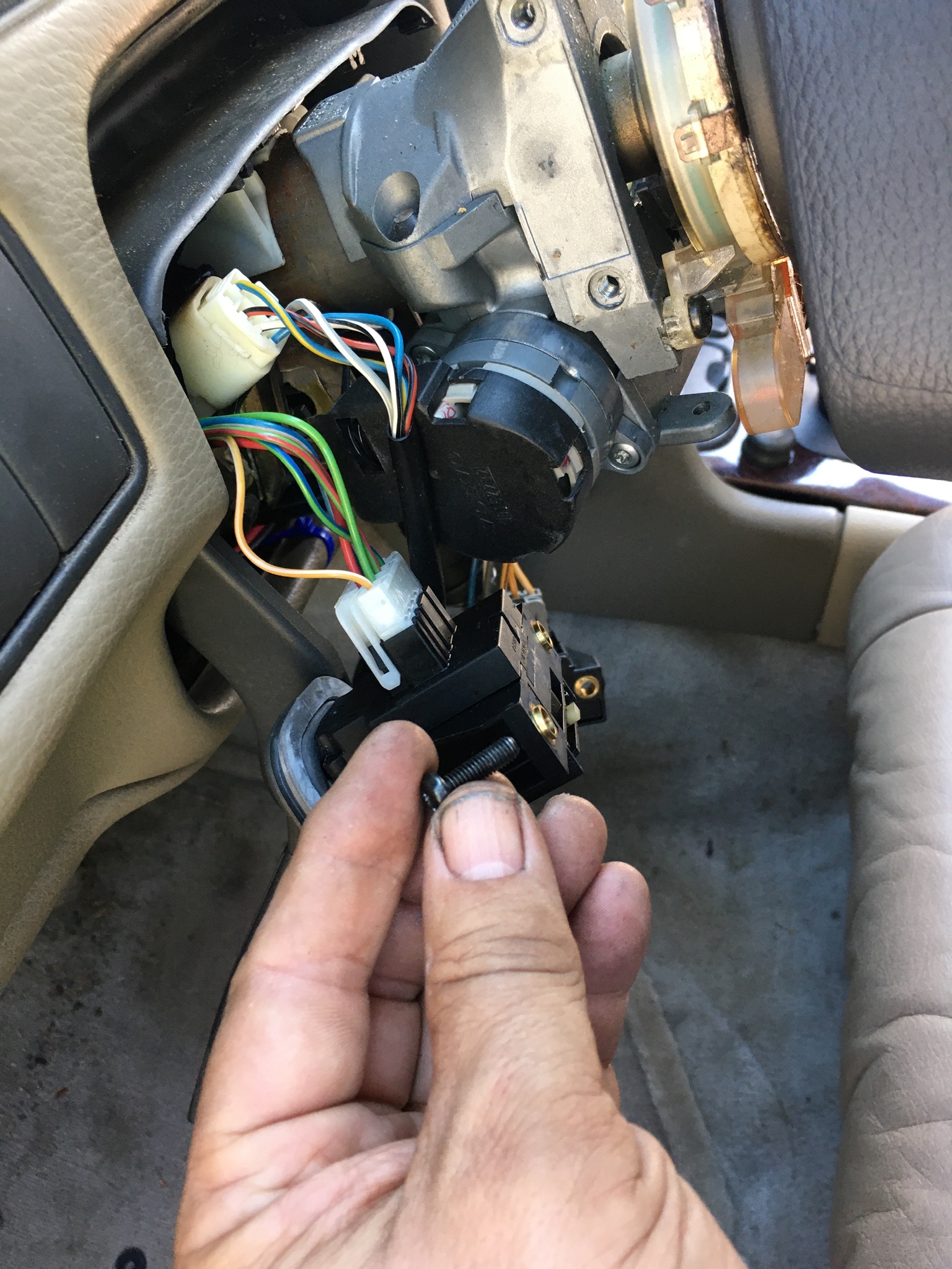

Now the three T25 under the lower steering wheel trim, the T20x4 holding in the wiper and turn signal stalks

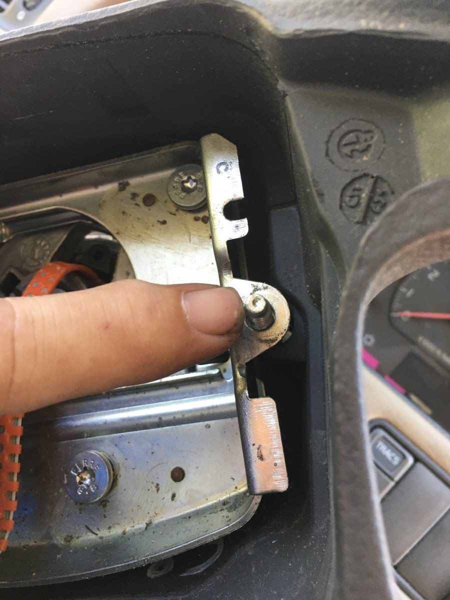

Ignition switch, then the two Torx holding the air bag in. These take 20 full turns to release

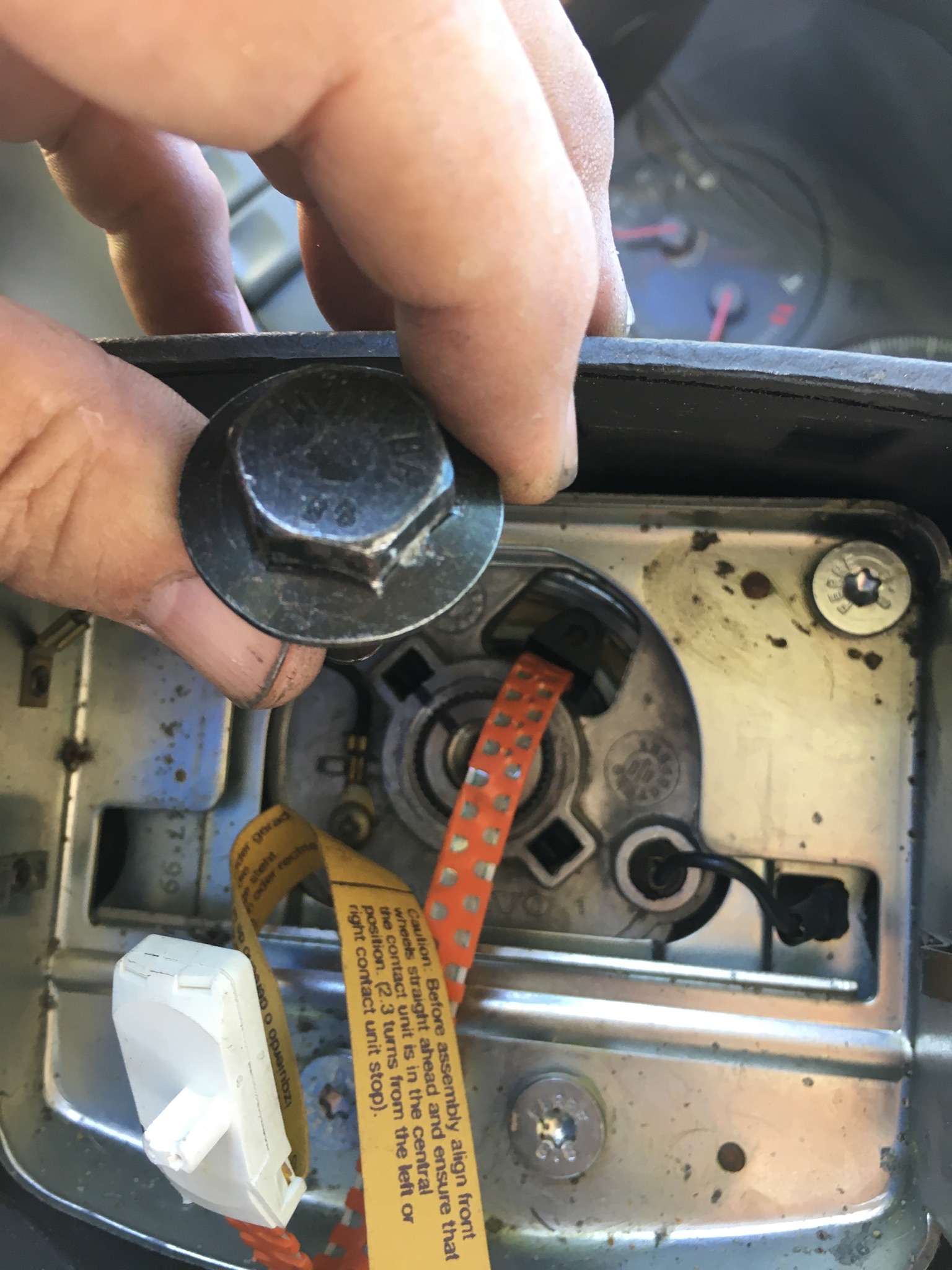

Big 17mm bolt for steering wheel

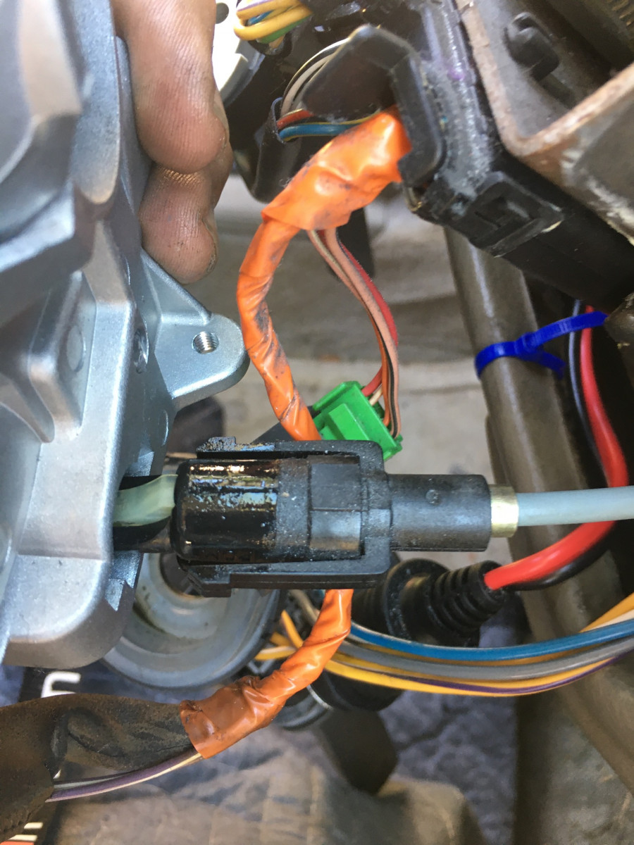

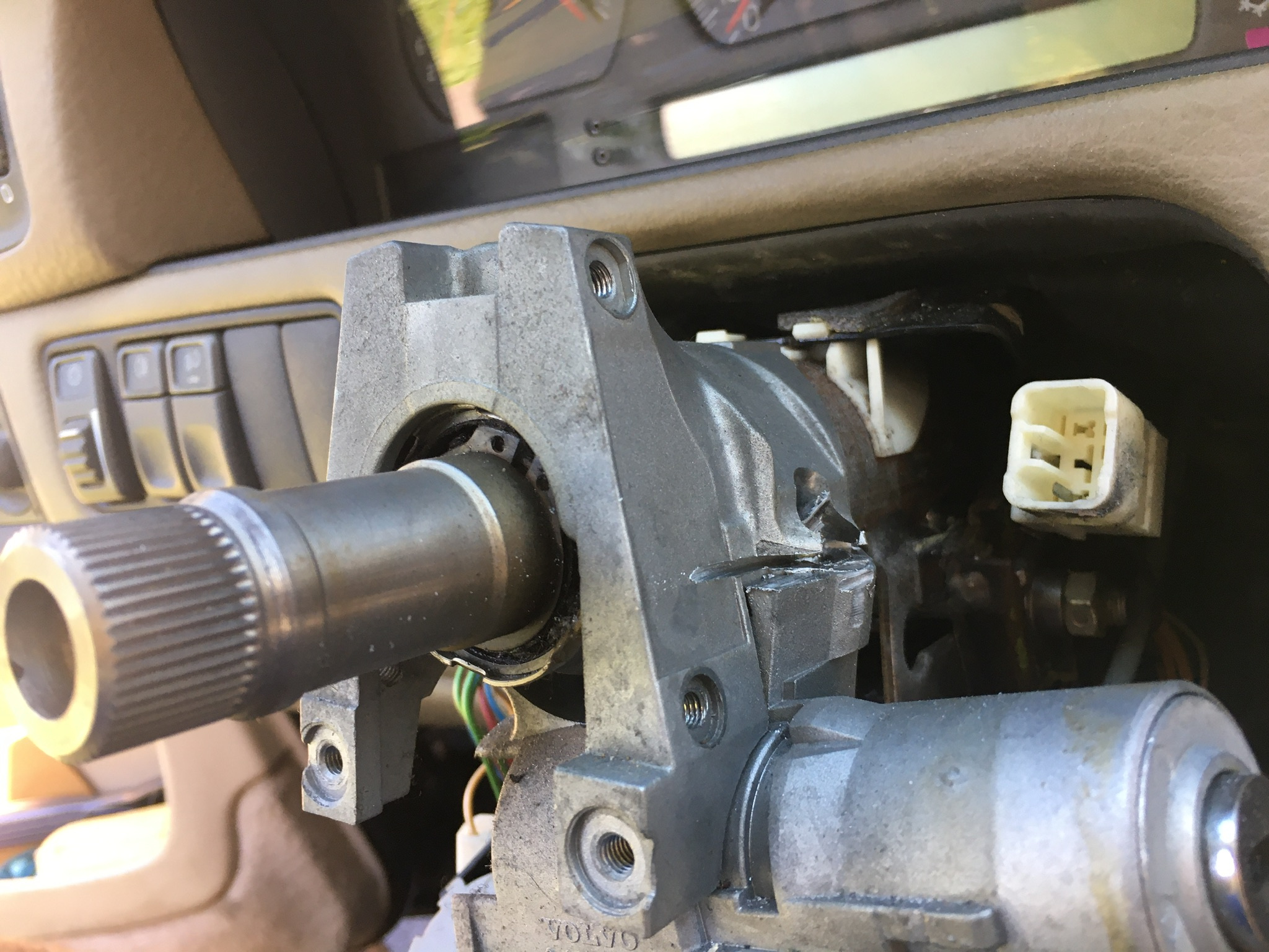

Get the wiring and shifter interlock out of the way unbolt the clock ring, unclip the antenna ring.

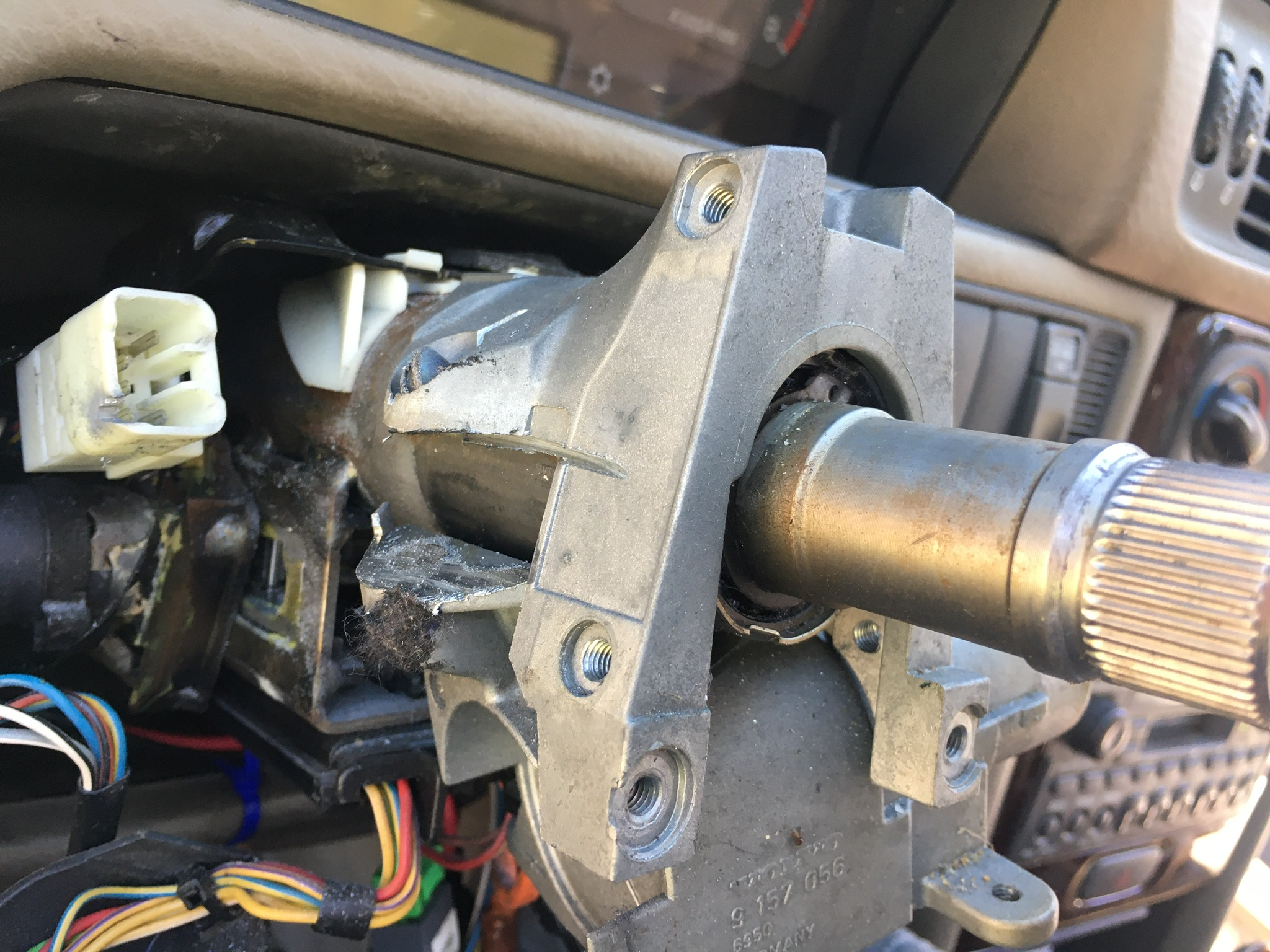

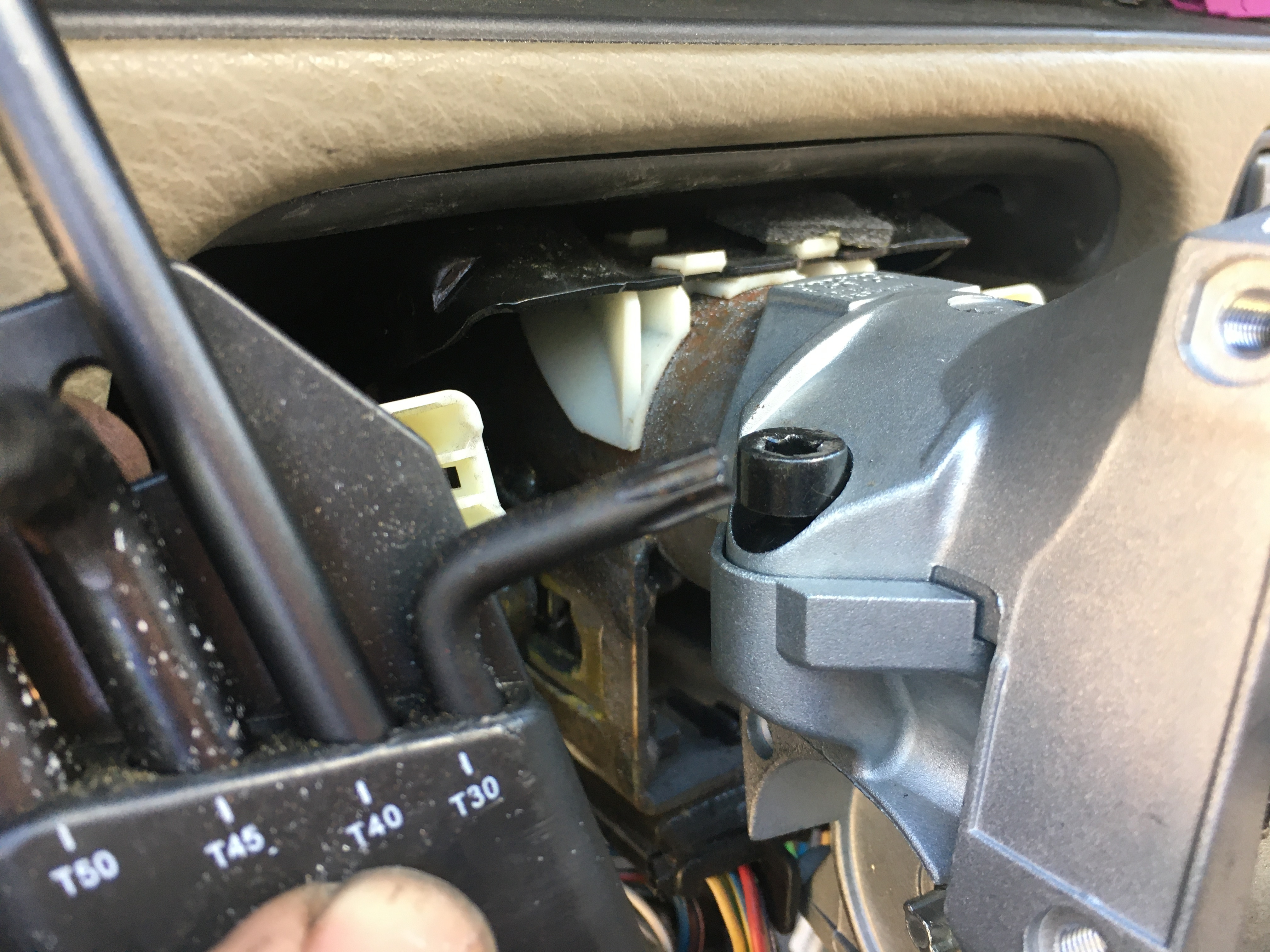

I Dremeled a slot into the top of the left screw, had a good 6 mm of bite , but couldn’t move it.
Got the angle grinder out and just dug into the housing to release the bolt

The breakaway securitybbolts are T40. The new lock set ships with a dummy plug in the interlock hole, remove it and insert the real one on the car
