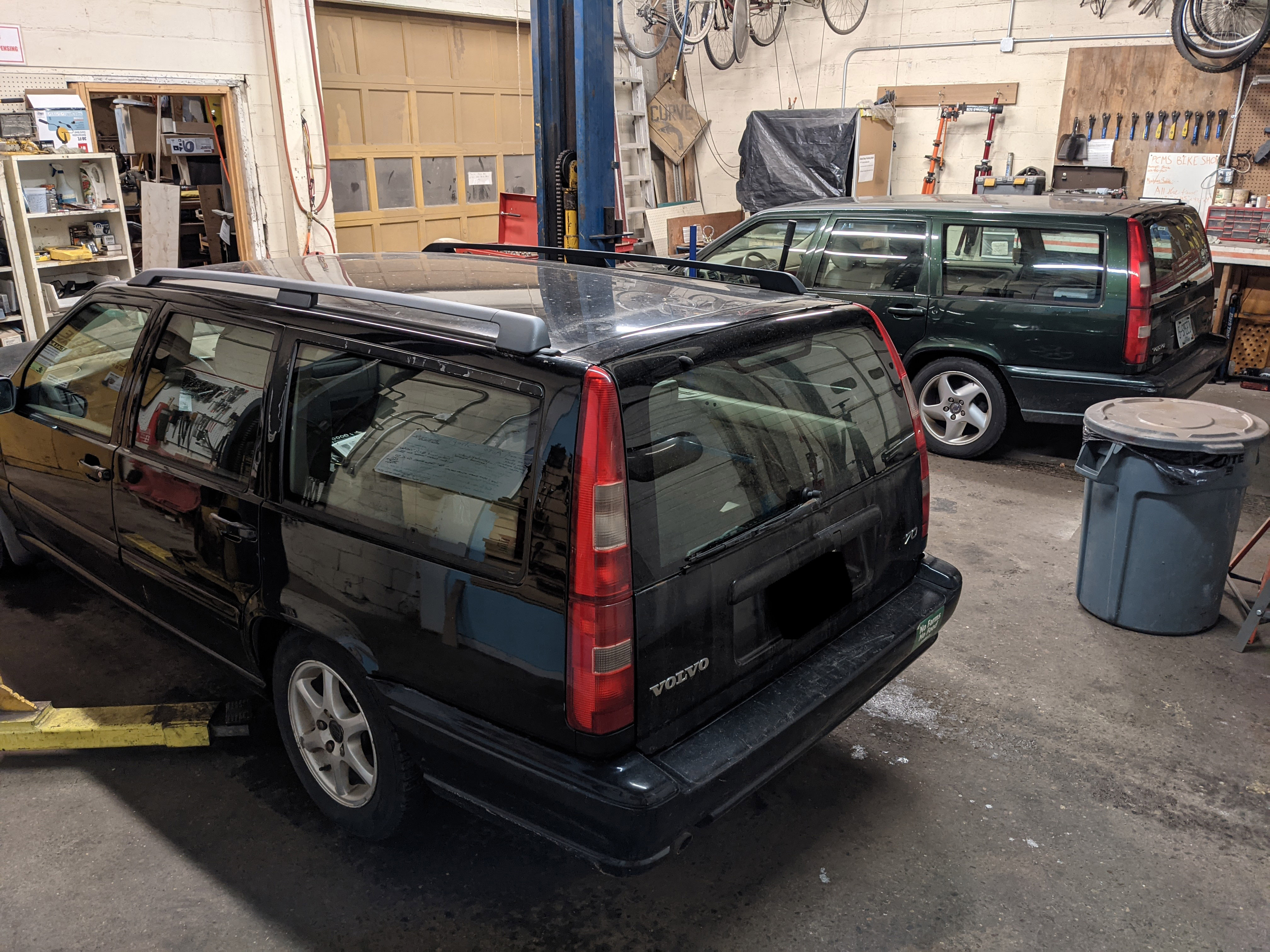

The rescue of Geronimo has begun in earnest. It was towed to the Makerspace where I work on my car. This lets me put it on the lift and have my car full of tools right next to it.
After two consecutive unreasonably long days, it has new front brake calipers, pads, and rotors. Time was consumed dealing with age/rust issues like a rotor locating pin broken in its wheel hub hole, cleaning rust off the wheel hub faces, and wondering why a rotor locating pin causes 9/1000" run-out. I also replaced the power steering tank and fluid, swapped in some simple used parts, and dismantled the center console to clean the shifter.
I could use help on one worrisome problem. Whenever I start the ignition, sparks fly off the battery negative post. That post has two additional grounds added to it. One goes to the engine, replacing broken grounding straps. The other goes to a grounding point by the fuse box. The negative cable is broken at the transmission (I have a replacement). Could these alterations have something to do with the sparks? How could I begin to diagnose and resolve this one?
