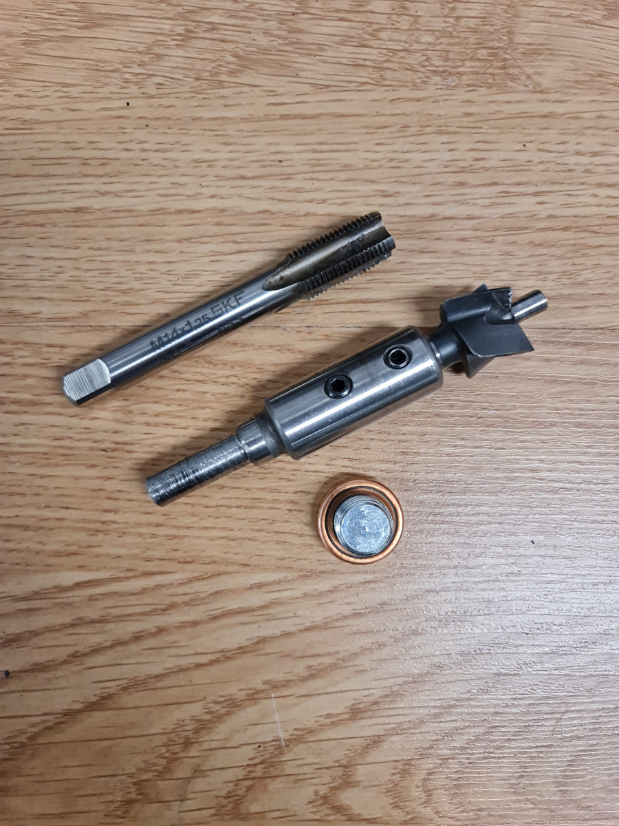

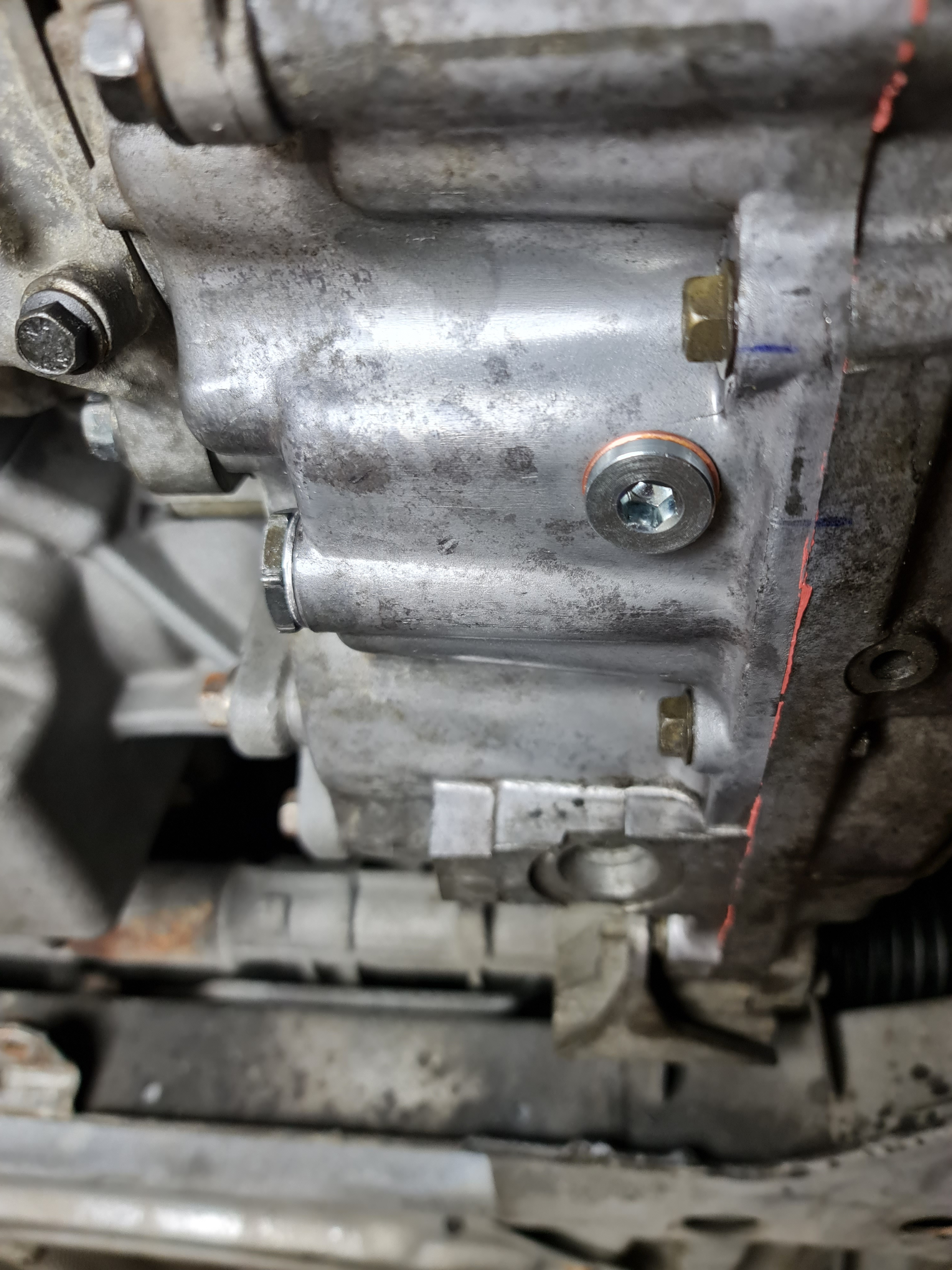

Huge thanks everyone…
My gearbox is now working again, but let's give it a couple of days before I celebrate :)
Purchased the M14 x 1.25 oil plug from my local Volvo dealer
Borrowed the M14 tap and a tool to get a nice even surface from work ( called a Granlund in Swedish :) )
I didn't invest in a inspection camera so I cant say how clean the filter got, but now its quite easy to do the process all over again.
If this works it must have been the cheapest repair so far.
Used the measurement 31mm and 25.5 and that was perfect position to get in to the filter :)
