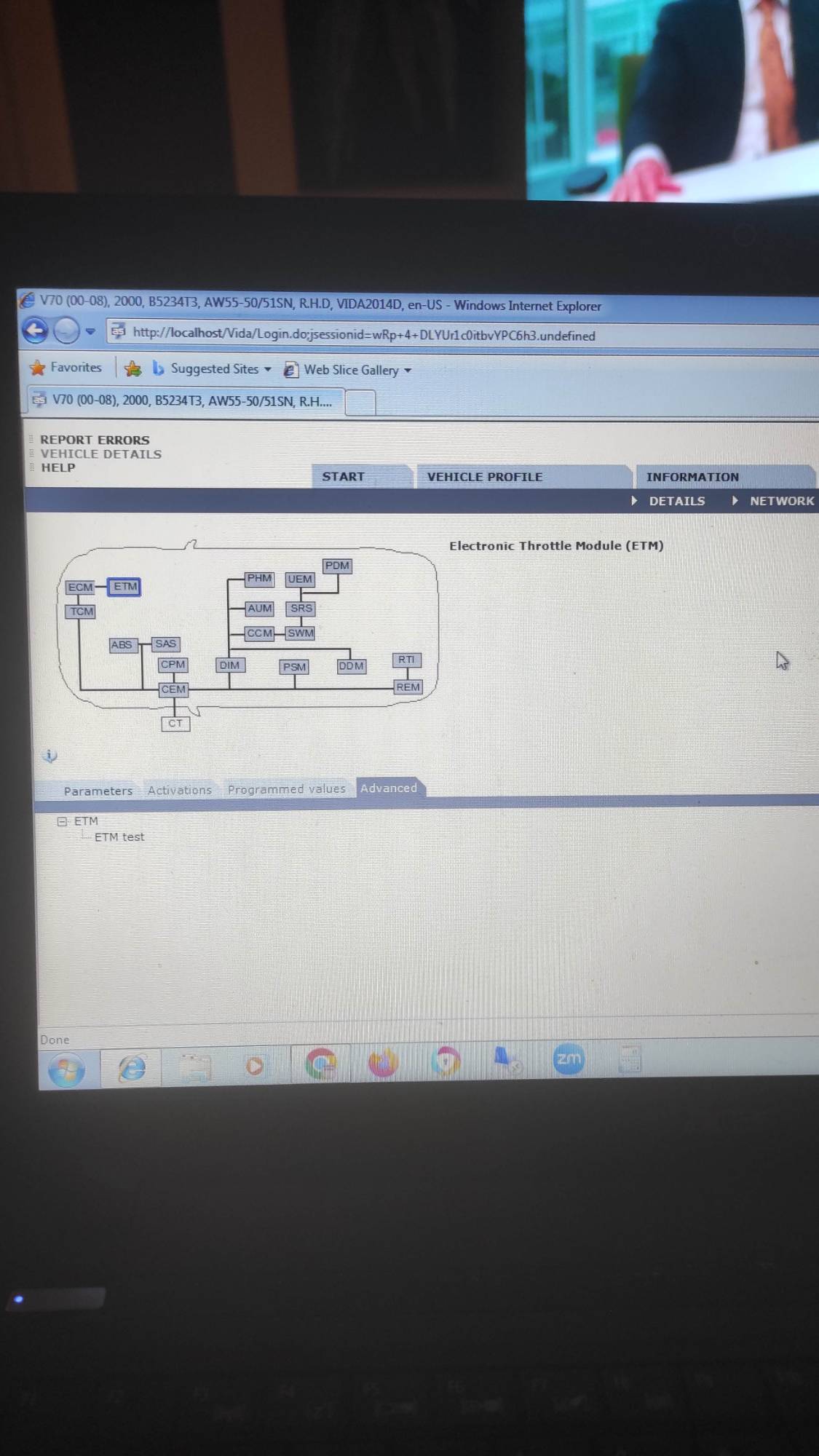

It's not the build of the ETM that allows the ETM test; it's whether the vehicle has been back to dealer for firmware update. You can have a yellow label that has been loaded with old firmware.
In Diagnostics Menu Choose ETM icon then Advanced tab then click on the ETM menu and ETM Test will highlight. If you can perform the test you have newer firmware.
