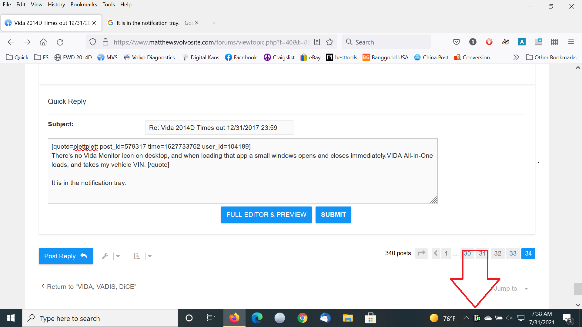

plettplett wrote: 31 Jul 2021, 06:16 There's no Vida Monitor icon on desktop
Vida Monitor runs in the notification tray. By default, it starts up as part of the boot process.

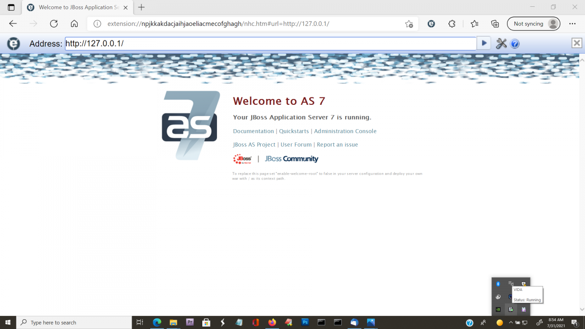

Vida Monitor is JBoss Application Server 7 running on the local port. Type 127.0.0.1 in the url address bar.

Thank you. OK, got it. Here's a screen grab showing app server 7 running. Perhaps we're set - but I'm a novice. Would you know if this DICE unit is supposed to show a LED once connected to the PC USB port :

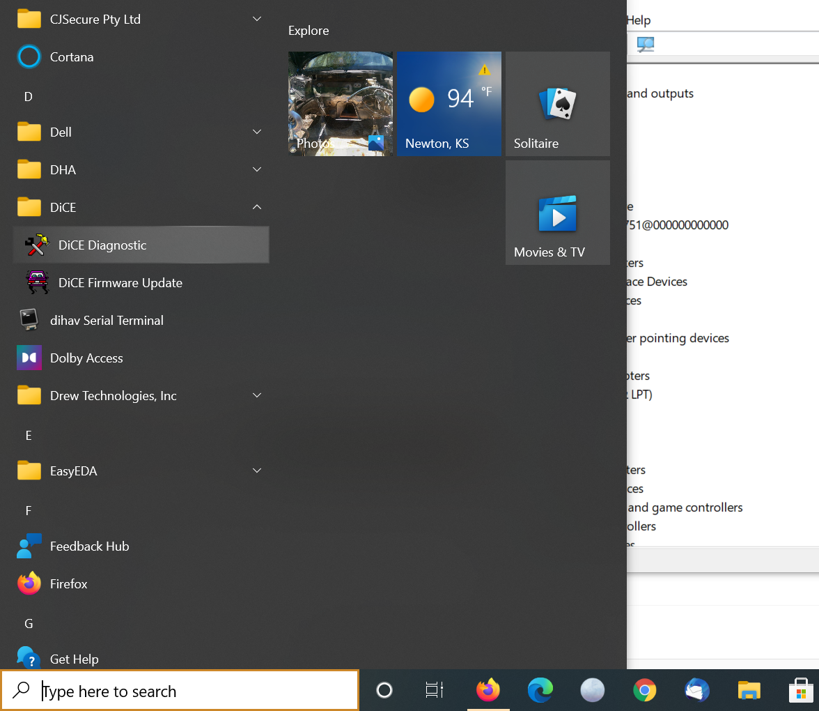

The DiCE needs a power source. Plugged in it draws power from the OBD2 pin#16 ( +12V ) . Not plugged into the OBD2 port you need to power the DiCE from a 12V wall wart. The 12V external port is right next to the OBD cable on the DiCE unit. Two amps is enough current. The DiCE is never powered from the USB port.
In the start menu under DICE there is a Diagnostic program for the DiCE hardware.
You can check in Device Manager to see if the DiCE is running.
