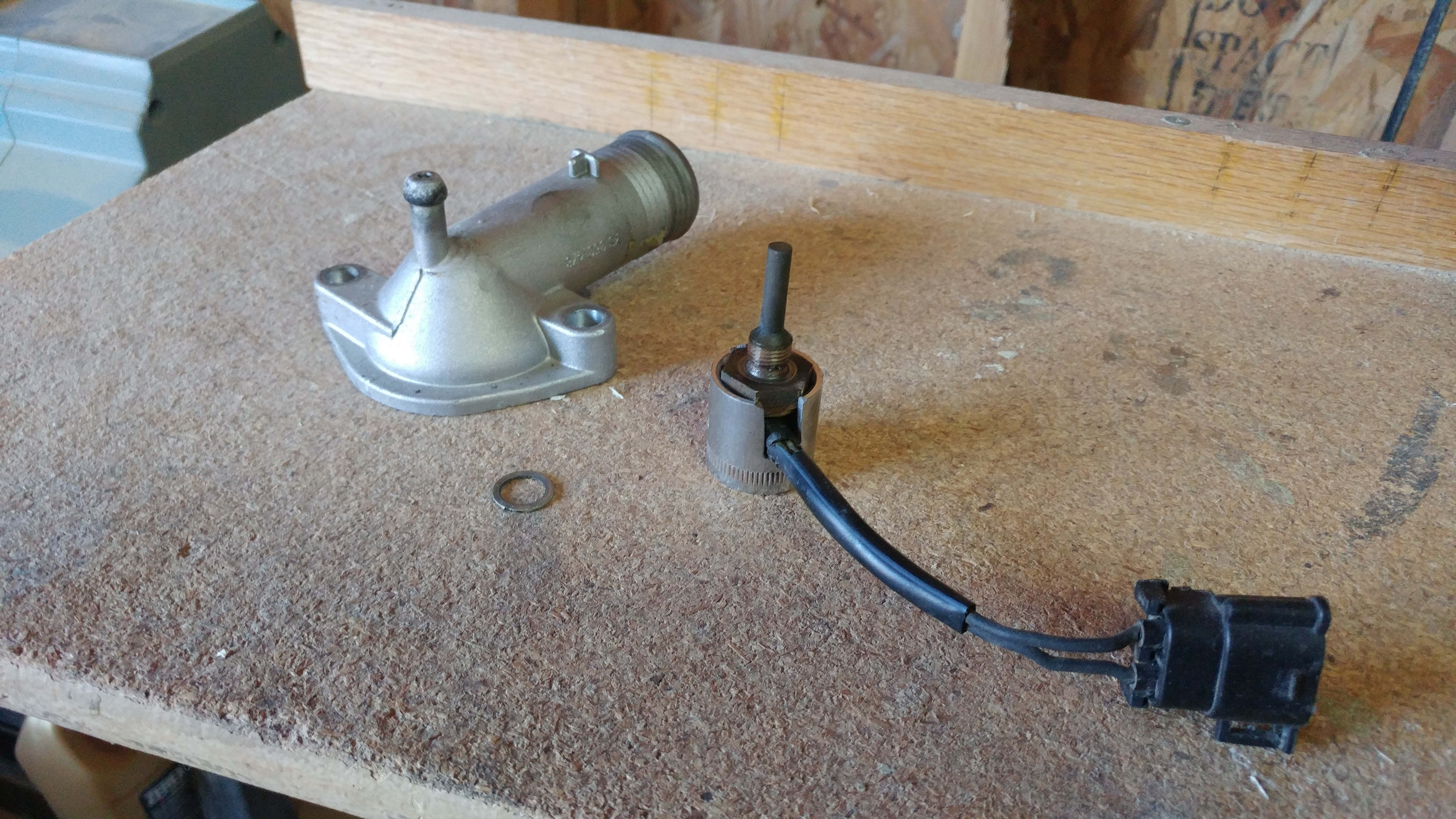

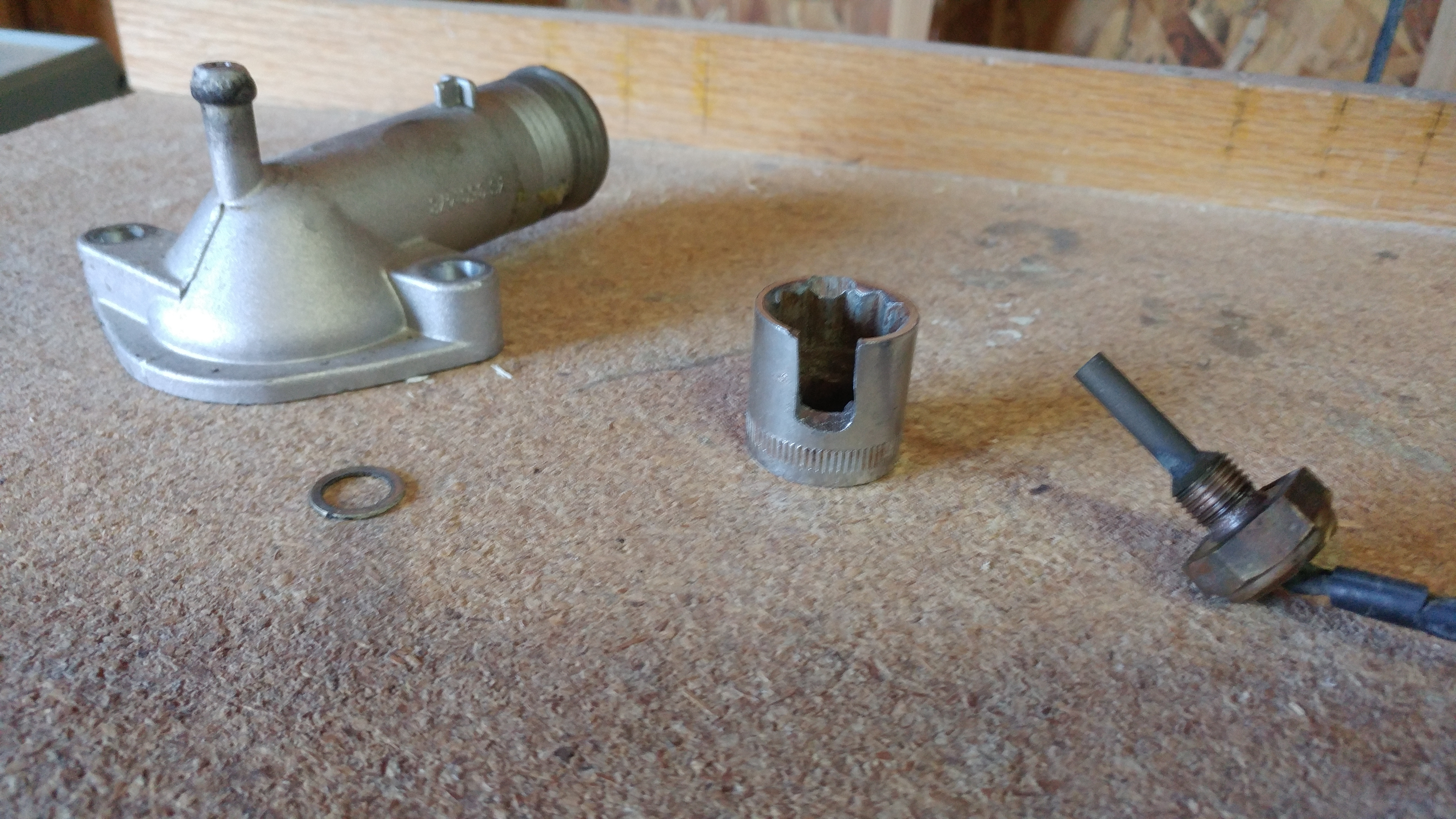

I decided to replace my engine coolant temp sensor and found out it can be a pain to remove.
As my father used to say - " Give a lazy man a hard job, and he'll figure out an easy way to do it . " So one cheap sacrificial socket and a couple of minutes with a grinder.... His point was made.

Hmmm... I have a new sensor that I want to install, might have to try this method.

You can also cut the wires on the sensor and then use a deep socket on the sensor; replace it with an open end to proper torque

In the case of removal, that would be the preferred option. If for some reason you can't get a wrench in there to tighten the new one down, the ground down socket should make easy work of it.abscate wrote: 14 Jun 2020, 08:59 You can also cut the wires on the sensor and then use a deep socket on the sensor; replace it with an open end to proper torque

Personally I would have tried taking apart the plastic connector before cutting the wires, particularly with the new one. But that also didn't seem to be the right approach. Additionally there was no way to get an open end wrench in there, at least in my case. And hey, if it was a race, I'd be drinking my second beer while someone else was crimping and heat shrinking wires back together.

What size is the socket, might it be the same as an O2 sensor? That would make it too easy though.
