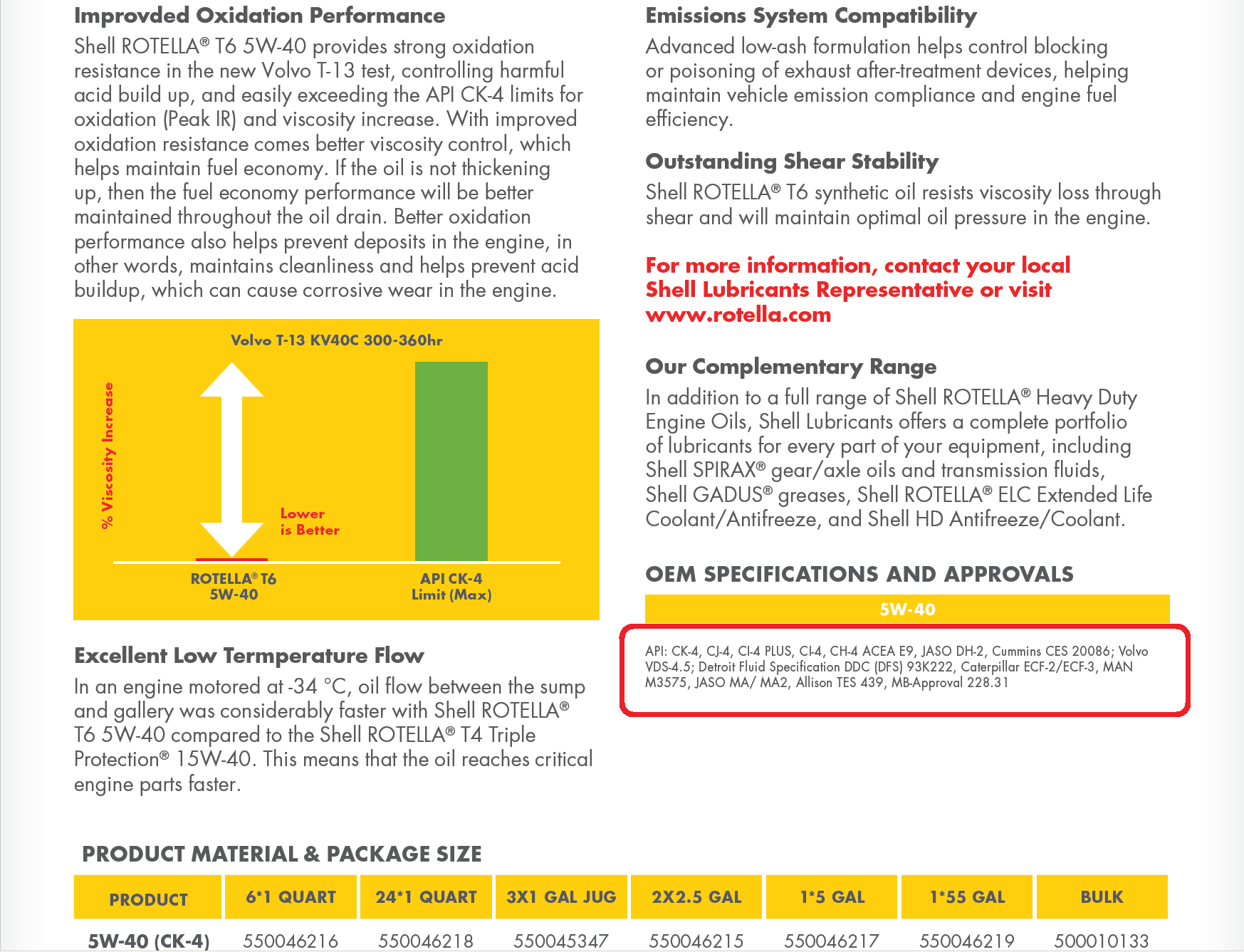

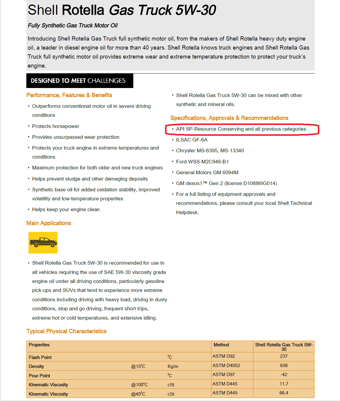

scot850 wrote: 29 Aug 2024, 17:23 We don't seem to get gasoline engine Rotella here. All I see are for diesel engines. I know there is a debate if you can use diesel engine oils on gasoline engines safely.
Krons wrote: 30 Aug 2024, 17:48
Rotella has a SN rating, so works fine for gasoline engines. Double check the bottle you get with your owners manual page.
The T6 has been used for a long long time in many many communities and is established, including motorcycles so no debate really. The only debate would be for new users and if it's another brand of diesel oil.
The SN was removed a few years ago from the T6. According to some of the Bob The Oil Guy posts from people who had contacted Rotella, the formulation didn't change just the new packaging and label. Amazon use to sell the two and differentiate them as "Old Stock" vs "New Stock" T6.
I believe it was removed so the SN but now SP could be used on the Rotella Gas Truck to increase overall market share of the gas Car & Truck owners, who wouldn't otherwise try diesel oil in gas vehicles. I tried the Gas Truck and didn't care for it so went back to T6.

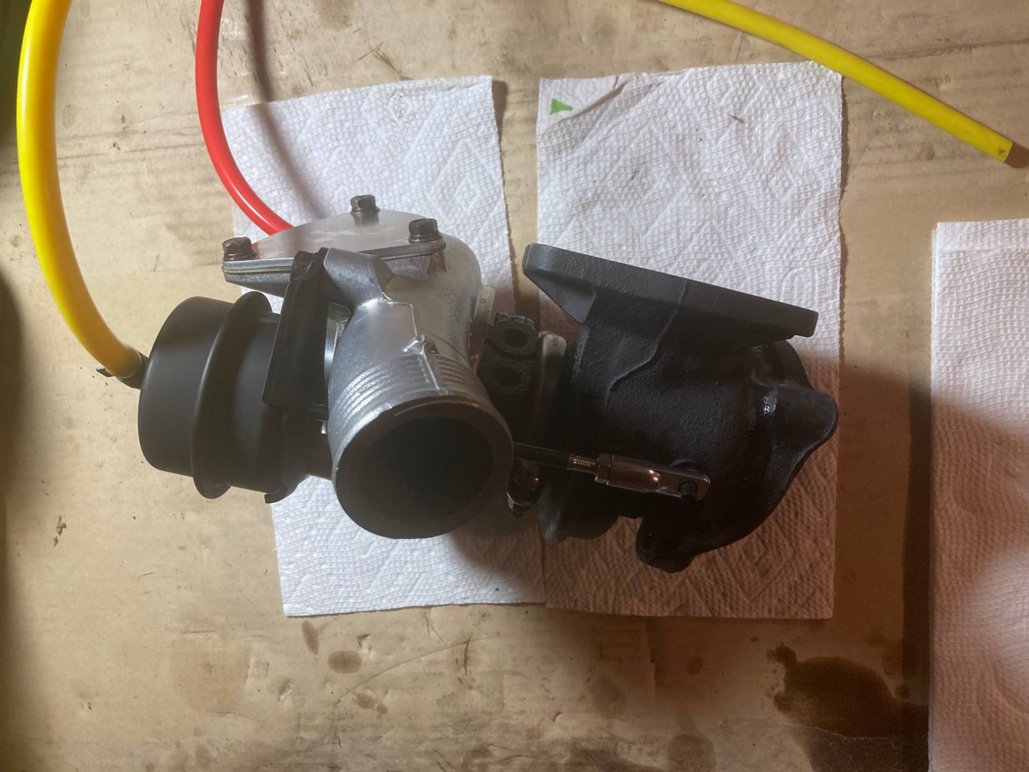

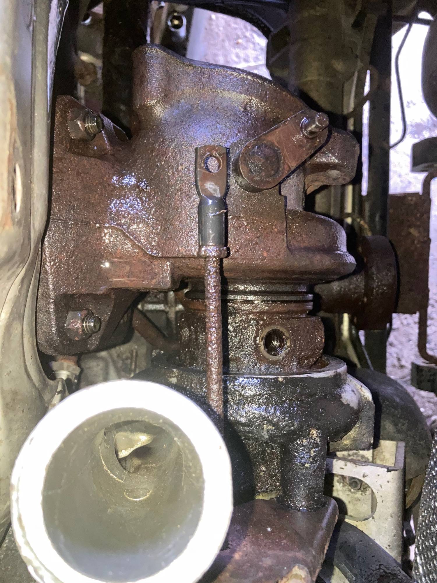

Finished rebuilding my turbo. Before and after pictures.

kcodyjr wrote: 08 Sep 2024, 10:43 Finished rebuilding my turbo. Before and after pictures.
Going to have to address my 2007 S60 2.5T one of these days. The turbine shaft is loose and lots of oil. Did you do a write up or use another link somewhere for reference? If so can you provide that?
