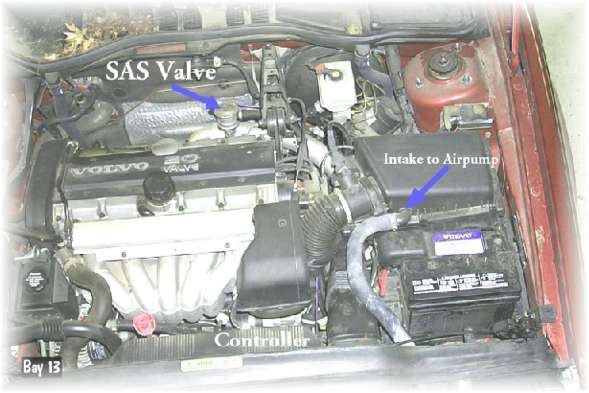

No SAS is not steering angle sensor. Is is a supplementary/secondary air system which is an air pump the engines use when cold to increase the amount of air to the cat to reduce the emissions for the tailpipe when the engine is running richer.
If the car has the system, there should be a valve on the exhaust manifold with a pipe running down to a rotary pump mounted under the battery tray. The problem with the system is the valves fail, and then condensation runs down into the pump which has no drain and fills the pump with water preventing it running and rusting it solid.

Picture of the “UFO” which is a SAS component attached….about half of 1998 were so fitted.
If your scanner is reporting EGR isn’t ready it’s not mapped correctly to the ECU codes. Cars without EGR don’t have an EGR monitor. Make sure you aren’t mixing up INC with N/A

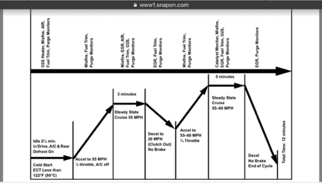

The car manufacturers are supposed to setup the monitors so that they will clear if you drive the standard fuel economy measurement loop.
The drive cycle is done with very moderate acceleration and small throttle openings and several sections where the vehicle slows down (without touching the brake) and then slowly accelerates again.
If you can't get the rated MPG then you are driving to aggressively.
For my 2010 S80 I had my son drive it like a Grandma for a day and it set the last monitor.
For my 2009 A4 2.0T I replaced the battery (which resets the monitors) and I drove it for over a year and I didn't get all of the monitors to set.
Here is what I did.
Note: this is from a cold start, I accelorated very slowly to 55 on the freeway, I exited on a ramp that will allow me to get back on and I slowed to 20 MPH then I slowly accelerated to 55. Then I chose an exit with a long ramp and slowed with my foot off the gas and no brake and I came to a rolling stop.
I did all of this without touching the brake

This cycle diagram is what the smog guy made me do. Even after driving the car for about 100+ miles through a combination of street and freeway driving at varying speeds...the monitors never went ready. The smog guy insisted that I follow the diagram. Had to find an industrial area without any stop lights. Then once you complete the cycle, do it 2-3 more times.

Oh oh oh, ha ha, yes now i know what the SAS is and yes i do have that and i replaced it about 6 years or so ago because it was bad and letting water into the now notorious Air Pump.
Ha, i like that name, UFO for that thing it looks like it ha ha.

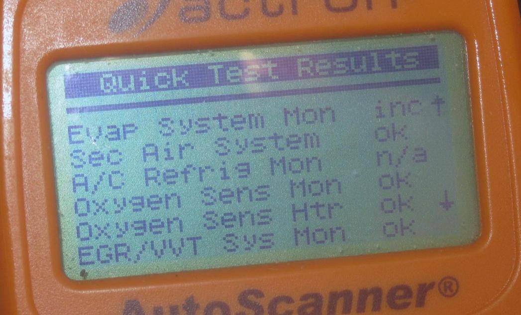

Here is a pic of part of the scanner readout. This was back in 2016 so EGR was ok then after some time.
If it is not EGR then i have no idea what it is.
If this was not included in the test it would have "n/a" next to it, not "ok" and not "inc".
For this scanner, "inc" means "not ready". So there are three states it can be with this scanner:
"ok", "n/a", and "inc".
There is one that is actually "n/a" so i ignore that one.
The others that read "inc" eventually go to "ok" when they are ready.
Here is a snap shot, but the EGR one is now "inc" and it is not "n/a" and it is not "ok".
You can see that AC line that is "n/a" so i ignore that one.
