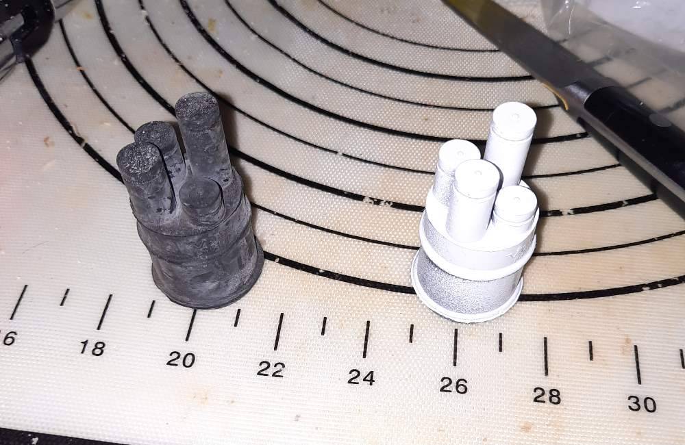

Hi,
Here is a pic of the nipple things.
Photo: Left is before, Right is after. The white one is easier to spot.
I just have to say though that i dont think i've seen a nuttier thing in my life as these things are. Should they be X rated?
The real problem is the nipple insides are only about 1/8 inch diameter and i need more like 3/8 inch diameter as i am running two wires that are side by side like zip cord for home lamps. That means i have to make a hole bigger than either of those nipple things alone. Maybe cut one off completely.
I just cannot get over how funny they look and who the heck thought of that particular shape, and why that shape.
It makes sense to have individual nipples i guess, but only when you intend to run just one single wire that you would typically run in a vehicle.

- Posts: 36147
Don’t forget a FUse

Haha, that's what i was thinking too!
They resisted removal but i got them off anyway and now they are pissed
