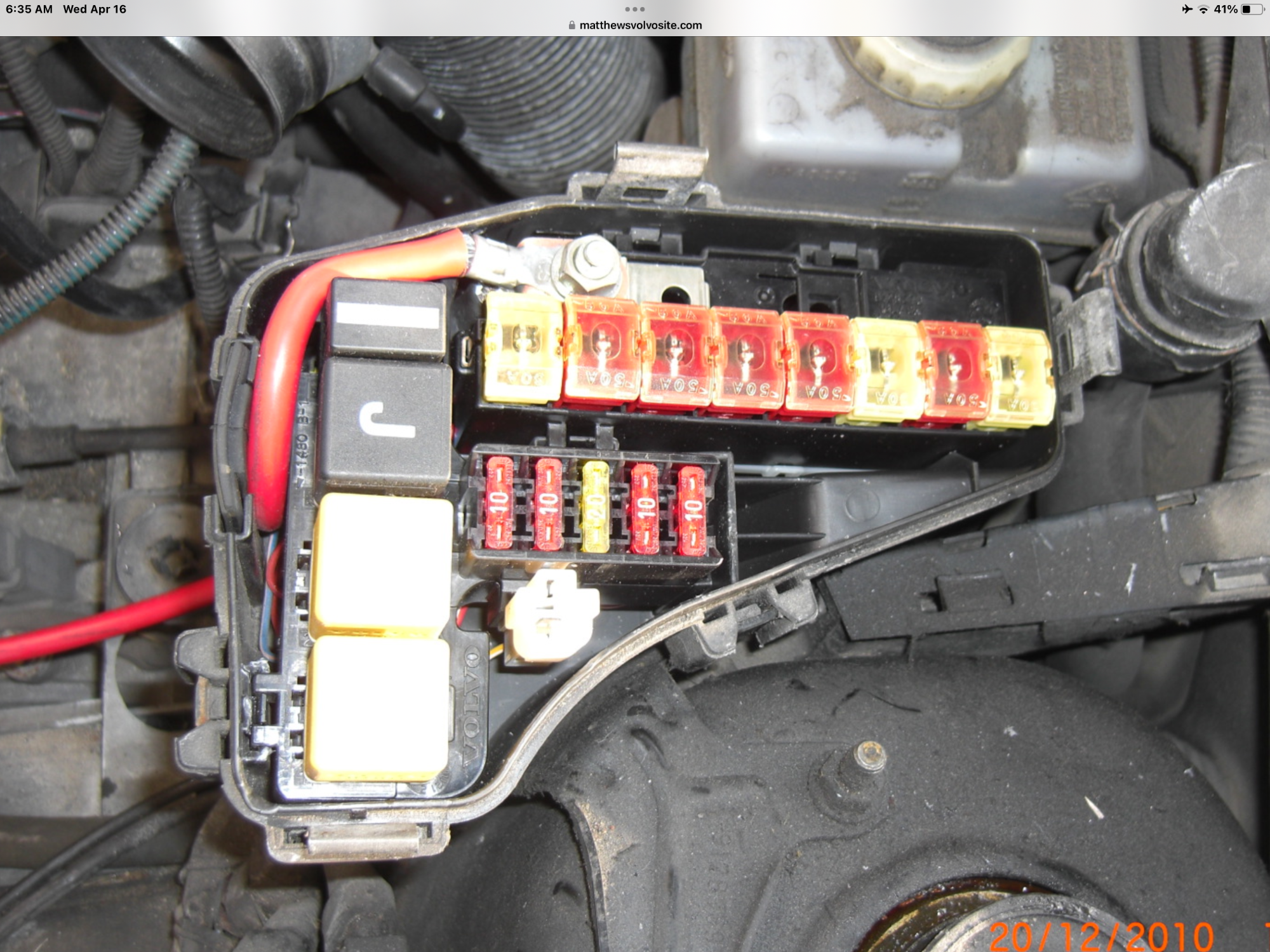

Can you get Mrs Dirk to twist the key while you see if the main engine relay clicks ? Need good battery of course
That relay is closed by grounding at pin b38 on the ECM so thst will tell us if we have any ECM activity or if it’s dead.
It’s one of the three square relays in this picture, the rectangular one is the AC relay
I think it’s the J marked relay
viewtopic.php?p=649708#p649708

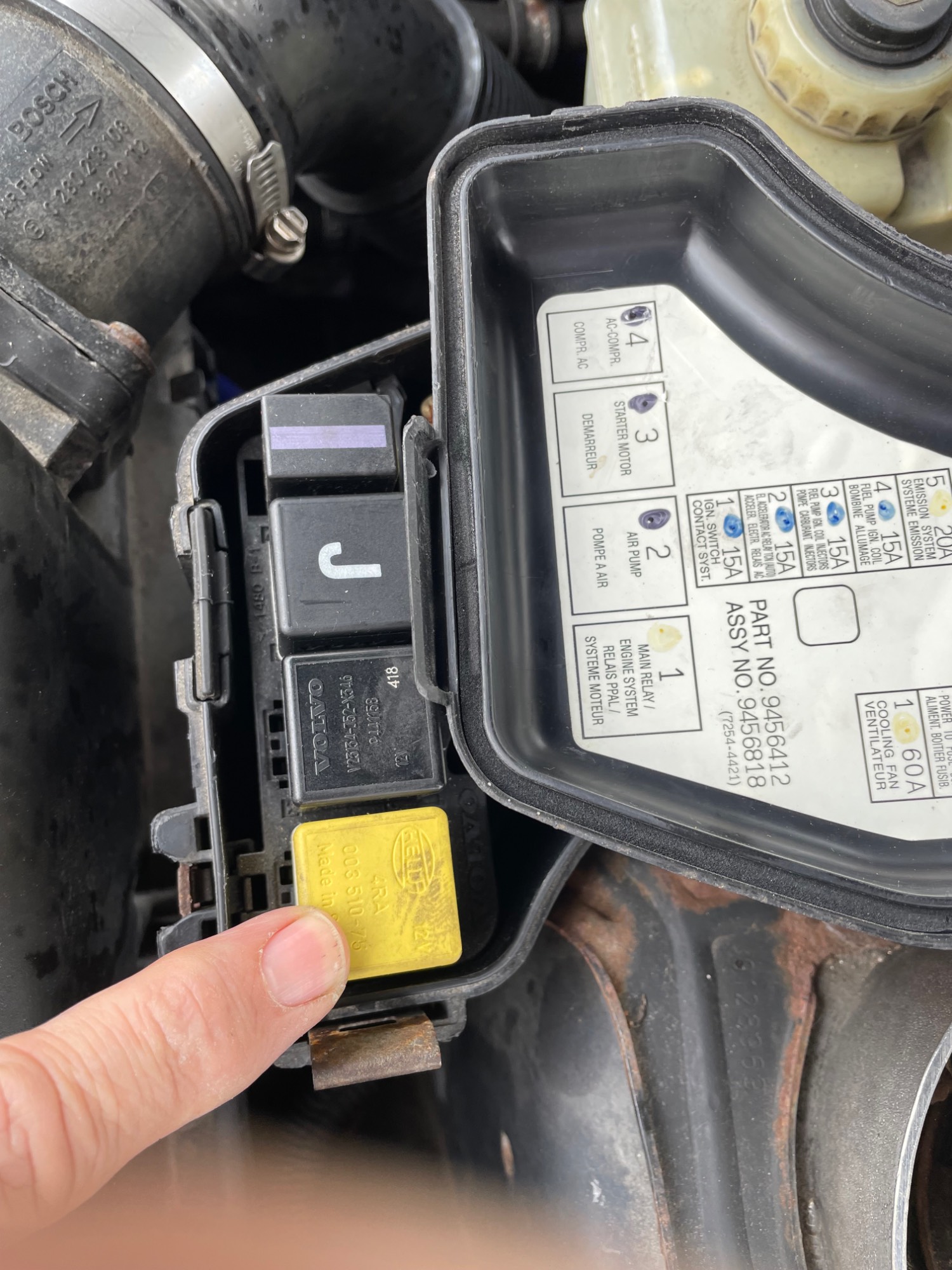

- Posts: 36149
Nope, it’s this relay…

I actually found that out when I looked at it. Got a good audible click on that relay, so that's probably good news.
Also, I took the ECU out to clean the contacts with DeoxIT, and I messed up royally. When we were doing the continuity test I used a tiny pin in the female part of the connector to establish a good connection. Apparently I forgot to take that out before re- installing the ECU and that matching pin got bent and was touching the pin next to it.
I bent the pin back and you would never know, but I don't know if things got damaged inside the ECU. It behaves exactly the same, but who knows.
That's why morons like me should never work on electronics

That pin will be fine. Thst does mean the ECU is trying to do some of its work
