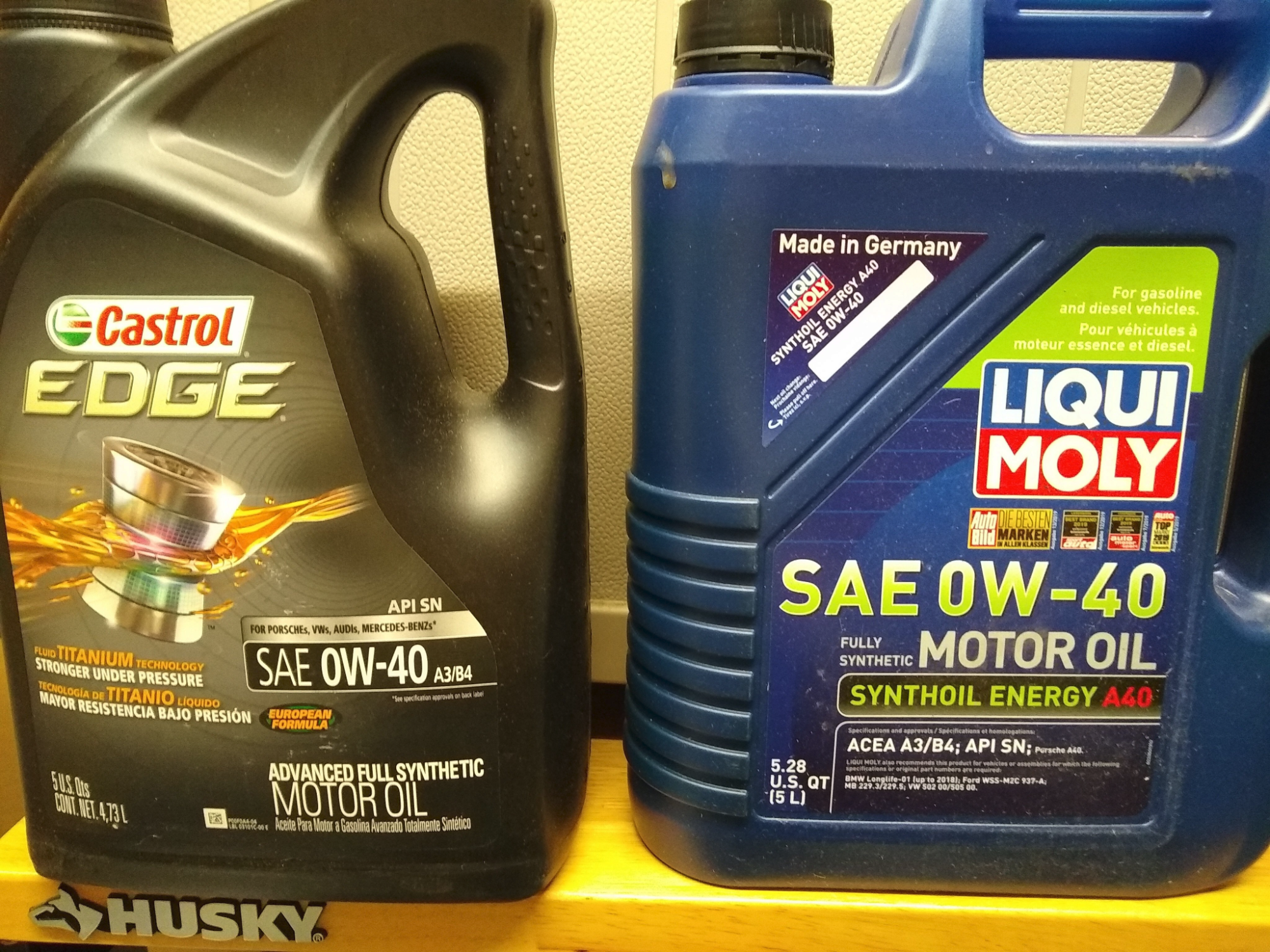

Both should get 0W-40 (colder climates) or 5W-40 (warmer climates or aggressive driving) full synthetic that meets ACEA A3/B4 certification, usually labeled as Euro oil. Don’t run Liqui Moly - their 5W-40 burns more than others because it’s noticeably thinner for some reason. I run Total Quartz since I got it on clearance, but Castrol is the usual go to for these cars.
There’s nothing special about any transmission fluid for the P80 4 speed auto - Valvoline Dex/Merc is what I use, but any fluid that meets Dexron III specs will be just fine. There’s no reason to spend extra money on fancy stuff. The 5 speed is a totally different story, but this 4 speed doesn’t need anything special.
You should NEVER run 15W-40, conventional, or diesel oil in these cars, regardless of what Mr. Swepco rep over here tells you.

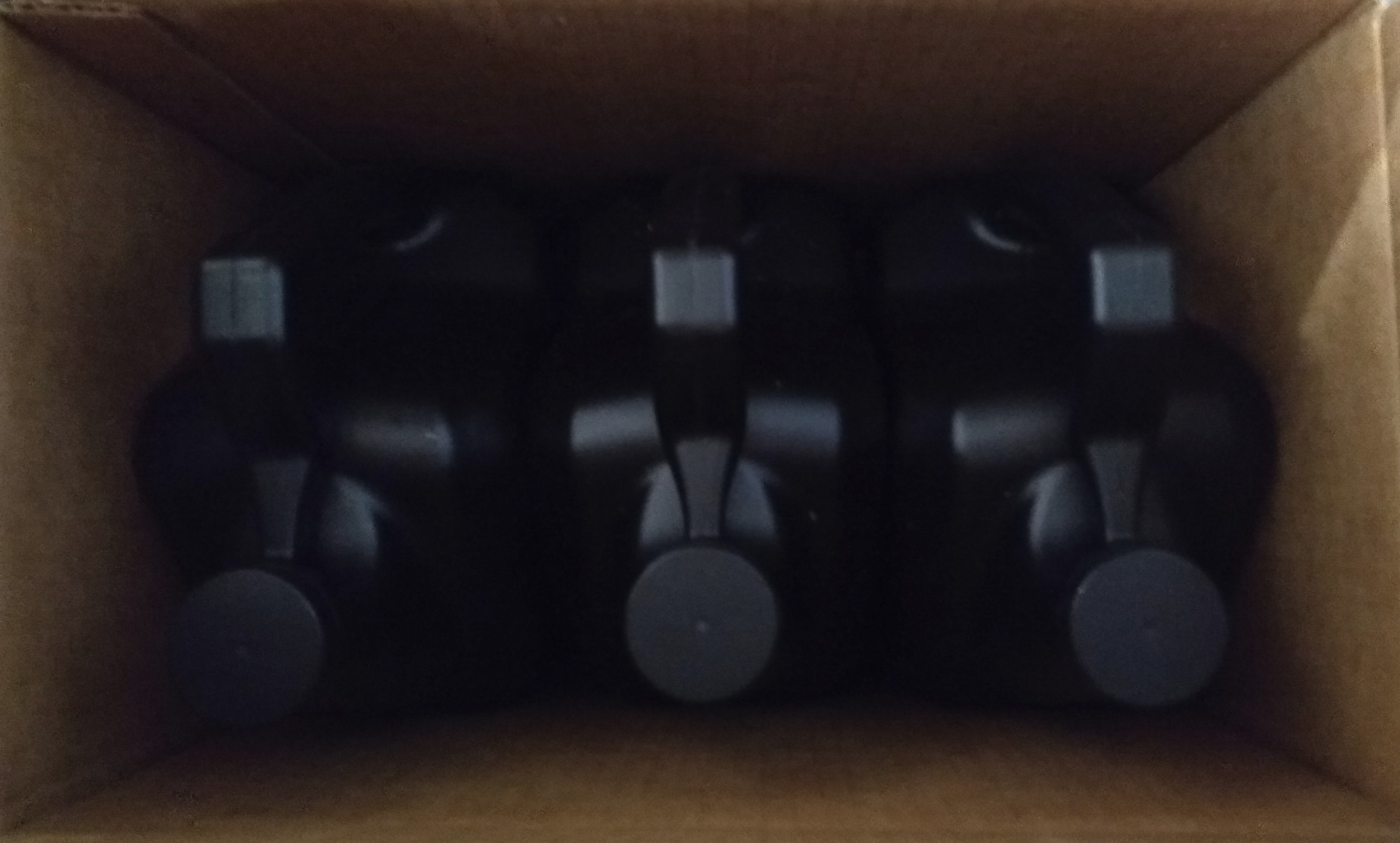

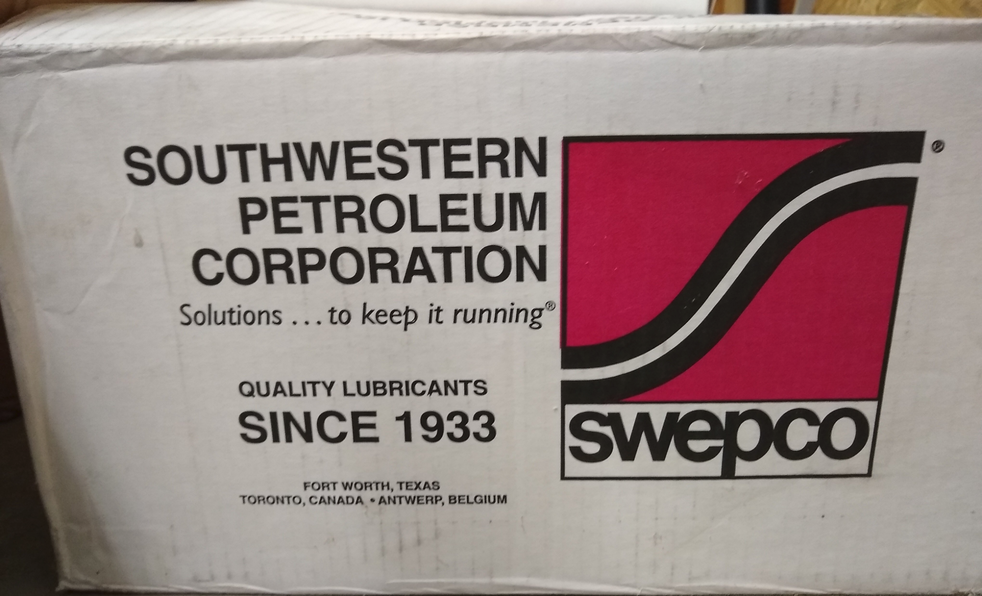

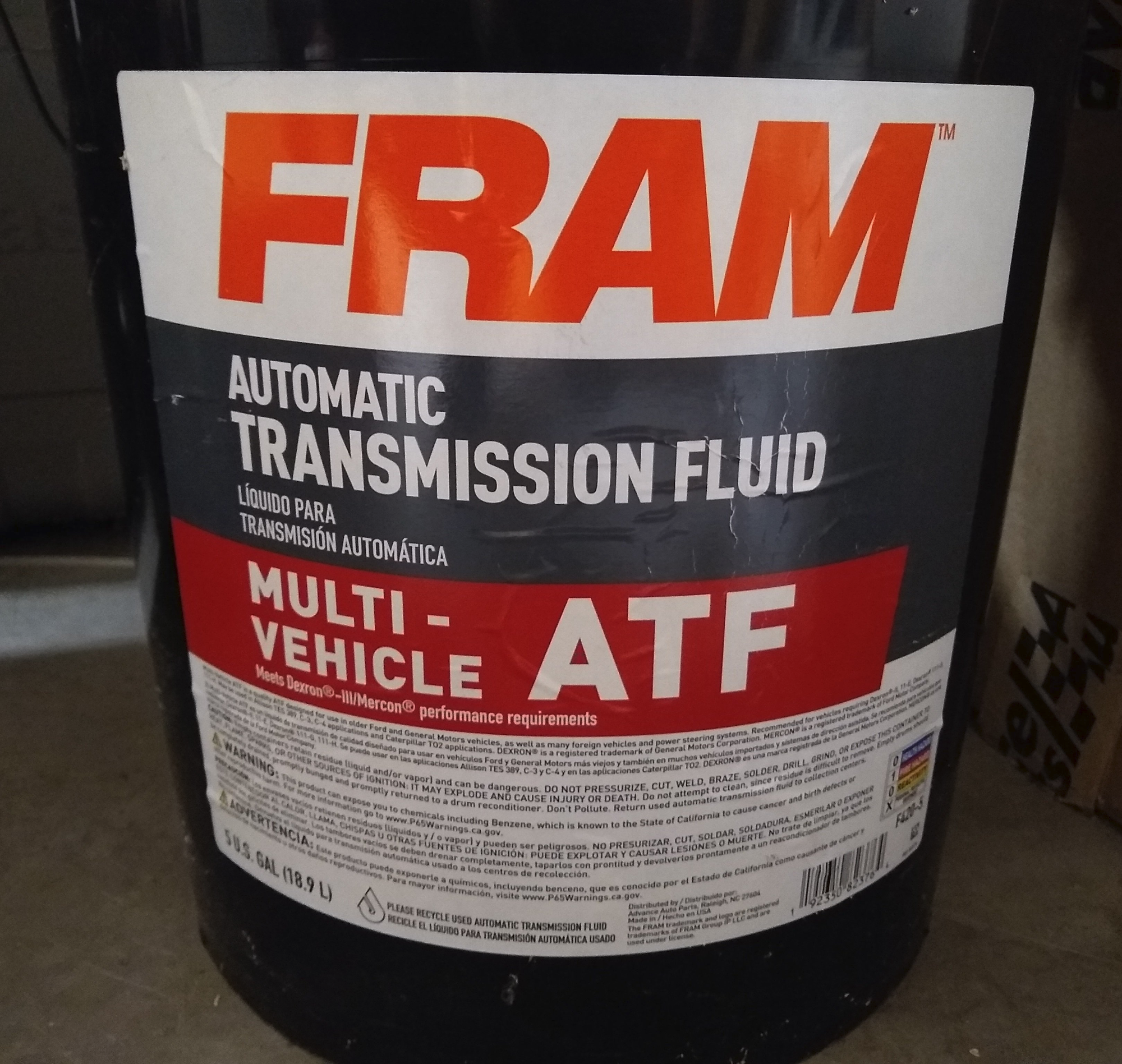

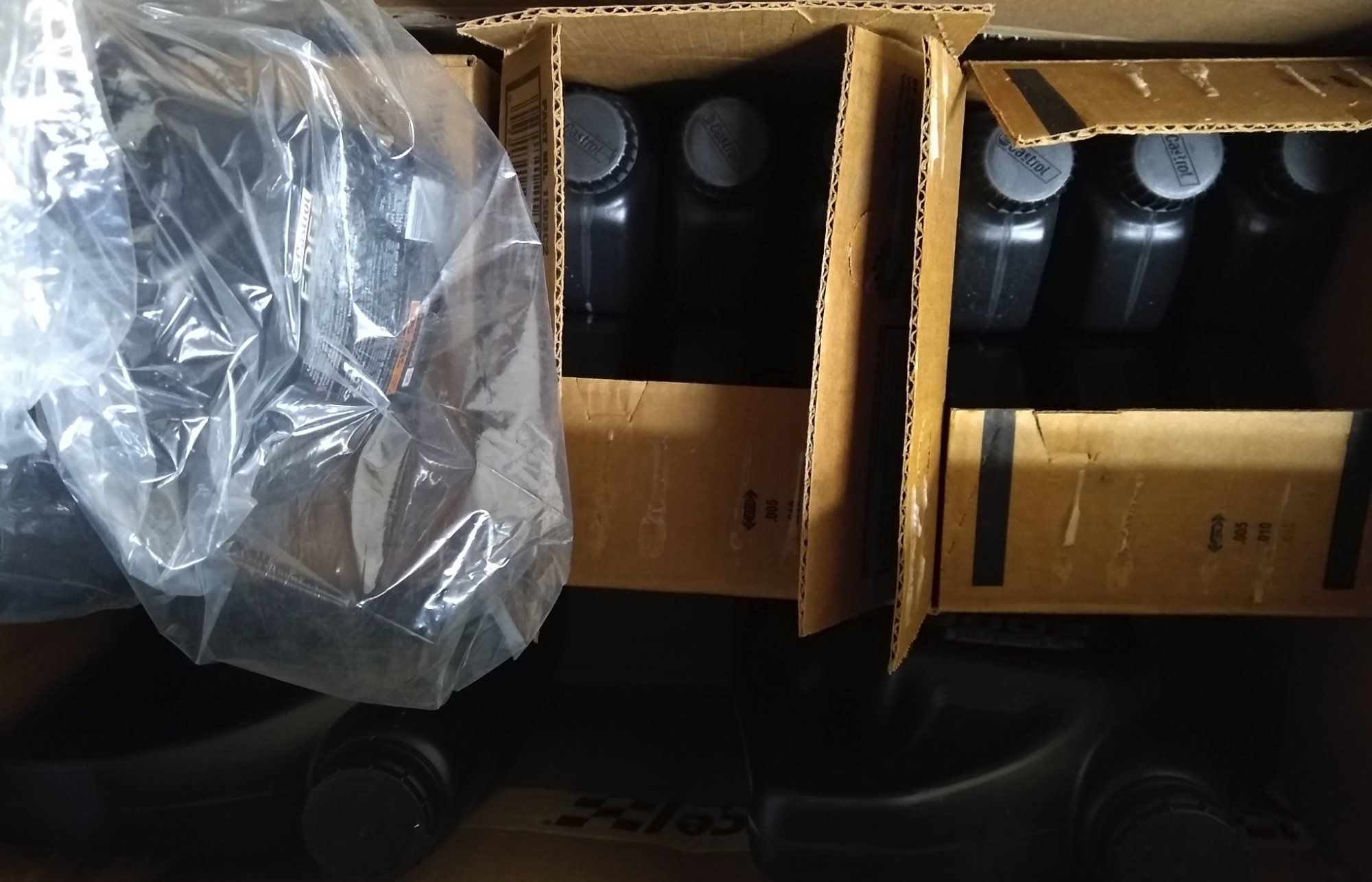

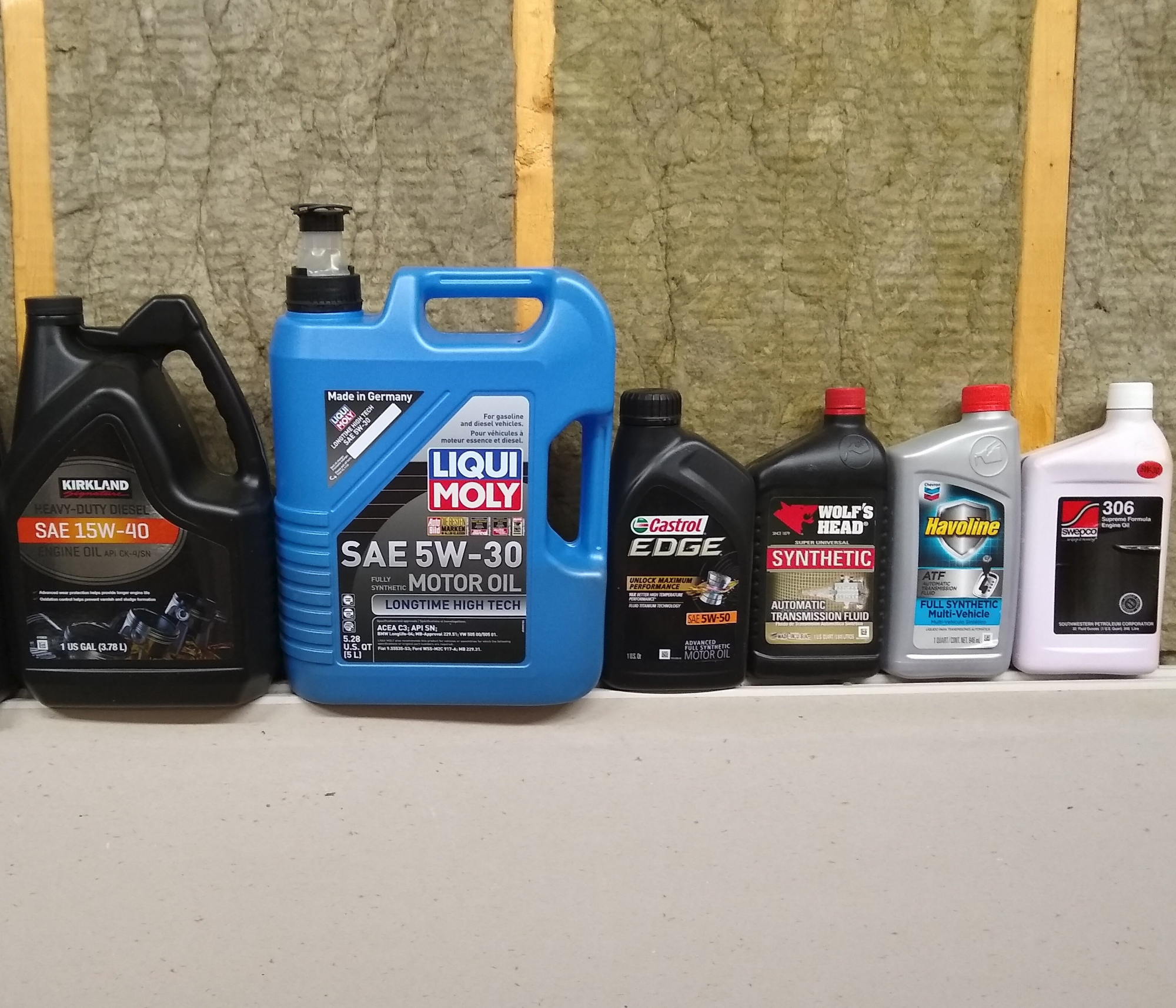

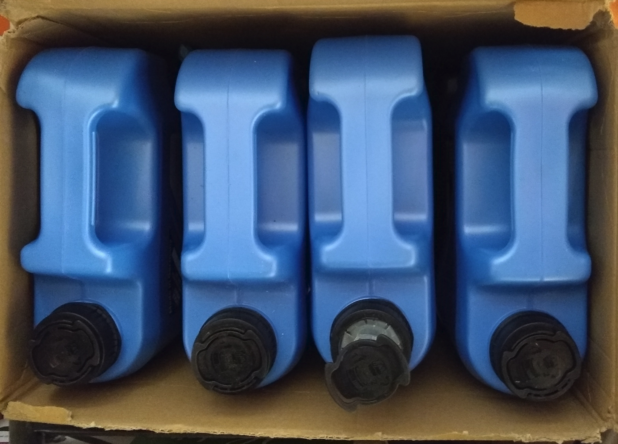

Normally I wouldn't run 15W40 nor 20W50 during winter. I've only had one minor hick up with the worn 98 S70 T5 motor using Swepco 15W40 and this for many many years and year round in quite a few makes and models. I believe I'm currently running Rotella T6 15W40 in the following and will see how it fairs during winter.
I had purchased 6 gallons during a super sale last year. Just recently started keeping track again after years of low mileage use of the various vehicles, so sometimes only annual oil changes rather than 5K or 6 months.

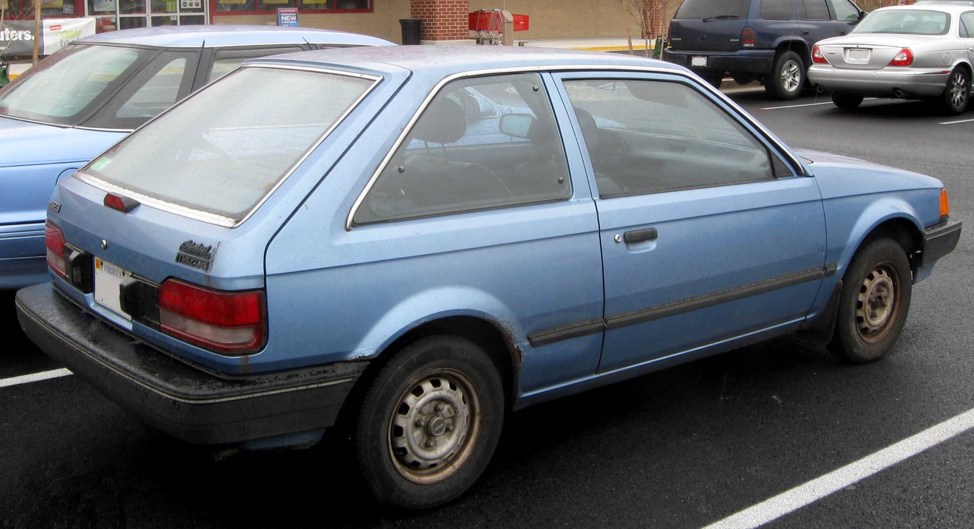

Yes, that's the first time I've ever seen fluid that bad and the transmission was still running. I used to own an 89 Mazda 323, same car but with trim rings on the steelies :lol: . The transfluid was literally silver when I got it. Change it out with some generic fluid and the car ran till the summer and one day it just went south on the way home and was really, really limping on the freeway. It's a good thing it can take up to 1.5 hours for 25 miles to get home from work in CA.
I remember getting off the freeway and nursing that thing from light to light till it made it home. Swepco with 714 20W and added a Hayden transmission cooler and it was literally flying though it did have a slight bump shift if you WOT too many times. That was in my younger days of course and the 323 was a fun little car with wider tires.
