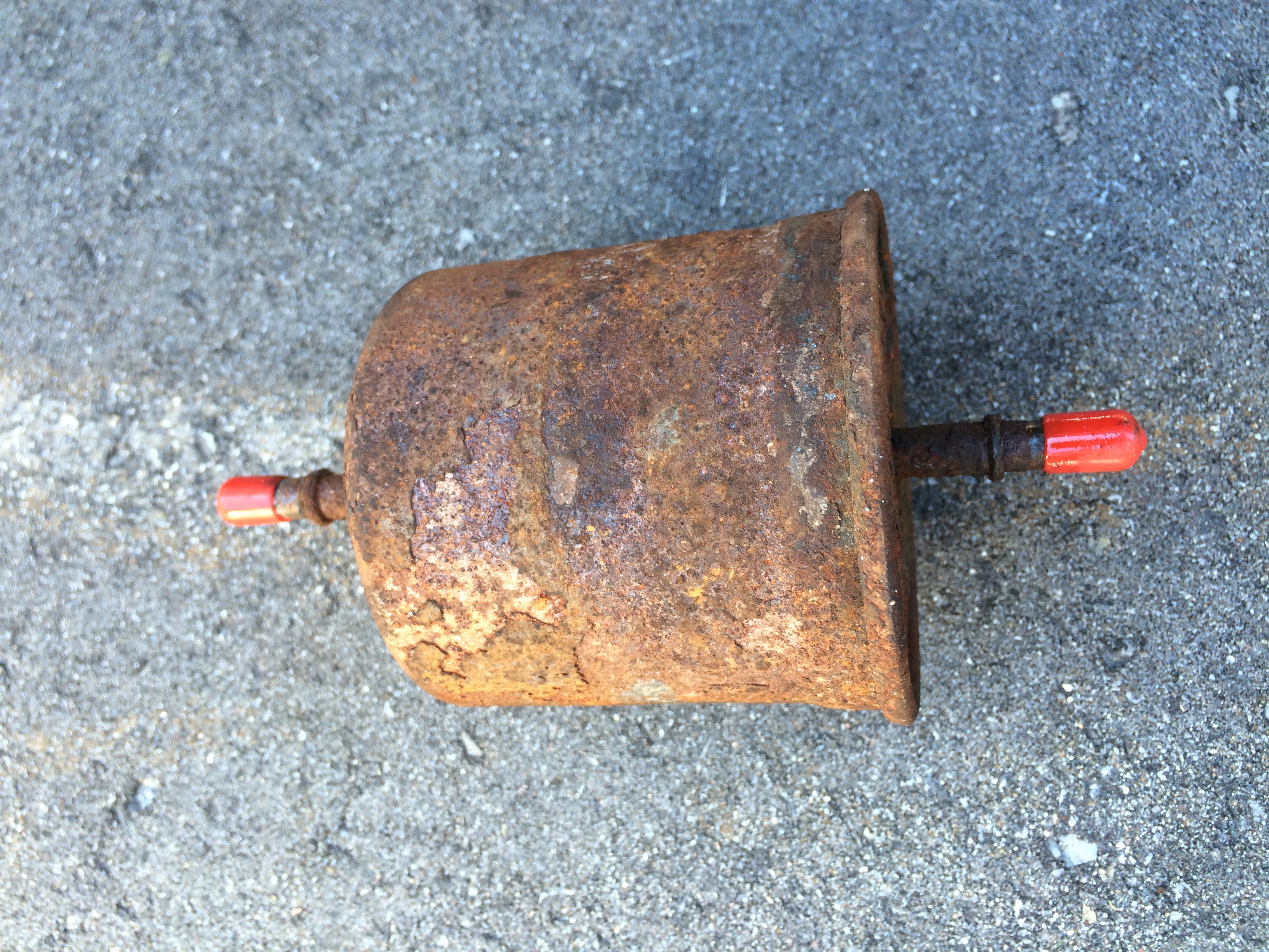

I think I win for most rusted out fuel filter...

eek the rubber nipples are a nice touch- I can't get the bloody bolt to catch the captive nut on mine

The rubber nipples came with the new fuel filter I ordered... just put it on the old one in case there was gas leakage.
I feel ya! My 12mm bolt was so rusted on that it actually broke my socket. I'd definitely recommend replacing hardware if possible.
