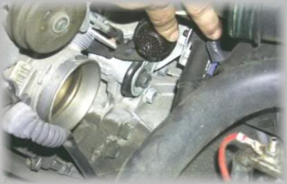

Apparently, there is supposed to be a screen in there and it is missing. That is why the PCV valve is all stopped up with solids. Fortunately, the guy thinks he can clean it and get it working again. He has the kit if he needs it but doesn't think he will have to use it. He went and got a replacement screen from a junked 850 and is putting that in. The manifold gasket looks brand new and actually slipped off when he lifted the manifold. The guy who worked on this car before didn't use any gasket sealant.
Are there two flame traps in the 850? Is there one that is part of the PCV system? I know I took the one out illustrated on Bay13
and the holder was empty. This guy said the flame trap was clogged???

You don't need sealant on the intake gasket, as there's no coolant running through the passages in the intake manifolds of these cars.
That is the flame trap screen in the picture, and is the first part to clog; that's why most people suggest removing it. If that's clear and the rest of the system (oil sep. box and hoses) are already new, maybe the ports in the engine itself are blocked up?

Thanks. I had the PCV, catalytic converter, airbox, cam seals, and flametrap replaced. A Volvo mechanic (friend of a friend) is supposed to pick up the car sometime soon and give it a good going over. His initial thopughts were that I may need the entire top of the engine rebuilt.
He said the PCV was full of solids and gunk BECAUSE the flame trap was missing. It makes sense now that I think about it. The flame trap clogs up a lot, right?. if it isn't in place, whatever usually clogs the flame trap up gets past and in where it can clog something else up. Seems to me that leaving the flame trap in place and occasionally replacing a cheap and easy to get to part beats the heck out of spending a lot more time and money tearing the engine apart to get to whatever else gets clogged up because the flame trap is missing....
