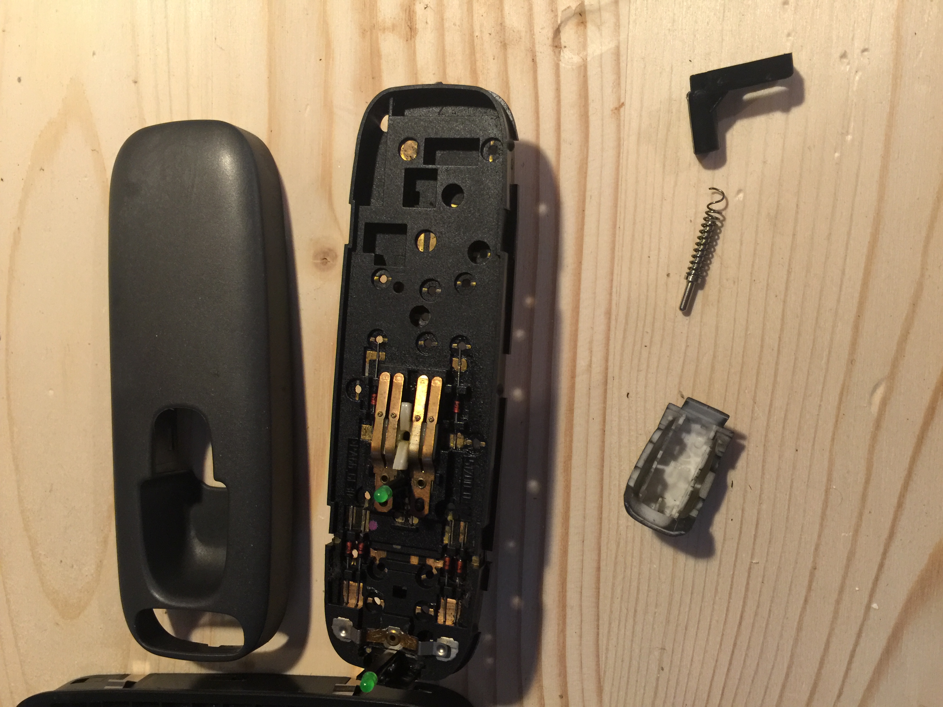

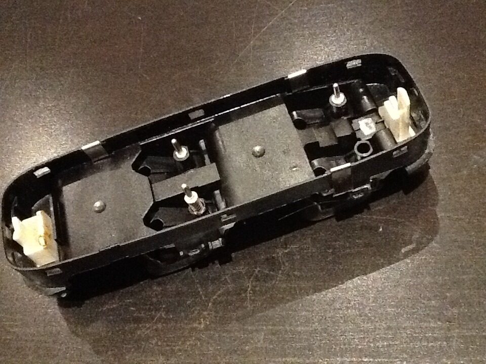

I had this issue just today, where I repaired the passengers switch which wouldn't lift the window up anymore.mecheng wrote:Unfortunately it's not that pin. I'm not sure how the pins came out of their housing but I can't get them back in. There is no obvious way they lock. Anybody else have this issue? Or does anybody have an extra top switch section hanging around. The switches work perfect otherwise

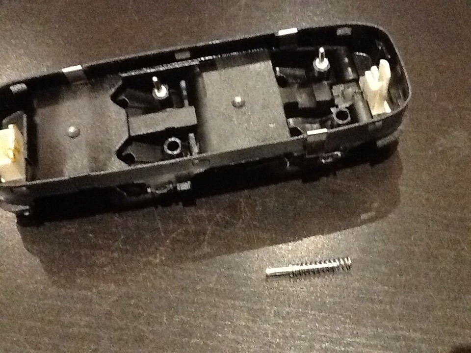

The little spring which popped out was essentially the reason for the malfunction.
I managed to fix it by bending one end of the spring, inserting that end into the switch and then bending the end again such that it wouldn't pop out anymore.
After reassembling the window switch worked again.
Anyway, the door lock switch was kind of blocked now, which also blocks trunk/fuel switch at the drivers side.
Another 15 minutes playing around with the switch and more carefully reassembling it, everything works fine now.
If it fails again, I will replace it.

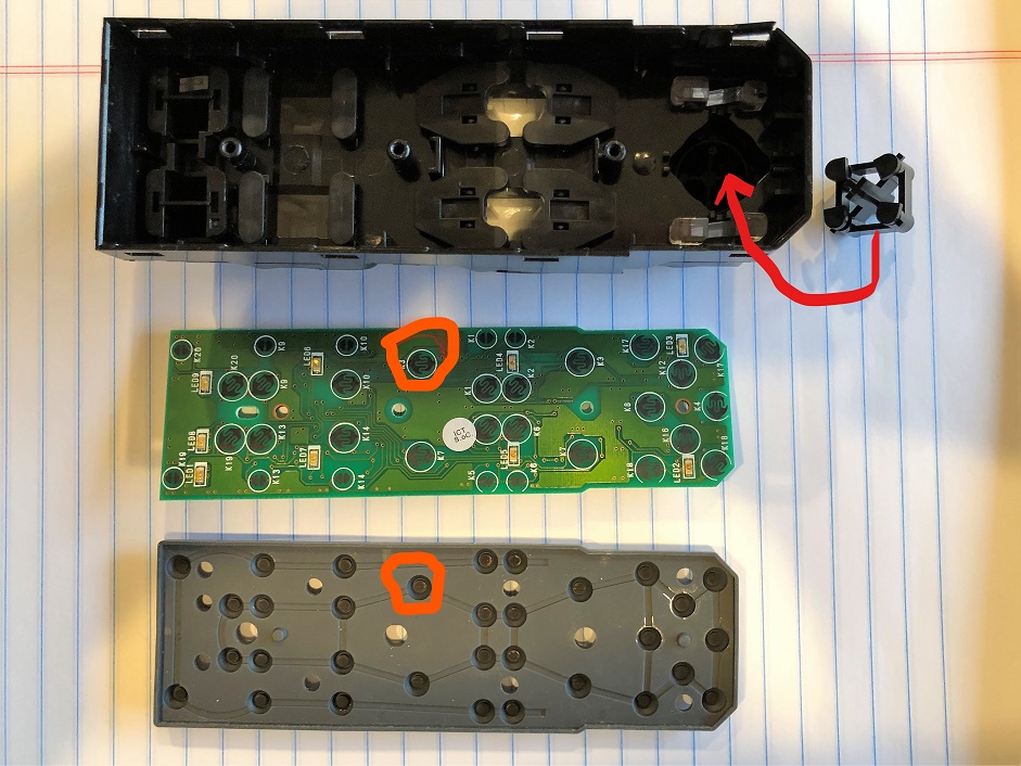

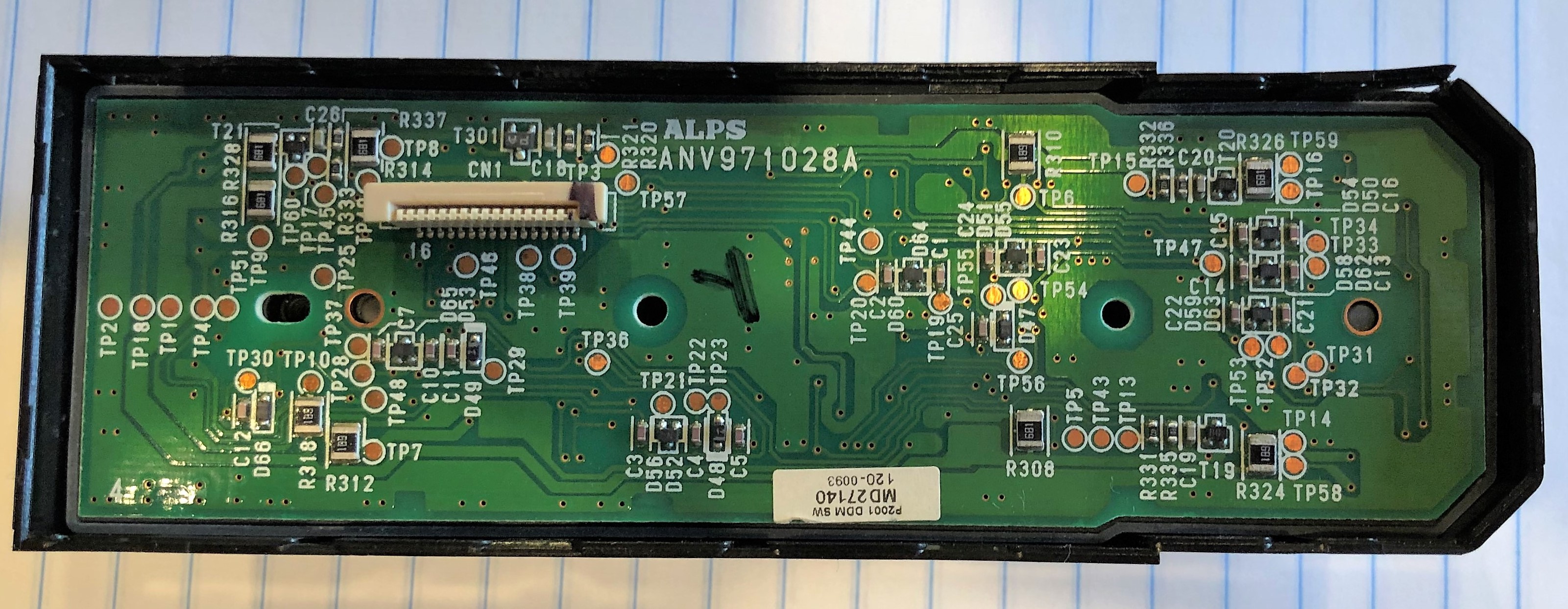

Realize my 2001 V70 is one year newer than this forum, but I have a similar problem and couldn't find any help in the 2001+ forum: driver's window doesn't operate when engine is running; operates with engine is off.
The 2001 controller has circuit board and rubber touch pad instead of the brass fingers and I cleaned all the surfaces, e.g., orange circles, on both but window still doesn't operate when engine is running.
Thoughts?
Thanks. Also, no obvious bad solder points on the board.

Looks like yours likely drives relays, our -~2000 years actually engage the motors directly through our switch. Sometimes the types of contacts like the ones you have will end up with crap on them and no amount of alcohol, etc seems to get them clean. The other possibility is the relays that actually drive your door motors could be at fault or the wiring to/fro.copetal wrote: 18 Dec 2018, 11:01 Realize my 2001 V70 is one year newer than this forum, but I have a similar problem and couldn't find any help in the 2001+ forum: driver's window doesn't operate when engine is running; operates with engine is off.
