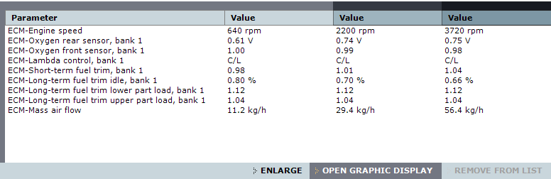

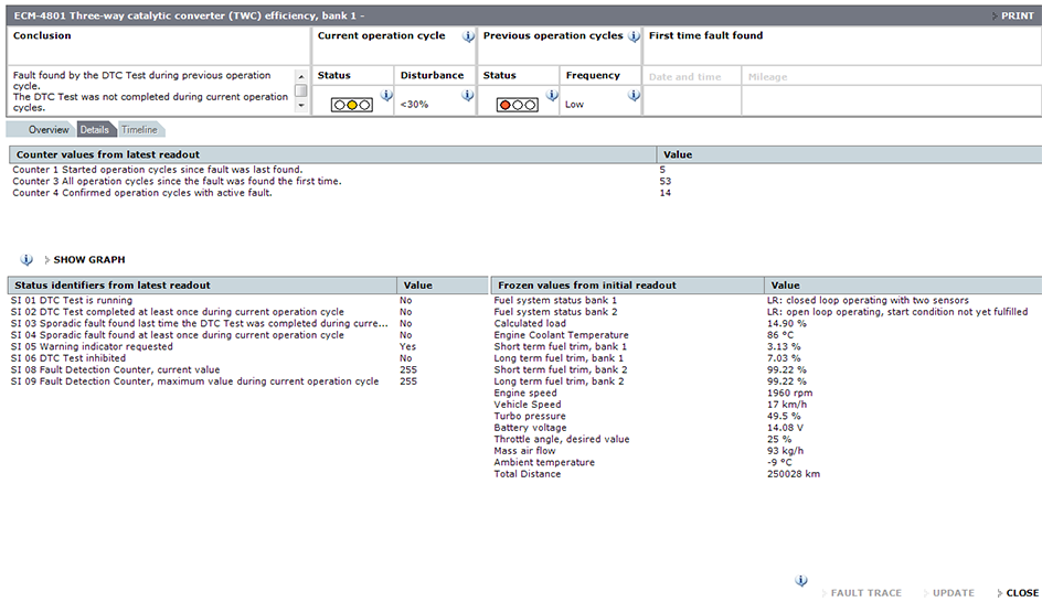

Here are few screenshots from today. Frozen values, Live data @ 640, 2200, 3720 rpm.
STFT and LTFT has improved since 2/14 read.
Frozen values from 2/28 read

Live data side by side @ 640, 2200, and 3720rpm

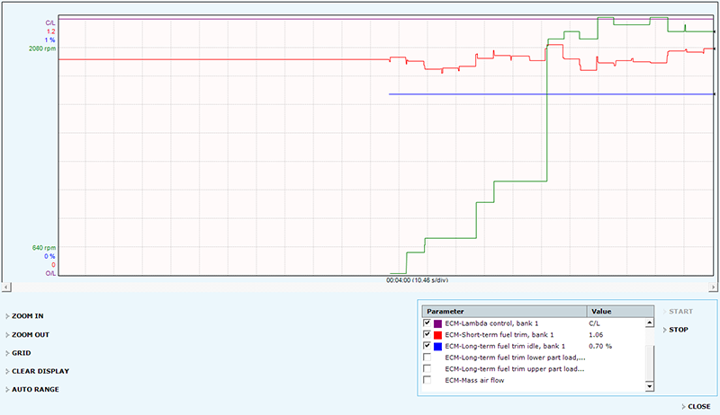

Live graphic view 640-2080rpm

Fuel trims look good, meaning there are no air leaks, fuel delivery is as it should be and ignition works well. The only parameter that is different than my car readings is MAF. Your reading is higher than what I have, 2.7 g/s at idle, but after the conversion you are at 3.nn so it's pretty close. Does the car drives and feels okay?
