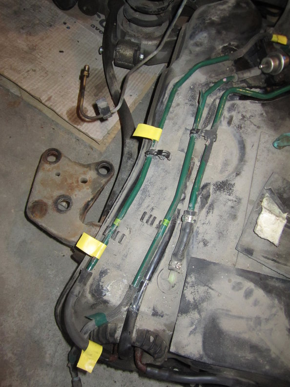

Sure can help with that. Most of the routing can be seen with the pipe routing notes I posted, but the 98 may be a little different to 99-00.
The first picture above, shows the pipes and wire harness from the passenger side (RH side) fuel pump.

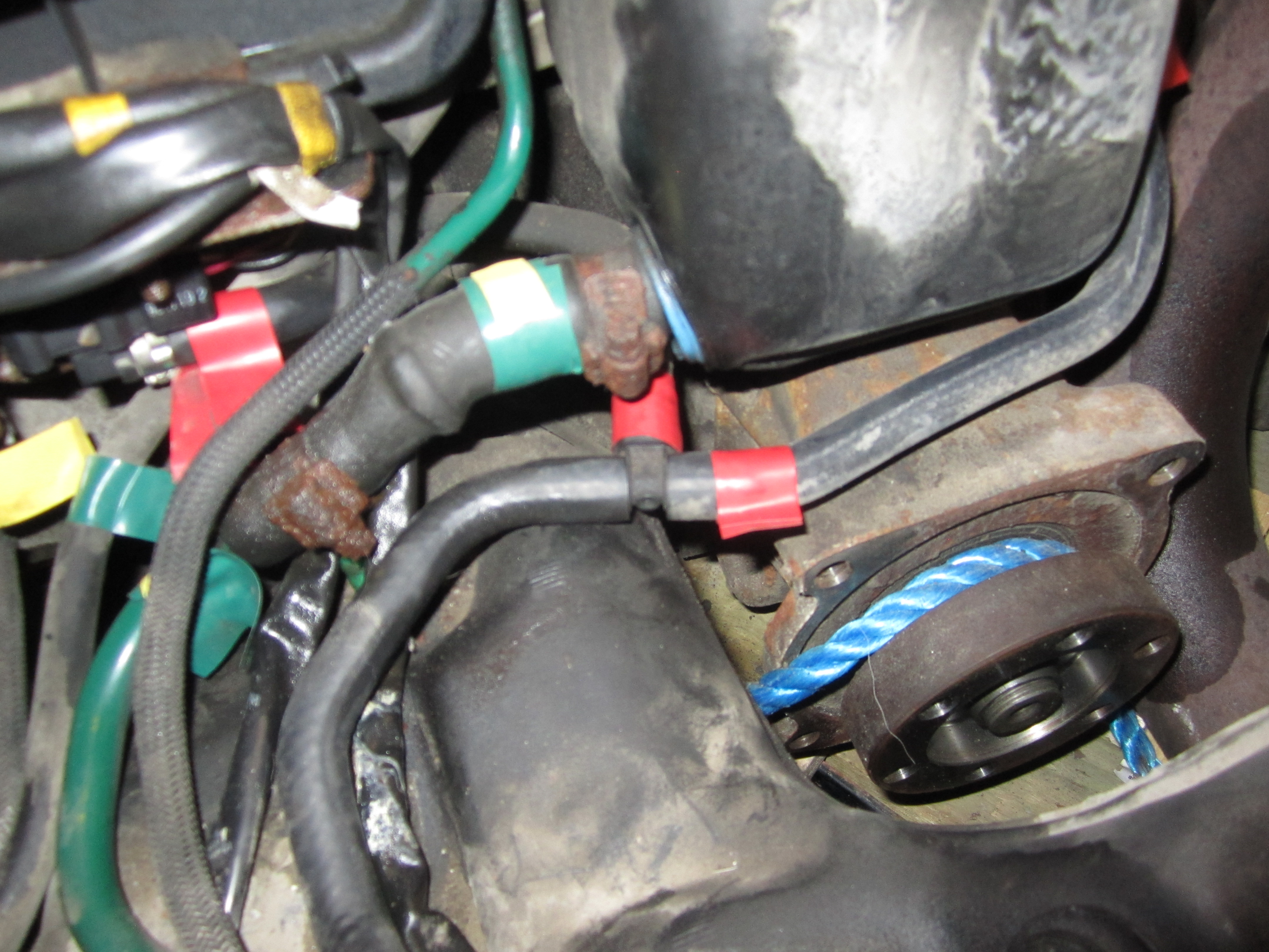

This may be a little clearer.
The wire harness appears in the bottom left of this picture in BLACK and runs up under the pipe for the fuel pressure regulator that is mounted to a black plastic block. It then runs up under the pipes to the right of the carbon filter housing (as seen in the picture, but actually the LH side of the carbon filter frame). The frame for a 98 is a little different to the later cars so this is where it may be a little different. The wire then is cable tied to the wires for the other pressure regulator mounted under the carbon canister mounting frame.

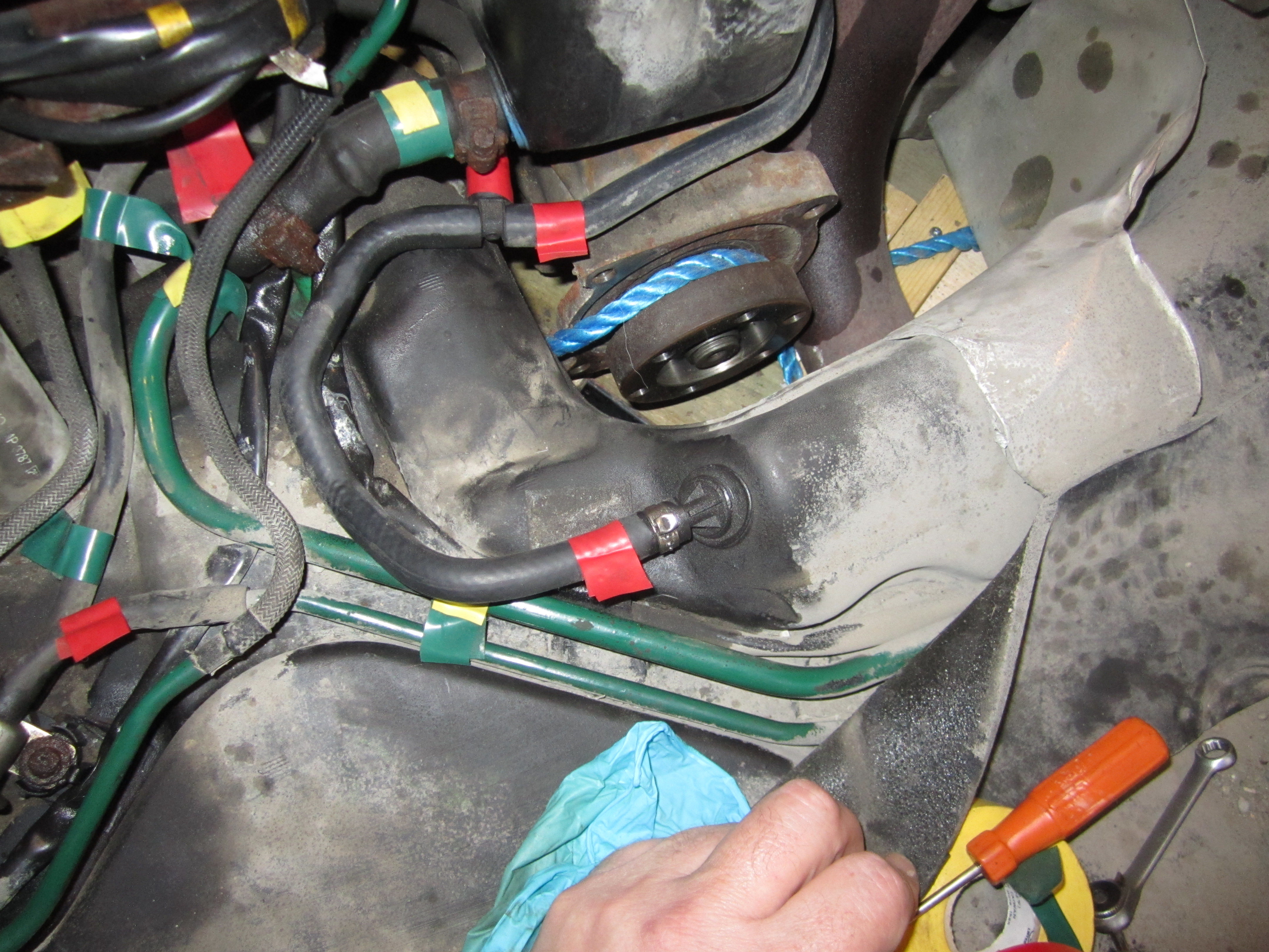

You can see where all the wires collect here and then run across the back of the carbon filter along the RH side of the filter and then up into the back of the car.

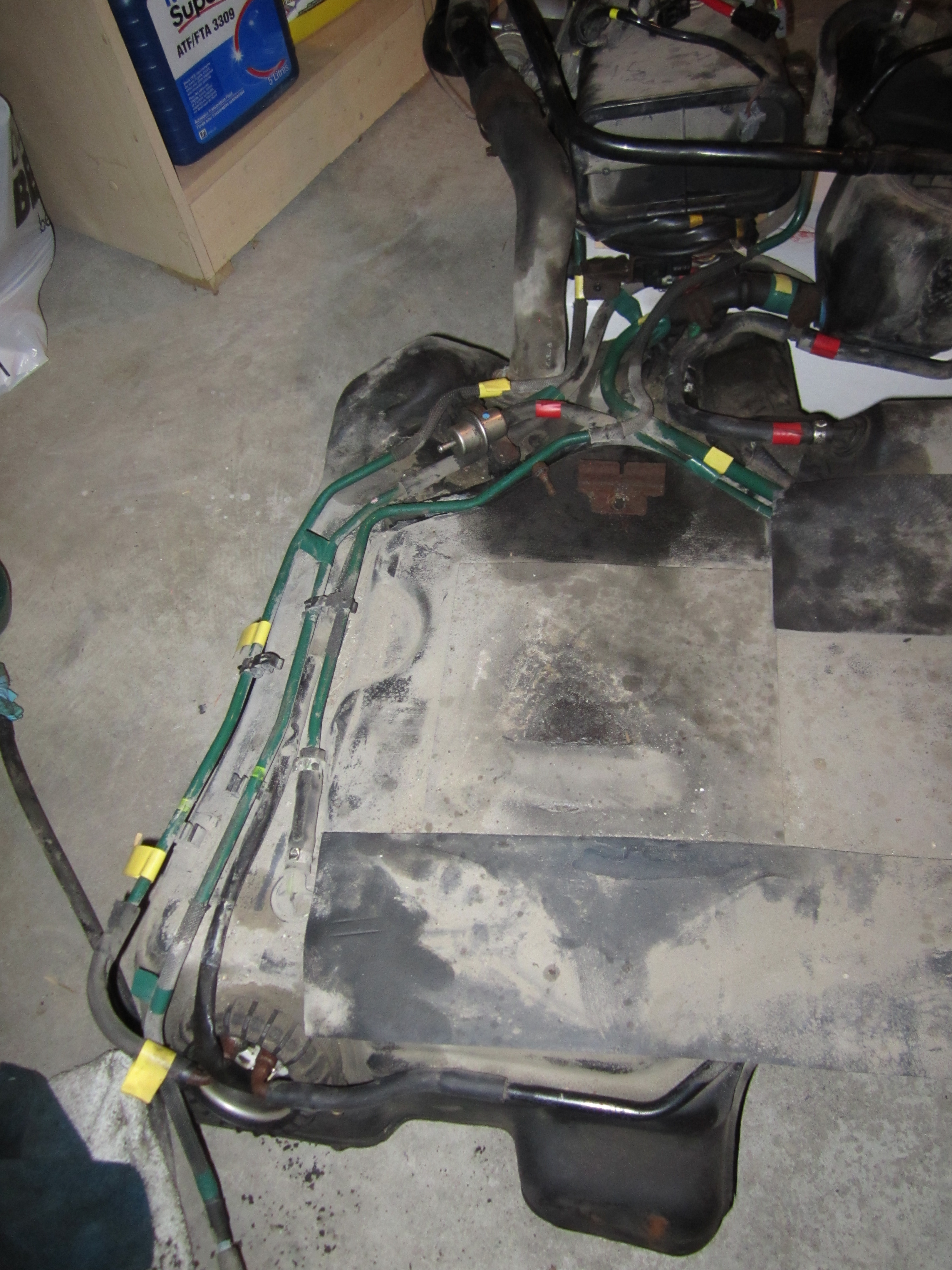

This may make it a little clearer.

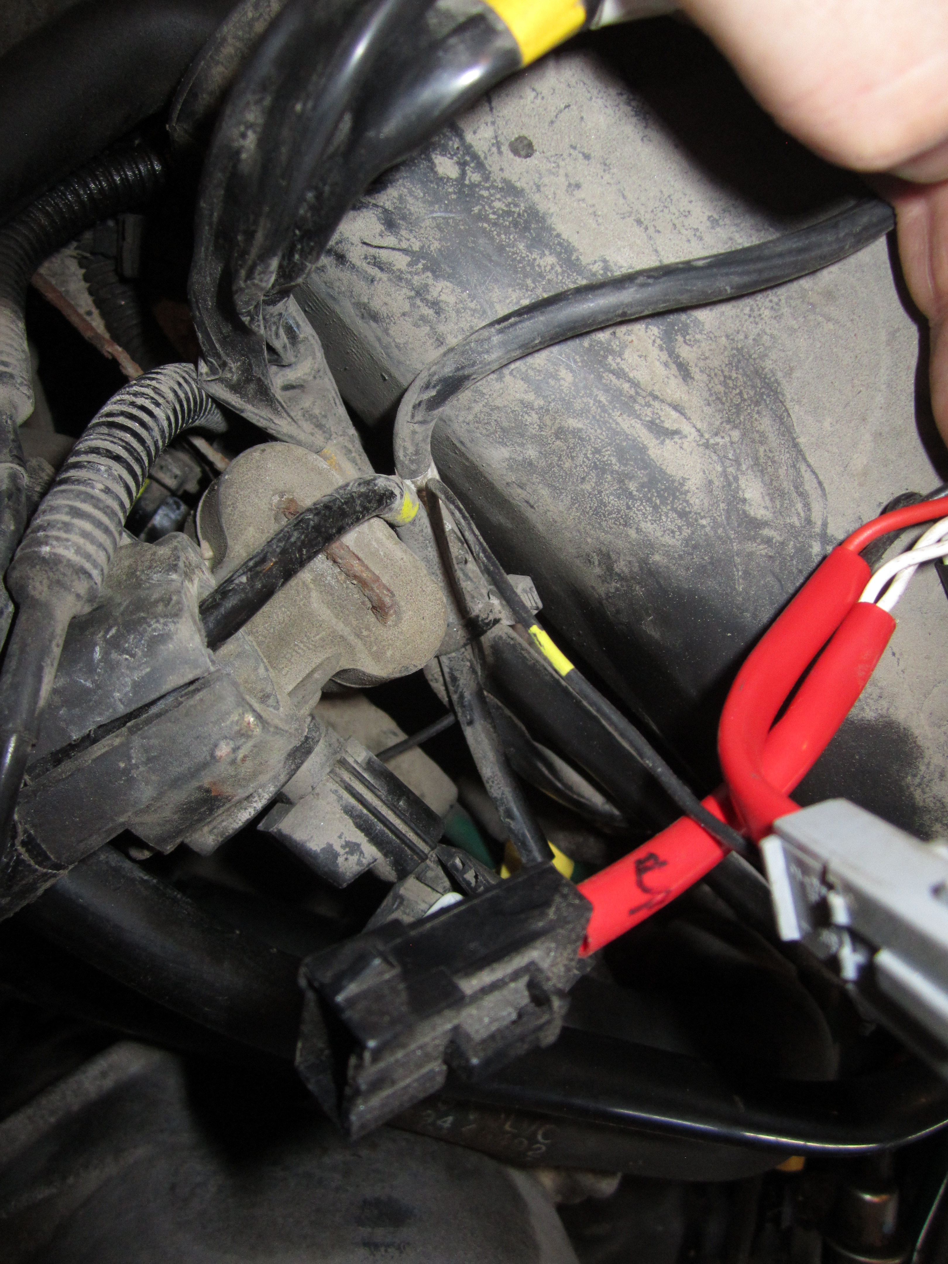

This is where the wires all gather beside the roll over valve then go up into the car.
Hope this helps.
Hope this helps.
