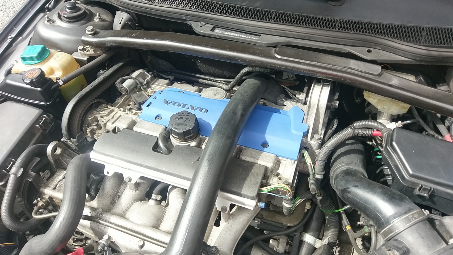

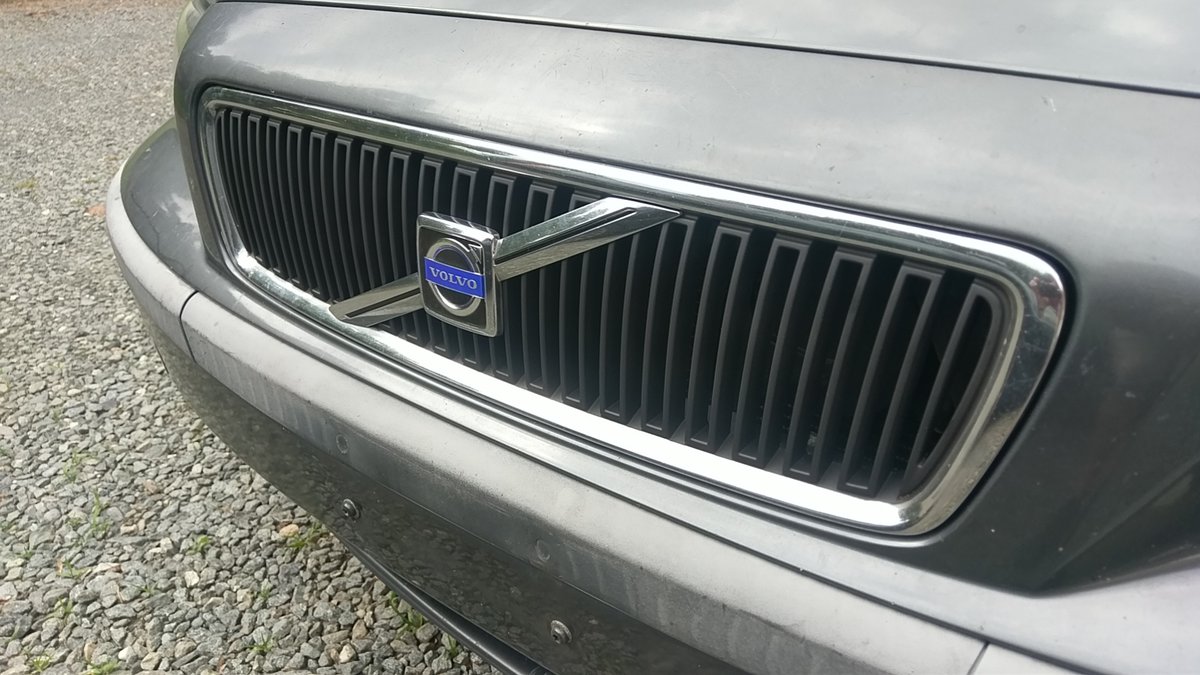

I got an order for a Cerakote job on a set of exhaust tips from 8EightFab and while I had the booth fired up, I did some of the parts for Sven! Mainly the grill (which looks hideous in it's stock form IMHO) and I wanted to try and see the results on the engine covers. I just did a quick trim job on the cover to prove concept, so after I figure out how to mask it better, I'll start offering it! Everything from motor parts to interior bits is eventually going to get done!!

Cerakoted P2 Grill - Graphite Black
Cerakoted Head Cover - NRA Blue
Don't mistake that black on the grill for Plastidip! You would destroy the grill before you get it to come off. No peeling or rock strikes here!! The process mechanically attaches itself to the part. If you care to see how tough it is, check out their video testing it's durability here! I love it because it's durable but it's flexible, chemical and UV resistant. You have to try really hard to hurt this stuff if applied properly! You read about these times where guys can "scratch it with their fingernail". I promise you... nothing that soft will damage Cerakote!! I got into it for my Lotus 7 build, but I liked it so much I started doing my firearms in it too! It's kind of an addiction now. I bring new guns home and 2 hours later they look nothing like they did when I bought them! There are hundreds of colors and you can mix your own (another fun part of the process I have learned), so really the only limit is the owners imagination!

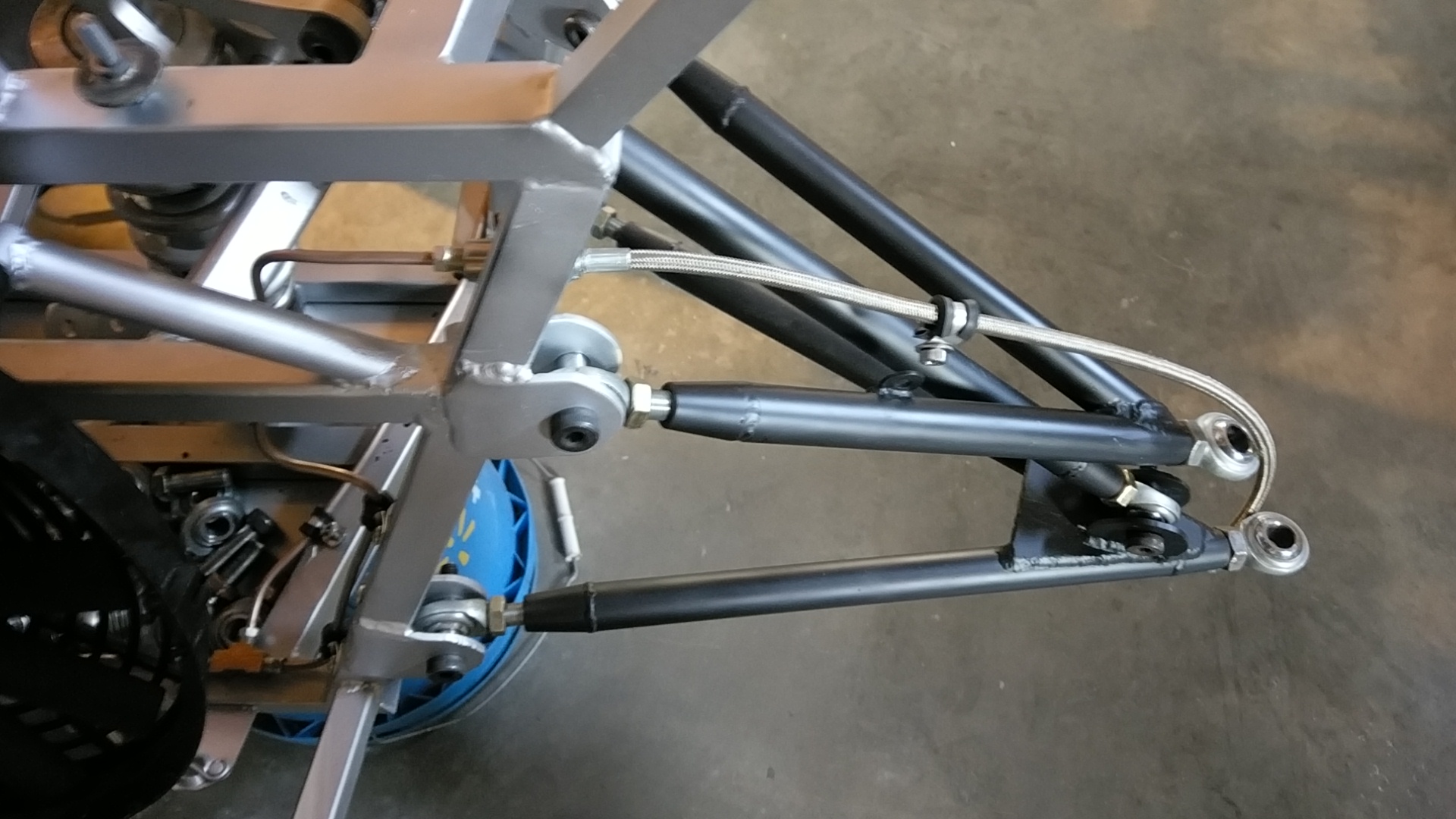

My first diamond in her rough!
Freshly Koted Suspension Arms and Frame. No corrosion here... EVER!!!

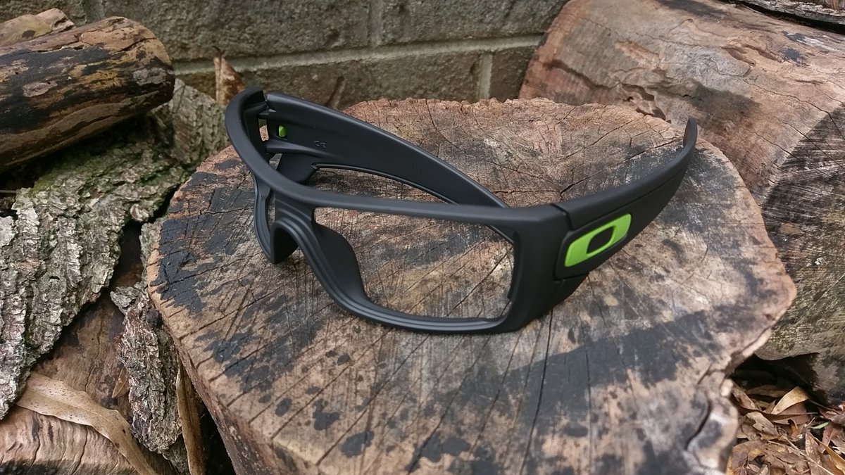

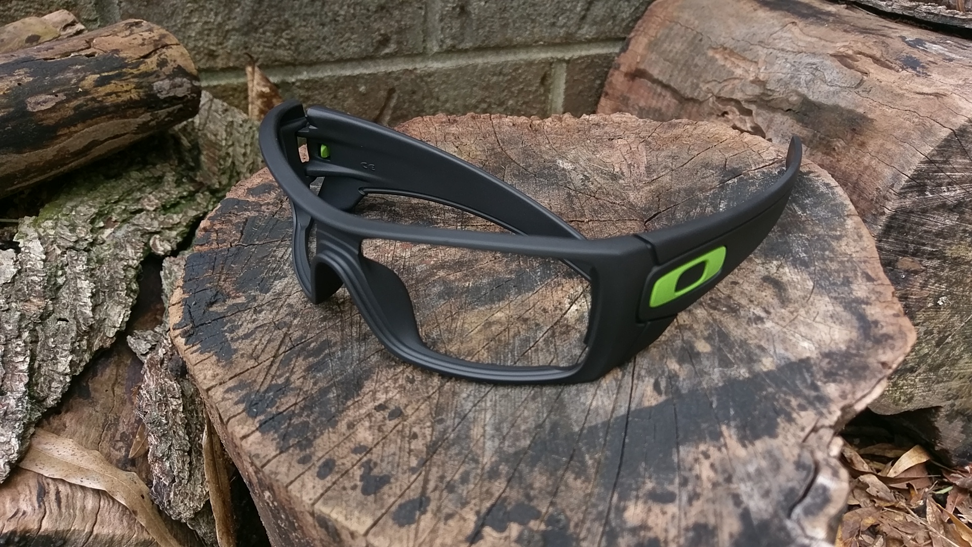

But it's gentle enough for Oakley frames!
