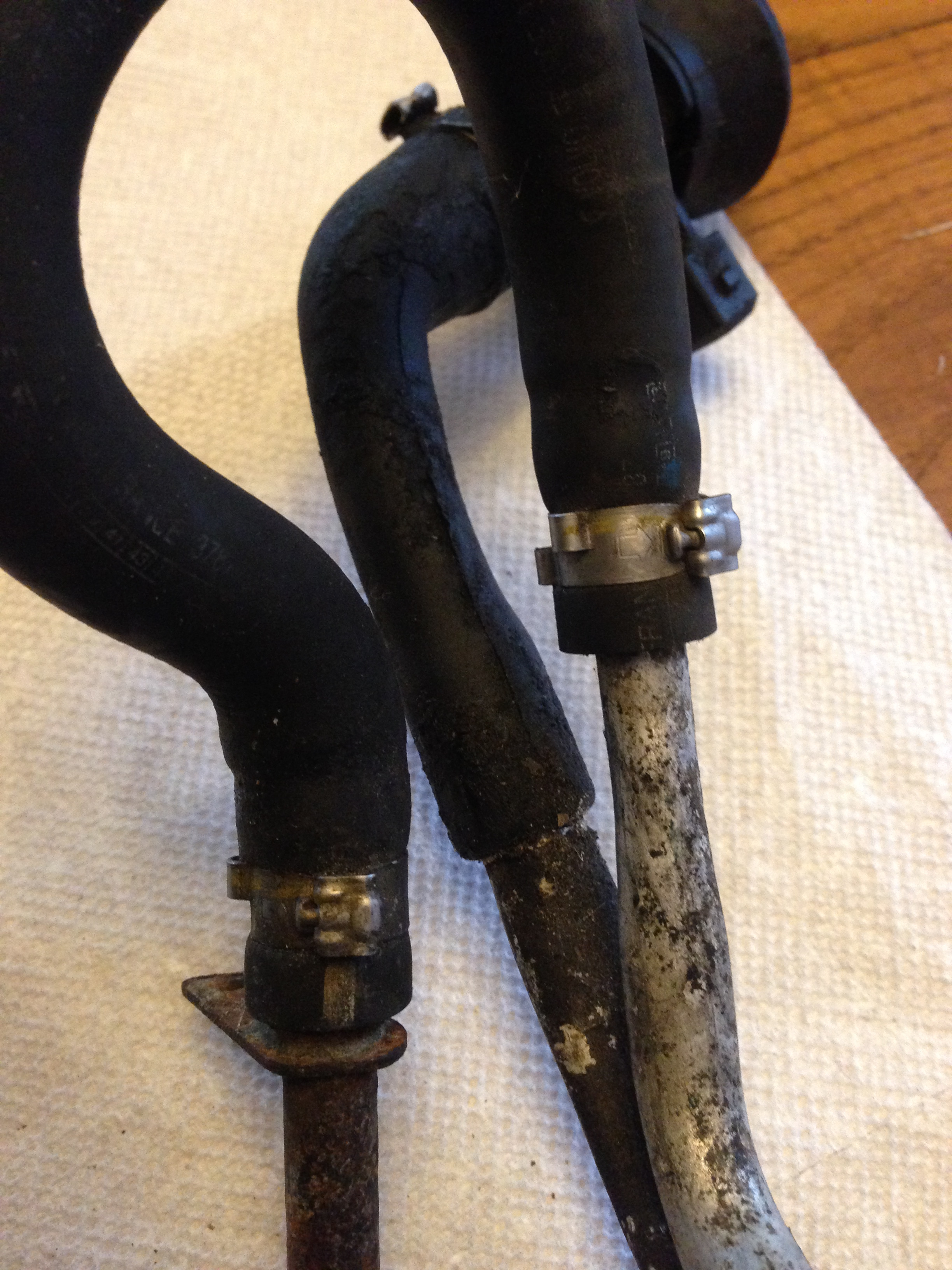

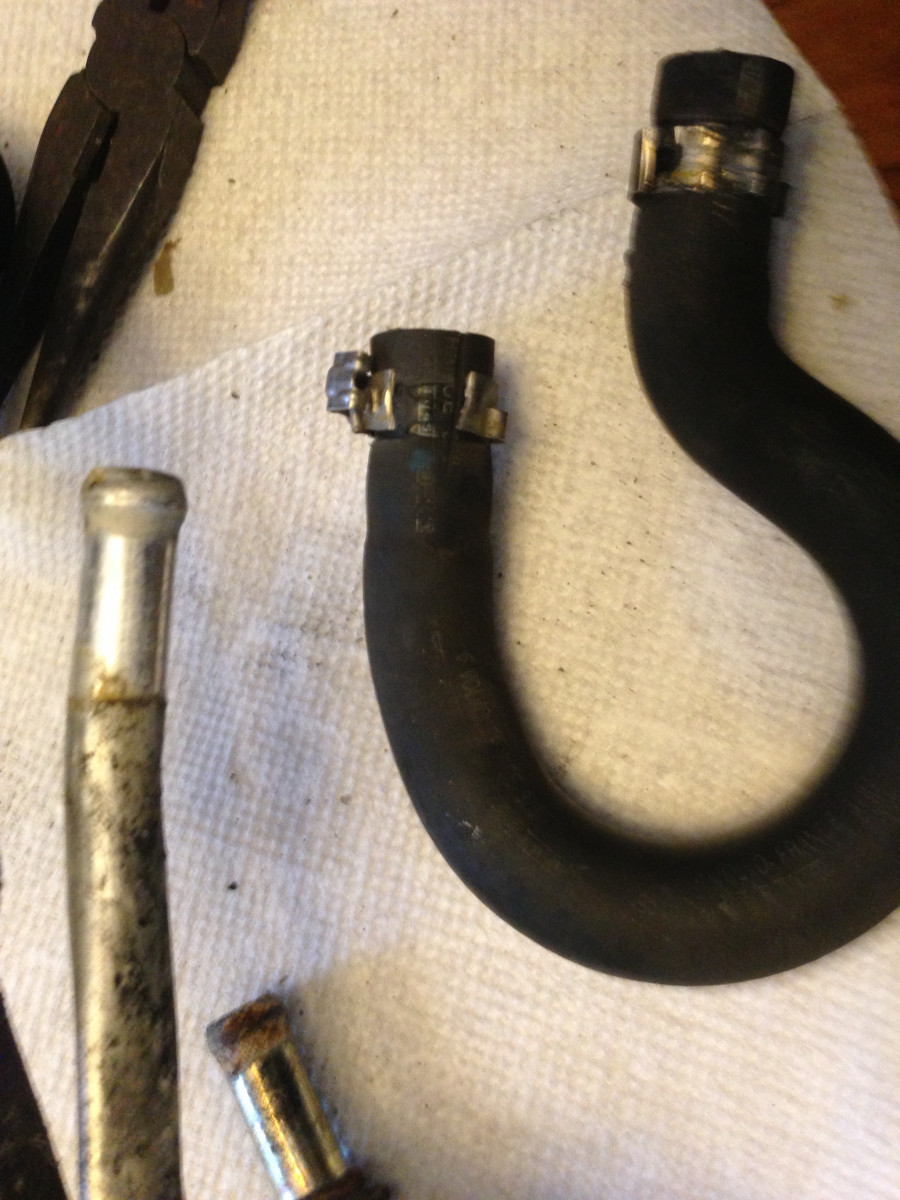

Picture dump
It's thick 10 mm hose with a 11mm ridge in the hard pipe

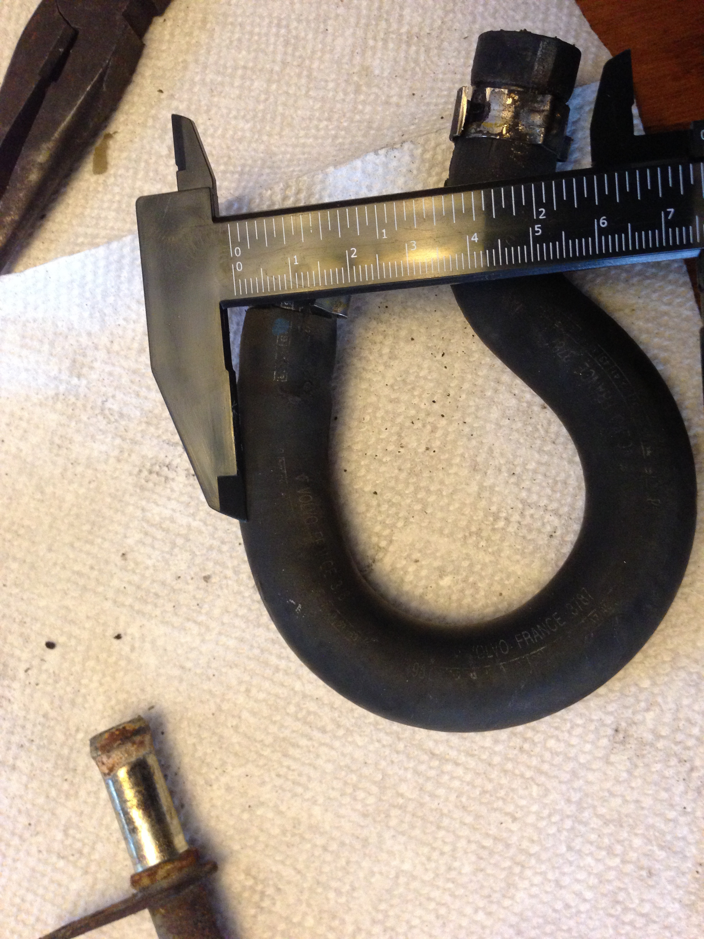

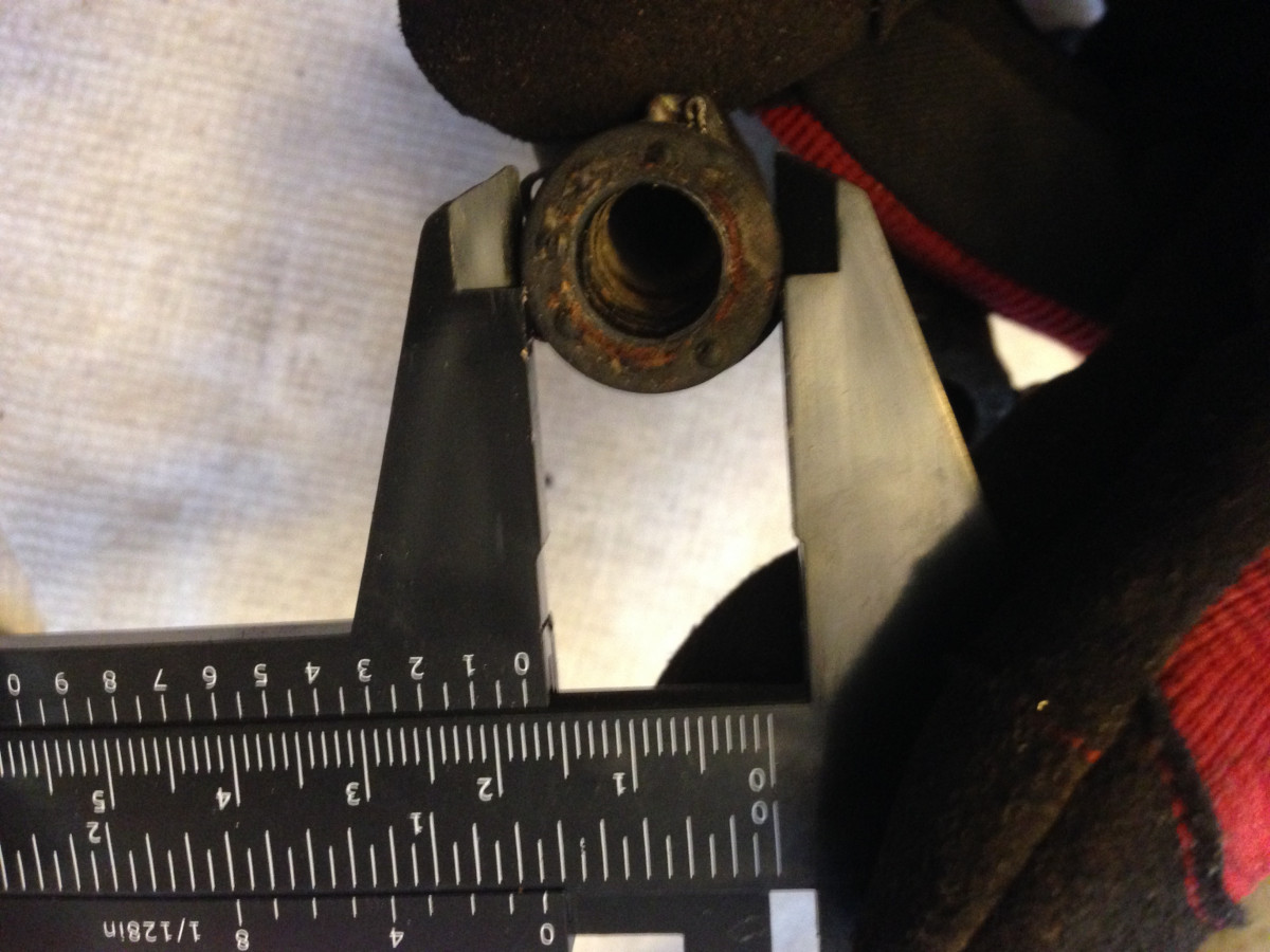

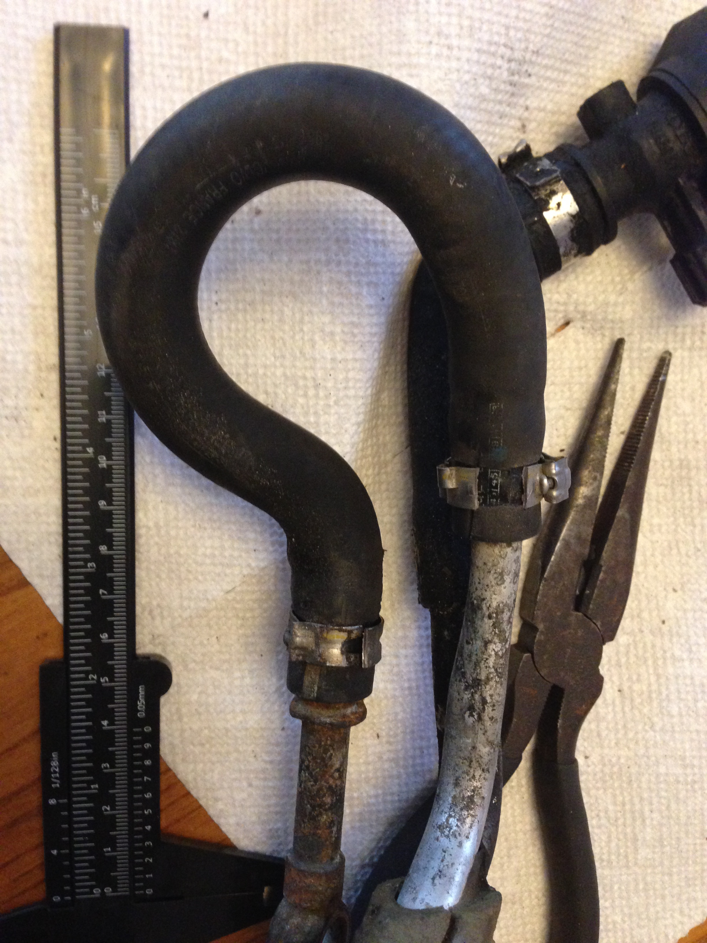

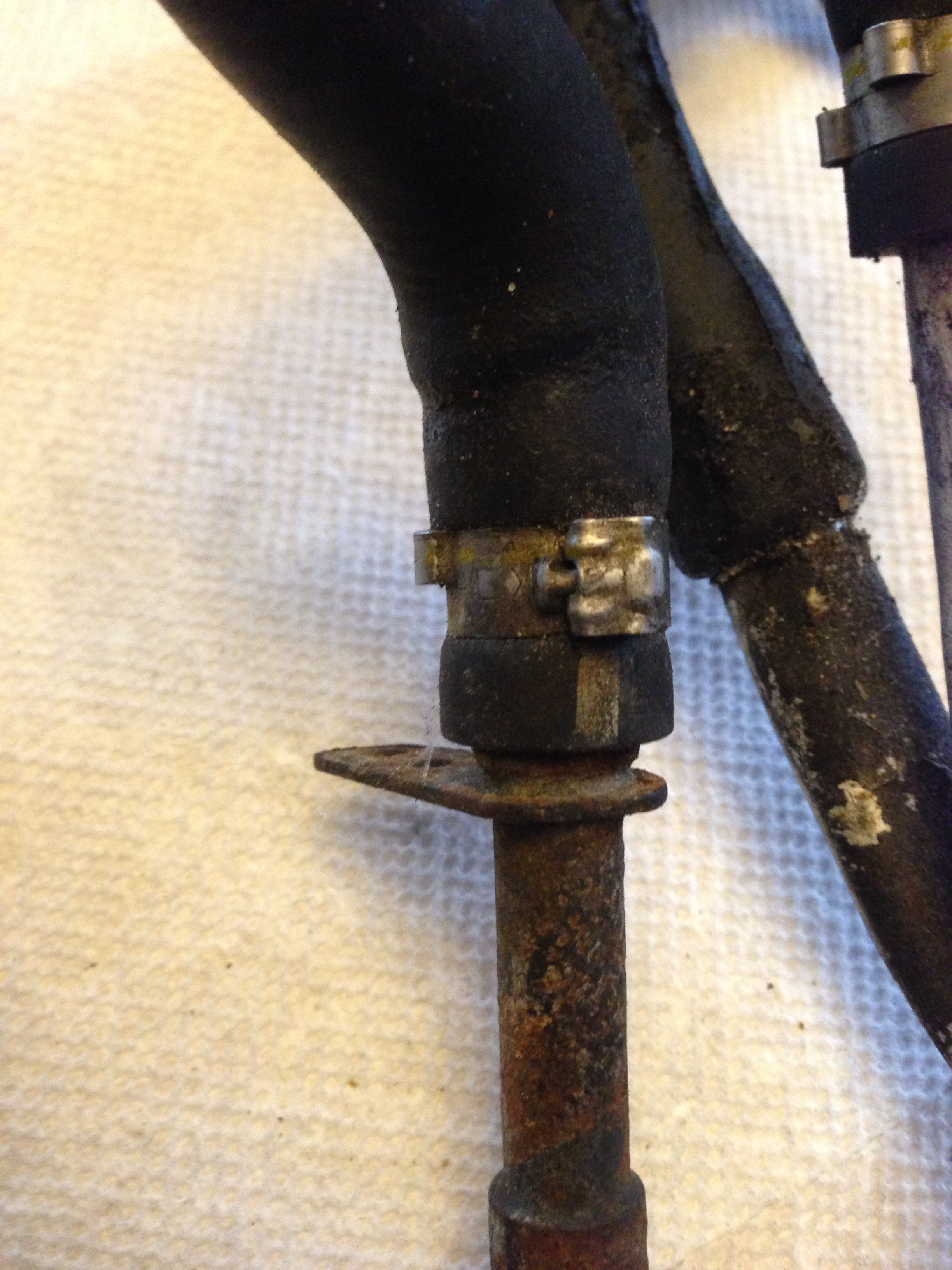

abscate wrote: 08 Jan 2021, 10:10 Picture dump

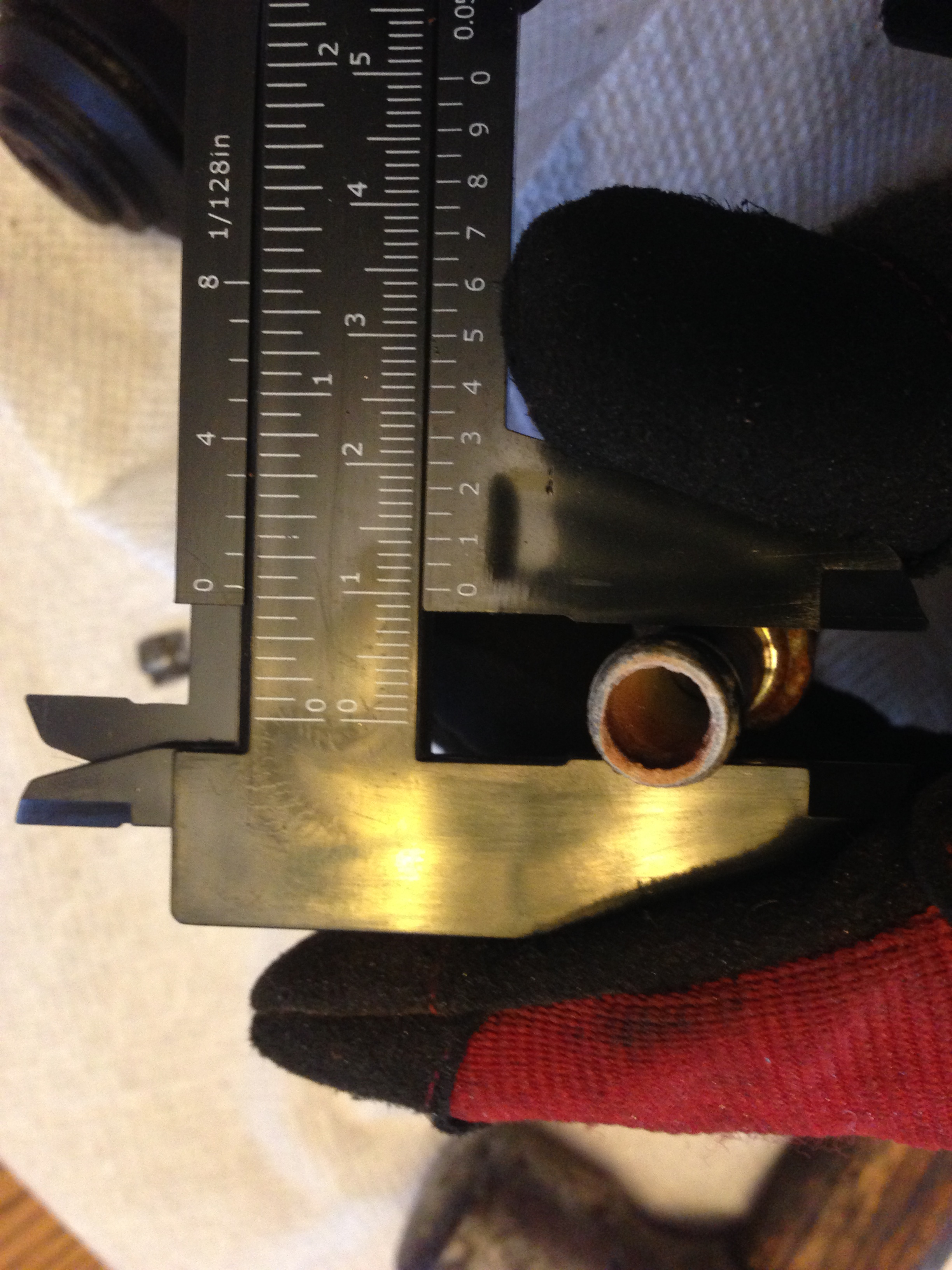

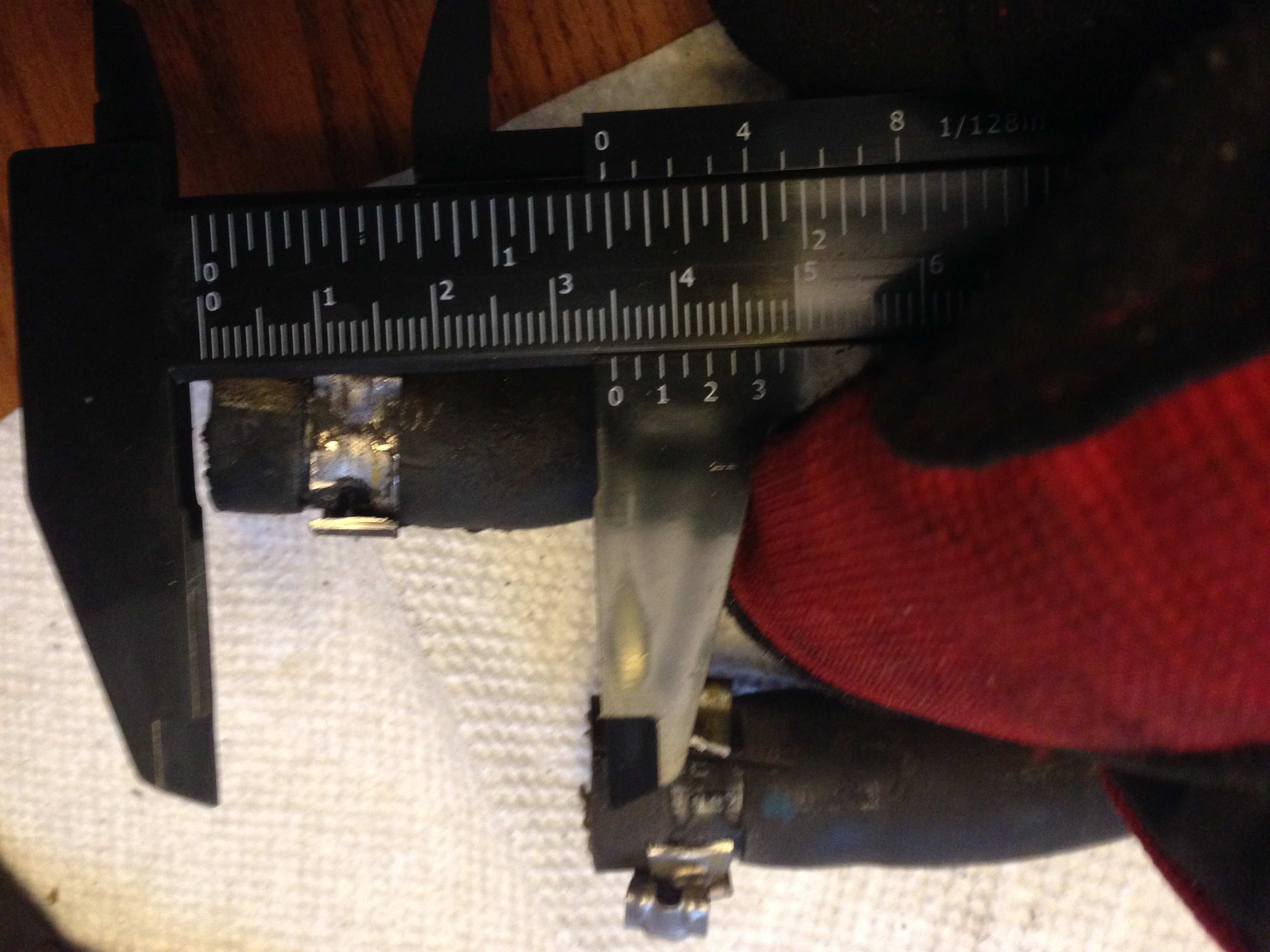

Can you measure the inner diameter of the hose?
Do I need a certain type of hose material for coolant? i.e. would vacuum hose work if I had the right size, or does it have to be specifically for coolant?
I'm wondering if this is the same type and size of hose as the return line for the coolant reservoir? If it is, I'm wondering if I can steal a bit of that line and use it to replace this, or if it's a different size/type of material.

It is 9 mm inside diameter. That is some serioulsy thick hose

Use oetiker clamps to put it together, and you will either need to re-route it or buy fittings to make that complicated shape. I would go the re-route route.

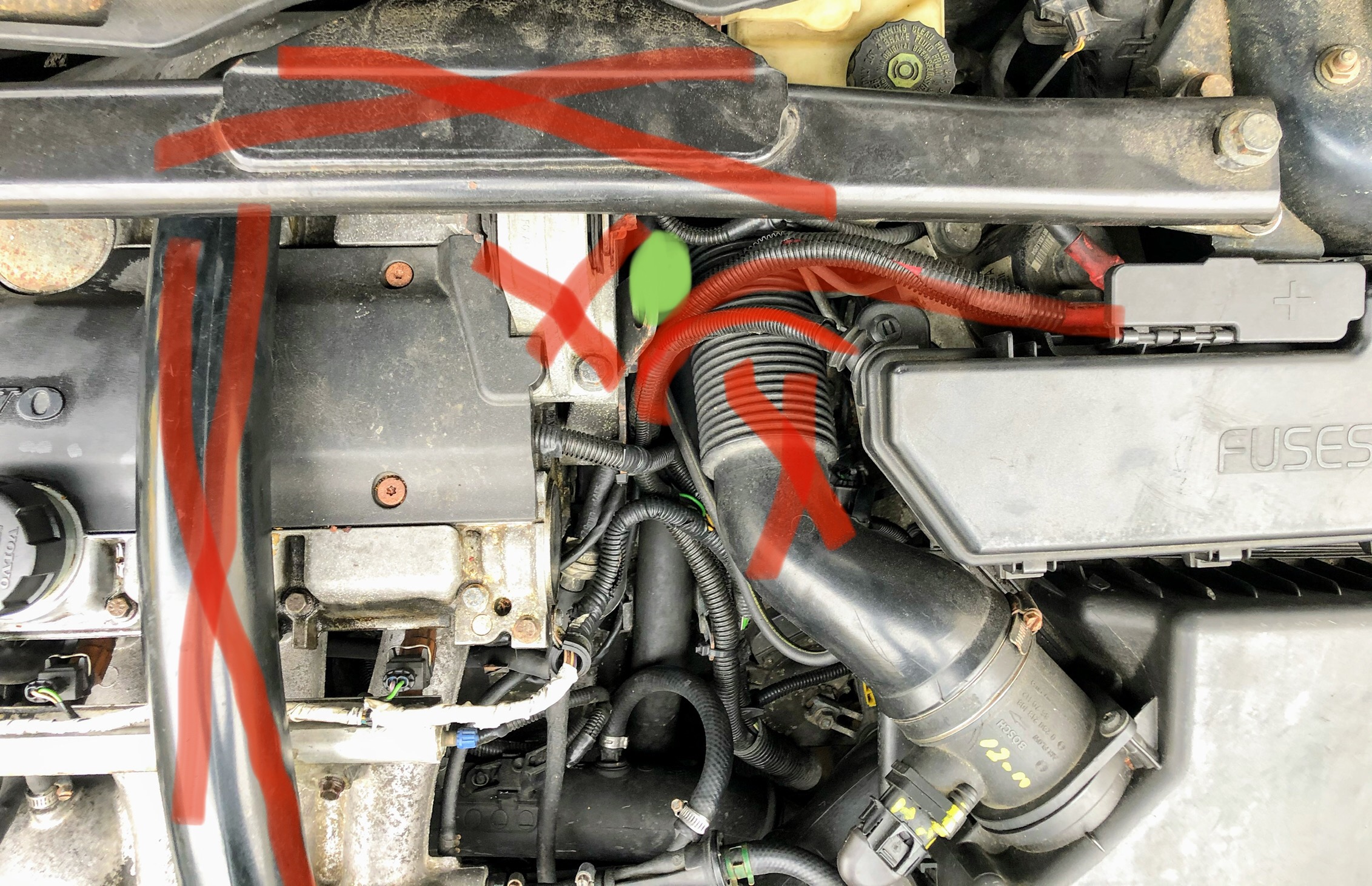

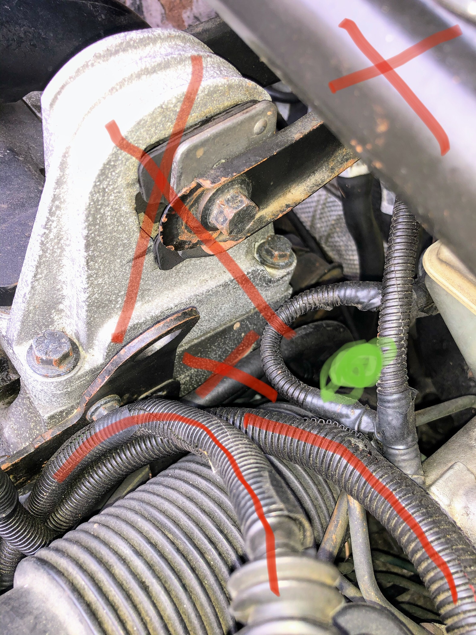

Here are some photos of the area with things I think I"ll need to remove or move marked in red. The general area of the component is marked in green (like the color of the coolant that's leaking from it):
- Strut mount crossmember
- Charge air pipe
- Top engine mount
- Side engine carrier plate (straddled by top engine mount)
- Fresh air pipe to turbo
- Cables from fuse box and positive terminal
(FWIW: I viewed these photos in a color blindness simulator (https://www.color-blindness.com/coblis- ... simulator/), and apparently it should only be an issue if you have Red-Blind/Protanopia or Green-Blind/Deuteranopia, in which case the red will appear as a light yellow and the green will appear as a darker/more bold yellow...)
Also I'll need a day that's not freezing cold to spend several hours working in the driveway...
Let me know if anyone has thoughts on strategy.

You can get the oetikers nipped with end on nipping pliers as opposed to dikes or side ons
The Dremel tool you ordered for Christmas should arrive soon, you touch that to the existing oetikers for 13 seconds to remove that. Use the fiberglass reinforced discs. Don’t try to trim your nails with that, it hurts
