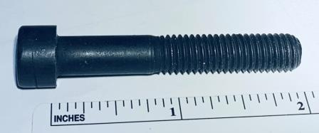

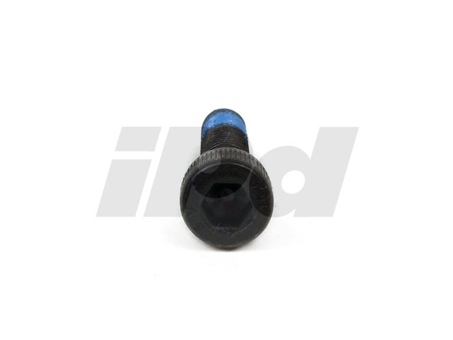

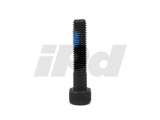

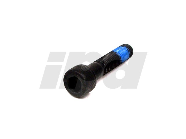

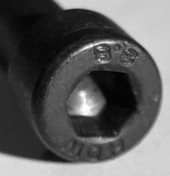

Only bolt close to that I've seen on these are the bolts on the prop shaft front and rear CV joints, part #988143. It's in my head 'cause I was recently down there, but I don't recall seeing anything similar elsewhere on the car. Looking at it, honestly I don't think it's the same bolt, but it can at least be ruled out. The length of the non-threaded section looks slightly off, but there was a superseded part #981507, which I can't find a picture of, and yours is a 2001...
Doesn't make any sense that one of those would turn up on your workbench, though...they're loctited in, and you were nowhere near that area... also fairly easy to check that all yours are still installed, if you care to, though.
I'd bet on non-Volvo random other-car part or unused piece from a universal kit of some kind.
What's the frequency of the sound? Like a one-per-revolution, matching the rpm, or a lower clanging noise, or what? If you don't want to start up the car to get a recording of it, you could recreate it in a recording by tapping on a desk or banging on a metal part... if you can approximate it, it might help the smarter car guys on here figure it out.
For comparison, your pics:

I was watching a video on head removal and sighted something that looked like what I have. I paused and rewind to be sure.
Yippie, it’s from the cam locking tool. It's the bolt that holds the arms together after the arms are screwed in to the cam shafts.
Now so feel better. At least that worry is out. Thank you all for helping me in identifying the bolt, well appreciated.
