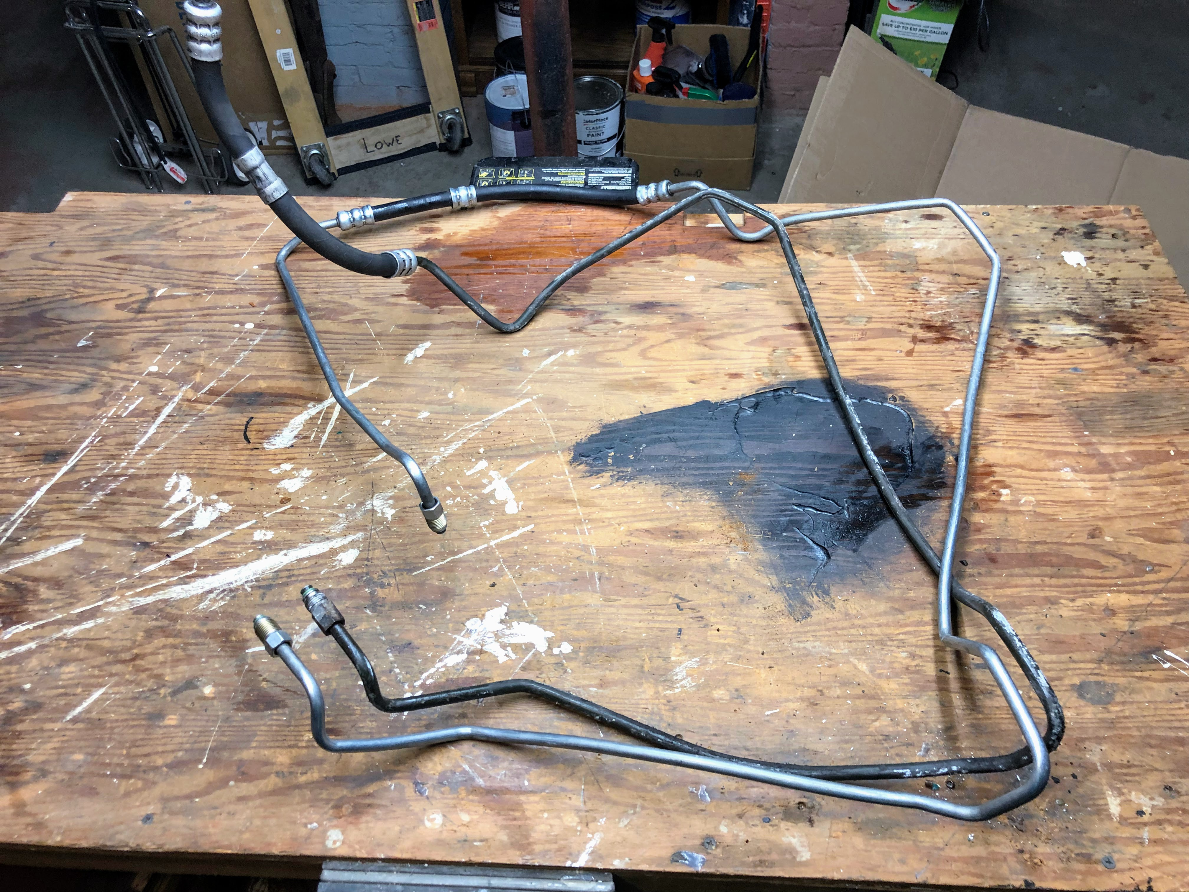

1. I laid the old and new hoses next to each other to compare geometry. One thing to note is that the old hose was not the correct hose for my model - it is part # 8634217 which is for 2001-2003 non-turbo V70 and S60s, which nevertheless was technically compatible, albiet ill-fitting. The major difference is with the bit of hose that comes up to the engine compartment, but I believe the bottom parts of the hose that connect to the steering rack should be roughly the same. here's what they look like next to each other:
The bottom geometry basically looks the same, until you get to the right side where the old hose bends to the left and the new hose bends to the right. The hose does flex in that area, though, so I'm not sure which one is preferable.

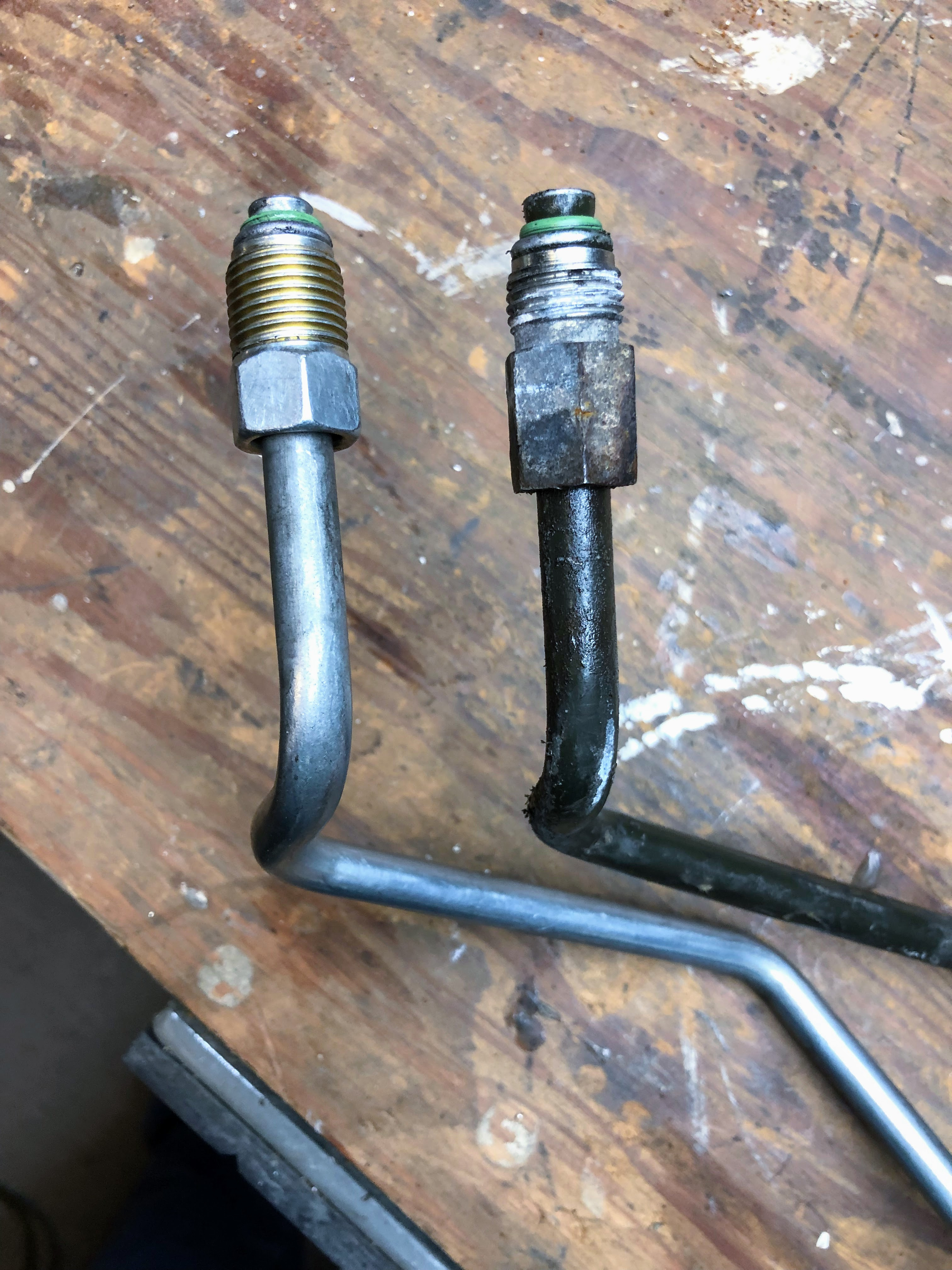

2. I compared the nipples on the old and new hose. The new hose has a shorter nut but more thread, where the old one has a longer nut and less thread. The length and angle of the piping leading to the end of the hose is the same though.

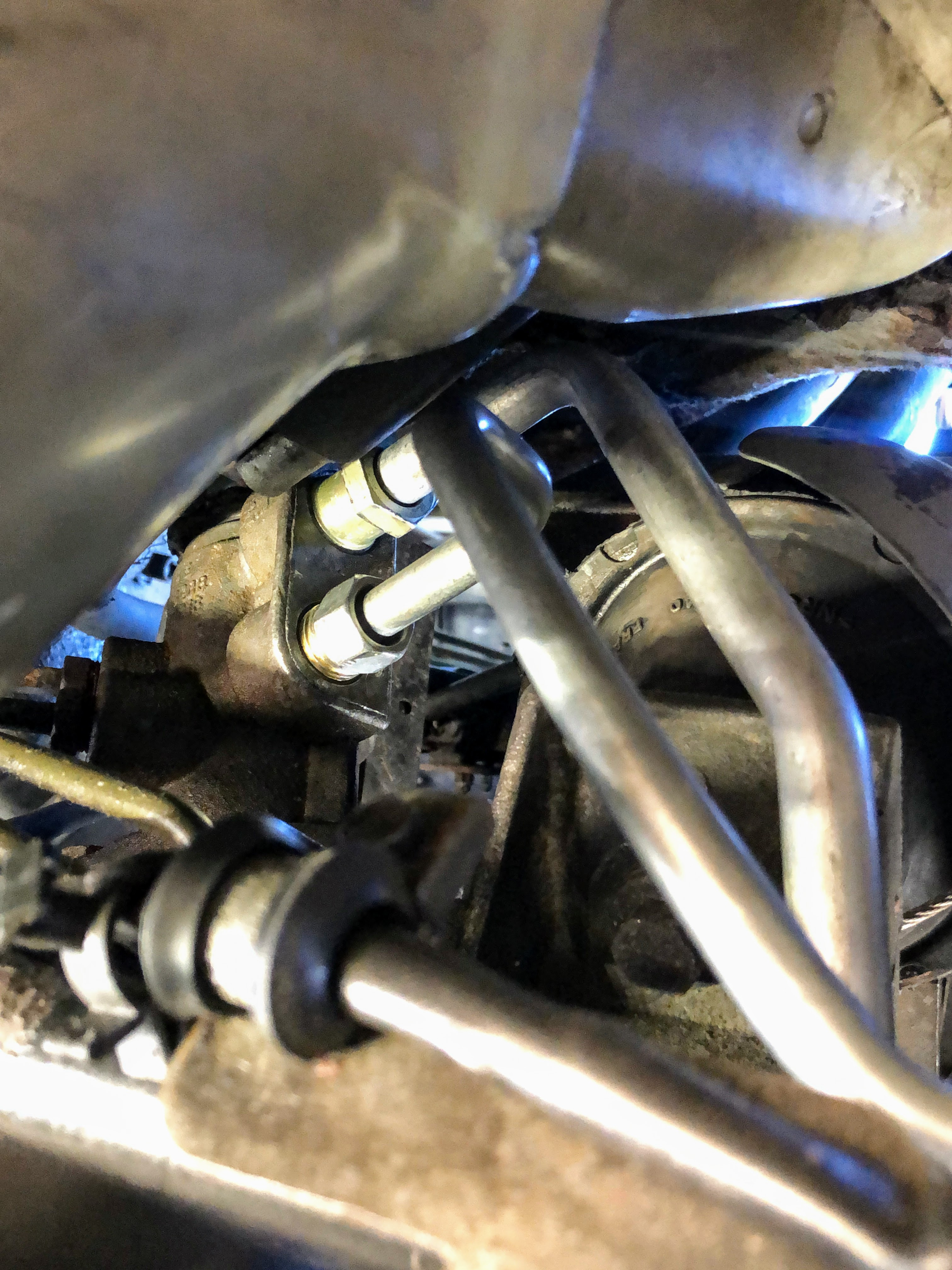

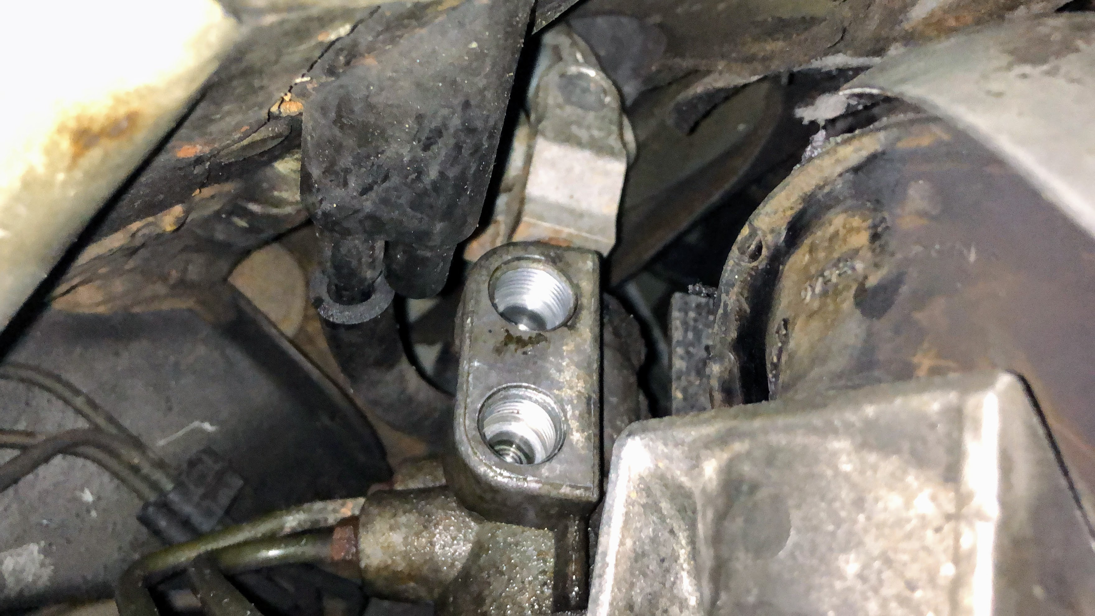

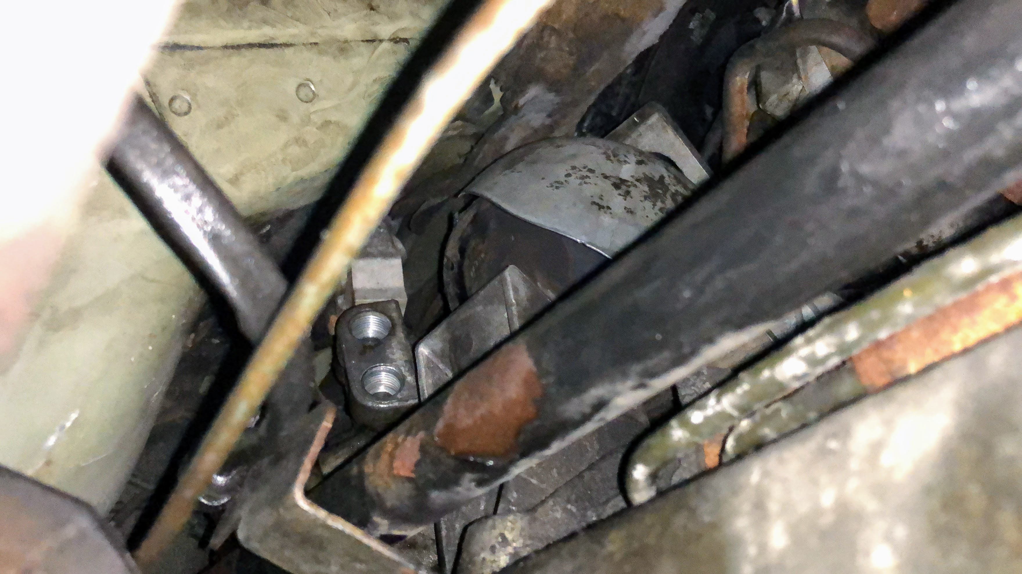

3. Took another gander at the obstructions around the steering rack connections. The engine mount is clearly an obstruction, and removing it would make things easier. There's also some sort of connector black connector that seems permanently attached to the transmission which is also obstructing things.
4. If I do remove the engine mount, do I need to keep something under the transmission to hold things up while the mount is removed? If so, this might end up being worse since a jack or a jack stand right there would definitely get in my way.
5. It does seem like lifting the car a bit higher would make things more comfortable. I have to find a suitable wood block to use... normally my father-in-law has a ton of extra wood laying around from carpentry projects, but he seems to have cleaned up most of it...

The hose looks like it will work fine. You got the old hose out with the rear engine mount installed correct? I still cannot figure out why you don't make it easy on yourself and drop the subframe and give yourself some room in there, it's easy and only takes about half an hour. If you take the rear engine mount out the engine will not drop, it's well supported in the front and on the passenger side. Good luck tomorrow!

- The new hose, as I had previously noted, has longer threading, which you can see in the photo at the steering rack with some thread protruding even though it is socked down tight. I'm hoping that it's tight enough to stay threaded in - the end at the pump has a locking clip that's connected from the side of the pump and locks in place around the nut to keep it from rotating. VIDA does make a note of the thread possibly protruding on the pump end of the hose (at the point where it tells you to install the locking clip), but nothing about the thread on the rack end. I suppose I just check it periodically? Maybe the rack end isn't as prone to vibration as the pump end?
- I didn't lower the subframe or remove the rear lower engine mount. I felt confident that I could accomplish the job without doing either one.*
