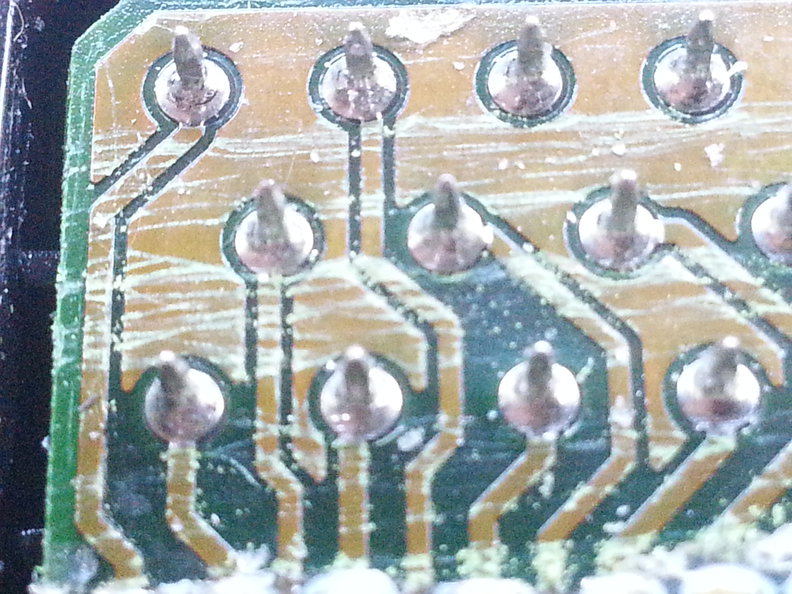

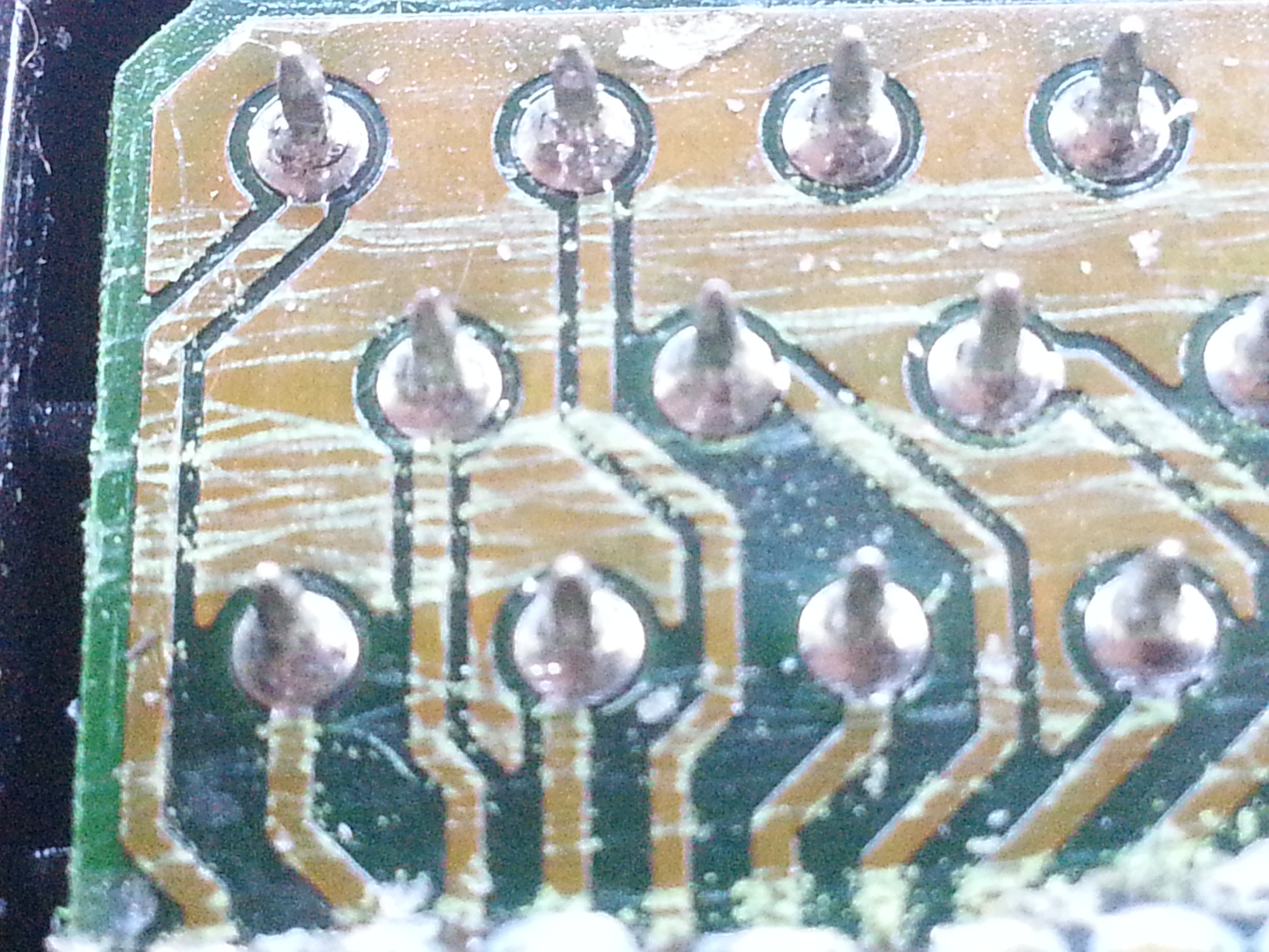

Came across these crusty demons on a Tracs ABS unit from a 850 the other day.
I have a rating of 30 watts however it has a 130W element built into the trigger for short sharp bursts; great for those pins and other large surface solder points.
The top row on the smaller pins is particularly bad
